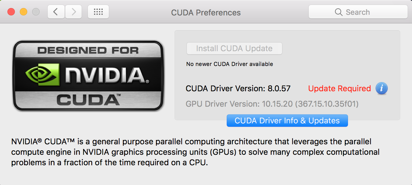

Nvidia Web driver 367.15.10.35f01 for macOS 10.12.3 now available over the Nvidia control panel. Do the update.
CUDA 8.0.57 not up to date.

I do not remember having the CUDA driver delayed from the Web Driver in the past, but I'm running into the same thing. Probably will be available late tonight or tomorrow.

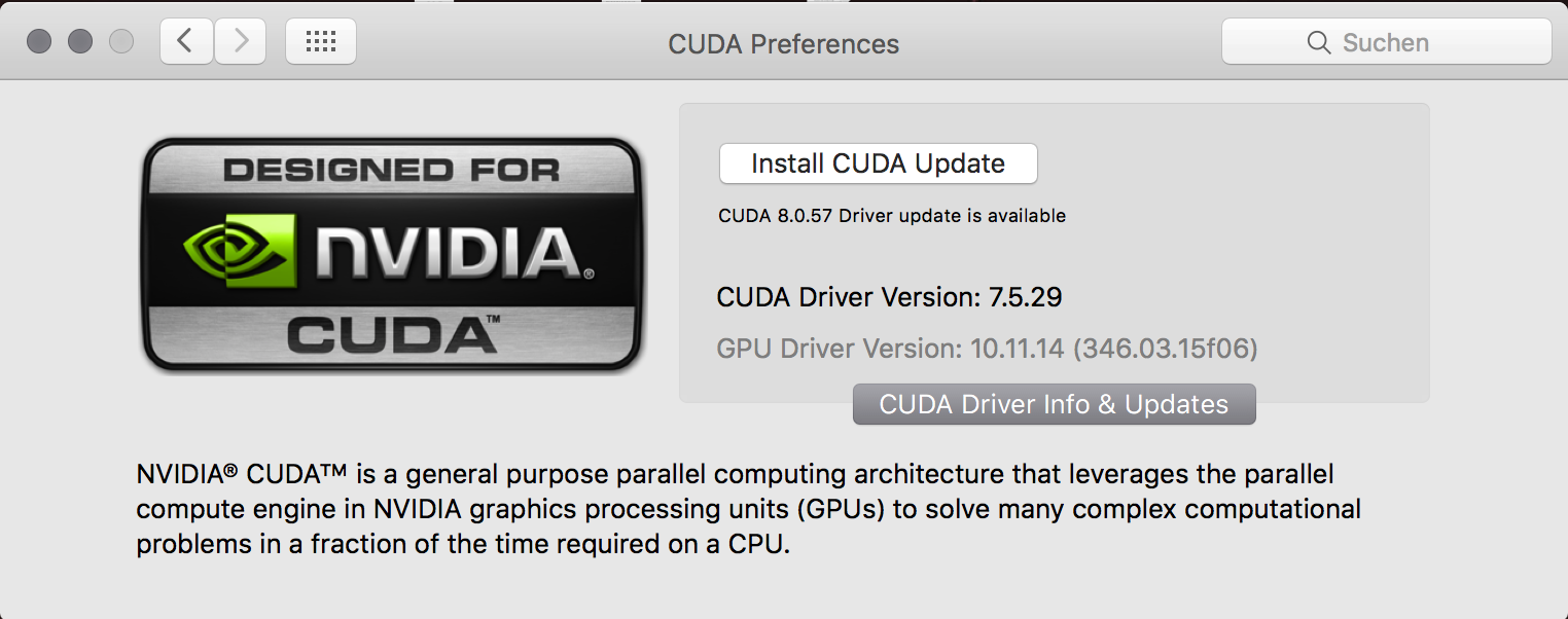

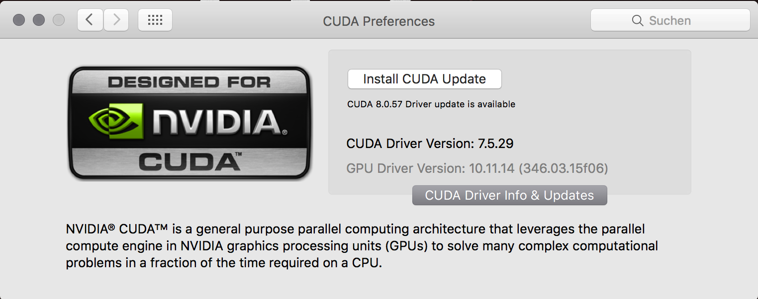

Download and install CUDA 7.5.29, works with newest Nvidia driver for 10.11.6:

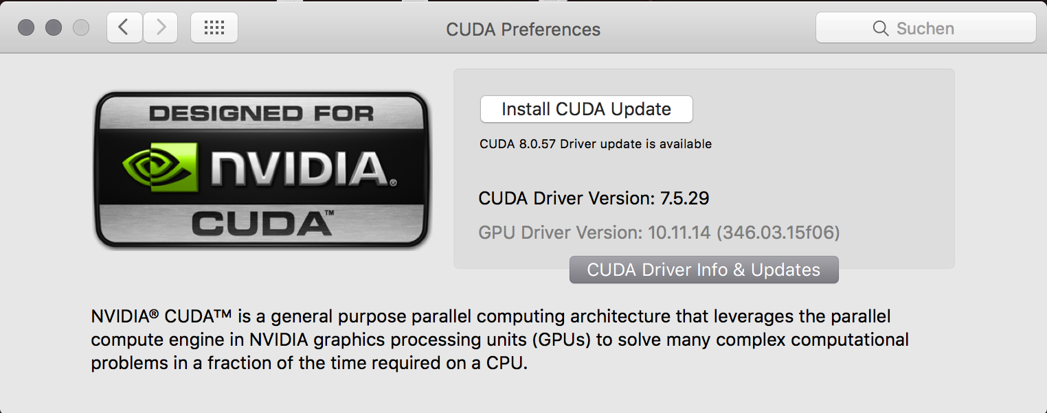

I am downloading CUDA 7.5.29 and will install. I currently have CUDA 8.0.59 installed and It is also giving me an error message.
Driver 346.03.15f06 works with OS X 10.11.6 (15G1217) on my Mac Pro.
Driver 346.03.15f06 works with OS X 10.11.6 (15G1217) on my Mac Pro:
I got it to work!!!!! I booted into the recovery console, and clicked on install OS X. that rolled back my OS X to 10.11.6 and then reinstalled the security update (to bring me to build 15G1217) and then installed the NVIDIA Web Driver 346.03.15f06. After I installed that I put my graphics card back into my mac and started up and it worked!!

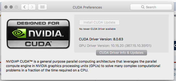

^^^^You're right it isn't. A couple of sites I visit have the link. I found it there and brought it over here to share. It works and the Cuda Preference Pane shows Cuda as being up to date.
Lou
FYI - the CUDA 8.0.63 update is now showing on the NVIDIA download page and through the CUDA preferences for anyone that was waiting
