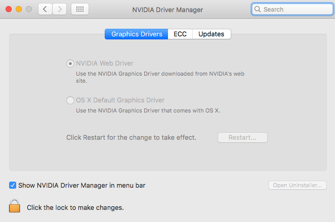

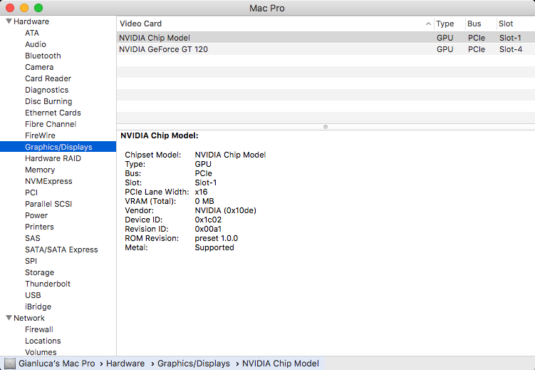

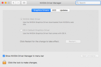

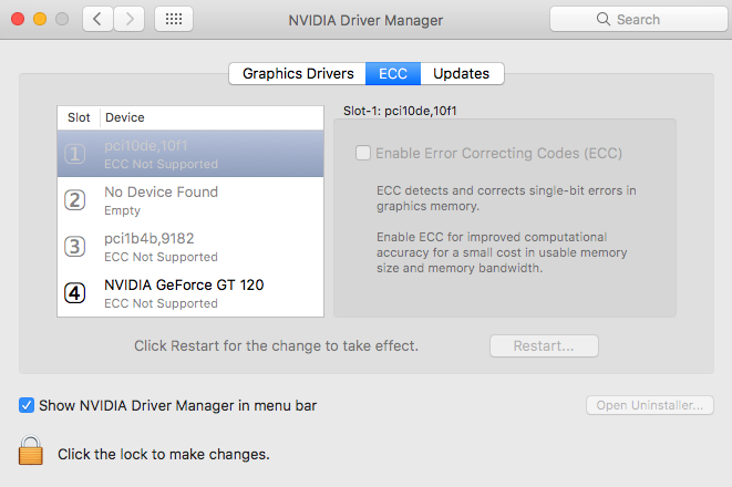

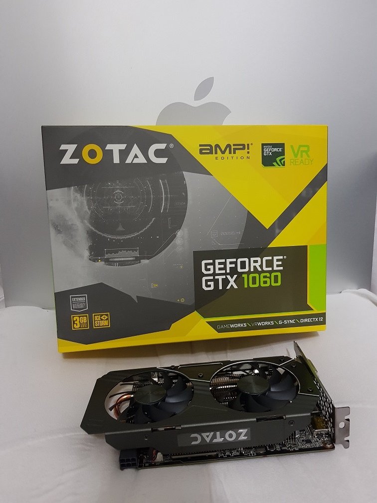

Updated to 10.12.6 and nVidia 378.05.05.25f01.pkg ... but nothing... my Zotac GTX1060 3gb not working... on system report say nVidia Chip Model :(
Anyone can assist me ? Have i to enable or disable something ?
This is what i have :

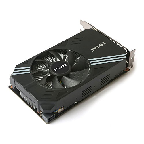

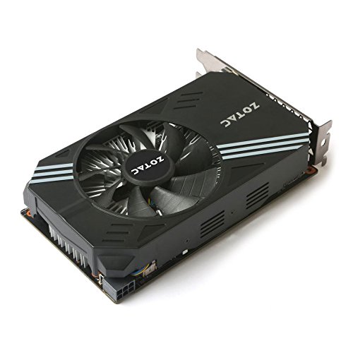

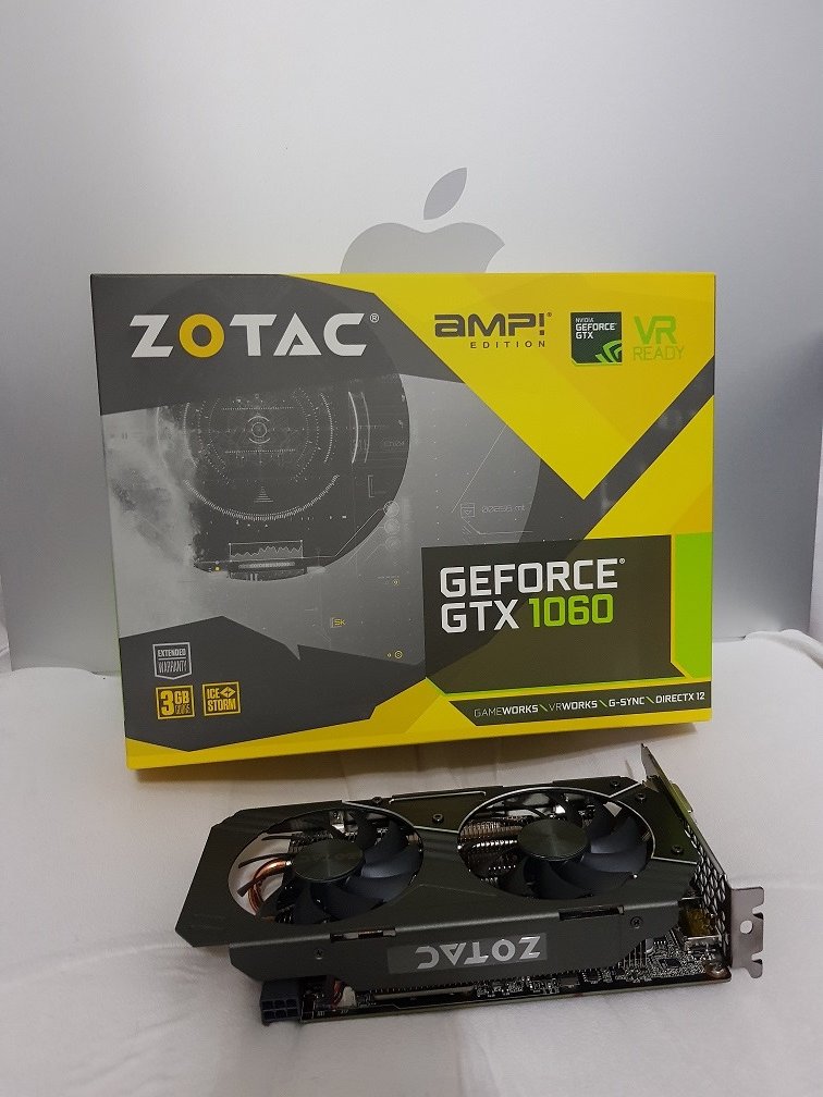

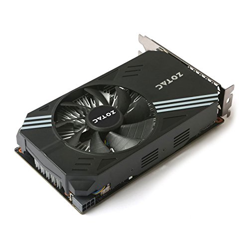

Saw your post at Netkas. For some reason your card isn't being recognized. As was asked above, is there a power connector on your card? If it's this card:
there is a six pin power connector on it.
Lou
^^^^And it's hooked up to mini six pin "A" on the MB with the proper mini 6 to 6 pin cable?
Lou
