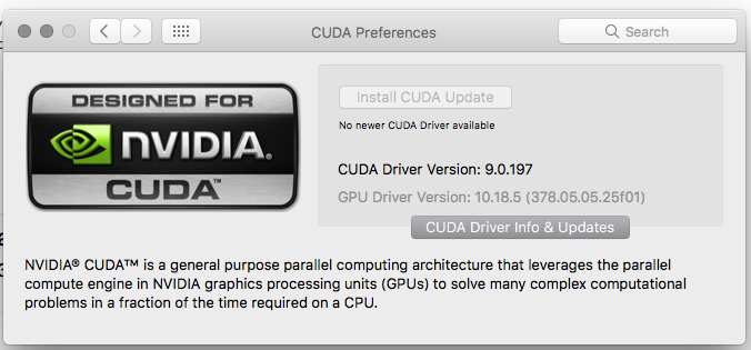

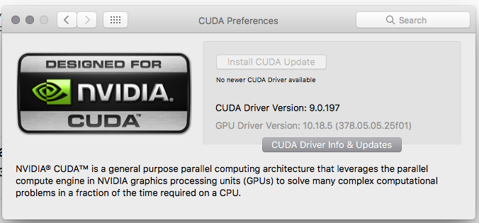

New Cuda Driver here:
https://developer.nvidia.com/cuda-downloads?target_os=MacOSX&target_arch=x86_64&target_version=1012
It says Cuda 9.0.176, but once installed Cuda says it's Cuda 9.0.197.

Well, we all know the Web Driver is now issued! BUT, Cuda 9.0.197, while it worked fine in Sierra, is a NO-GO in High Sierra. So, don't bother until a later one is issued.
Lou
Well, Cuda Driver, 9.0.197, is now on Nvidia's web site, still a NO-GO in High Sierra even though it's listed with the 10.13 Web Driver. In the text however, it's listed to work with 10.12.x. So, I expect another one soon - I HOPE!!!!!

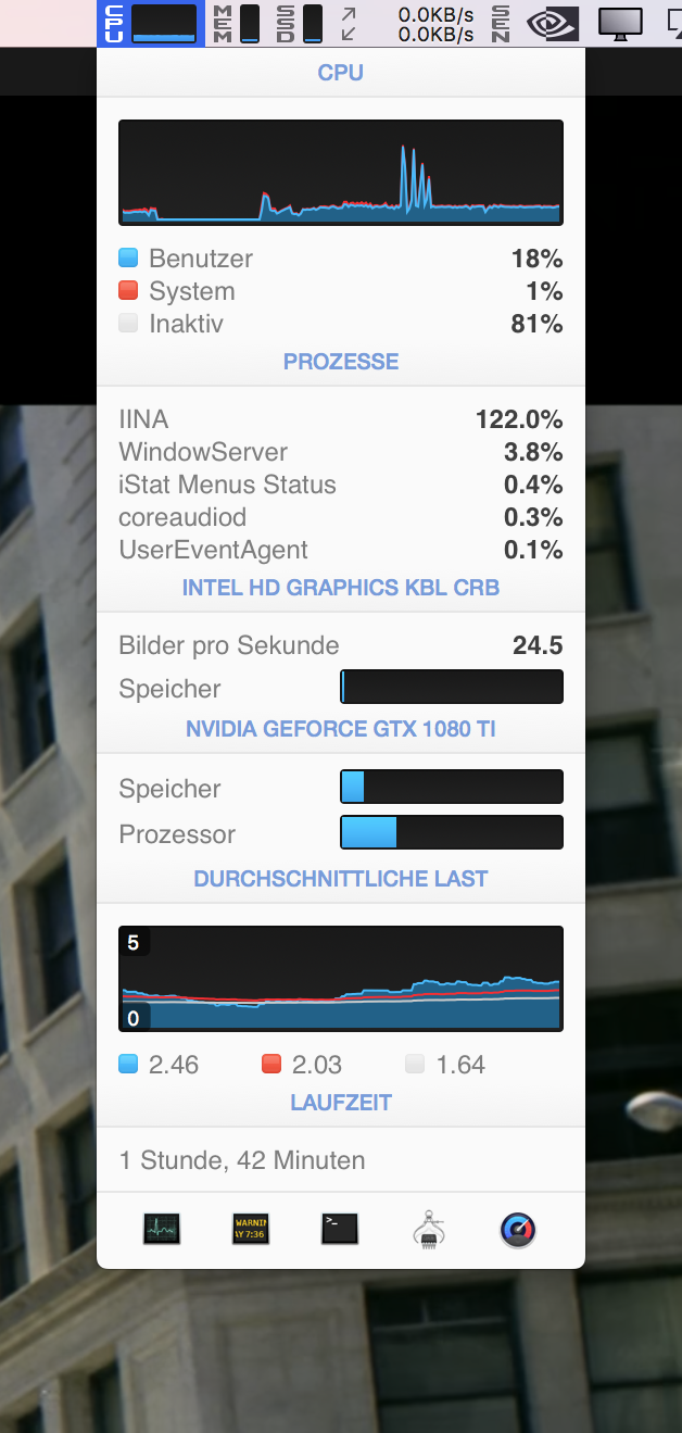

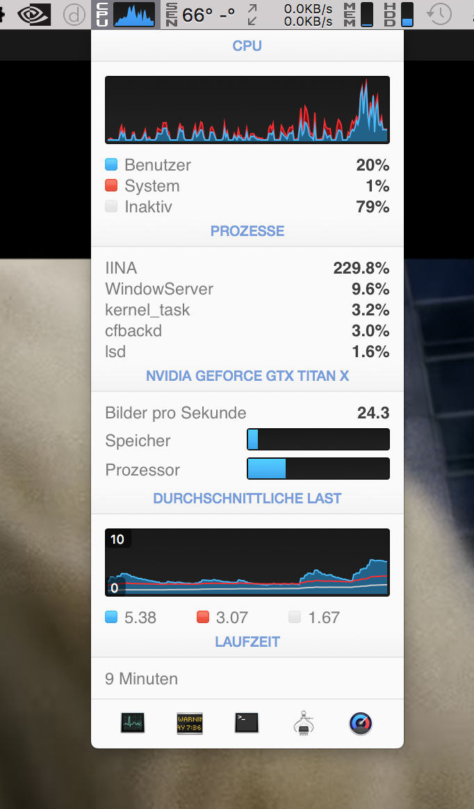

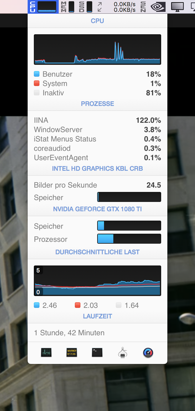

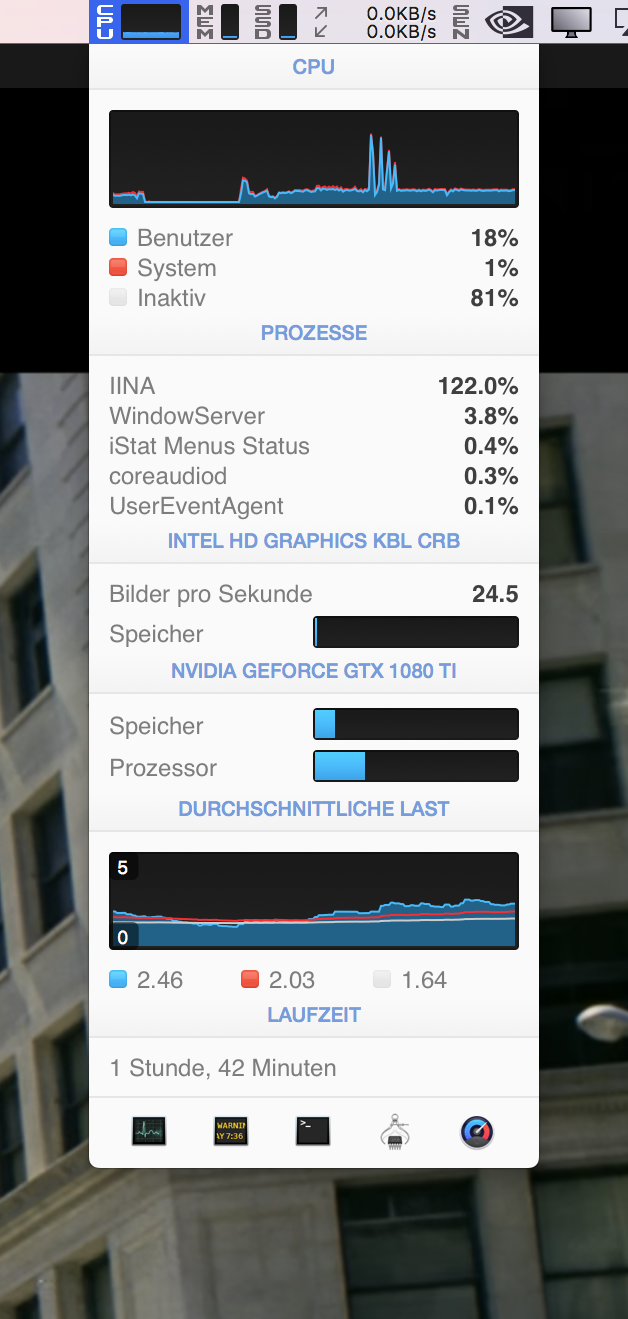

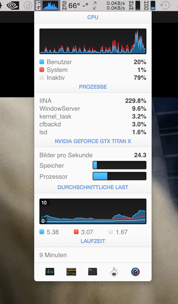

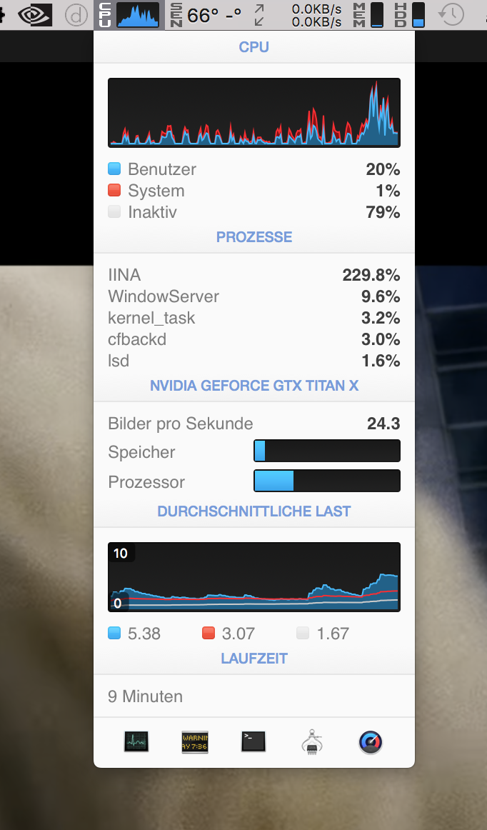

You are right. I misinterpreted the far lower CPU usage of my i7-7700K compared with my W3690 as hardware acceleration (macos 10.12.6).
Mac Pro with Maxwell card:
Hackintosh with Pascal card:
