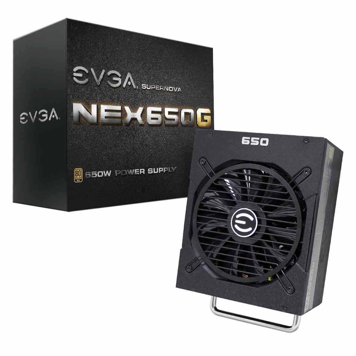

Here's my calculation:
PCIe graphics card slot #1 or #2 = 75Watt
PCIe mobo power connector #1 = 75Watt
PCIe mobo power connector #2 = 75Watt
Total MAXIMUM Watt drawn from the Mac Pro 5.1 MOBO wil be 225Watt!
Don't give this a trial-and-error!!!!!!!
What you CAN research is a way to hook the cards to an external power supply!
http://www.evga.com/Products/Product.aspx?pn=120-PG-0650-GR
Would love to see your end solution!
GL & Cheers!
I grabbed an FSP BoosterX 5, which is a 450W internal supplemental power supply that you can daisy-chain to the main power supply and thus not have to worry about them getting out of phase.

If you don't mind a little ugliness, you can use the same power supply but have some dangling wires and avoid the soldering.
If that is the guy who wanted no additional wires outside, he did a wonderful job acheiving that.
Yep, and this is what I did. Just a simple SATA to Molex adapter, and then the power cables run over the top of the hard drive bays to the graphics card. I was running that system with the side of the case off already, so it was a simple installation for me with no case mods required.
