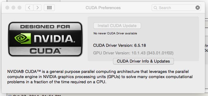

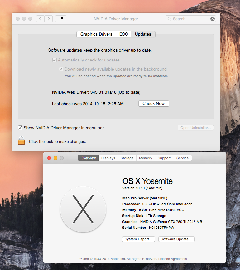

Everything is working now, might have been a loose connection or something. So yes I can confirm that the current Nvidia drivers support Maxwell Cards under OS X Yosemite. Thanks for all the help everyone.

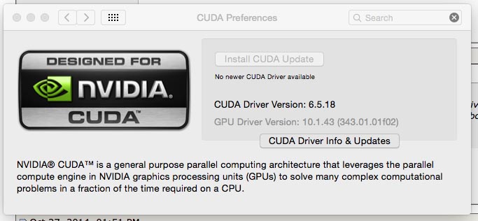

^^^^From what I've been reading, the only difference with this driver vs. the f01 drivers is that it fixed and removed the "Cuda Update Required" message that showed up on boot and when the Cuda CP was queried.
Lou
Lou
I have updated and it's still telling me that a Cuda update is required.
