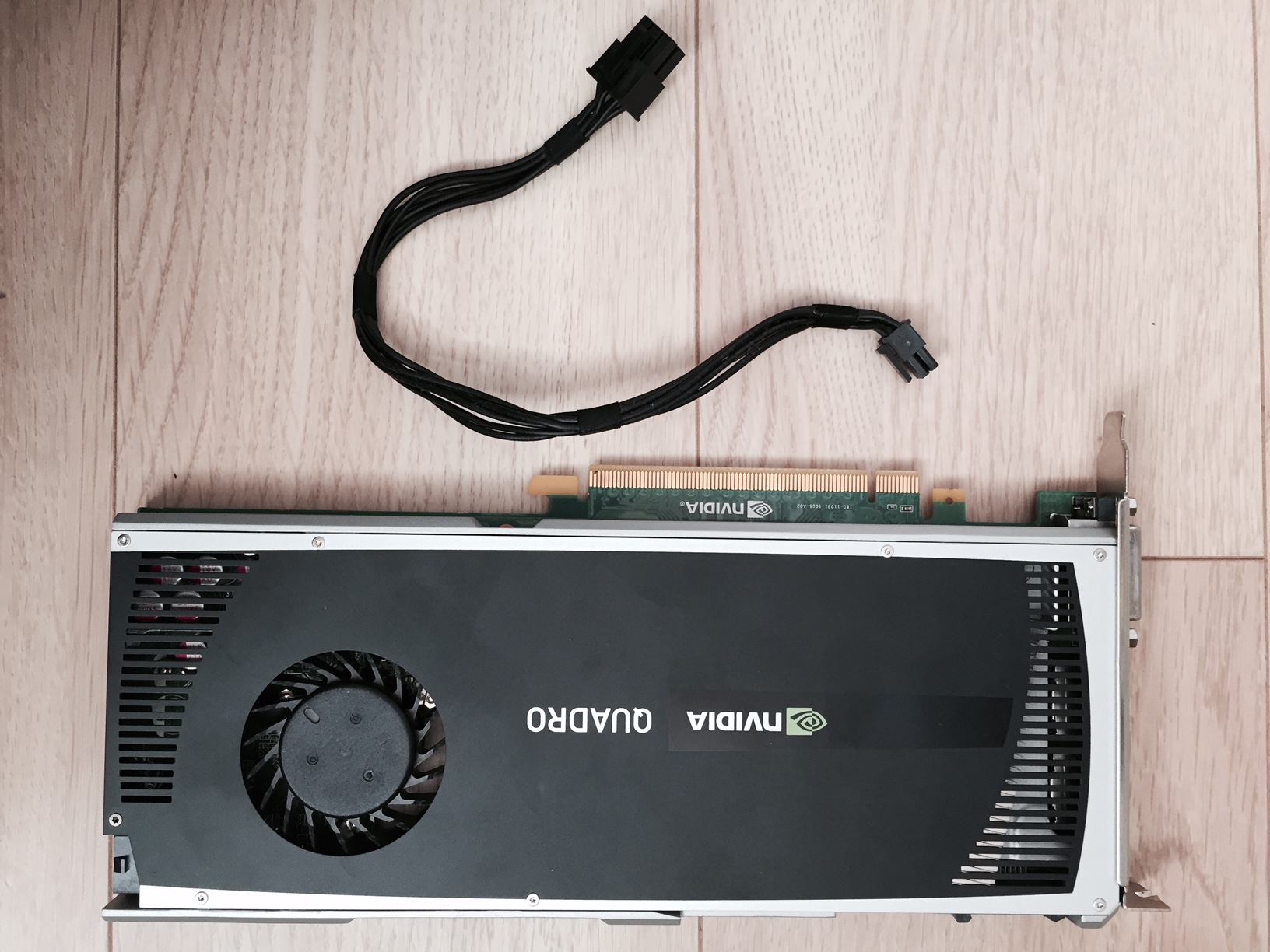

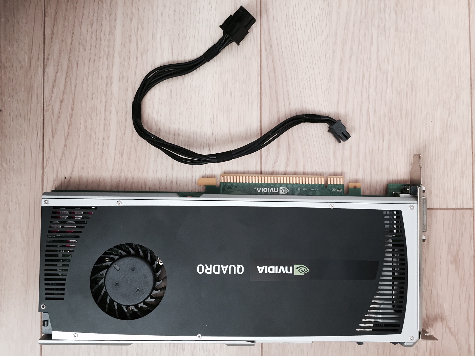

Hi again guys,
I am now at the install/set up step in my quest to use a PC (for Lenovo desktop) Quadro 4000 in my MacPro (5,1 mid2010).
I pre-installed the (I believe) appropriate Nvidia Mac driver for my Mavericks OS (OS X 10.9.5 [13F34]), which is listed in the Nvidia Driver Manager as the 334.01.03f01 version driver. (Though I didn’t install the separate[?] CUDA driver which I thought should be installed after getting the card working)

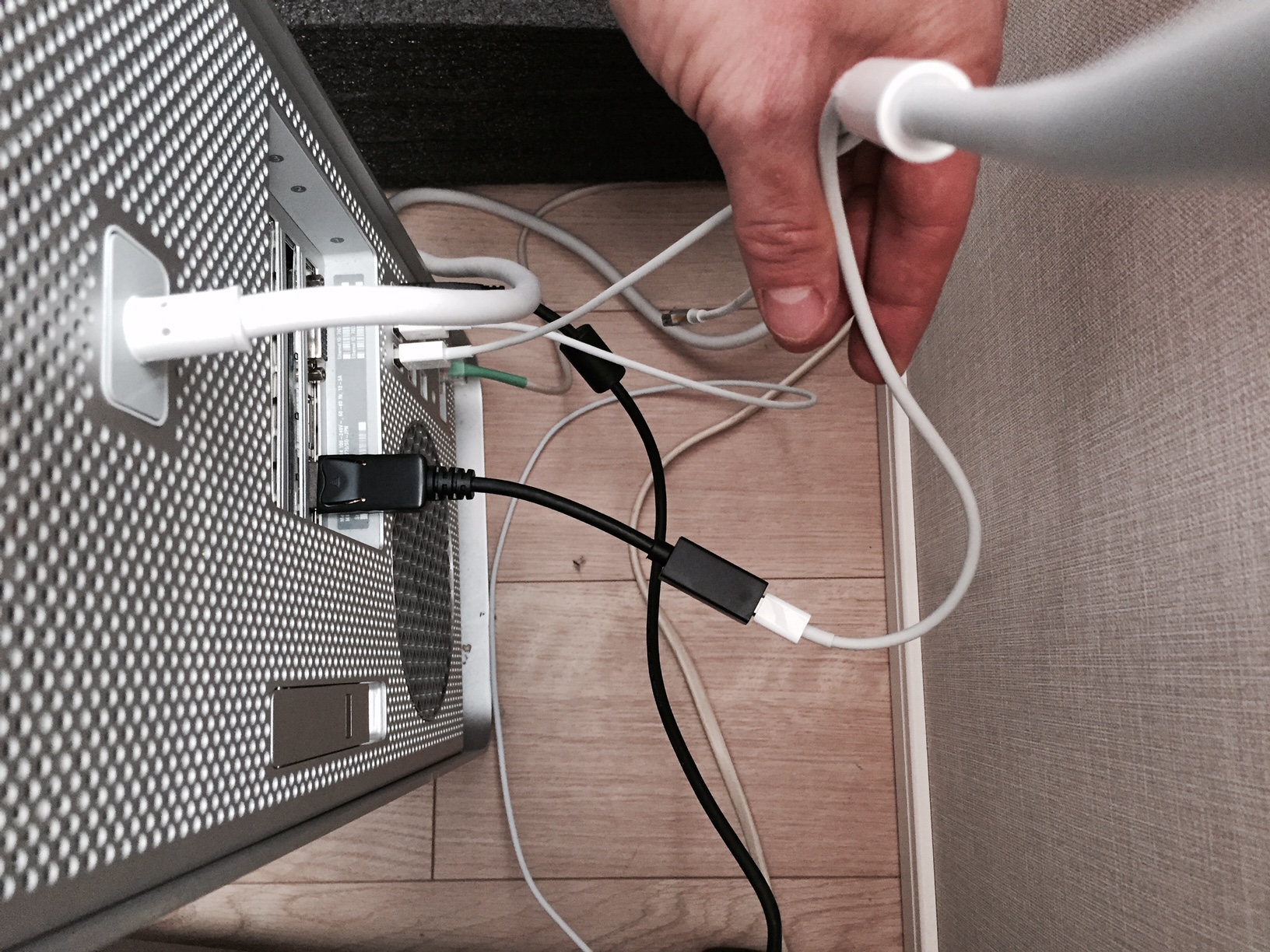

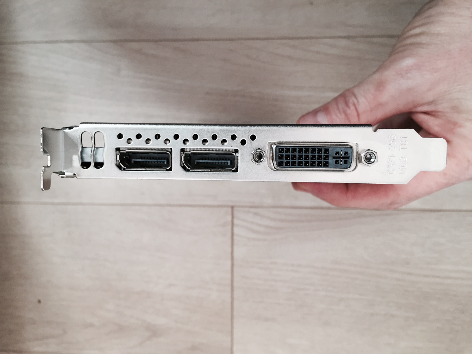

The Display Port (male) to Mini DisplayPort (female) adapter had finally arrived in the post, so I took out the current card, ATI Radeon HD 5770 1024 MB, and replaced it with the Quadro in Slot 1 (16x). I used the same power cable that the Radeon was using to connect the Quadro to the mother board into ‘aux power 2’ which is where it was plugged in for the Radeon.
I reconnected all the plugs : power, Mini Display Port, LAN cable, keyboard…..and powered up the MacPro but despite the Mac starting up the monitor just showed a black screen.

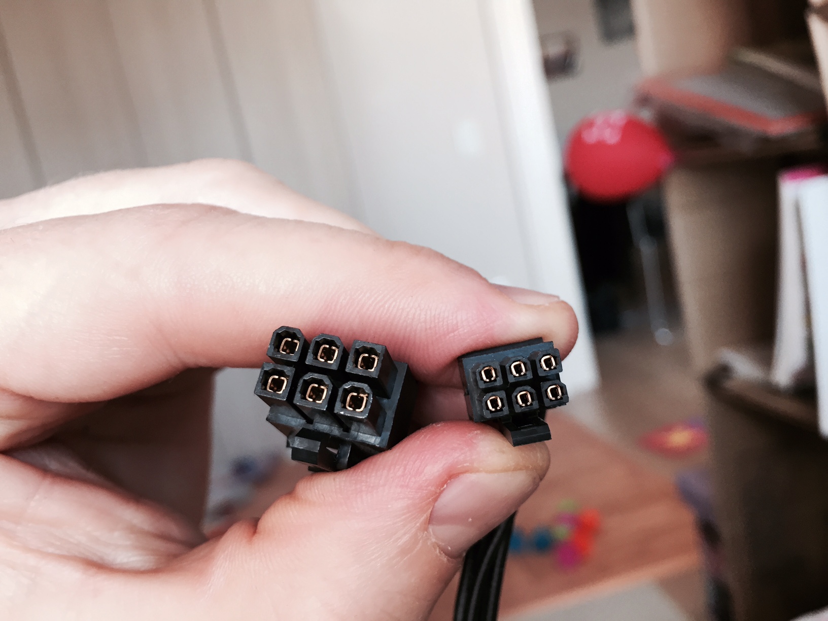

- The power cable I used from the Radeon isn’t compatible with this PC Quadro card? Though it plugs in fine. Not supplying enough power ?

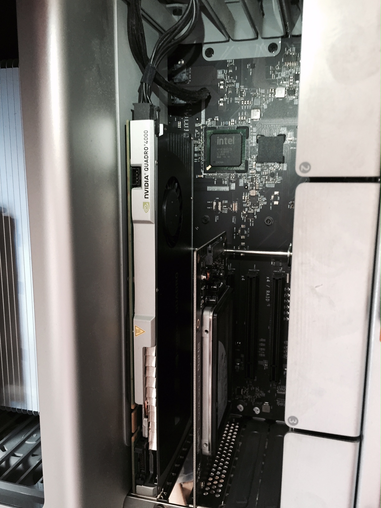

- Putting the Quadro in the first x16 slot is an issue ?
Hi again guys,
I reconnected all the plugs : power, Mini Display Port, LAN cable, keyboard…..and powered up the MacPro but despite the Mac starting up the monitors just showed a black screen.

That should work. Power cable is fine. The only slightly off thing is that Mac Q4000 has 1 DP and PC one had 2.
Did you try both ports?

I did try both Display Ports ..1 and 2. But this was after booting up plugged into one with a black screen...I switched to the other port. Would I need to actually boot in each Display Port to properly test this?

If you didn't install Trim Enabler then your kexts will be fine. Try moving the SSD to the 4x slot, there's more than enough bandwidth there. Or even remove it until you sort out the video.
Do you mean to move the SSD to the 4x slot and then move the Quadro to slot 2 (16x).....or to just leave it where it is in Slot 1 (16x). Sorry, if I'm asking things which seem obvious....I'm a total noob.
I was just trying to see what would happen if your configuration was the same as mine and checking if you have power draw issues. Keep Quadro in the first 16x slot. Move the SSD to the last 4x slot or remove it from the system. I wish you had Boot Camp installed to check things from Windows' end.
