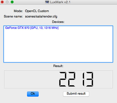

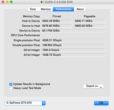

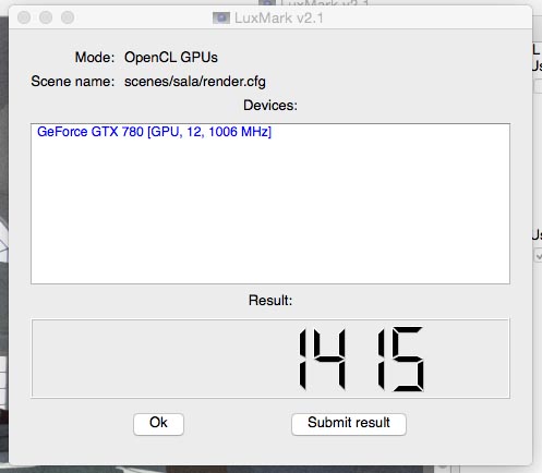

So now I can report on improved performance with my GTX980 under OS X 10.10.1 using all the new drivers. As was reported above, Adobe FX still can't recognize the CUDA drivers. Also, I realized that I was using the old version of CUDA-Z. Now running beta version 0.9.230, it's reporting good performance (see below). I also saw a modest improvement in Heaven at 1080p, increasing from 44.8 fps to 45.7 fps. I also saw minor improvements in Luxmark, with the Sala test increasing from 2197 to 2213 (see below). Finally, Furmark scores nicely increased, with 1080p performance running with aa off increasing from 3684 to 3958.
I think I realized it before you, see my post on the previous page. Open CL seems to have a big jump over my GTX 780.
Lou

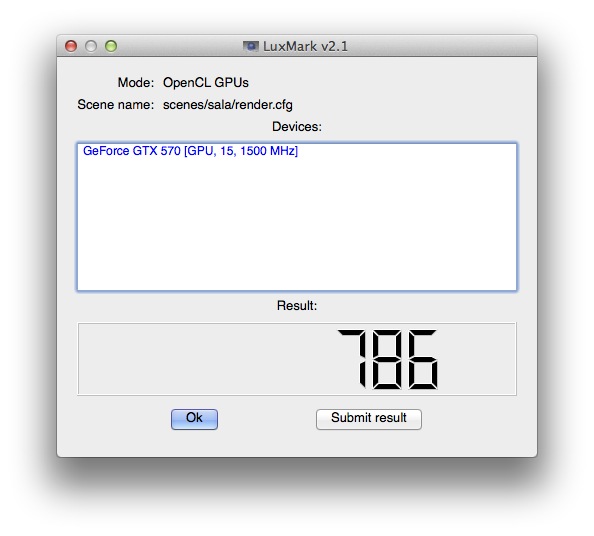

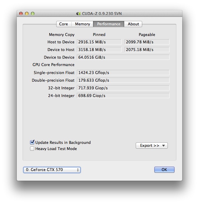

By way of comparison I just tested my GTX570 & it gives me 786 on LuxMark (35% of GTX970) but interestingly while most CUDA scores are lower the Double-precision Float is about 179Gflop/s which is 29% faster than the GTX970.

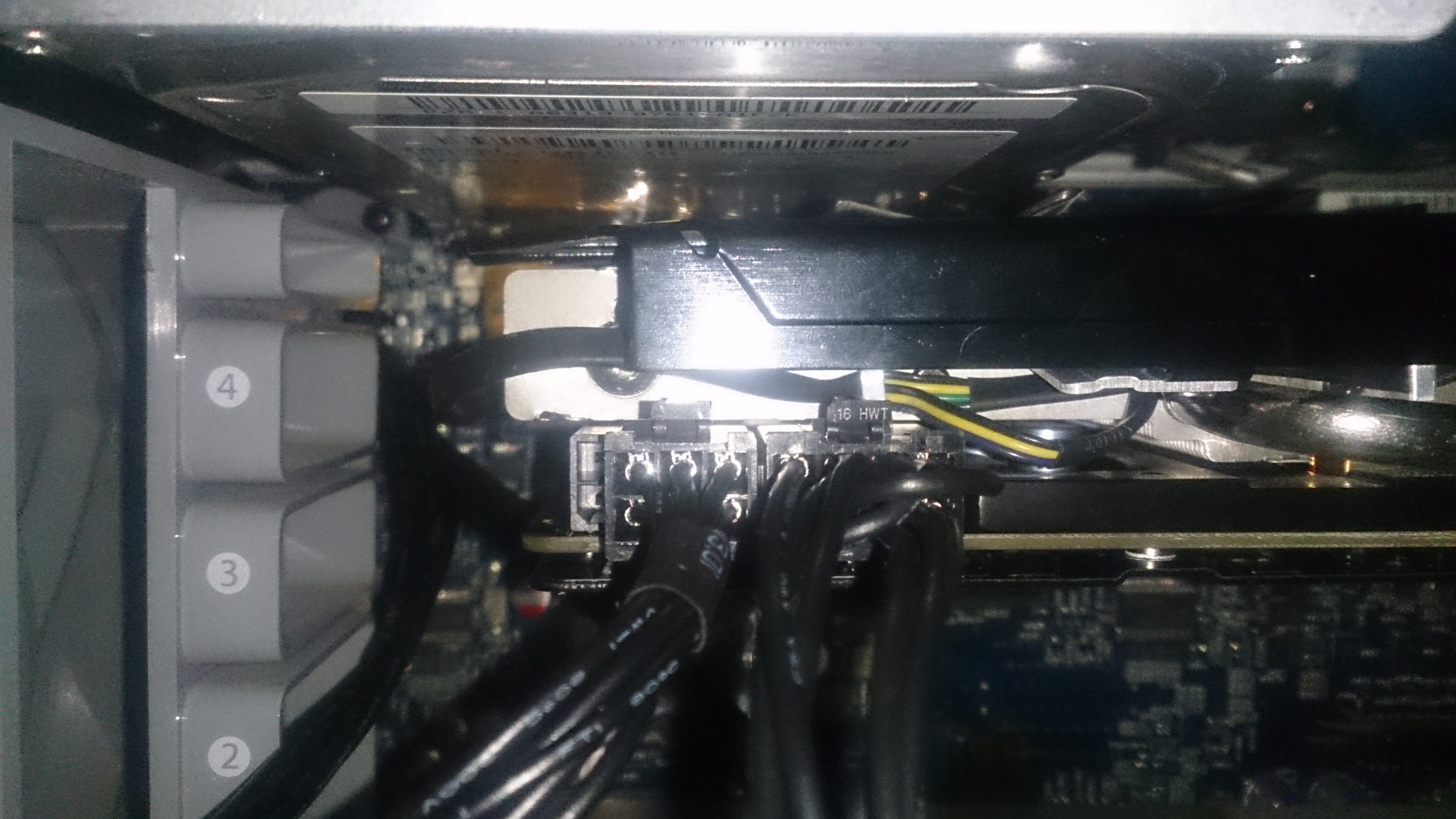

^^^^Two of the pins on the Card need to be shorted. See Photo of my card to see how 6 pin cable is plugged into 8 pin plug, top two pins are shorted to the second set. or you could use a 6 pint to 8 pin adapter.
Lou
So, I ordered an 6pin to 8 pin adapter. Used the 6 to 6 pin cable in the other slot. I was guessing I'd only need the one 8-pin cable.
When I turned the computer on, I get the same message "Please power down and plug in PCie cables". Surely an 8 pin and a 6 pin connector would be enough?
Or do I need another 6 to 8 pin cable ?
Also, how do I know I don't have a fault on the power connector on the motherboard. The second connector came loose when I took out the cable. I plugged it back into place, and it seemed secure, but I wonder if I have damaged it.
As an alternative, I heard about using power from the DVD drive using a molex adapter. Is this worth trying?

OK, let's think about this.
Here are the facts:
1. You haven't populated all of the power pins.
2. Your computer tells you that you haven't plugged in all of the power.
OK, what was your question again?

Haha I'm not very good at this, am I!!
I'll order another cable.
thanks for fast response.

Like with molex connectors the PCIe plugs have these pressed metal connectors inside the holes. Unlike molex which you can clearly see with these types you have to unplug the cable itself and use a small spike, flashlight and possibly a magnifier to check you've broken the insides or not. Hopefully it's the cable itself, the logic board will need a new connector re soldered on and that will cost a lot more than the cable.
I would suggest you buy another or even a second to replace that possibly dodgy one.
