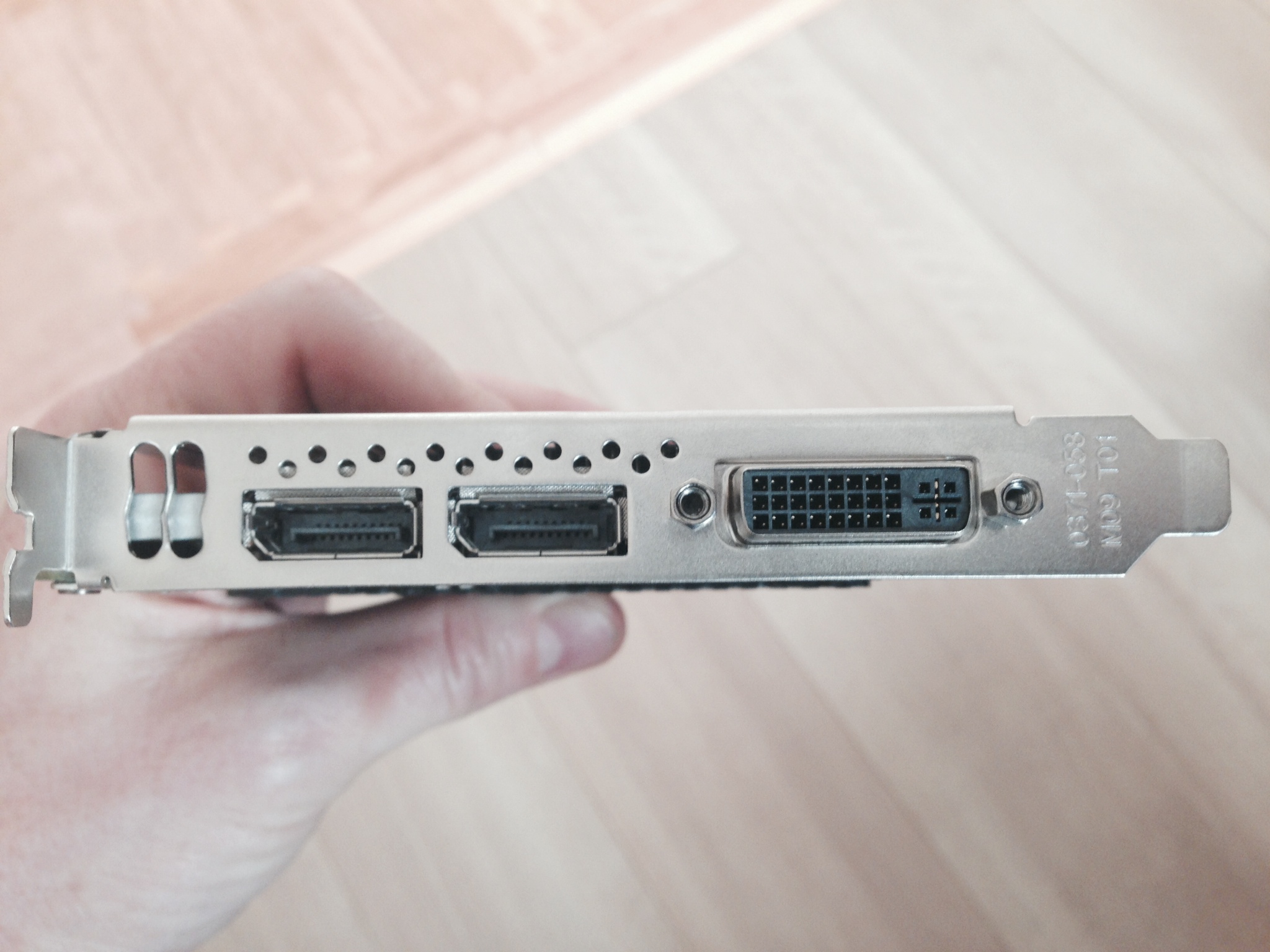

How did you have that connected to 7300GT?
If it is TB, you can't.
If it is MDP, you need a DP to MDP adapter. Startech has a nice one for $7 (US)
The Quadro will work if you are on 10.7.5. As you are on a 1,1 flashing ti would be pointless, so you could leave 7300GT in for boot screens.

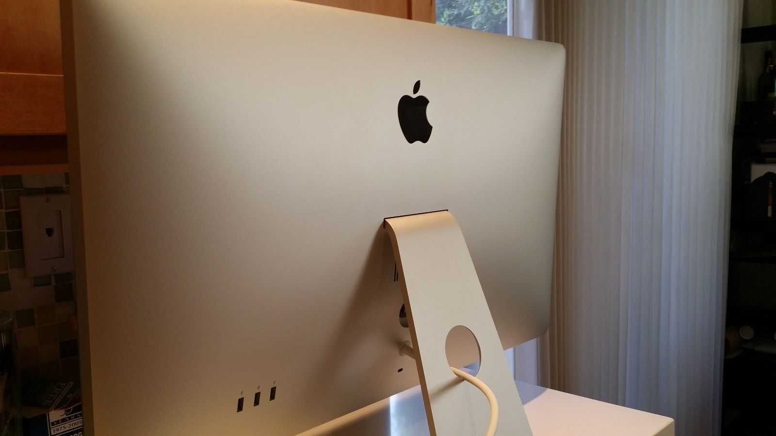

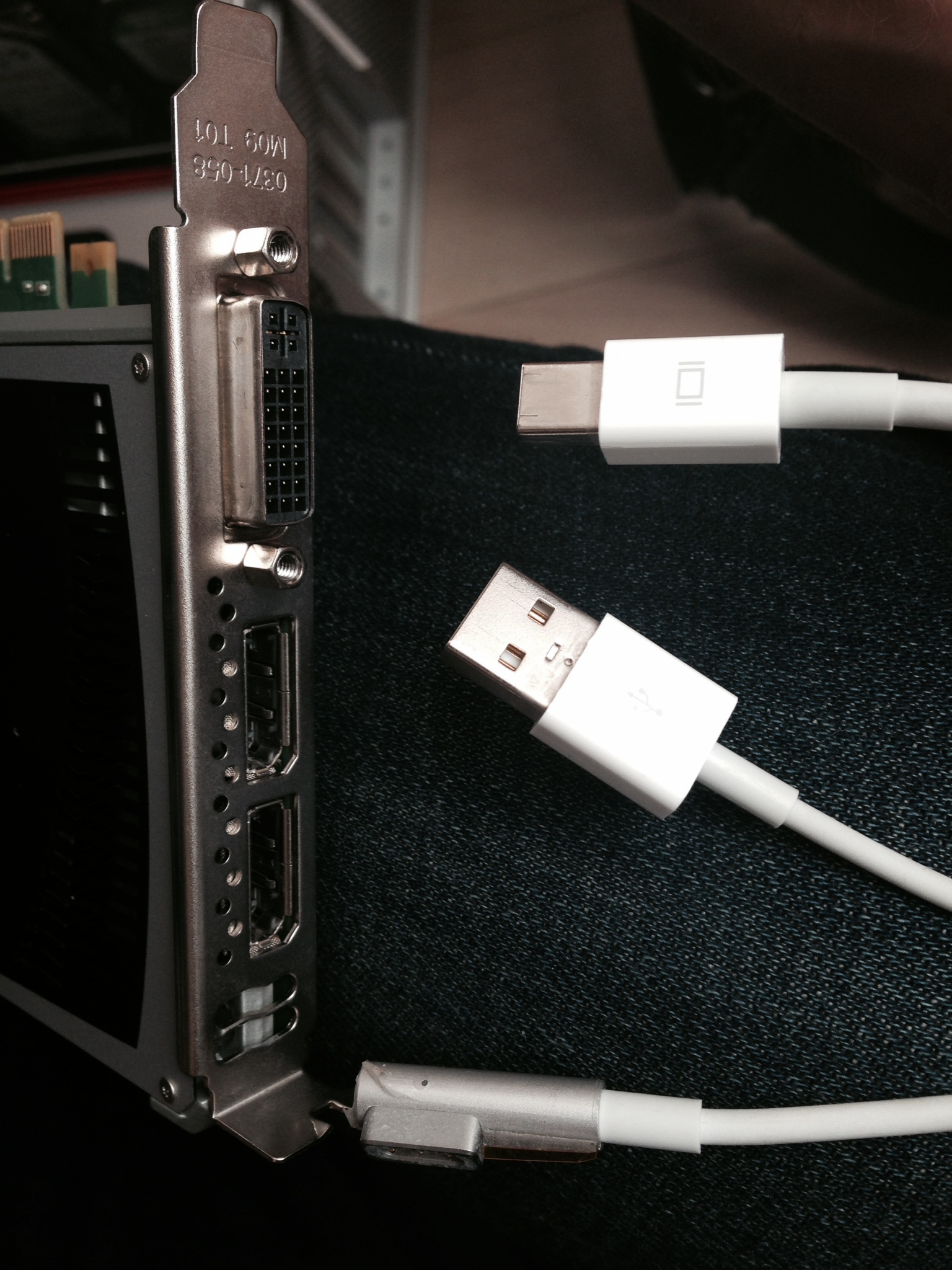

The top cable is a Mini Display Port cable.
The middle cable is a USB cable.
The Bottom cable is the MagSafe cable.
To use the card you'll need a Display Port to Mini Display Port cable like this:
http://www.monoprice.com/Search/Index?keyword=mdp+to+dp
The USB cable plugs into a USB Port on your Mac to activate the additional USB ports on the monitor. If you don't need additional ports, the cable doesn't have to be used.
The MagSafe Cable is only needed if you wish to charge a Mac laptop with a MagSafe connection from your Apple display. As with the USB cable, this cable doesn't need to be connected.
The only cable you'll need to get power from the Nvidia Card to the Apple Display is the Mini Display Port to Display Port Cable.

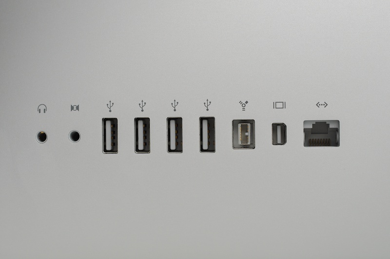

When did Apple Displays have Female MDP ports?
I have a 24" and a 27", both only have the cables he pictured. In true Apple fashion, there are no other options.
^^^^I have never owned an Apple Display, but I have never seen any display with a male video port. Is the pict I attached not a female MDP port?
Lou
Lou
Picture is from an iMac.
Or maybe a TB display, I don't know.
Certainly not a MDP Apple display.
They connect one way and one way only, a male MDP cable, as pictured by the guy asking.

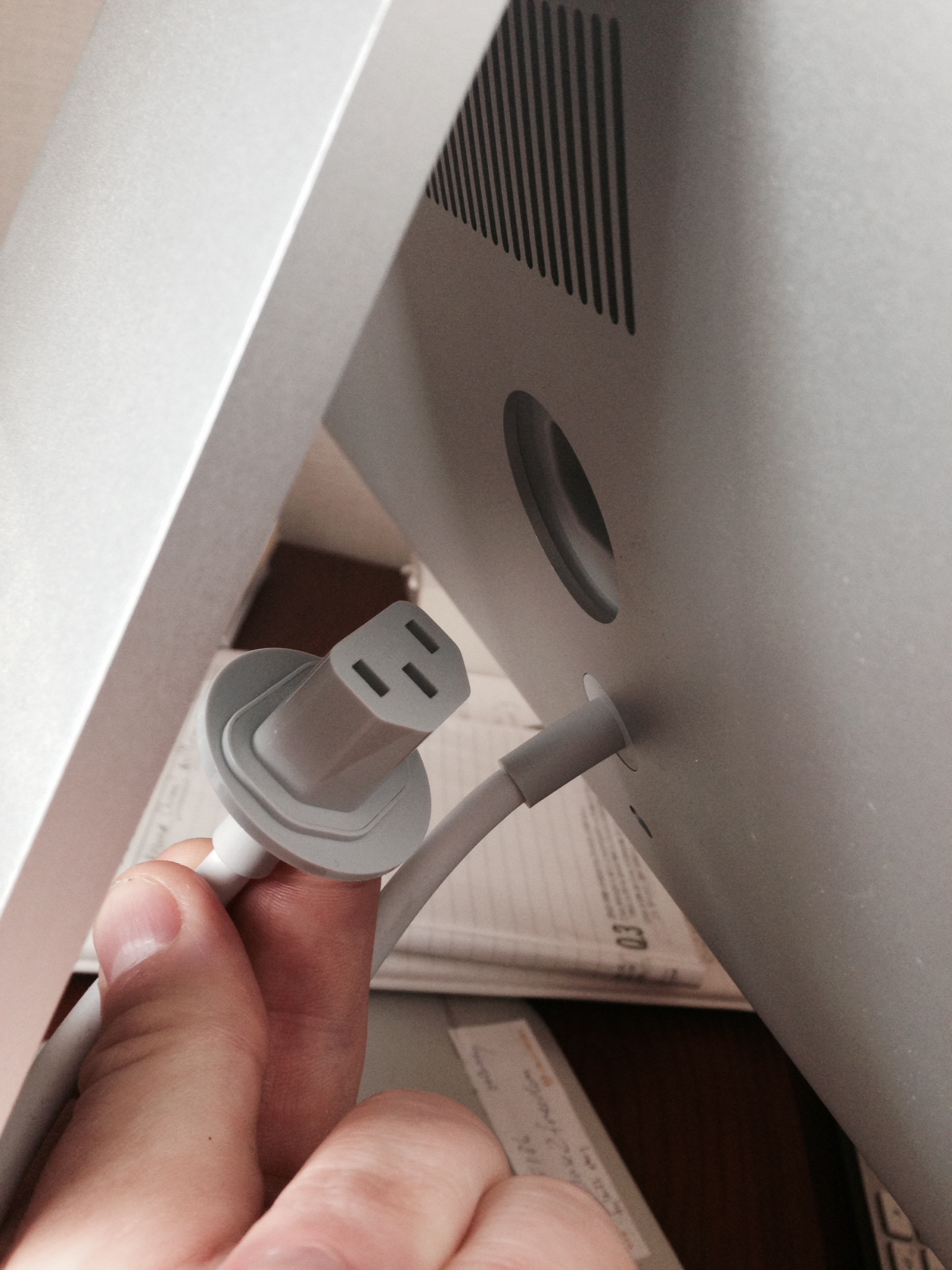

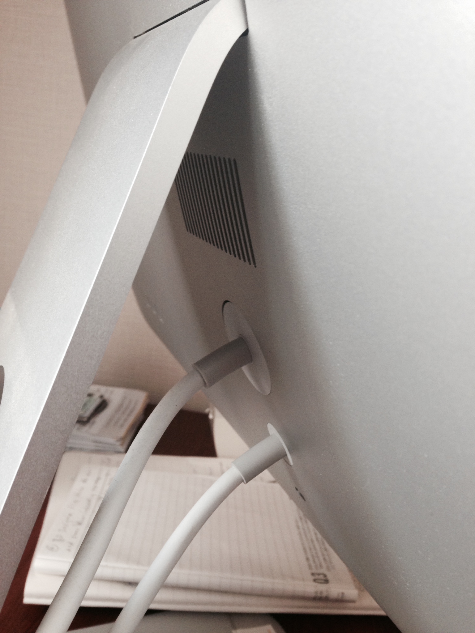

unfortunately. I can unplug the power cable from the back (see pics) but the Mini DisplayPort just doesn't come out....I gave it a good try.
You should change unfortunately to fortunately, cause that cable is not meant to be disconnected. ONLY the power cable can be disconnected. If you had pulled it out and ripped a cable, you had some soldering to do.

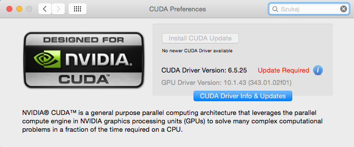

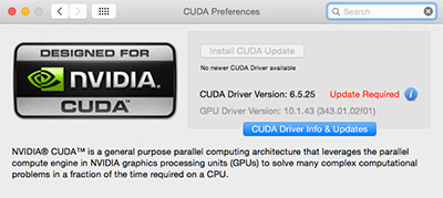

Hello!
Short report:
VGA: GTX 970
OSX: Yosemite 10.10.1
nv web driver: WebDriver-343.01.02f01.pkg
CUDA driver: cudadriver-6.5.25-macos.dmg
and…
CUDA works in Adobe Premiere CC2014!

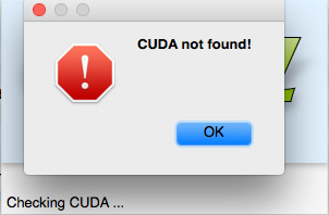

^^^^^^^ Great news. I can verify this with my GTX970, although CUDA-Z still has problems, as does Nvidia CUDA Preferences. See below. I'm now going to try out several of my benchmarks and report any improvements that may be seen - or not!

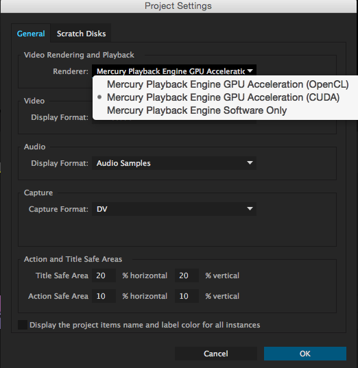

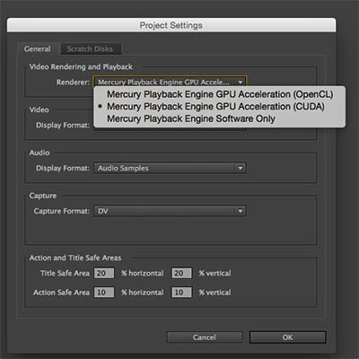

It's a bit different on my side.
I see this:
but CUDA-Z looks good.
After setting Mercury to use CUDA I see huge speed improvement playing and rendering timeline :)
It's about 5x faster then old ati 5770 running OpenCL.
Bottom line: AfterFX, no go. Errors after enabling CUDA renderer.
