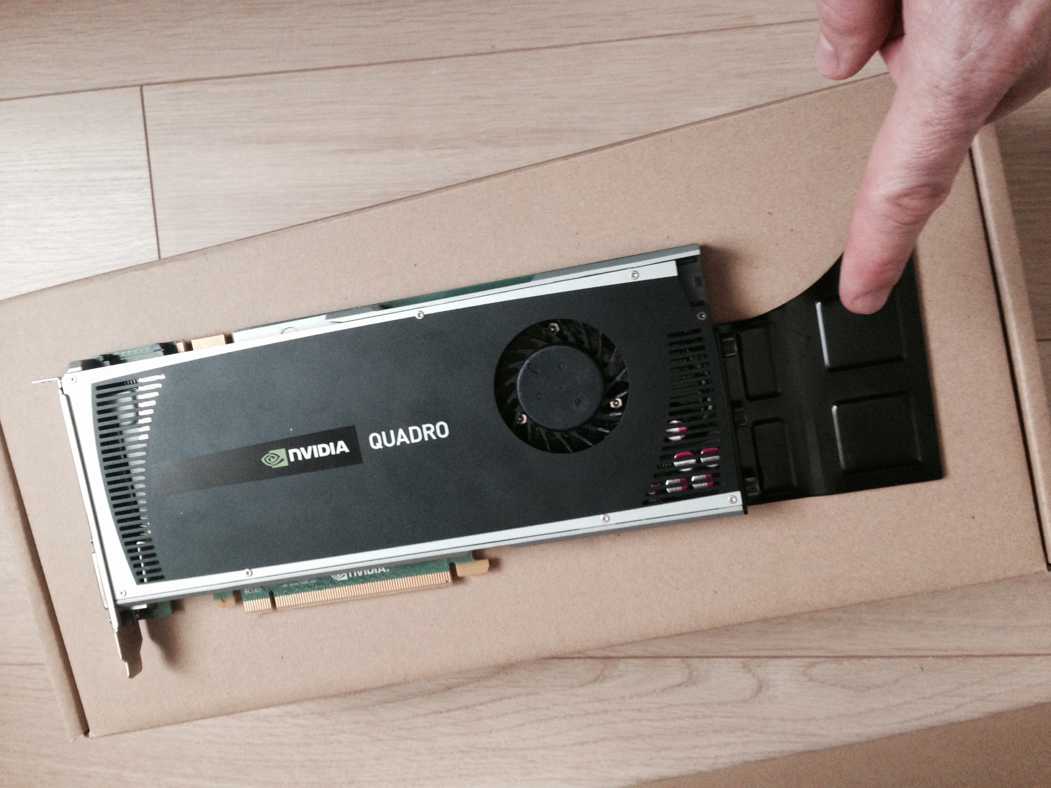

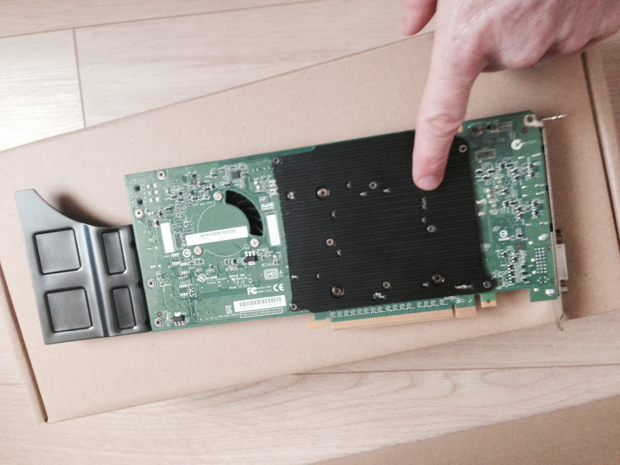

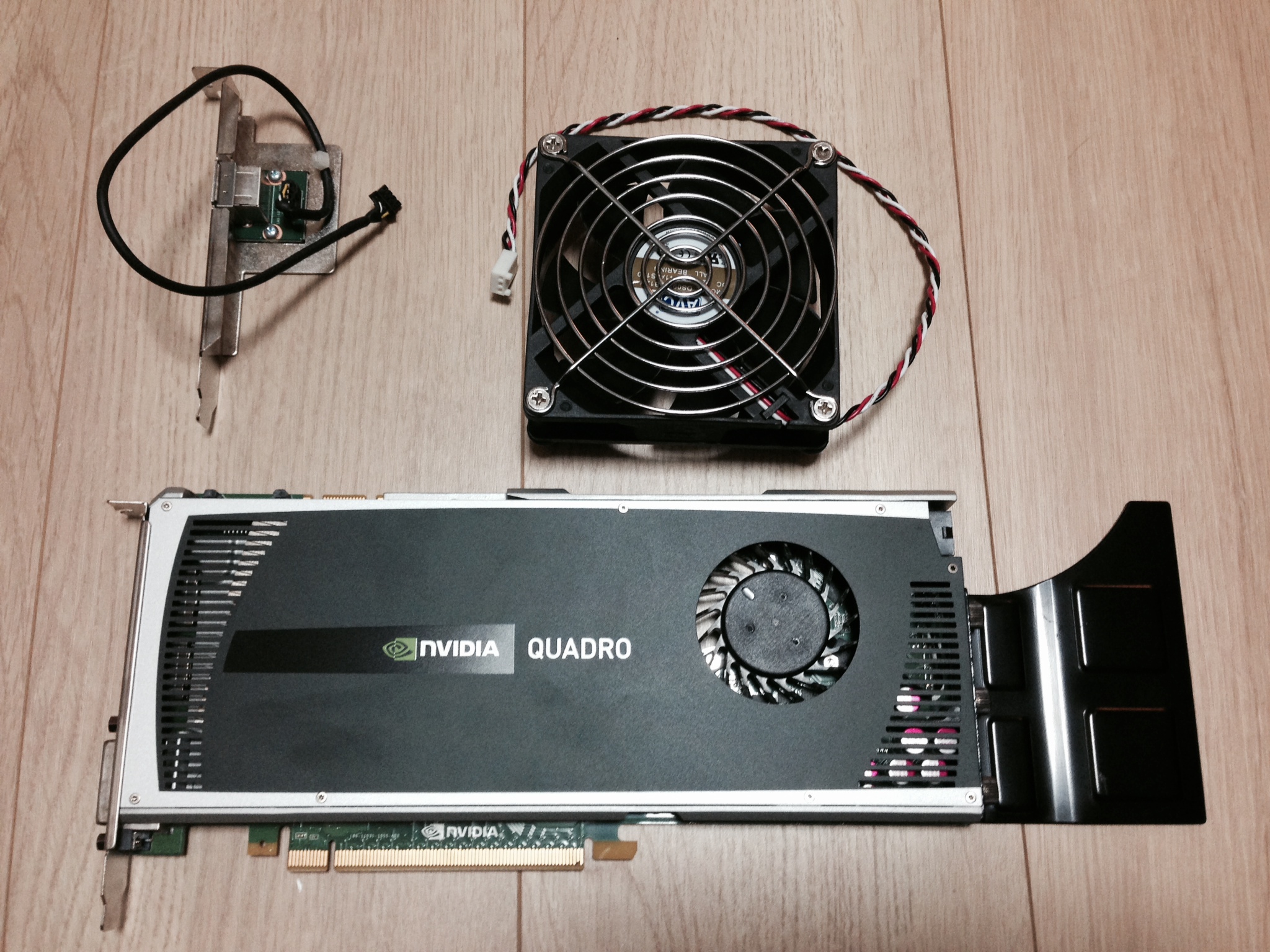

Can a PC Quadro 4000 for Lenovo can be installed into 5.1 mid2010 MacPro?
I bought a PC Quadro 4000 for a Lenovo desktop secondhand hoping to install it into 5.1 mid2010 MacPro? I assume no special chip or flashing modification are necessary for my situation.
But it has extra bits and pieces, some attacked to it, that I really don't know what they are and if they need to be removed in order to install this into my MacPro.
I am attaching a photo of the card, the separate fan and some extra bracket that came with it. I hope someone can explain how to install it.
I have already downloaded and installed the driver for the Mavericks OS just in case that was necessary.

Your Mac Pro came with an AMD 5770, and that utilizes a 6 pin power cable that should work with the K4000.
For that card to fit, that rear piece will ned to be removed. It should work, Nvidia's Web Drivers support the K4000. However, of course, no boot screen.

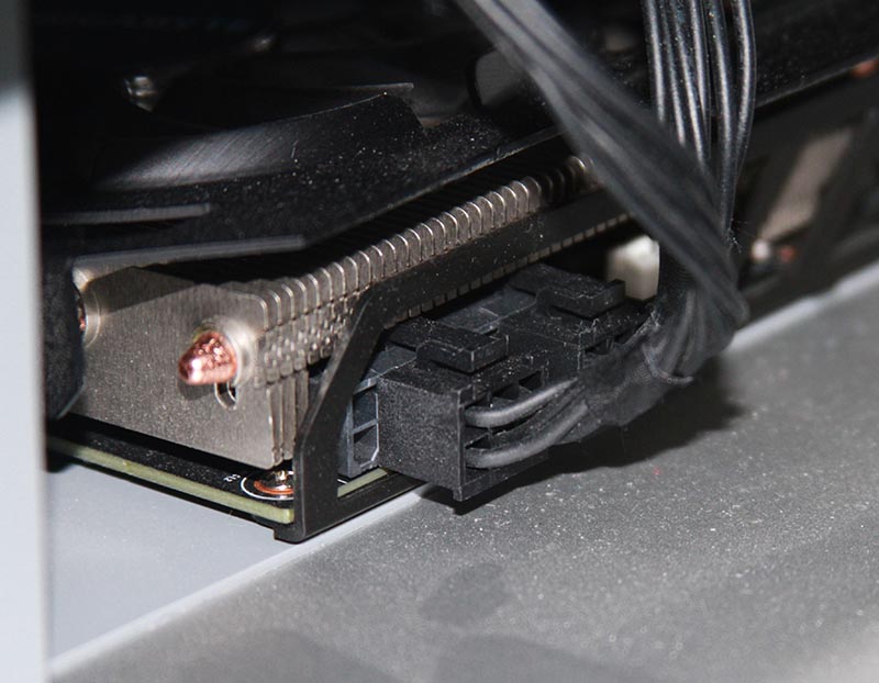

^^^^Two of the pins on the Card need to be shorted. See Photo of my card to see how 6 pin cable is plugged into 8 pin plug, top two pins are shorted to the second set. or you could use a 6 pint to 8 pin adapter.
Lou

Yeah, 680s are funny. Some will run fine with 6 in 8 socket, looks like you found one that won't.
A standard 6 to 8 adapter should trick the sense pin.
Did you get one with card? The ones they ship only work one way. (If it has yellow, black, and brown wires, use side without brown)
Lou
Thanks for the reply, Lou. Very much appreciated. When you say 'the rear piece has to be removed' I assume you mean the black extension in pic 1, not the heatsink(?) in pic 2, yes?
One other question which is really worrying me is if I install the card and boot the Mac and it doesn't work, what will happen and how do I get out of the situation? I simply can turn off the Mac and put the original AMD 5770 card back in? Mightn't be hard at all, I just can't afford to screw up my Mac for any period of time. Thanks in advance for your help.
