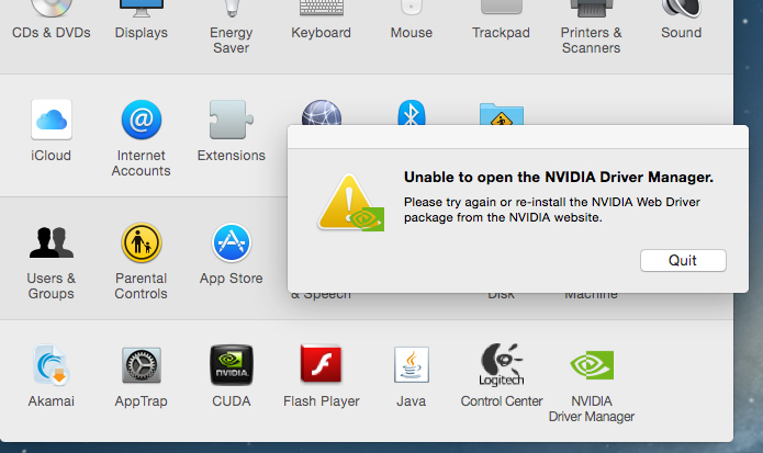

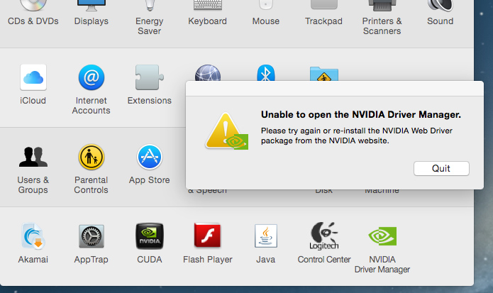

Can't start or remove Nvidia Drive Manager
The Nvidia Driver Manager will not open. I have re-installed the latest drivers (10 times) but the result is the same. Even tried to install older drivers- NO GO. SEE Screen Image.
I can’t open the Driver Manager to remove to run official uninstall. What ever is preventing it from running is in the system and untouchable. Any suggestions would be helpful. If necessary I will wait until NVIDIA updates their Drive Manager again to see if that will solve the issue. In the mean time my MAC PRO is running fine just not using NVIDA drivers.
NOTES
1. The CUDA preference pane will open.
2. Photoshop is showing that "Detected Graphics Processor” Open GL
3. Ran Disk Utilities from Single user and also ran FSCK.
4. Removed the SSD from the Velocity and connected it to the mother board directly and ran utilities and tried to re-install NVIDIA. No luck.
5. I may have to reformat and start over.
Bob
Mac Pro, MacPro5,1, 6-Core Intel Xeon, 3.33 GHz, Memory: 32 GB
MAC OS version 10.10.2 (14C1514)
GPU - NVIDIA GeForce GTX 680 2048 MB
System is on Samsung 1TB SSD connected to Velocity Solo X2
Erased and installed new system
Gave up and Erased my SSD drive and reinstalled OS 10.10.2. Then rebuilt from time machine. I had to remove the SSD from the Velocity Solo X2 PCI card.
Trying to reinstall Nvidia Driver Manager and I now get a message that I need to update my MAC OS 10.10.2 to a newer system before installing (WebDriver-343.02.02f04).
Not having any luck with this. But the Mac Pro is running fine for now.

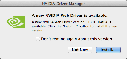

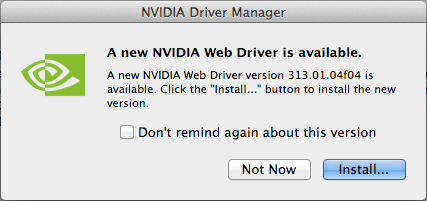

Web Driver 313.01.04f04 for OS X Mountain Lion available through the Nvidia control panel.
Web Driver 334.01.03f03 for OS X Mavericks available through the Nvidia control panel.
