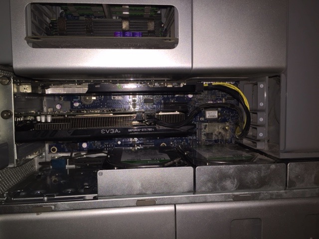

How are you powering the card?
Each card (the 750TI and the 8800GT) has a single 6-pin power socket with 6-pin power cable going to the motherboard. When I had the 5870 in the machine, both of these cables went into the 5870.
Attached is a picture of the two cards in my chassis with the yellow+black cable going to the 8800GT and the all black cable going to the 750TI. When running with just the 750TI, I use the all black cable while the yellow+black cable remains unplugged. The yellow+black cable is not long enough to use in the 750TI since its power socket is on the "top" of the card rather than the "back."
I have no issues using the 750TI even under heavy load in OS X as long as the 8800GT is in the machine (not even a monitor connected to the 8800GT). This suggests to me there isn't a power issue for the 750TI, especially since I can power both cards seemingly without issue.
With only the 750TI in the machine, it won't boot to the desktop. I hear the chime, attempt to login at the black screen, but I don't get any feedback from the system that the login was successful (usually I see my mouse's LED flash when I login successfully at the black screen with 750TI+8800GT or with the old 5870). I've tried to remote login to the machine but cannot get a connection; I assume the network connection is available at this point if it's not booting successfully.
In the attached picture I'm running the 750TI in the slot 3 and the 8800GT in slot 1. I've tried the reverse and get the same results. I've tried only the 750TI in both slot 1 and slot 3 with the same results.
attempt to login at the black screen, but I don't get any feedback from the system that the login was successful (usually I see my mouse's LED flash when I login successfully at the black screen with 750TI+8800GT or with the old 5870). I've tried to remote login to the machine but cannot get a connection; I assume the network connection is available at this point if it's not booting successfully..
I'm almost positive that your machine isn't making it to the login screen. I just tested on my 970 & Mac Pro 1,1 and while I don't get the initial boot screen (as expected), I do get video on the login screen fine.
Here are some things I would try:
1. Enable auto login
2. Check sudo nvram boot-args to make sure you don't have something weird in there.
3. Check to see if you are getting video on either the HDMI or DP ports on the 750ti
4. Triple check that the card is seated properly when installed in slot 1 and all power connections are secure.
5. Be patient during boot
If none of that solved it I would install a fresh copy of 10.10.3 & nvidia web drivers to a spare drive and see if it boots to rule out software problems
