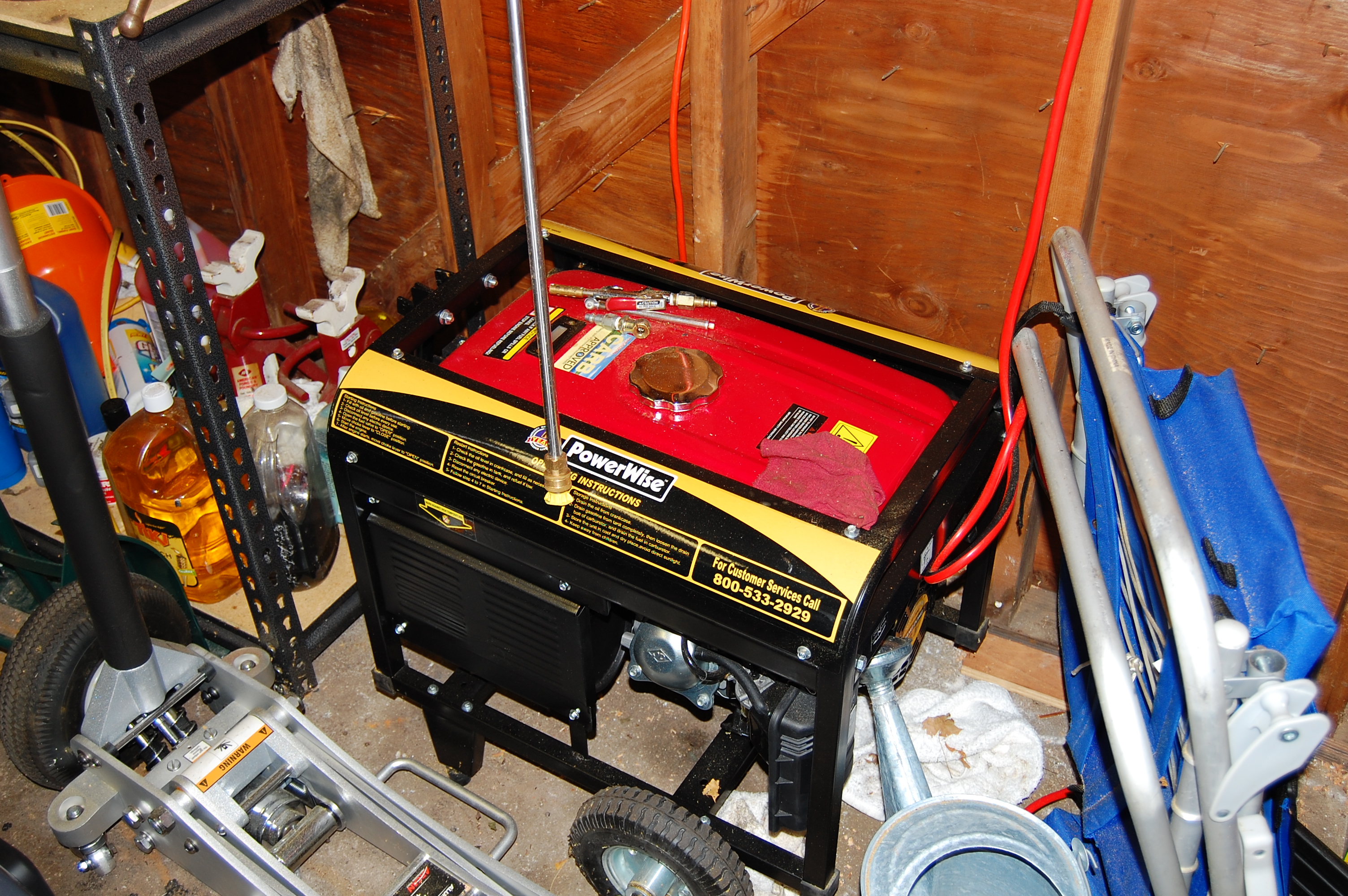

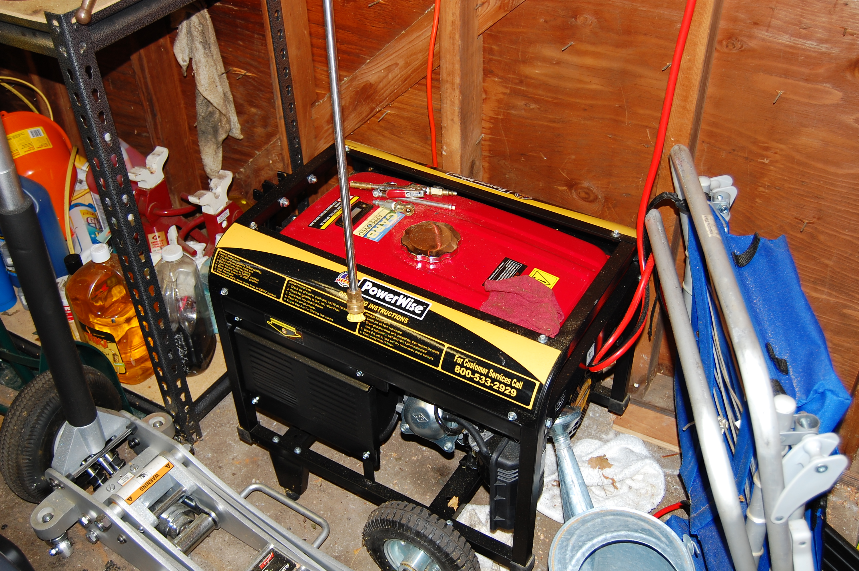

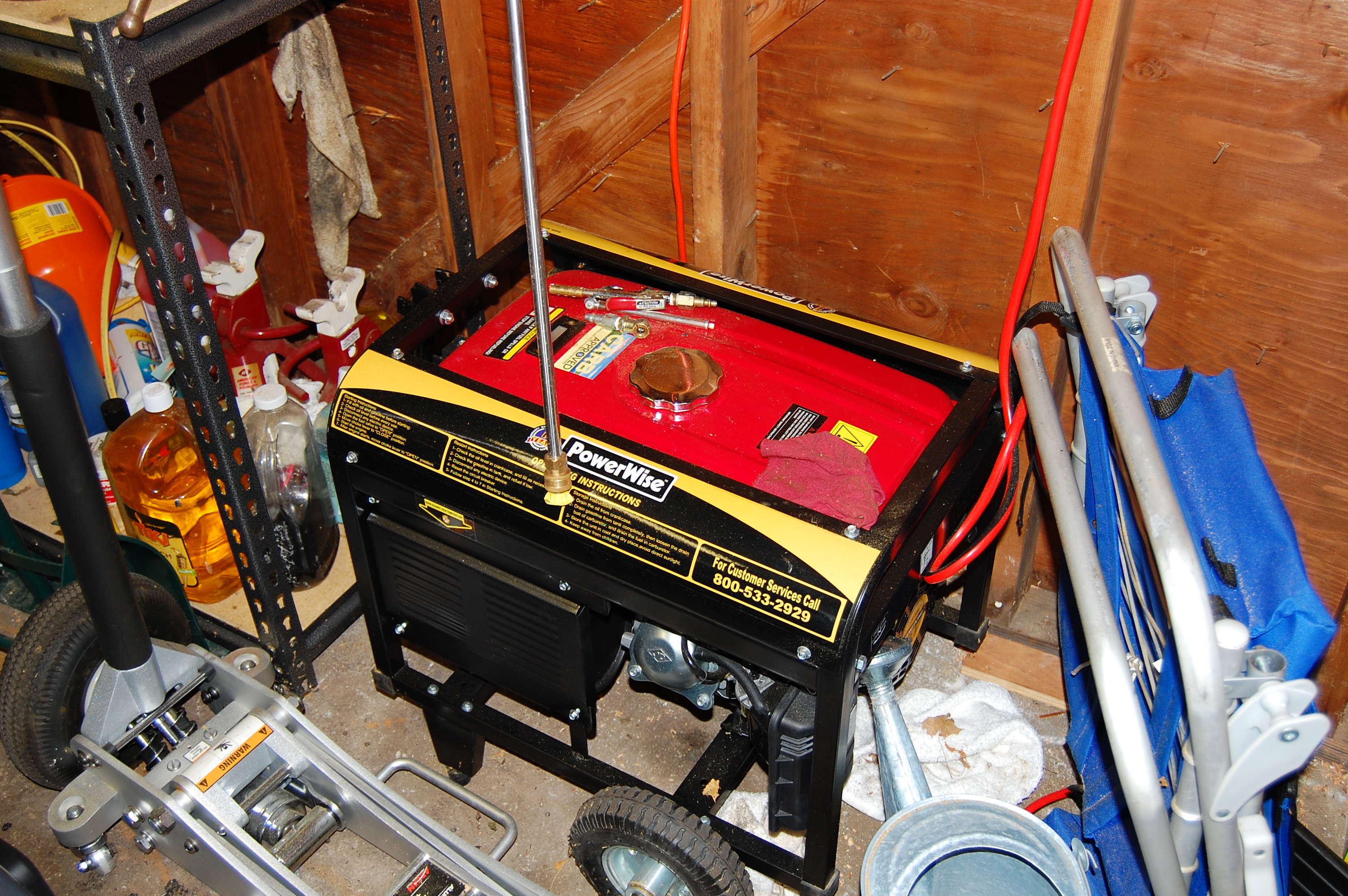

I bought this inexpensive 3000 watt generator from Costco 10 years ago. It's gotten me through the last 2 hurricanes (Irene and Sandy)with no problems. I back feed it from my detached garage, keeping only a few circuit breakers engaged just to power the fridge, heat, and a few lights. I'm thinking about getting a natural gas whole house generator in the future if I end up staying here in NY.
