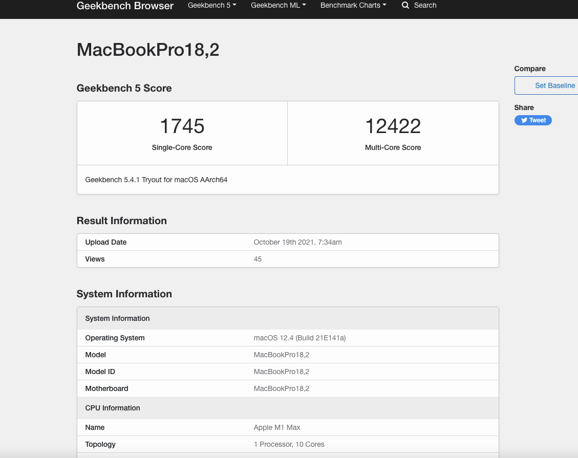

I thought the M1 single core score(in M1 mini) was in the range of mid 1600s. So, the gain is around 5-6% per core from M1 to M1x assuming the scores in the 1st post is accurate, is that right?
No. The M1 gets mid 1700 single core results, so there is no improvement in the M1 Pro/Max. This implies it is using the same 1-year-old Firestorm & Ice Storm cores as the M1, which I find disappointing.
