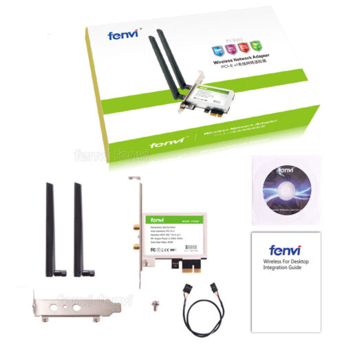

Ok, I think that I found the right one! Before I buy, I am pretty sure that this will work to get me beyond Mojave:
Just to confirm, this card will work beyond the Mojave?

Now that I am thinking about it, do I have to use the BCM94360CD chip? Is there a chip for Mac pros that can get me WiFi 6 and Bluetooth 5?
