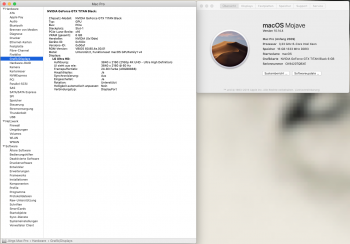

gtx titan black is working as well as the gtx 780ti, compared to eachother i see no different in them because they are based on the same kepler gpu. the benefit of titan black is the 6gb memory, while the 780ti is a little bit higher clocked.
i used a gtx780, gtx780ti and titan black in my cMP.
power consumption is too way high, under full load i always got system shut down.
i prevent this by using an evga powerlink adapter.
AFAIK, there is no custom rom to efi flash it by yourself.
it works OOB in mojave but cuda acceleration is not available because of no driver from nvidia.
Reactions: Pentaxer

well...mine is the living proof that this statement is wrong.

Kepler has Rev B card which was not natively supported in OSX. But Apple fixes that few years back, all Kepler GPU should be supported natively in MacOS.
dont have WIN on cMP but can take a shot later from pc...no problem.
but there arent different versions of the titan black, all are based on on kepler gpu with gk110-430-b1 chip and 2880 su's.
the 780 w/wo is using the gk110-300 or 425 gpu's, while the 425 variation also have 2880 shading units but the 300 just have 2304.
all of them have nativ supported in macOS since lion AFAIK.
Good to know. I am still confused as to why he would recently list it as requiring drivers and not supported though.
Thank you for sharing this information.
