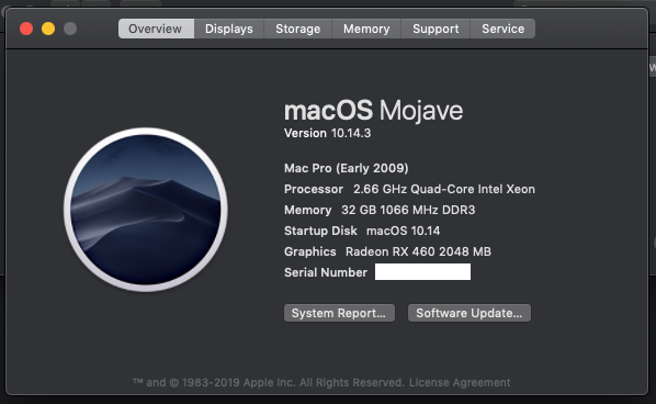

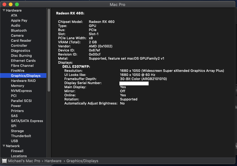

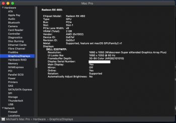

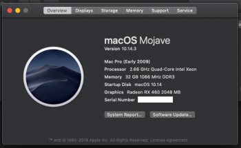

RX 460 support Metal 2 on Mojave?
Without flashing to RX 5xx?
Maybe it is Metal 1. When I looked for Metal in the System Profiler I saw: "Supported, feature set macOS GPUFamily2 v1". I bought the card off of Ebay, seller claimed “New sealed OEM”. They had no idea I was gonna put it into a mac so safe to assume not flashed.
