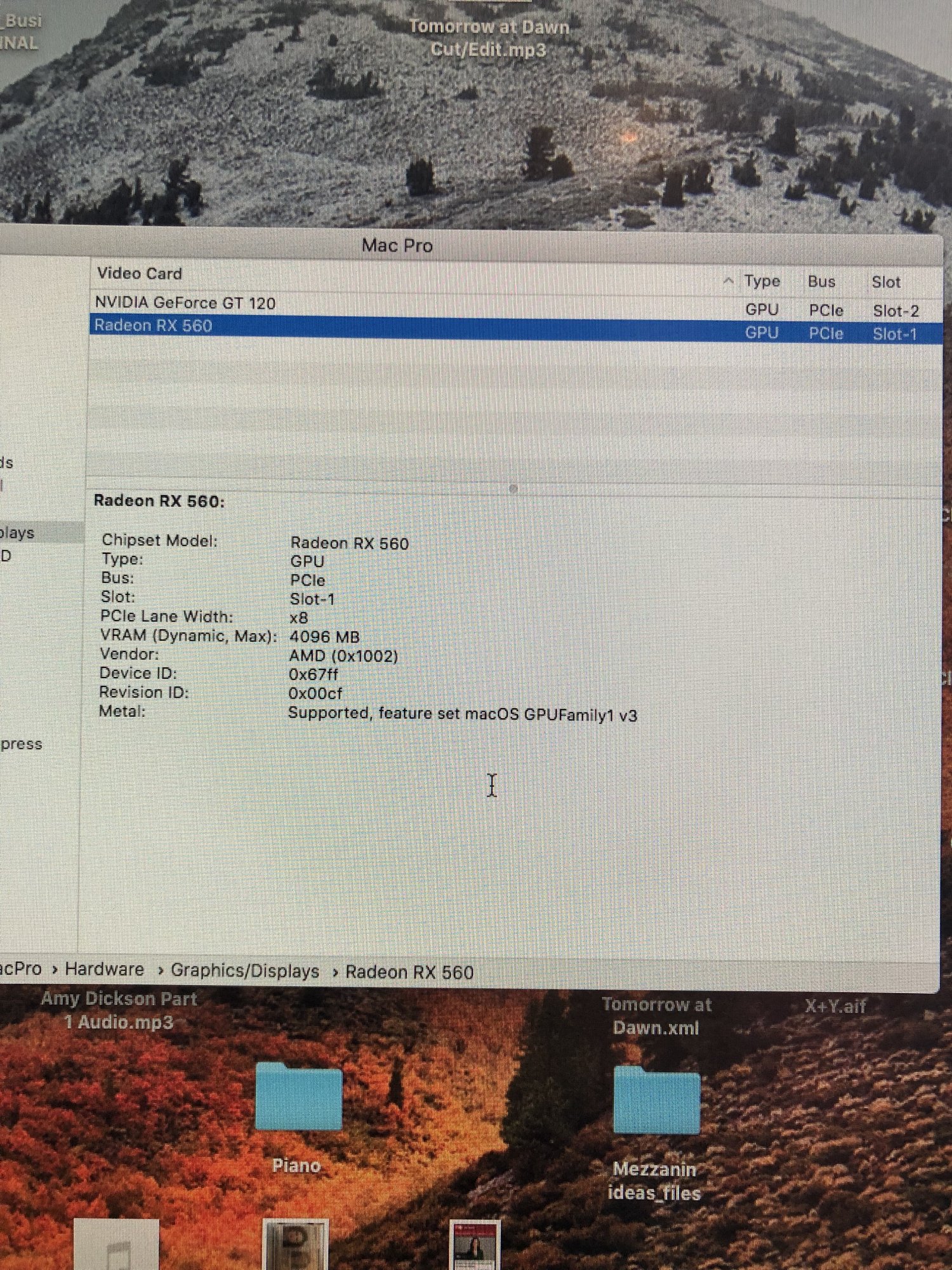

So just tried both cards and yes it does show up in the system info. Here’s a pic:

If no Aux power required, then shouldn't be powering issue.
You can install RX560 in slot 1, and GT120 in slot 2 (if you have concern about "too close". Or it seems the GT120 block the RX560's cooling, you can install the GT120 into slot 3 or even slot 4. That doesn't really matter). Then connect the monitor to the GT120.
Then you should able to see something like this. Of course, in your case, the card in slot 1 will be RX560, but not 1080Ti.
If you have no idea that's patched or not, then most likely it's unpatched. We can set this aside first.

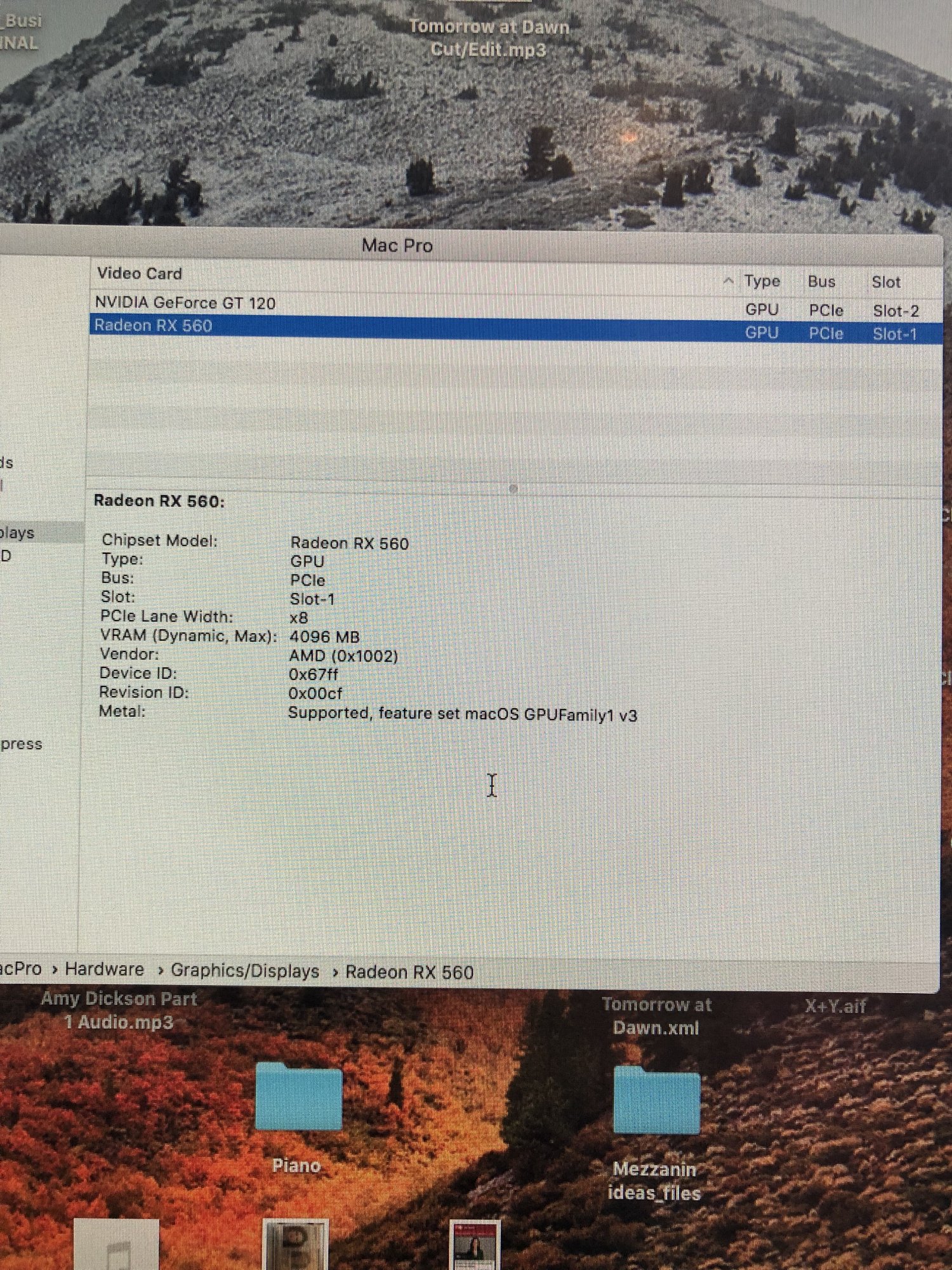

So, please do this again, and then when the screen show you this info, please unplug the monitor from the GT120, and connect that to the RX560 (You can disconnect and connect DisplayPort / HDMI cable when the power is on).
And please make sure you try ALL the ports on the RX560, just in case.
Oh wow!! That worked!
Unbelievable… thank you!!
Does that mean that I need to keep the GT120 there all the time?

You need to remove the GT120 in order to install Mojave.
No, the GT120 should not be required. You may try to remove that now and see if the RX560 can work stand alone.
The colour around letters most likely related to the font AA. What's your monitor's resolution? And which rendering resolution you are using now?
Thank you that worked!
The RX560 is working on its own.

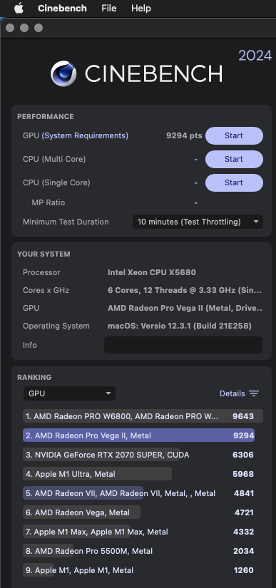

Sorry about slightly off topic, but just tested 2x VII, the other one downvolted and OC spoofed as a Vega II. Got 1000 points more in cinebench than without downvolting and spoofing. Don't know which one was the key to get it up that much. Maybe both.
It seems there's a bug in cinebench 2024. It only shows Radeon Pro Vega II once, but I certainly have selected them both to work on the bench. Maybe it's the OC spoofing of the other one of those GPUs, don't know.
Next I need to figure out how to assign the downvolt+spoof to PCIe slots 2 and 4. Trying to figure it out, but help needed desperately, please. Link: Today at 14:49
ps. by the way, this is a little over 600 pts (7%) more than Apple M2 Ultra top of the line 76 CU GPU.
