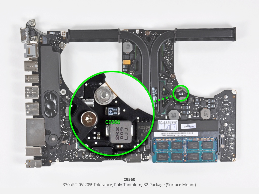

The 2010 issue can be solved by replacing a tantalum capacitor in the GPU area. I fixed it a long ago and it's now owned by a friend and works perfectly, an external monitor can also be connected too. The 2011 could only be worked around by the procedure suggested here (removing the X3000 driver), but it only worked for a few years and now it wouldn't show anything on screen at all and it's basically dead. The GPU went under reflowing at some point, but it only held for a few years and I assume the GPU is now dead so I can't even boot and hack it as before.

Any software-only "fix" won't really fix it. You'll have to have a tech replace the tantalum capacitor near the GPU as a permanent fix.

Changing the capacitor is the best way. Low cost and the problem is solved, allowing the use of an external monitor.

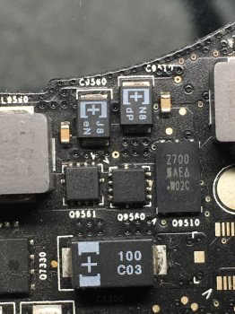

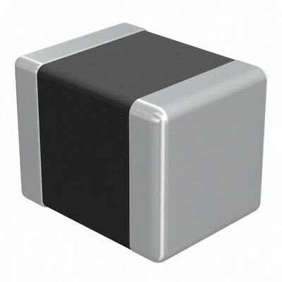

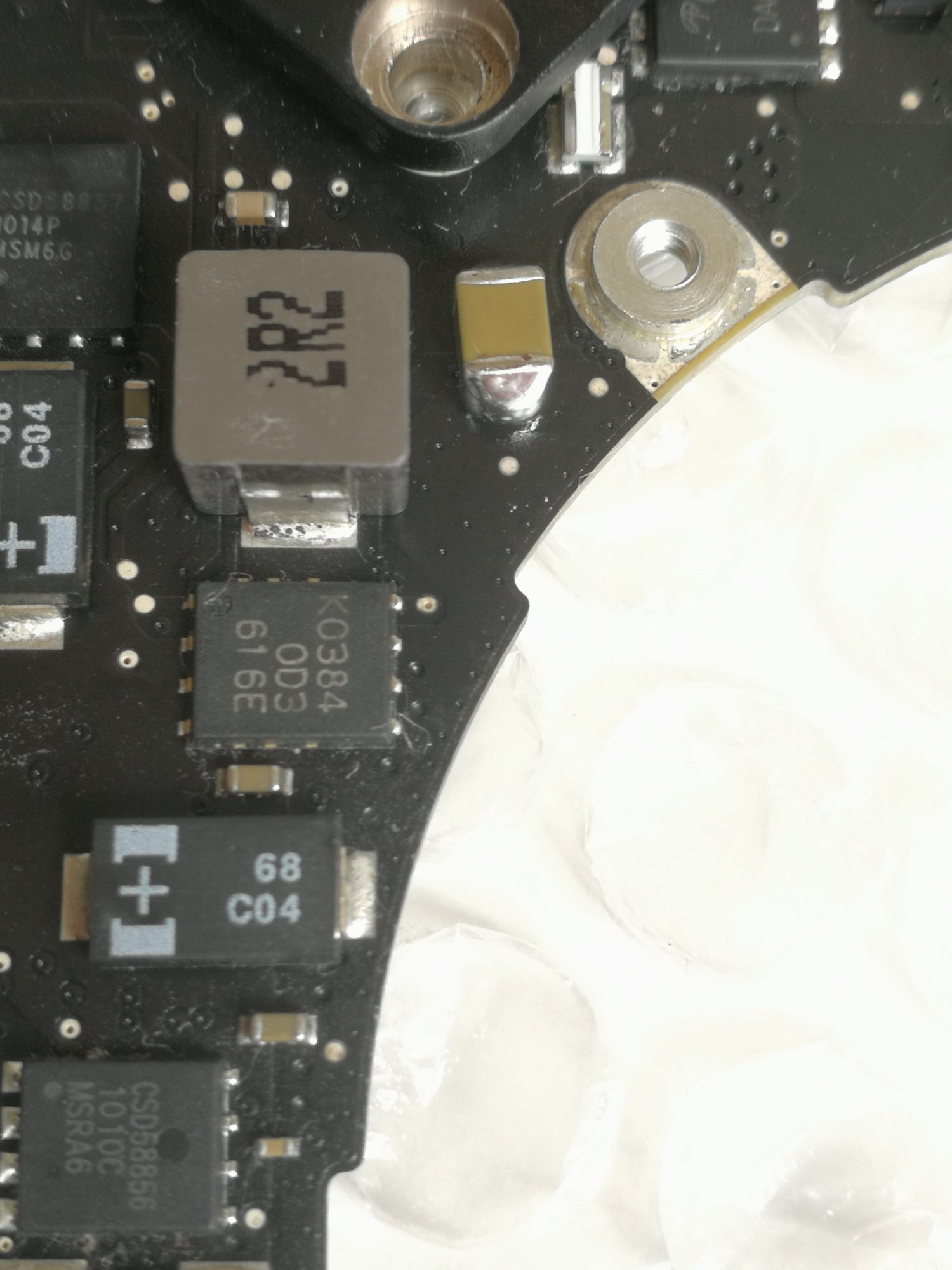

Hi guys. Another MBP saved. Software solution didn't worked for me sice I needed external screen. So decided to go for hardware solution. I've used ceramic capacitor to replace tantalum one. It was done by very nice lady in PCB Liverpool. She used soldering iron instead of heathgun so everything was in a save manner. Her only concern was that the original cap has polarity and ceramic doesn't, but it all works well and Im happily using my external monitor now.
If any of you needs this capacitor I bough bulk at Mouser and selling it on eBay:
JestaDubstep

@lost in spice
hey man. ill probably buy one of those off your eBay. can you confirm the name of the company you got to do the repair? was it PCB soldering in bootle? what was the ladies name who did it as ideally id like someone who knows the problem and the fix to sort mine out for me. so any info you have would be great and ill get on to ordering one of those off you on eBay man.
also is this defo 100% the same issue you were having? or can anyone else confirm that this is the issue with my 2010 machine before I commit to buying part and booking it in? heres a crash log that I get a daft amount of times a day

No. MBP 2011 has not capacitor problem. The gpu failure is a different problem.
For 2010 model, c9560 capacitor is 330uF.

Is it fine to Replace both c9510 and c9560 to 330uf 2v?

Hi all,
I think I/my friend damaged the 'big' 2R2 inductor coil right next to the capacitor when using a heat gun to remove the faulty capacitor.
Can anyone link to a replacement that would be suitable (and available in the UK), please?
Thank you!
Where can you find this capacitor?
Also, does it have to be a specific size?

Had the same issues with my 15-inch Mid 2010 machine. The repair extension program had since expired and because the machine had entered vintage status, replacement parts were no longer available.
I'd already bought soldering tools to repair a Mid 2009 MacBook Pro, so I decided to have a shot at changing the troubled capacitor. Problem solved. Not the easiest repair in the world but it would be a straightforward job for an electronics repairer or anyone skilled with a soldering iron.
This would be the better solution for anyone that isn't content with a temporary software fix, boots between multiple operating systems or needs the use of the higher powered graphics hardware.
I know this is an old post, but, could you fix it changing the capacitor? Can you give me some advice? I have a logicboard 820-2915-B Macbook Pro 8,2 late 2011 with Radeon. I read a lot and dont want to give up, as it is in very good shape... the only problem is the screen glitches sometimes, someother time blue screen, black screen... now it is working with linux and the nvram variables... but I feel it will fail soon again.
Thanks!
