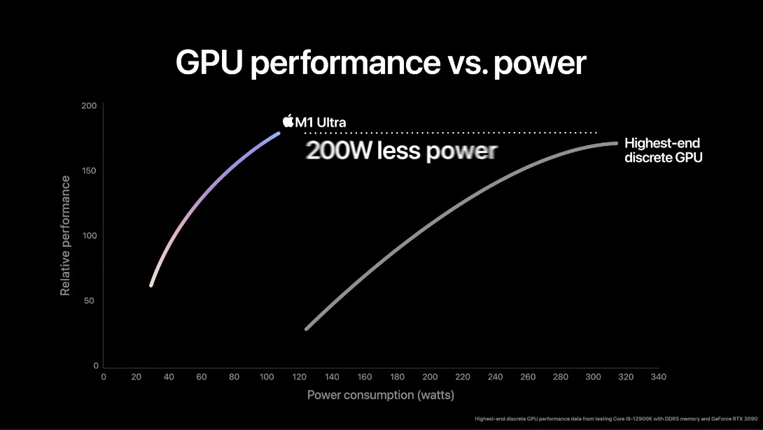

In their presentation slide they say that the GPU in the M1 Ultra (64 core version) is slightly faster in performance than RTX 3090. Can this even be true? I know for redshift rendering it is going to be nowhere close to this, but would love to see how the two compare.

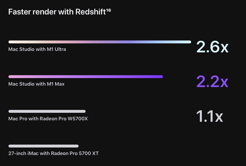

I've been trying to work out how fast the Mac Studio GPU is compared to the Mac Pro options. They say the ultra (64 core) is 2.6x as fast as a Mac Pro W5700X card for rendering in redshift. And on the Mac Pro page they say a W5700X has 9.4teraflops single precision performance. (9.4tf x 2.6 times = 24.4tf). So is the Ultra GPU equivalent to a W6900X which has 22.2teraflops single precision. I don't know, or fully understand this stuff.
I'd just love to know how the M1 Ultra GPU compares to Mac Pro GPU power and RTX 3090 for rendering in Redshift / Octane. Hopefully YouTubers will be able to test this.
My plan if I get more into GPU rendering is to buy RTX cards for my PC and use that as a render farm. Still work on the Mac, and farm out to the PC only when needed.
But the real star of the Mac Studio is the 20core CPU! Hopefully After Effects will be able to use a lot of this. 40core CPU in upcoming Apple Silicon Mac Pro will be crazy good, beating all AMD Threadrippers, and will be crazy expensive too!
You are right, my mistake. It was M1 Max on par with 3060 Ti. M1 Ultra was said to beat 3090.
We'll see.
While it's good that Apple provides some numbers we can hold them accountable to, it's wise to read with caution. Or, perhaps better: to not extrapolate what you read to be valid for another scenario.
"Relative performance" is very loosely defined. There are many ways you can benchmark GPUs and we can rest assured that Apple has used something that utilises the benefits of Apple Silicon to the max, while it isn't necessarily optimised, or even representative over a larger suite of tests, for the RTX3090.

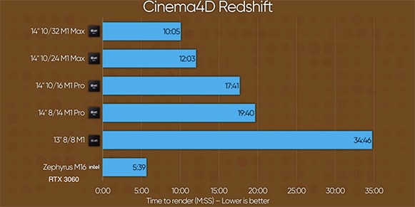

So from this I guessing that the 64core GPU of M1 Ultra would render in redshift the same speed as a RTX 3060 😭

Does anyone know of a site which shows benchmarks for comparing PC cards to Mac cards for GPU rendering? I'd love to know how say a M1 Max compared to a Radeon Pro W6900X to a RTX 3090.

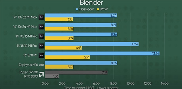

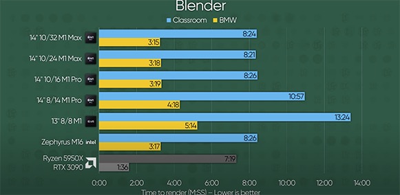

That video also shows these blender benchmarks. Do you think these are for GPU rendering?
Not using Redshift, but I just rendered the Classroom scene in Blender on my MacBook Pro M1 Max 32 in 1min 41sec using GPU rendering.
They might be using Cuda in the graphic above. They should be using OptiX and the 3090 would render that scene in... hmmm, what was it? 16-20 seconds or something.

Since I've already shared Classroom benchmarks, for reference on the BMW scene with my 10900K CPU and 3080GPU:
BMW:
CPU: 2:35
CUDA GPU: 00:16
OPTIX GPU: 00:09
I'd assume that benchmark in the LTT video is showing CPU rendering on the PC side, because a 3090 is orders of magnitude faster than what they're showing in their bar graphs. EDIT: That video is also from Dec. of last year, so who knows what version of Blender they're testing with
