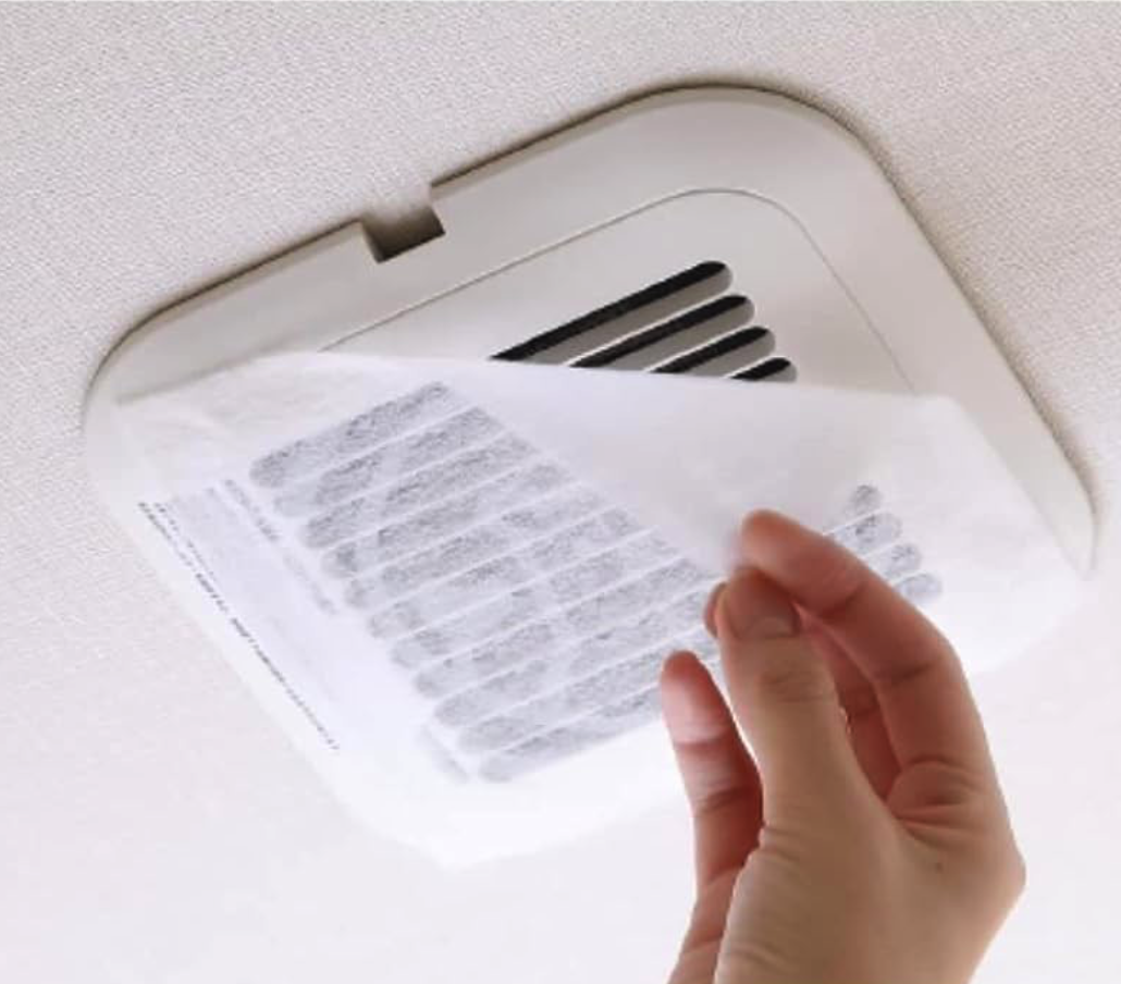

For posterity, swapping out the filter significantly lowered the temperature.
I feel a bit foolish that this was the main culprit, but I'm glad the issue is resolved. :oops:
By "swapping out", do you mean the filter was dirty, and replacing it with a clean one lowered the temps?
Or do you mean that you removed the filter entirely, implying that any filter at all was obstructing airflow enough to raise temps?
This. The old filter was dirty and I replaced it with a new one.
The filter I'm using is more dense than a foam or stocking, so the ventilation system is capable enough. Similar to this material:
