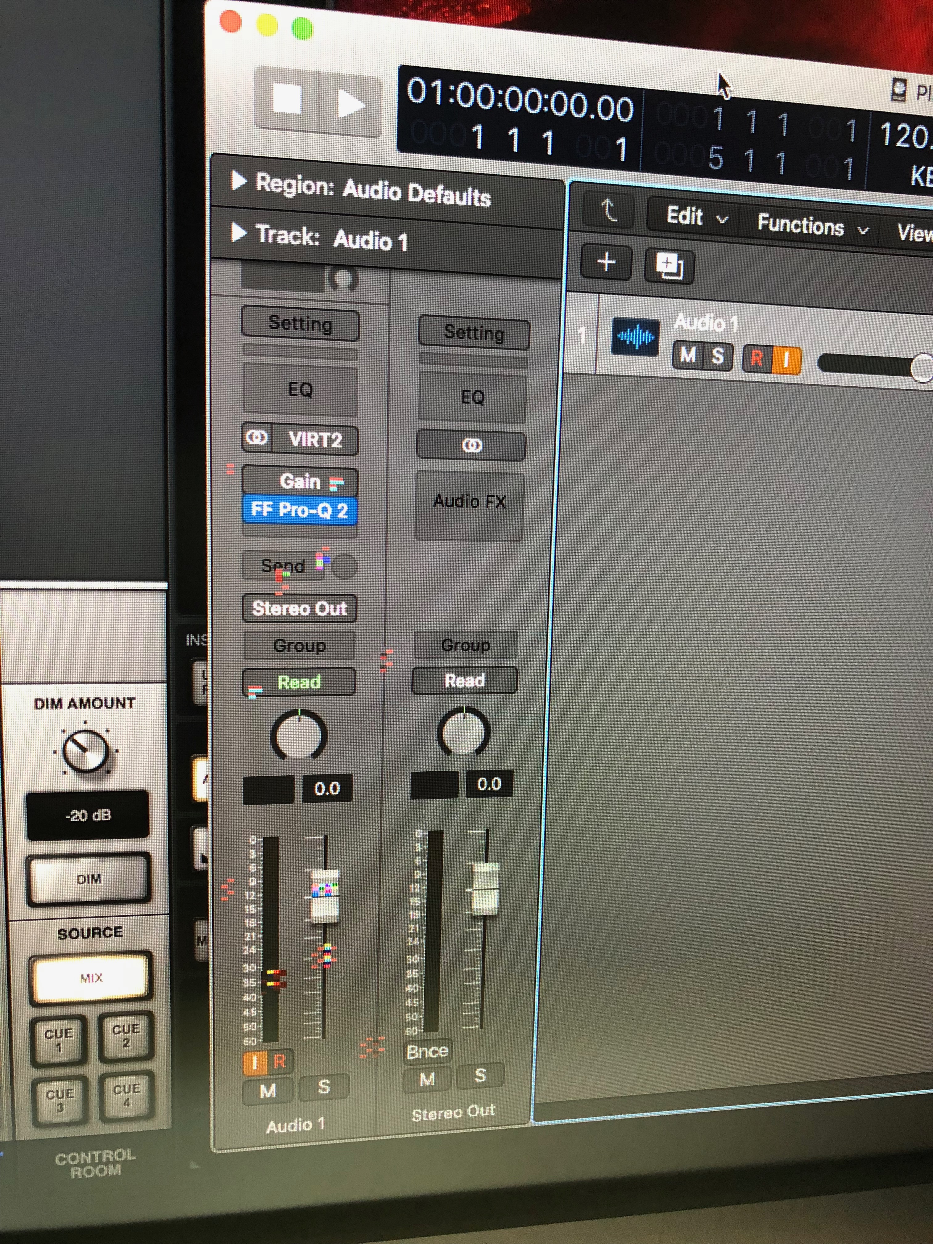

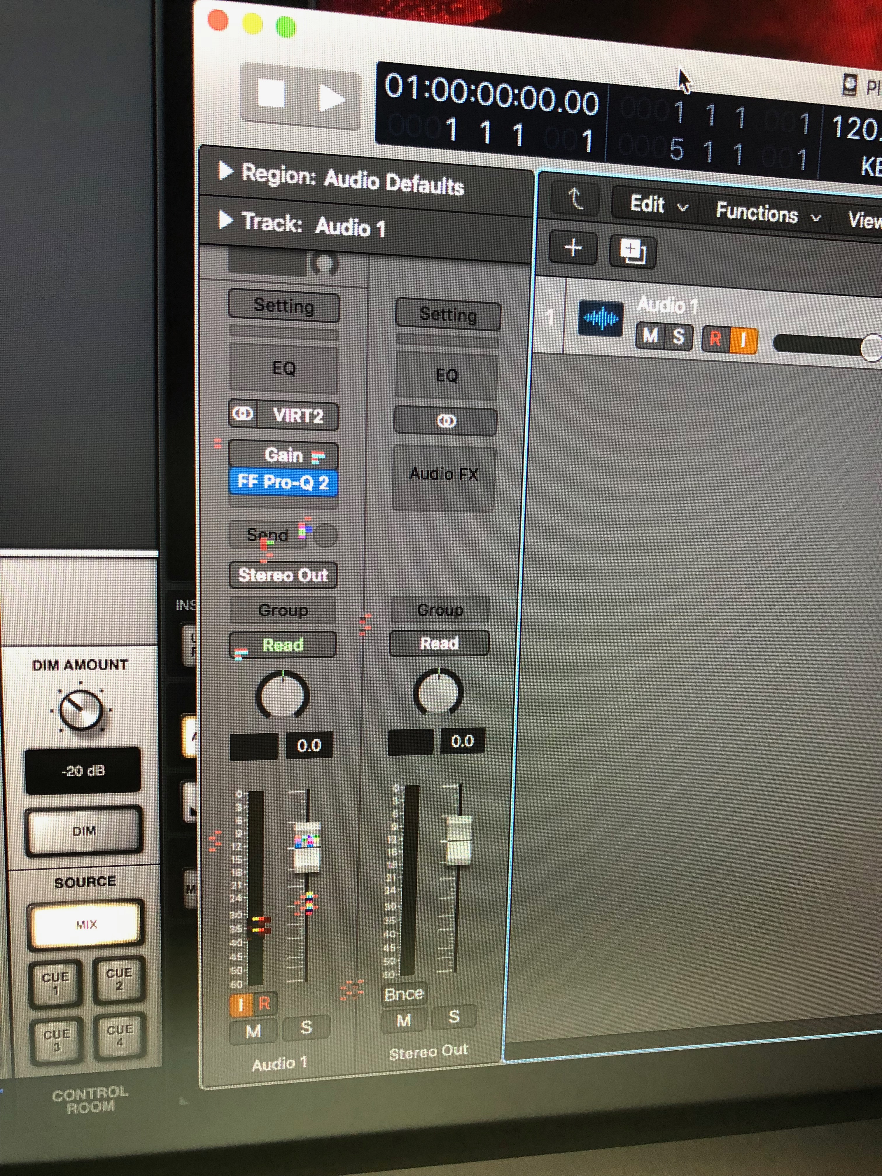

And the hits just keep on coming from Apple! Bug STILL exists in 10.13.6 on my 2nd iMP. ...
There have been previously-reported cases of Pro Tools causing graphical UI artifacts on various Macs: http://resources.avid.com/SupportFiles/PT/Pro_Tools_2018.1_Read_Me-Mac.pdf
In fact if you search the above document for "artifacts", it happens under various conditions and Avid classifies them as "known issues". It's possible they are more common on some hardware platforms than others.
However -- you also saw this on Apple's own Logic Pro X, so that seems to rule out Pro Tools.
If it is reproducible on those two different apps from different vendors, that implies it's a lower-level problem at the OS, driver or hardware level. There's also the question of whether it's unique to the two iMPs you've had, or unique to a specific config such as Vega 64, or would it happen on a base iMac Pro at the Apple Store.
Apple stores have base iMac Pros but they (nor Joint Venture nor Business Teams) have access to Configure To Order iMac Pros. So unfortunately you can't go there with a portable drive and run a test on a non-stock machine.
I don't know where you purchased your machine (and I know this is beside the point), but cases like this are a good reason to purchase it only from Apple or a retailer which permits returns without restocking fees. You could encounter a serious but elusive problem that requires exchanging the machine to resolve it and several popular retailers such as B&H do not allow exchanges or returns.
Sorry, but I mentioned this before. This has nothing to do with Protools or Logic Pro. I was getting identical graphic glitches on my first iMac pro accross several apps [todoist and Evernote I recall]. It was the base model straight out the store where I had the issues.
For me, we can conclude, it is not graphic card related [56 / 64] nor is app specific.
I'm not saying it's always Pro Tools or Logic Pro, only users must be aware of app-specific graphical issues.
People in this thread have reported "it" only happens on Apple apps, others report it only happens on non-Apple apps. Others report only "frame glitching" within FCPX. What "it" is varies -- the descriptions are diverse.
Some people have had reduction of symptoms after replacing hardware, others saw no improvement. You yourself reported "when I got the Vega 64 there were no more glitches."
The thread has become a grab bag of symptoms which are often vaguely defined. It's similar to a software bug being filed which only says "slow performance". Everyone sees that vaguely defined symptom and thinks "that's my problem".
Regarding the few people who posted screen caps or videos, those do look low-level in nature -- hardware or driver-level software.
As I previously posted, there have obviously been some low-level graphical issues with the iMP because the macOS 10.13.4 specifically mentions "graphics corruption issues affecting certain apps on iMac Pro": https://support.apple.com/en-us/HT208533
If those could exist and were fixed, it's quite possible other similar ones could exist -- which affect only certain apps -- which are not yet fixed.
The best approach is try to narrow down the problem, report it to Apple, and help fellow users by reporting specific details.
