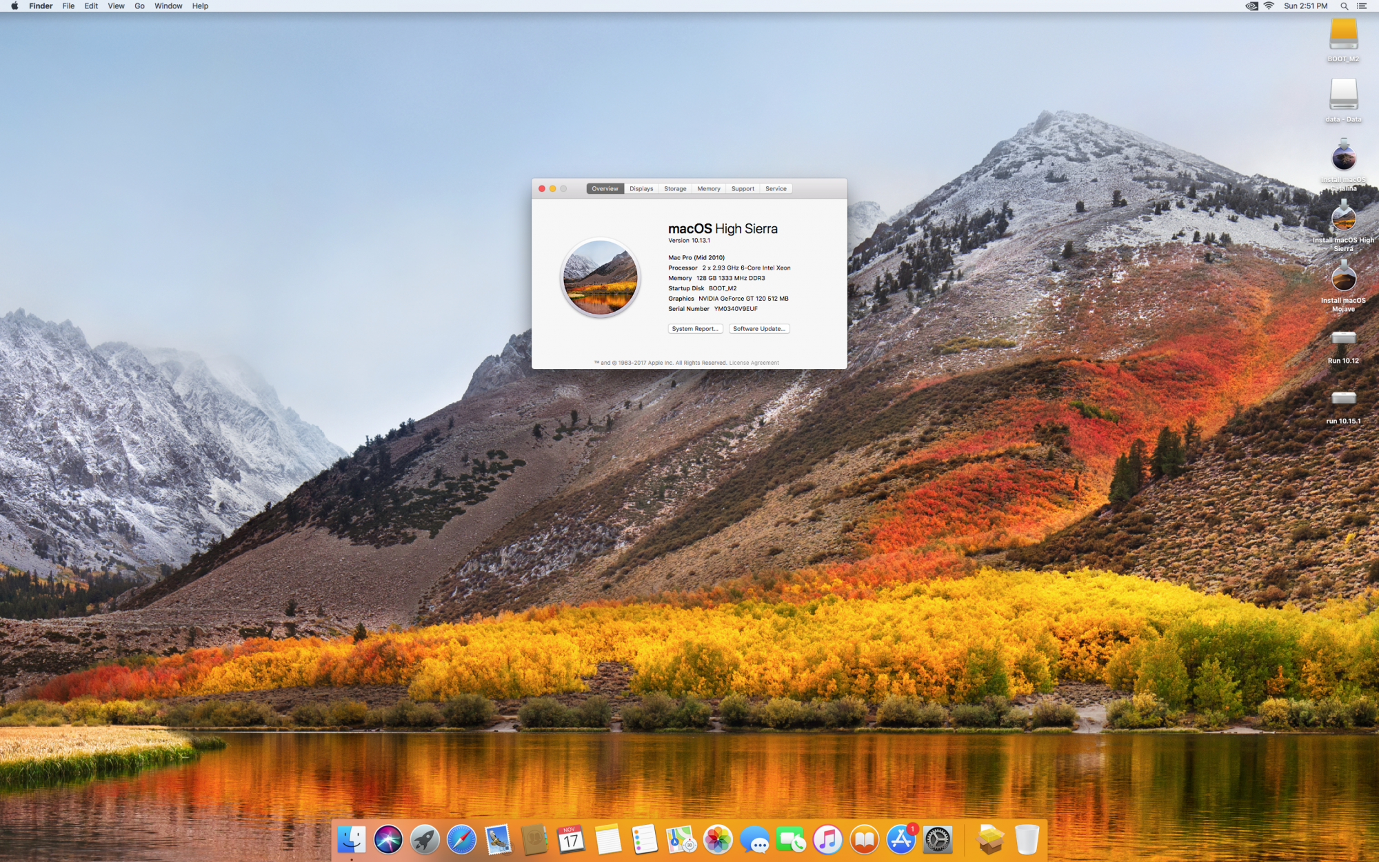

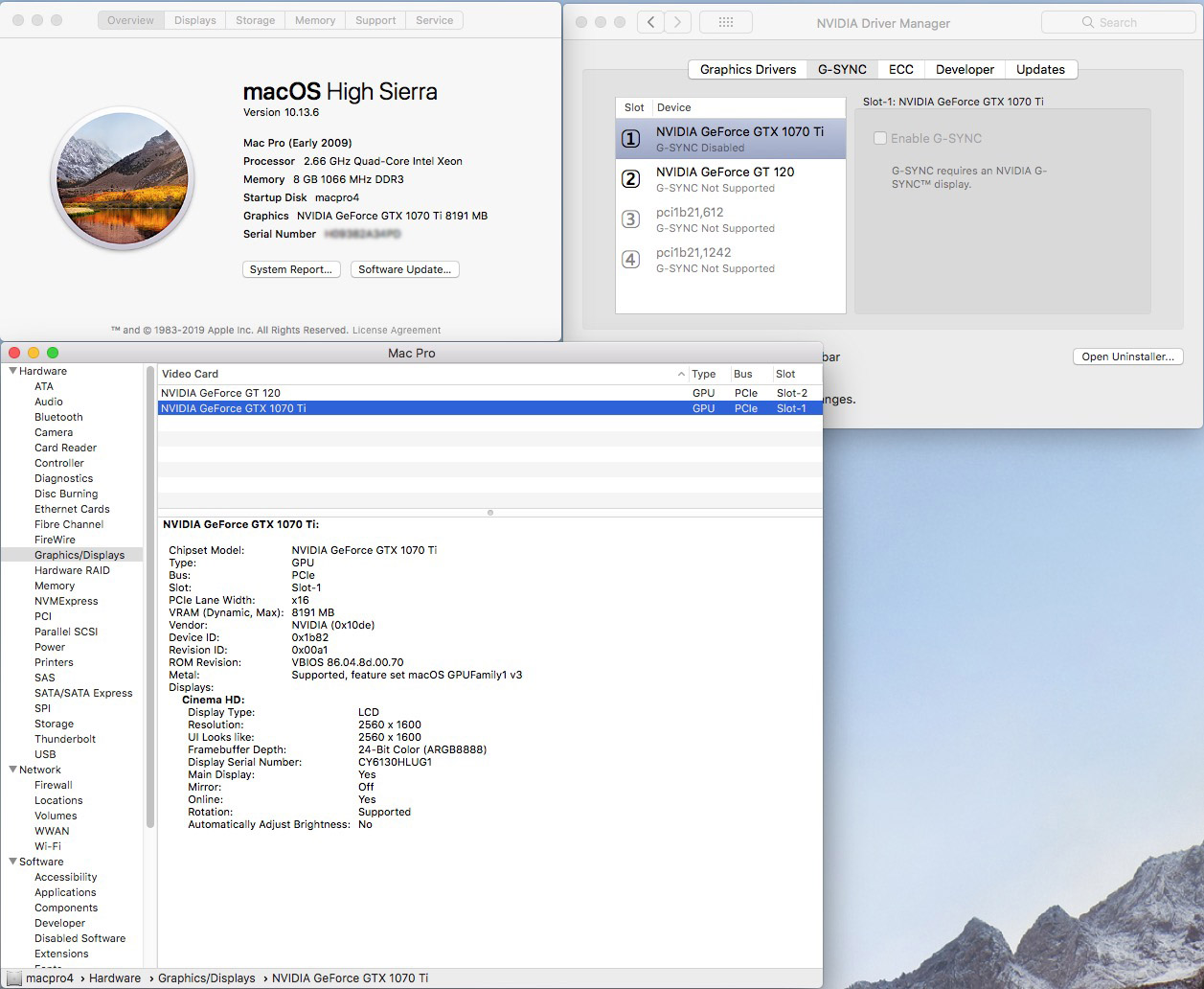

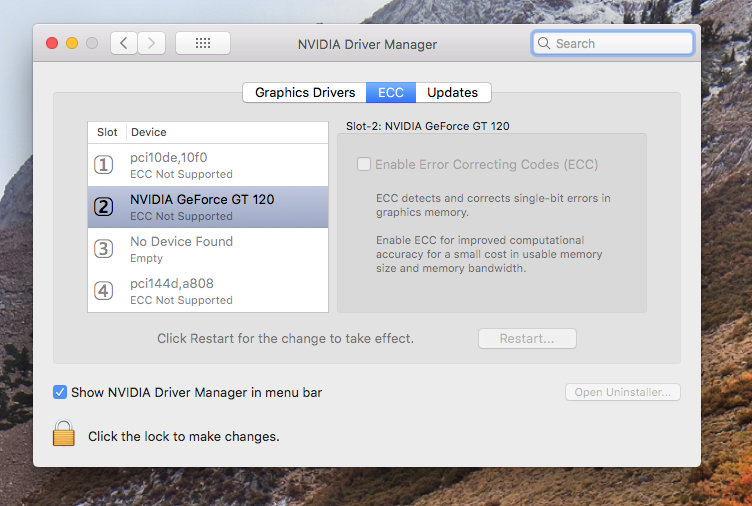

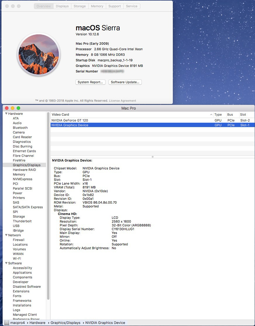

Dear Accrok, here is the photo you requested.
Reactions: Accrok
Thanks a lot!
The GC isn’t recognized as “NVIDIA GTX 1070Ti 8191MB”?
Why?
Not sure. I can tell you that I'm powering a 30" Apple Cinema Display so I know it is working.
Here is the same machine running under High Sierra.
Hope that helps. Good luck.
Next up for me, more ram and an NVME pci-e add-on card.
Reactions: Accrok

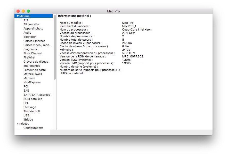

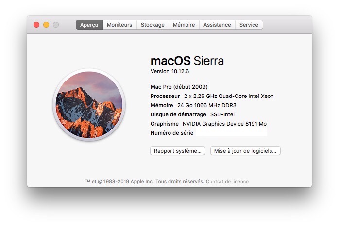

Hello @emulitu and everybody!
Voilà, I’ve move forward and upgrade is now effective : 4.1 to 5.1 and Sierra clean install with my new graphic card - Nvidia GTX 1070Ti
Here is my shots:

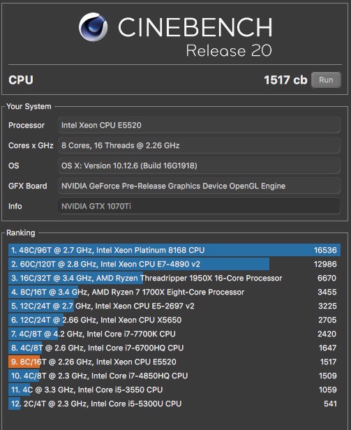

@emulitu could you make me a favor please and make a benchmark of your 1070ti on High Sierra please?
Here is my Benchmark :
Oo sorry, I’m newbies!
Is there a solution (software) to make a benchmark for a graphic card?

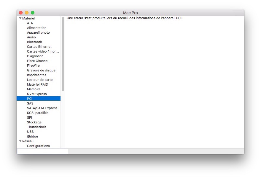

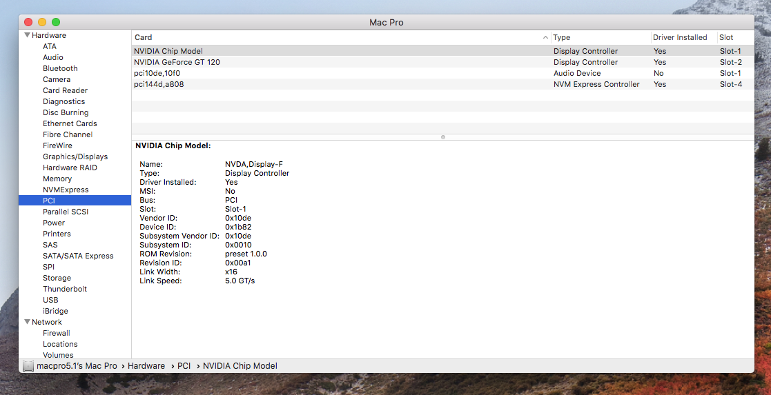

Hi, my name is Son. and I think I need your help.
I got same problem when I tried to install my PNY GTX 1070Ti on my MacPro 5.1, 10.13.1.
I used my Gt120 as my default VGA.
1. I installed CUDA driver
2. I installed Nvidia web driver ( matched with 10.13.1), SIP and Gatekeeper were enable. it asked me for the permission when I was installing CUDA and NVIDIA web driver.
3. turned off Mac Pro.
4. plugged GTX1070 in.
5. turned it on....
6. it always chooses web driver not Mac OS driver.
PCI said YES on the driver installed column, but it has still not recognize dat 1070, just a common Nvidia card, and I can not use it. My cinema 30" is always black when I plug it to dvi port. mac pro is still running fine, because I can plug it out and change to GT120's dvi port, the screen is on again...
Can you share your extension folder so I can see what different from mine?
Many thanks.
PS: I can use the gtx1070ti in my eGPU, it works well :D

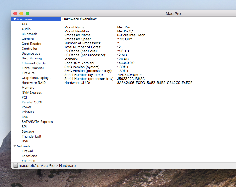

Hi @son, what’s your build version (just click on 10.13.1 text) and what’s the build version of nVidia web driver? (put screenshot please)
I did not success with 10.12.6, back to 10.13.6, here my build and driver, extension folder, and has not worked yet... :((((
any idea please?
Very strange, I’ve the same build version (17G65) and the same web driver version and all work fine!
I don’t understand where the problem and why your GC not work.
Do you’ve tried with DisplayPort, hdmi output ?
Perhaps, try a re-install of web driver and CUDA driver !
