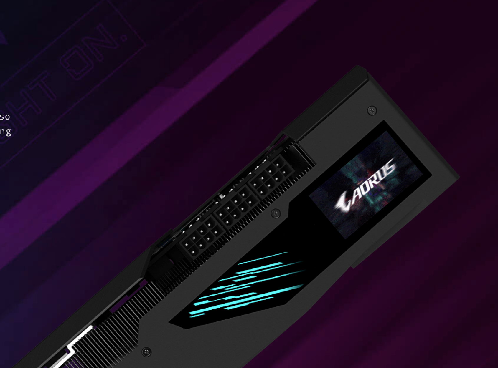

I don't know if you already got your answer for this by the time I'm seeing your message now, but the answer is: no you don't need an external power supply. The Mac Pro's 980W built in PSU is plenty good for any single GPU. You will need two power cables to connect the GPU's power connectors to the Mac Pro's PCI power supply lines, which are headers on the motherboard. That is all.
^^^^For older GPUs yes, for some new ones not so much.
Even some late model GPUs with more than six pins per side.
