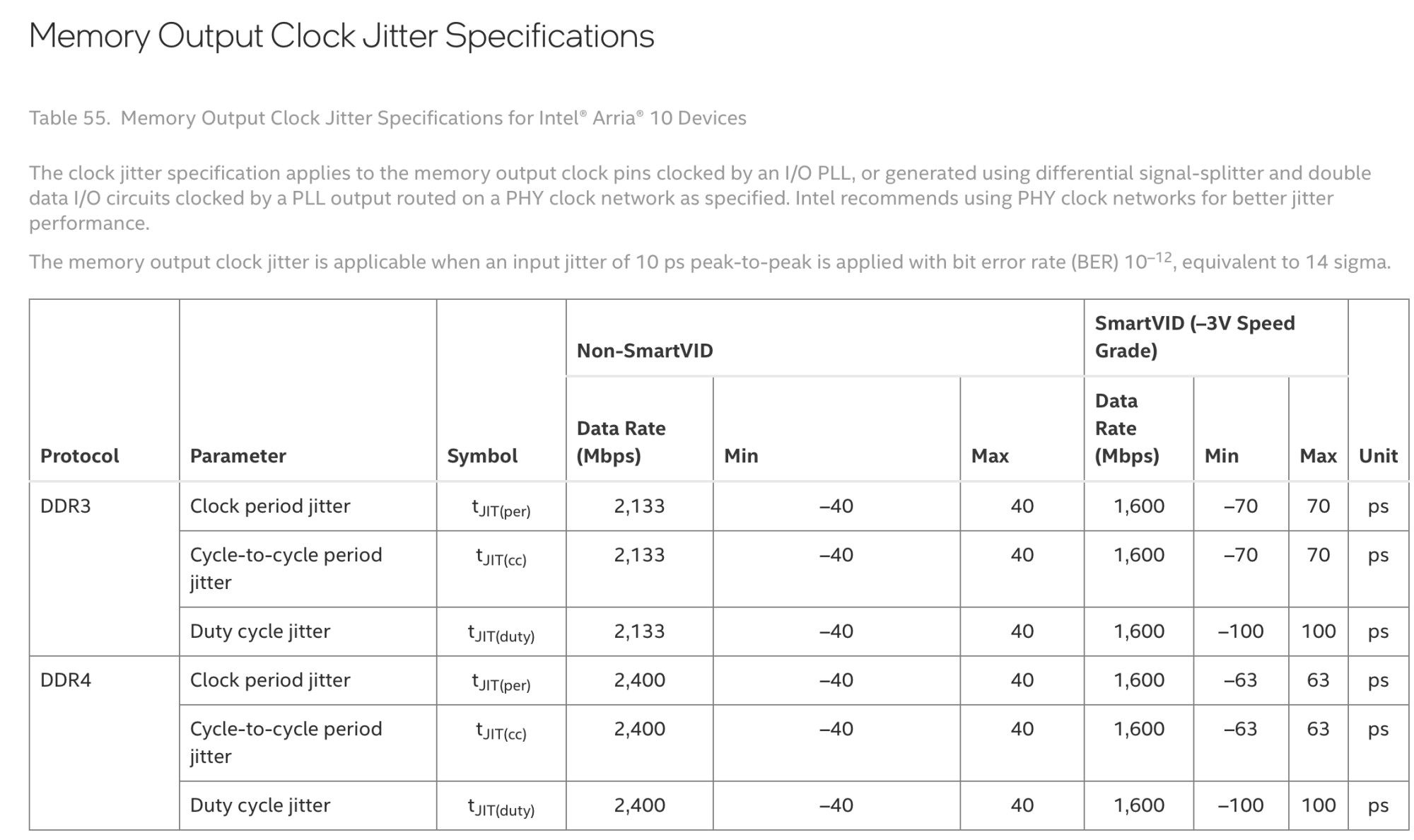

Of course, it also doesn't make sense to express it as 33.3333333333333... MHz, since that indicates a precision in the clocks that they don't have. When discussing this area specifically, it's probably better to say that 30 ns is the nominal period, and 33 1/3 MHz is corresponding the nominal clock speed. The actual period and clock speed varies due to jitter. For example:
Yup. In fact, it's incredibly common to implement something called "spread-spectrum clocking", where you add frequency modulation to your PLL. With this feature, the PLL's output frequency is still centered on nominal (or sometimes, nominal is treated as an upper limit), but the instantaneous frequency wanders around within some band (say, +/-10 MHz).
This is done to help systems pass the EMI (electromagnetic interference) tests mandated by national bodies like the US FCC. When you use a normal clock that doesn't wander, you get large, narrow-band EMI spike at the clock frequency (and smaller ones at each of its harmonics). Spread-spectrum clocking doesn't reduce the total radiated energy, but by spreading it out over a wider frequency band, the peak is much shorter, and that helps pass the test.
