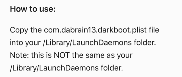

I was checking out the instructions and notice something about what location to use:
It says to move it to "/Library/LaunchDaemons which is not the same as /Library/LaunchDaemons"
I assume you mean it's not the same as ~/Library/LaunchDaemons (with the tilde)?
Yep. It needs to go into the /Library/LaunchDaemons NOT ~/Library/LaunchDaemons. My bad. I've updated the readme.
Edit: I've just removed that statement. KALLT is right, there are no "user daemons" so that folder doesn't even exist.

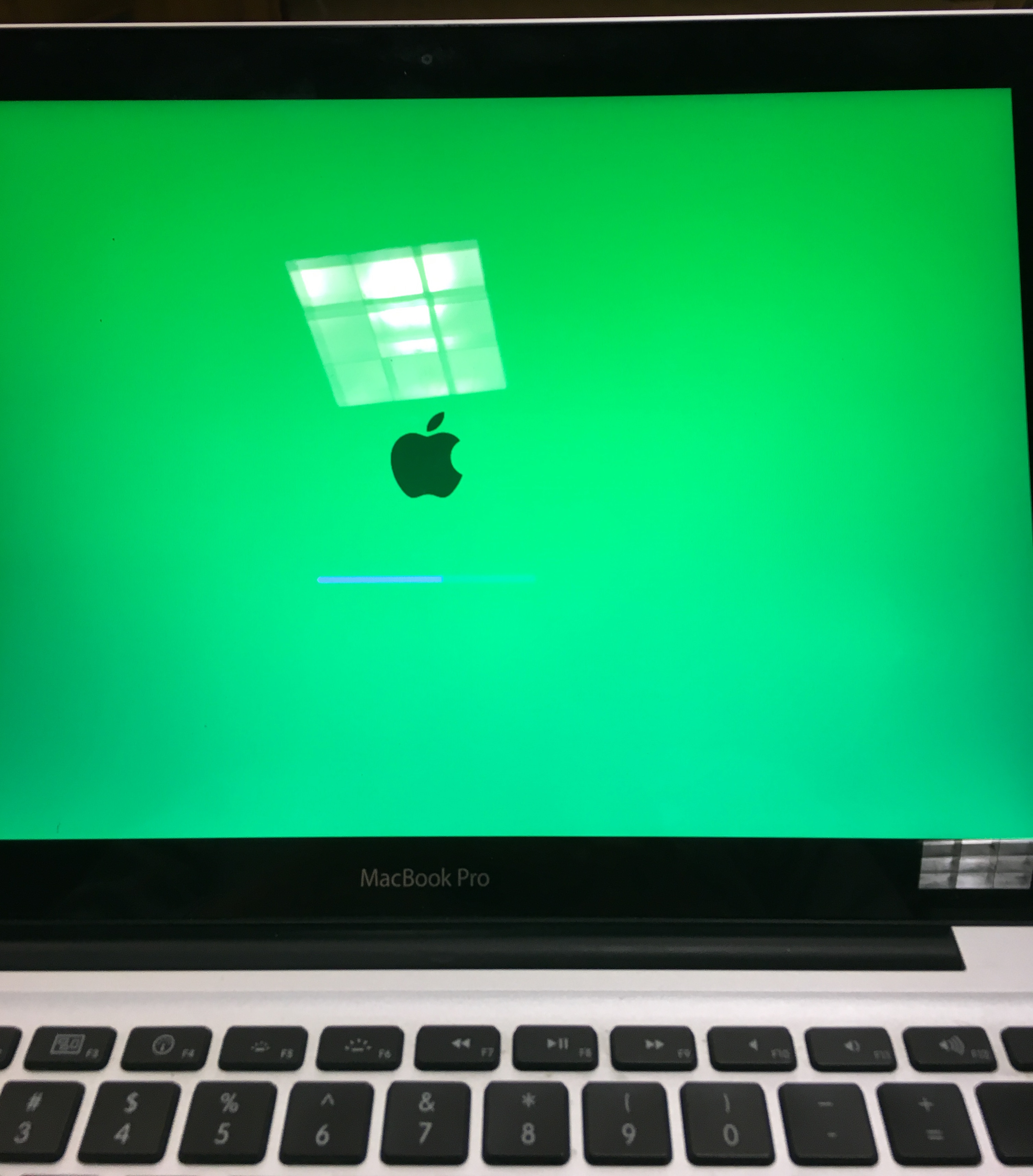

So it looks like you can choose any RGB color you'd like. Just google the hex code for the color you'd like, replace the %00%00%00 part of the nvram command with the hex code of the color you want (% two first two hex digits% second two hex digits%third two hex digits) and reboot.
Pics or it isn’t true. :p

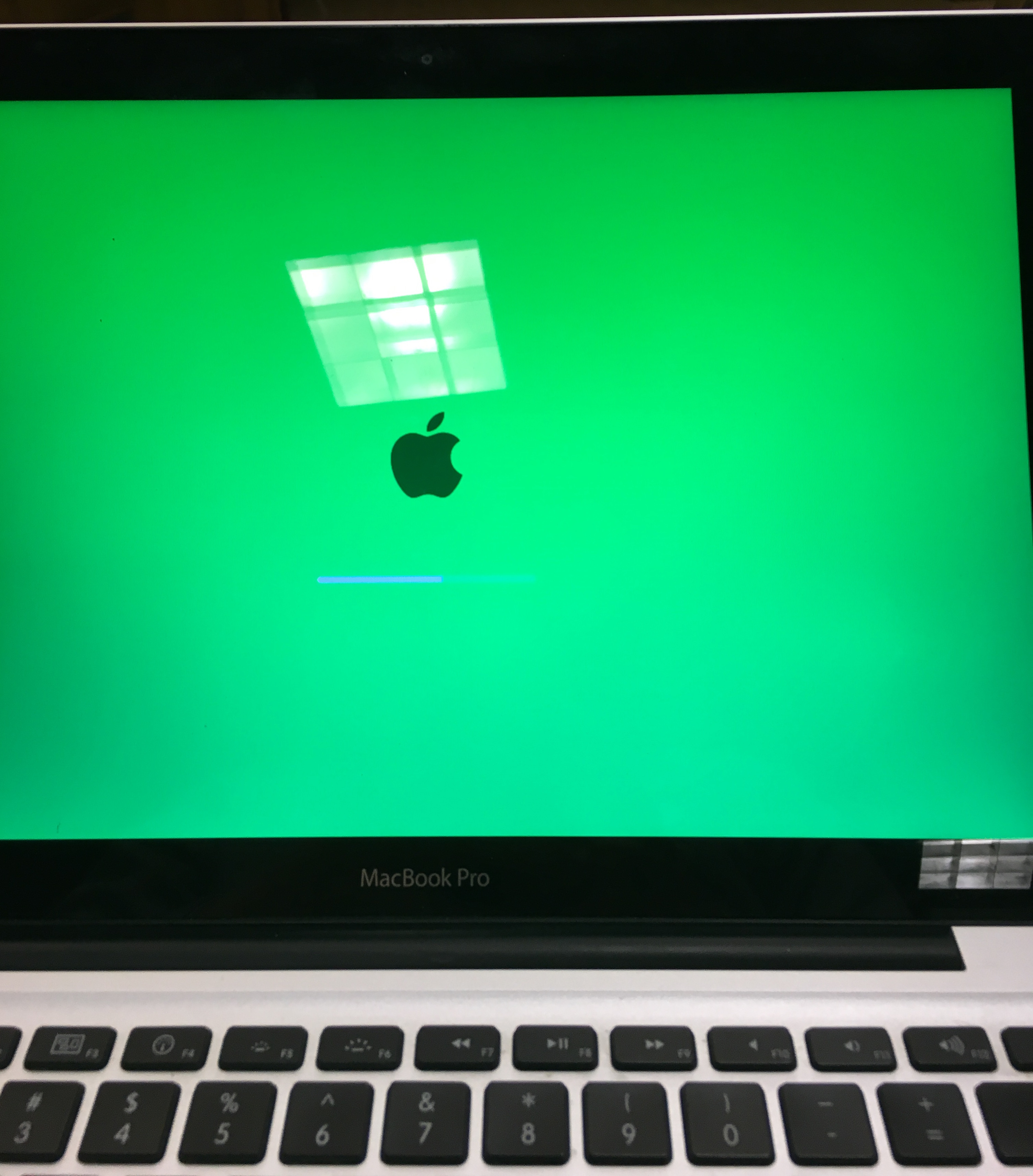

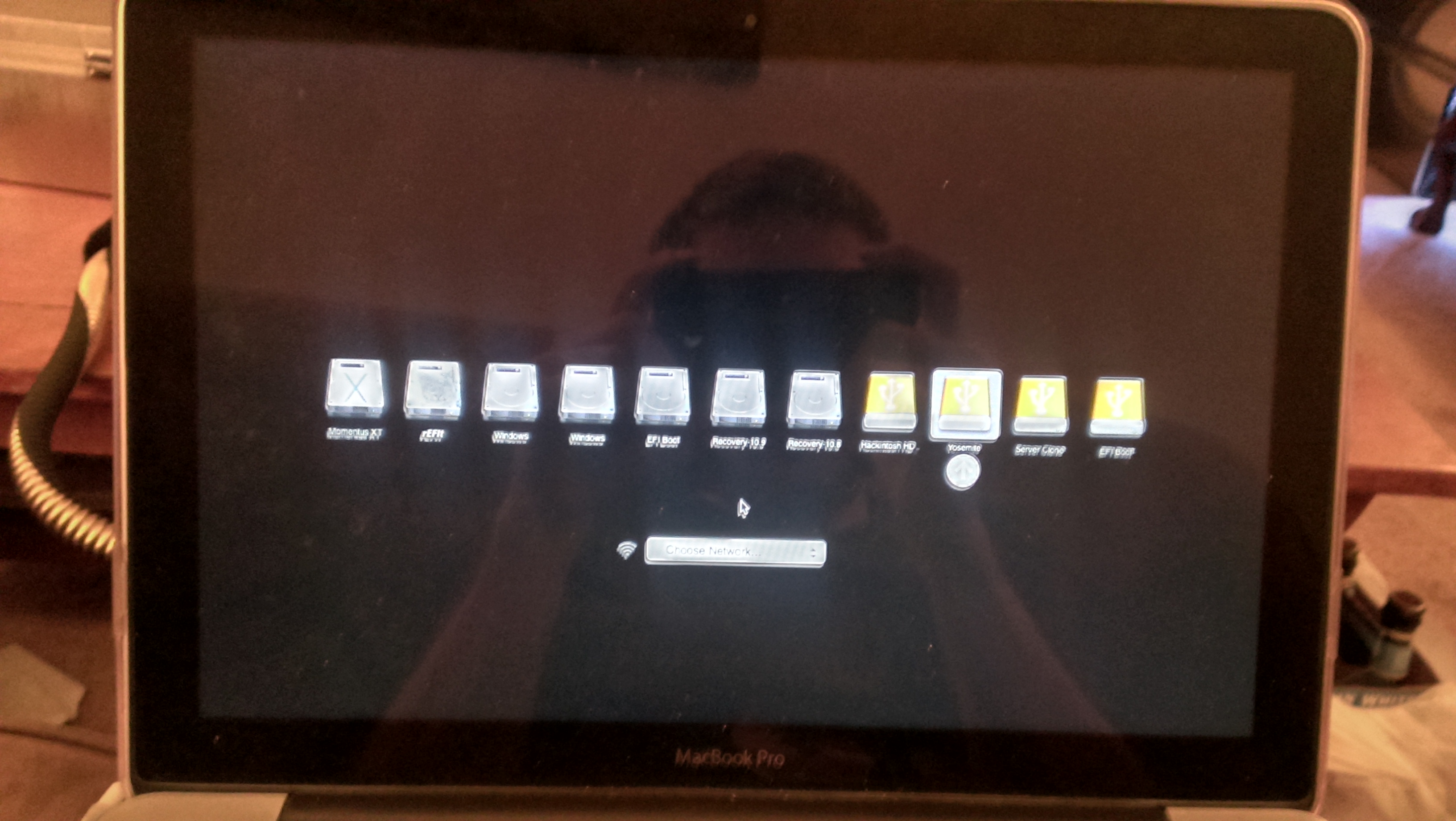

Sorry for the bad quality, but I think it gets the point across!
awesome.. tested on MBP Early 2011 with 10.11.5 ElCapitan ;)
*btw for color can i mod to orange color / something else but not RGB color ?

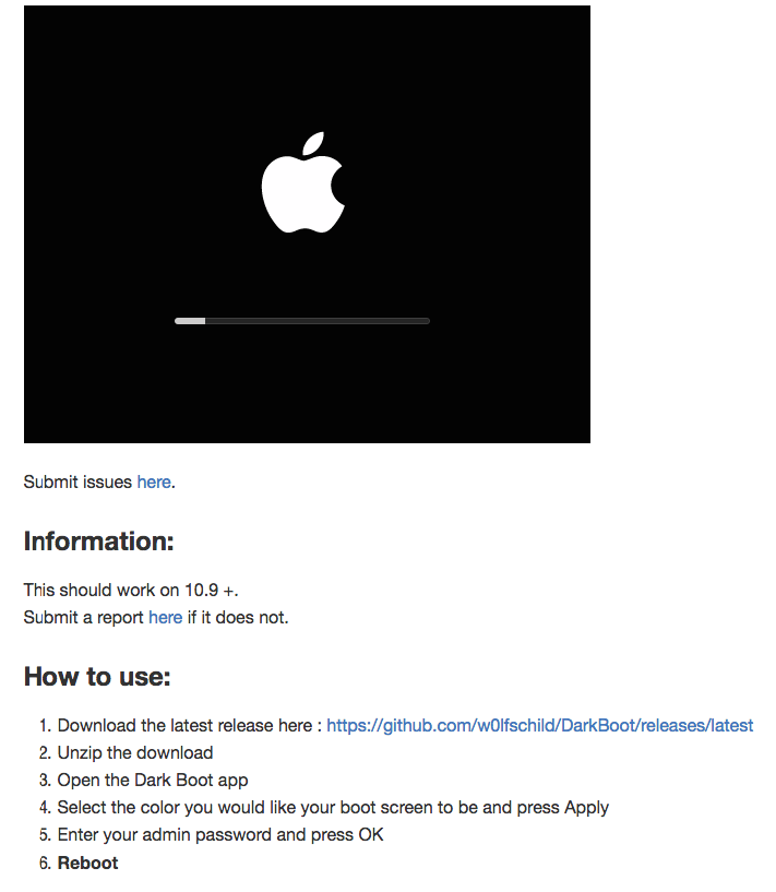

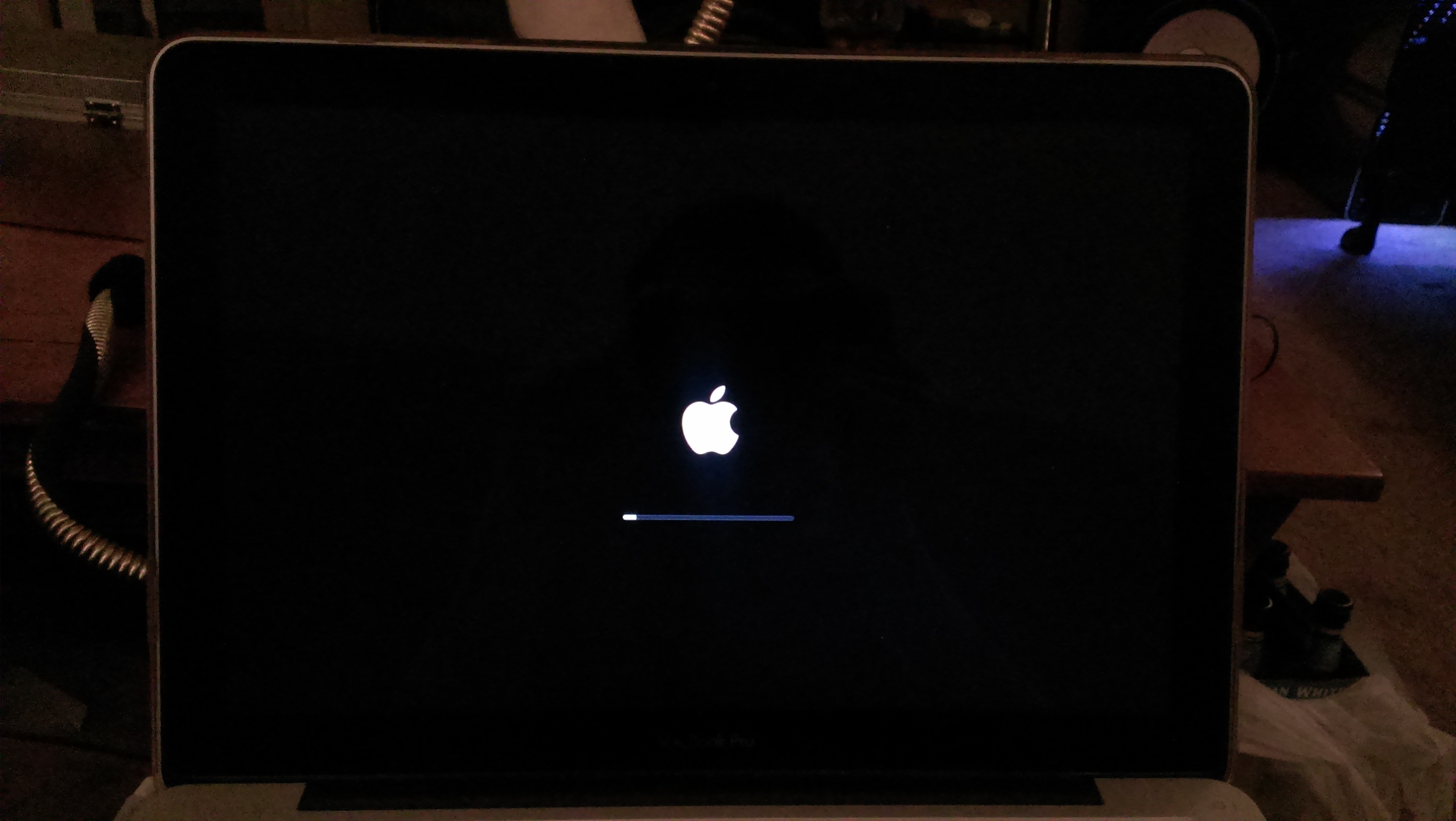

This is a guide for enabling the black boot screen + white Apple logo on "unsupported" Macs.
It should in theory work on all 64-bit EFI Macs.
WARNING: A small mistake or even just a fluke problem could potentially prevent your Yosemite partition from booting. Make sure you have a backup of it! I'm not responsible for anything that happens to your Mac.
NOTE: When you run an update it's possible that it could revert this, so you may have to repeat the process again after the update.
UPDATE: w0lf has been kind enough to write a script to automate this process! This link will always have the latest version: https://github.com/w0lfschild/DarkBoot
note: You may have to make DarkBoot.command executable after downloading. Put it on your desktop, open the Terminal and type the following:

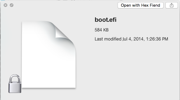

2. Now let's back up the boot.efi file just in case. Make a folder on your desktop called "efi_backup" and copy /System/Library/CoreServices/boot.efi to that folder.
3. Now make another folder called "new_efi" for example, drag boot.efi into that folder. Note that the icon has a lock on it:
This means that NO user can modify the permissions or ownership of the file, not even the root user. Let's fix this so we can actually modify it.

11. Now let's reboot! You will most likely need to reboot twice for the settings to take effect.
Here is the result:
I'm extremely happy with this hack, I hope some of you will find it as useful as I have!
If this guide is useful to you, please check out my music in my signature. :)
