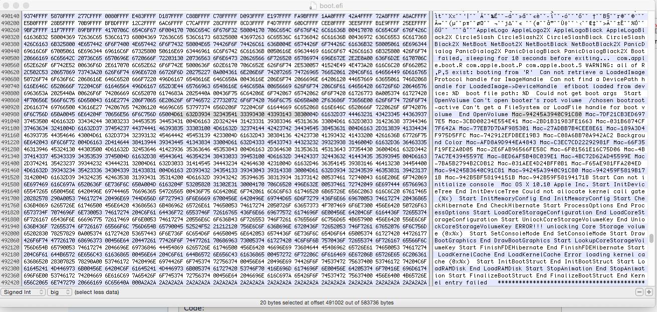

This is my board id (same as the example)
And this is my actual modified boot.efi
I don't know why don't work

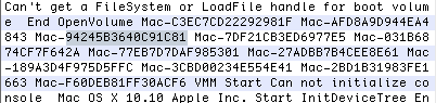

First off, I would like to thank Pike R. Alpha for explaining how boot.efi determines whether to use a black or white boot screen, as seen here: http://www.insanelymac.com/forum/topic/298808-can-we-get-back-the-apple-logo-on-boot/?p=2036030 Also, thanks to VanillaCracker who explained how he got this to work on his 2012 Mac Mini in that same thread.
What this hack does is it simply checks the board id of your Mac to determine if it supports the black boot screen.
So basically, what we will be doing is changing one of the "supported" board id's to our own to trick it into thinking our Mac is supported.

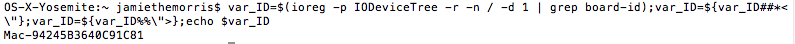

1. First, you need to get the board id of your Mac model.
EDIT: Thanks to w0lf, here is a script you can use to tell you your board id:
Code:
var_ID=$(ioreg -p IODeviceTree -r -n / -d 1 | grep board-id);var_ID=${var_ID##*<\"};var_ID=${var_ID%%\">};echo $var_ID
As you can see, the board id for my MacBookPro8,1 is Mac-94245B3640C91C81.

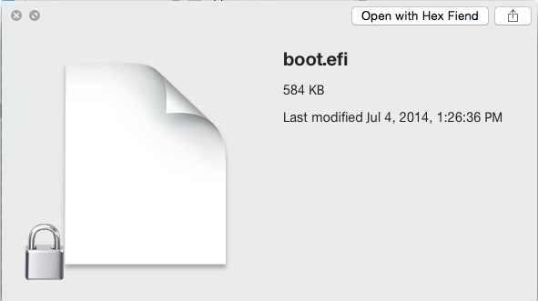

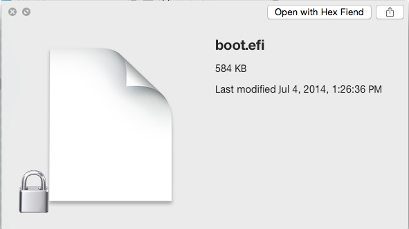

2. Now let's back up the boot.efi file just in case. Make a folder on your desktop called "efi_backup" and copy /System/Library/CoreServices/boot.efi to that folder.
3. Now make another folder called "new_efi" for example, drag boot.efi into that folder. Note that the icon has a lock on it:
This means that NO user can modify the permissions or ownership of the file, not even the root user. Let's fix this so we can actually modify it.

7. Now we're going to edit boot.efi to tell it that our Mac supports the black boot screen. Open it up with HexFiend, click on the right column, and search for "Mac-" (make sure you have the dash). You should see a bunch of Mac board id's. Highlight one of them, in this example I am using the third one which is Mac-35C1E88140C3E6CF. That's the MacBookAir6,1 board id. Replace that with your board id, which again in my case is Mac-94245B3640C91C81.
NOTE: If you have an 8-digit board id, the last 8 digits of the board number you are replacing will have to be replaced with spaces (this can be done by going to the hex side of the window and replacing that section of the board number with 00 00 00 00 00 00 00 00)
Save the file and exit hex fiend.

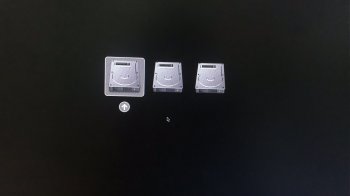

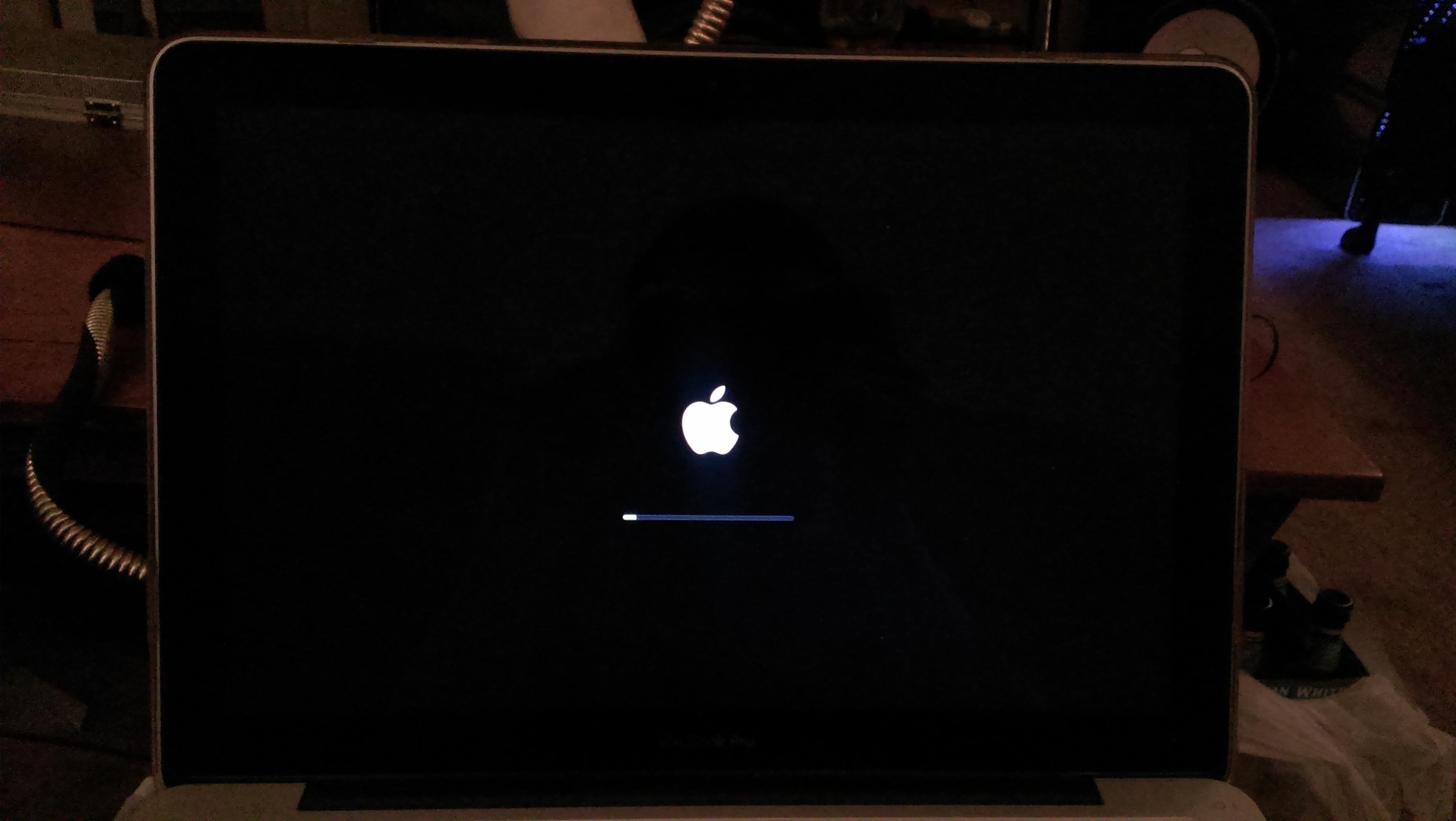

11. Now let's reboot! You will most likely need to reboot twice for the settings to take effect.

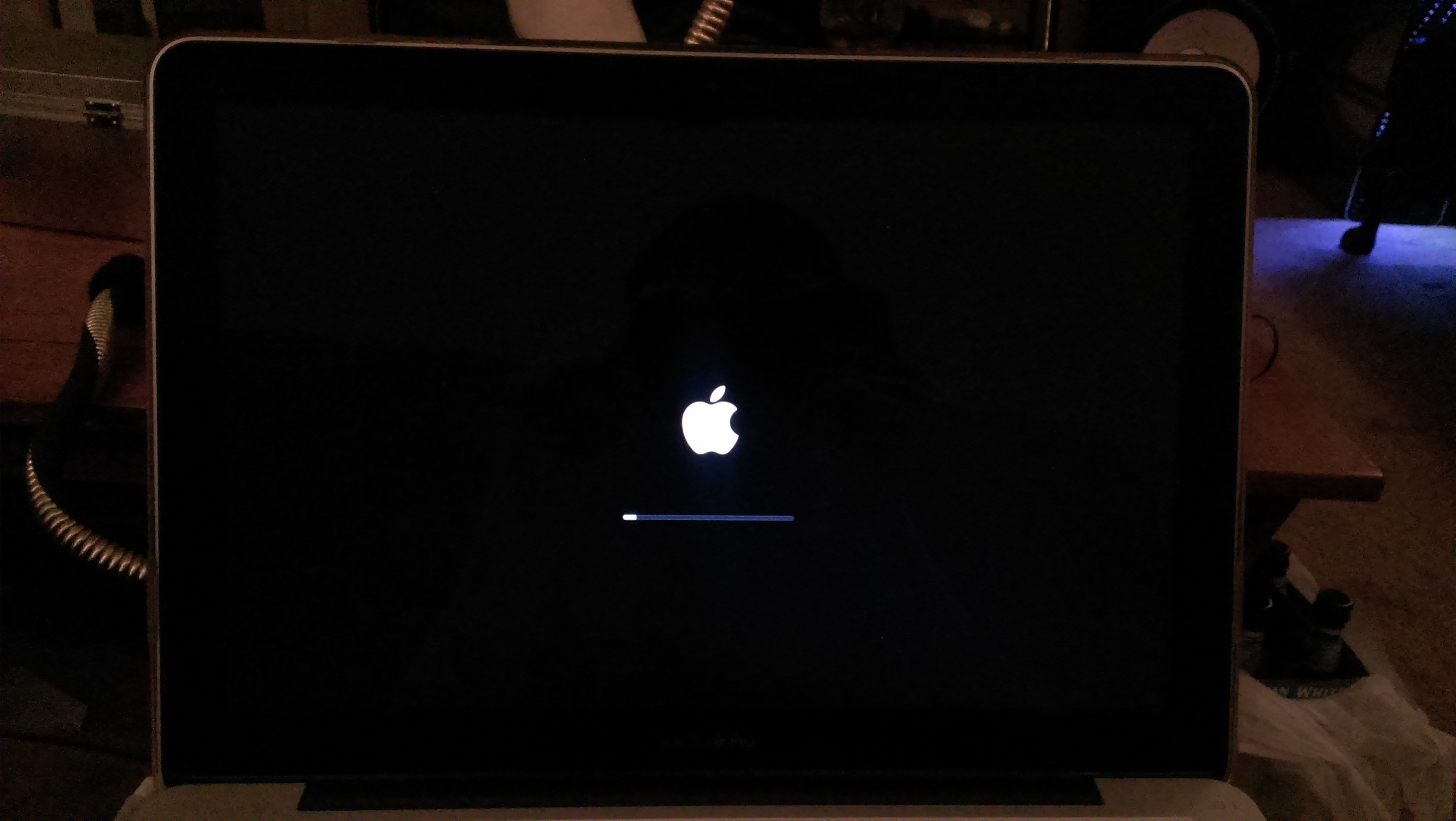

Here is the result:
I'm extremely happy with this hack, I hope some of you will find it as useful as I have!

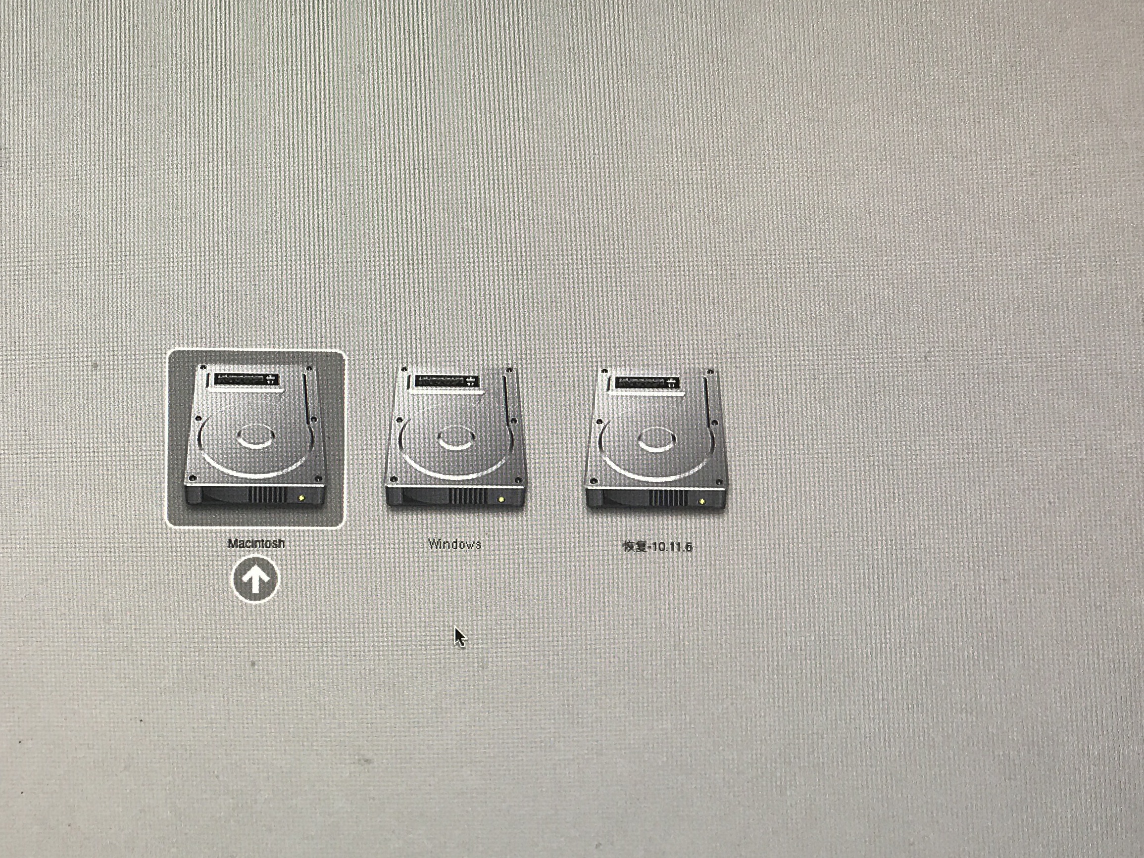

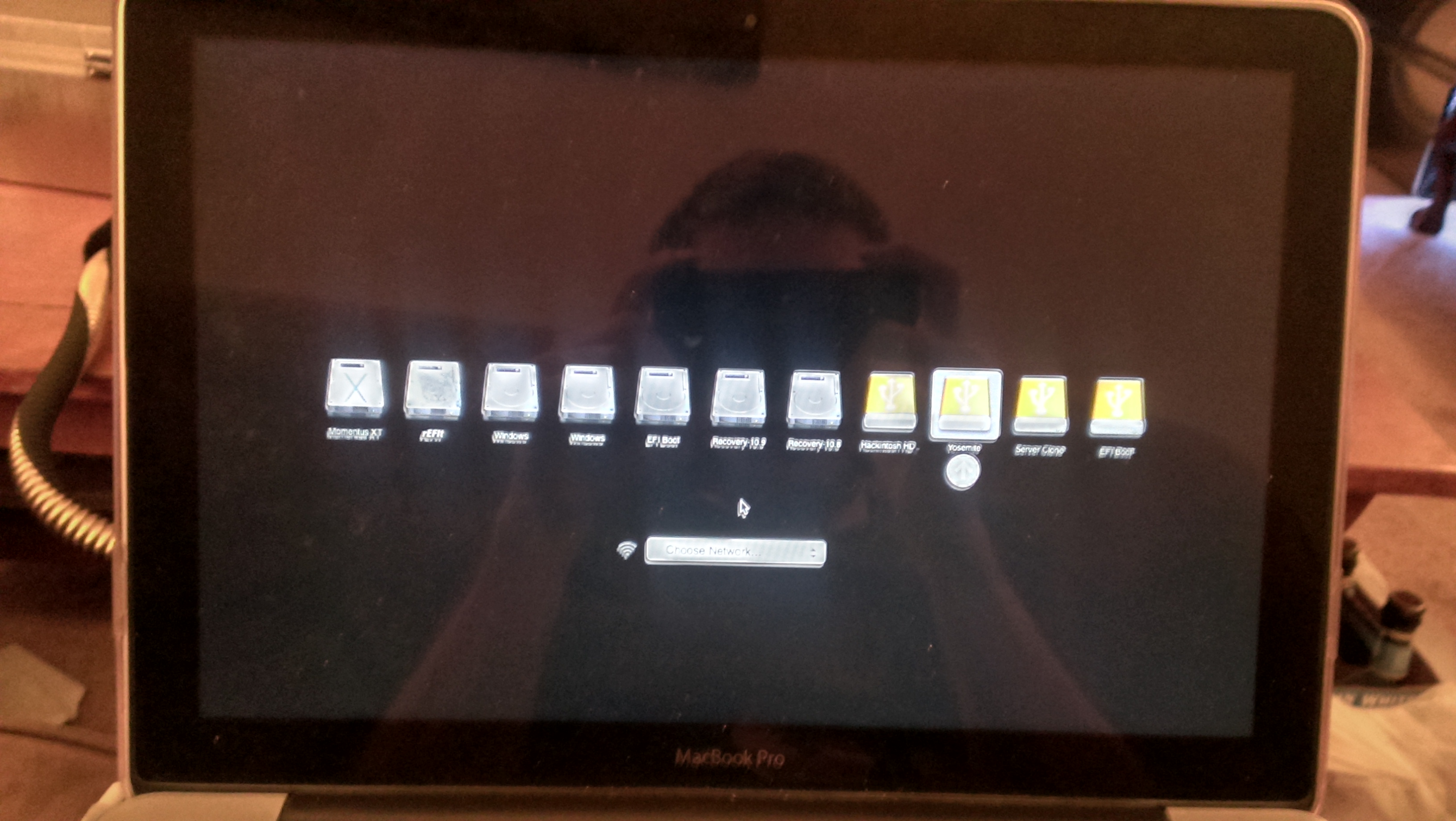

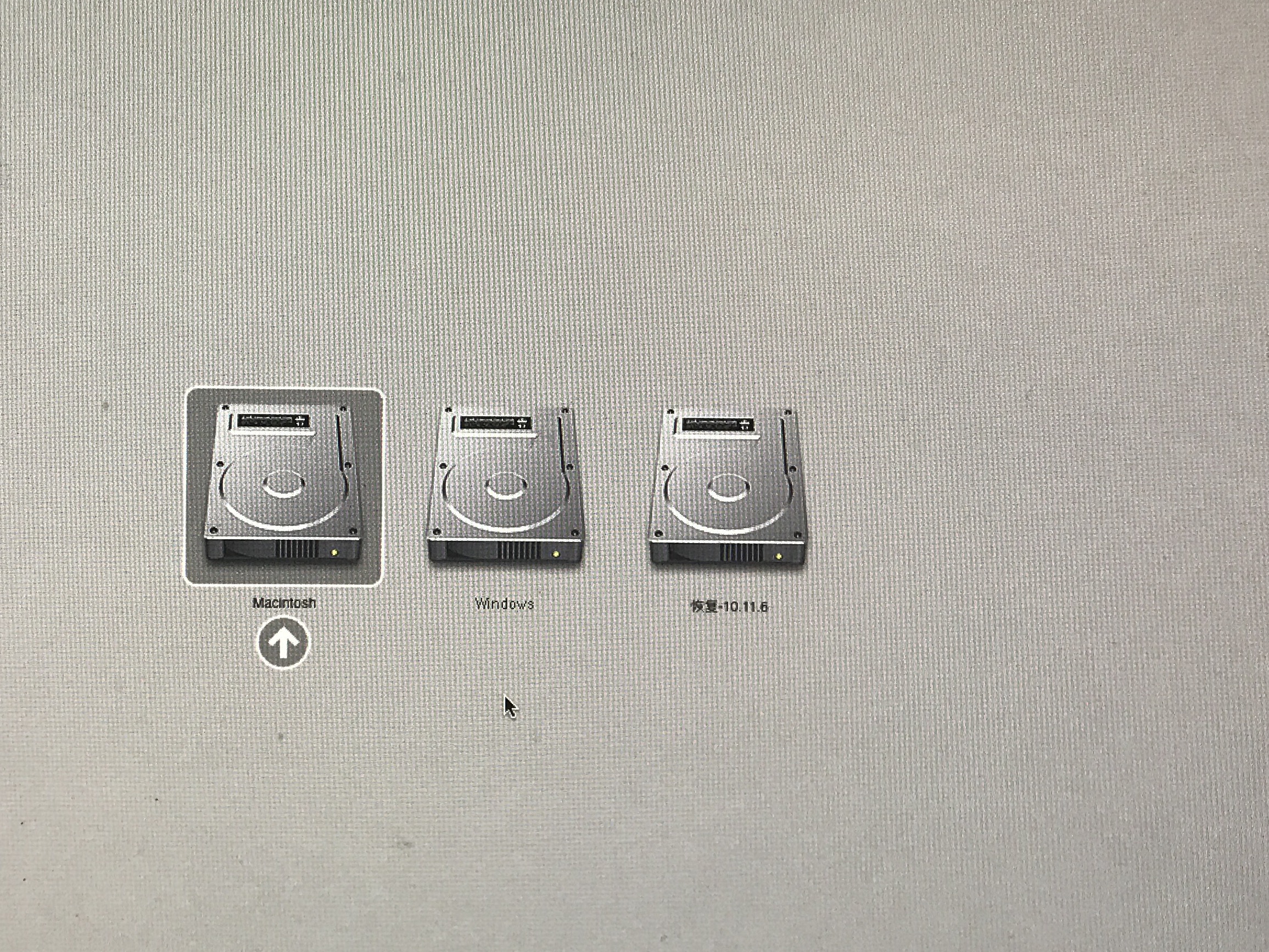

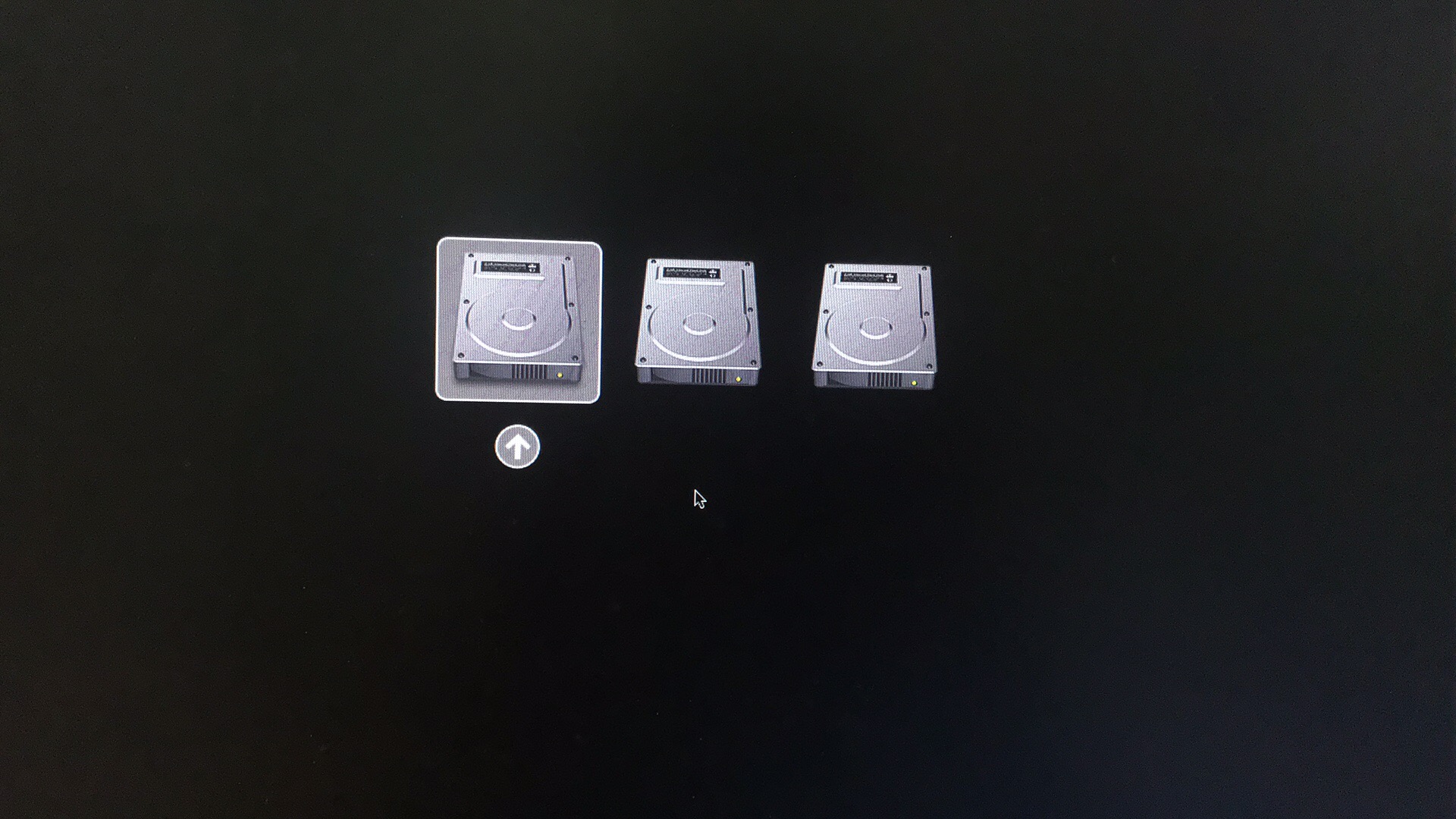

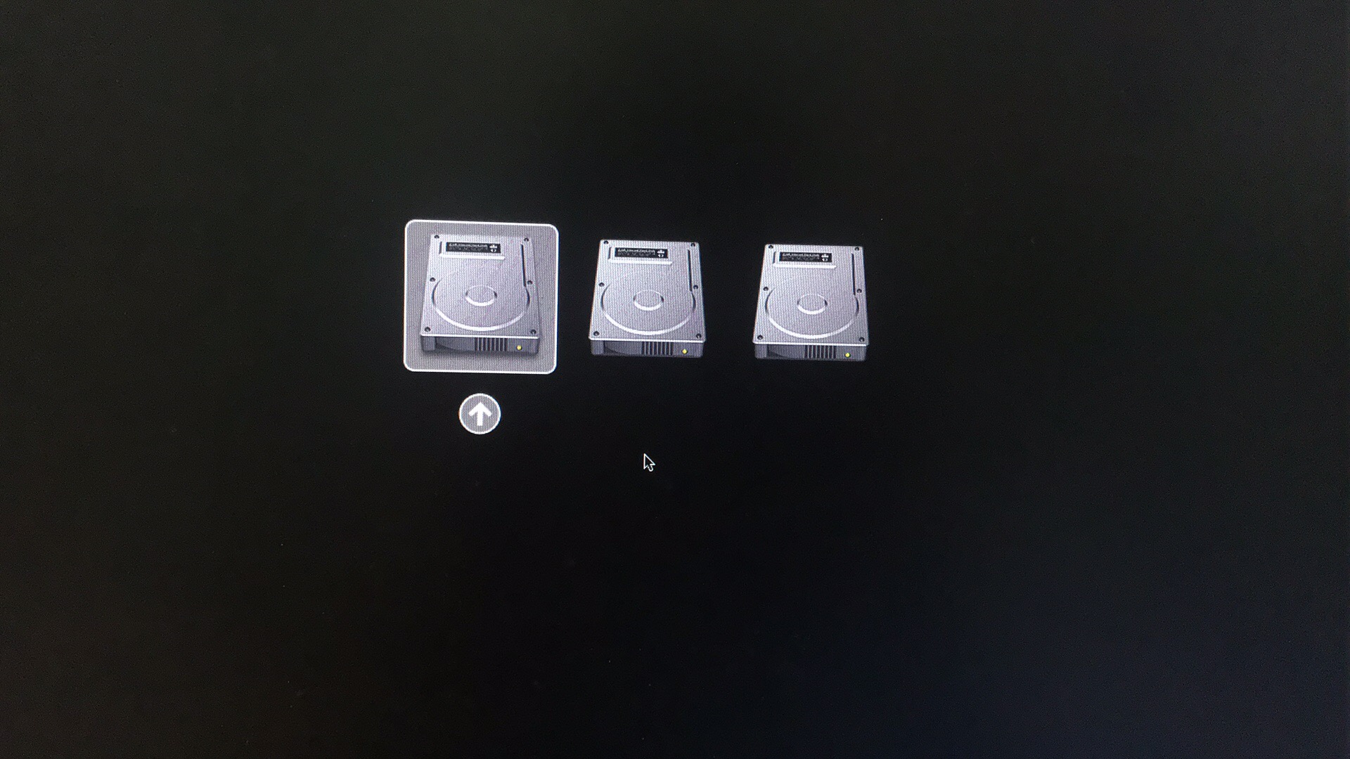

NVRAM. This is using the method posted by dabrain13 earlier in this thread just automated. The EFI hack stuff from earlier in this thread is dead, and good riddance, it was terribly unsafe.
I use your dark boot app it can change my boot screen to dark boot screen, but It has a problem in boot menu. The select disk text is miss . I THINK THAT MAYBE THE TEXT COLOR STILL BLACK. It maybe has some other command to change the text color
