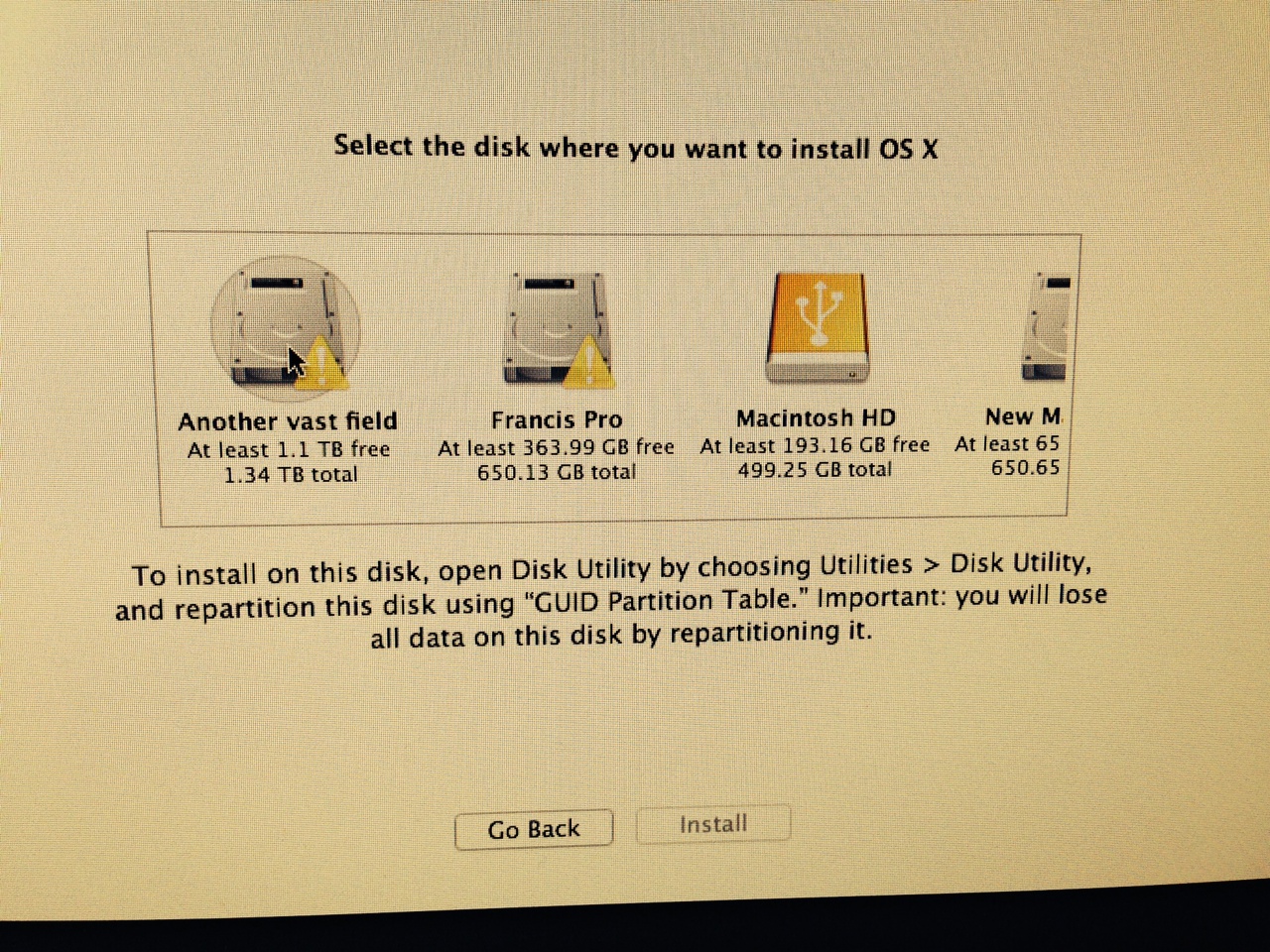

My fight so far - any hints?

Please don't spread misinformation. Most definitely, the Mavericks installer does NOT require a GUID partition.
Peter,
I'm "spreading" what I saw. The installer DID refused to install Mavericks on a partition saying it could only do so on a GUID-partitioned hd.
Here you go. Or shouldn't I spread this as well?
Peter,
You are spreading ABSOLUTELY WRONG, FALSE information. The demonstration of its UTTER FALSEHOOD is obvious: My Mavericks installer partition resides in a MBR-partitioned disk. I designed it that way, because that disk contains: 1) The Chameleon boot, which MUST reside in a MBR disk; 2) the Mavericks installer partition; 3) my backup unit.
So, no matter what you may have seen or failed to see, you completely misunderstand what you see. Once again, stop spreading absurd information, and don't give advice about what you so blatantly are ignorant of.
Don't confuse the installer partiion (which needn't be GUID) with the Mavericks installED partition, which SHOULD be GUID).
EDIT: To clarify the matter: The Mavericks installer partition is the partition that contains everything necessary to INSTALL (not run) Mavericks. This partition NEEDN'T be GPT. Naturally, the installer itself will complain if you try to install Mavericks to a non-GPT disk (where Mavericks is to be run).

Contrary to you, I prefer to keep the discussion in a civilized tone, and I won't proceed to this rude tone of yours.
I do have Mavericks installed on an MBR partition, which does NOT mean it was originally installed like that, as obviously the installer refuses to do so.
My information was not false, Here's what I said:
I couldn't install it on the same disk, as the installer requires a GUID partition. So I installed Mavericks on the other disk (disk B), over a Mountain Lion partition. It didn't complain, and installed perfectly.
While what I said can be read as "the installer requires for itself to be on a GUID-partitioned drive", what I meant, of course, is that the installer requires the destination partition to be in a GPT-partitioned hd. I may not have given all the detailed info, which does not mean I gave false information. This was done the same way as you when you said (and then edited later) that you've got a Maverick running on an MBR-partitioned disk (which I've got as well). You are of course omitting that you didn't install it that way, which doesn't make your info false, just incomplete.
So before behaving in such an aggressive way in a public environment and demand 100% correctness of people (arrogantly so, by the way), you should apply the same standards to what you say here as well.
