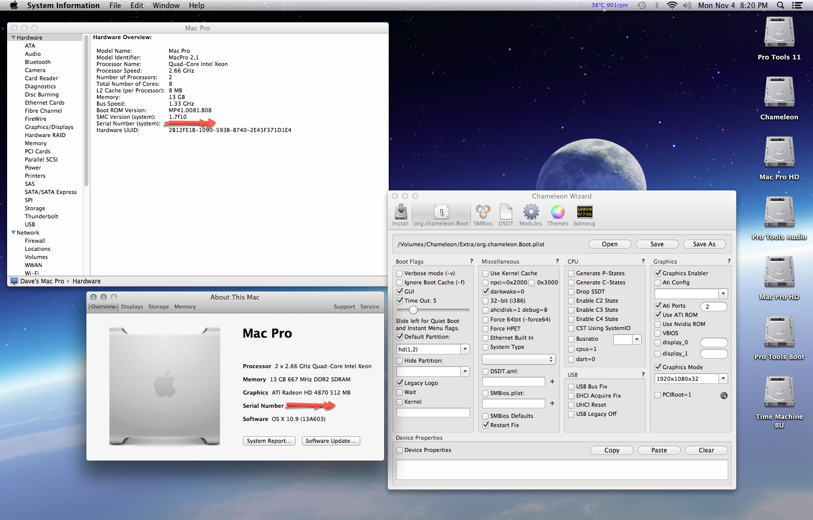

So I tried doing this hack a second time to make my partitions the sizes that I really needed and it went without a hitch. I can't believe how simple it is. It seemed so daunting in the beginning, reading so many posts and people doing this differently. I guess it really comes down to your set-up and whether or not you have another Mac laying around which supports Mavs to install from. I got Pro Tools 11 to run with no problems...yet. Here's a screenshot of my bootplist. Like I said, it may vary depending on what other OS's you are planning to use like Windows.
**One thing I have noticed in regards to Chameleon when it boots up... If I don't use the arrow keys to show all of my disks and select a startup disk right away, when I choose one it has a kernel panic. Otherwise, if I choose a disk to boot up with fairly quickly it boots perfectly. OK... now we just need to work on those 10.9 bugs out there

Enable the Kernel option and select mach_kernel from the drop down. Why do you bother with darkwake and the two ATI options?
When I checked the kernel it wouldn't boot. darkwake seemed to help with it not crashing after waking from sleep. The ATI was because my video card wasn't being read correctly.
Also... I think someone on here earlier said something about lowering the timeout setting. When I did that it crashed
When I checked the kernel it wouldn't boot. darkwake seemed to help with it crashing after waking from sleep. The ATI was because my video card wasn't being read correctly.
Post both your plist files if you wouldn't mind and I'll have a look at them. This is the stock Apple 4870 or something else? Also, please list all the other files residing in your Extras folder.

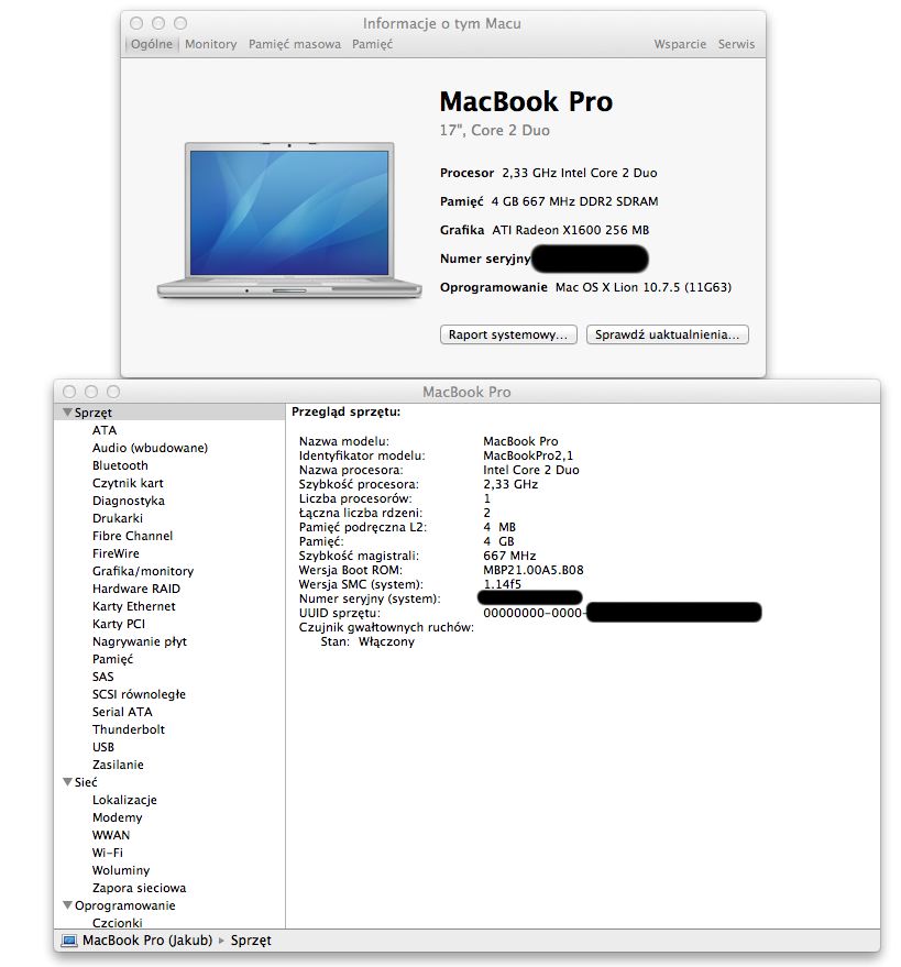

Please Help
Do You know any way how to install Maverick on old MacBook Pro?
My spec:

After looking over your boot plist some quick points:
1. You shouldn't need to have the AtiPorts flag set unless GraphicsEnabler isn't auto-detecting it. To verify you can remove this flag and after the next boot open up the bdmesg log in Chameleon Wizard to see if it is or not. Since you're running with a flashed 4870 are you having any issues with QE/CI?
2. The UseAtiROM flag is doing nothing for you unless you have the ROM for the card sitting in your Extras folder and you didn't mention it. This can be removed.
3. This is purely personal preference but do you need to use a theme with Chameleon? Why not just let it boot straight to Darwin?
4. I'm still not sure the darkwake flag is doing anything for you. When you say your system would crash after waking from sleep do you mean a kernel panic or the UI simply froze up? Flashed PC graphics cards have always been hit or miss when working properly with system sleep. I assume you used a tool like Zeus to add the EFI patch to the cards ROM?
Your SMBios is fine and, aside from a few key entries, purely cosmetic anyway. As you're running an actual Mac and not a hackintosh you don't need the Resolution.dylib file and there's a tweak mentioned earlier in this thread that negates the need for the FileNVRAM.dylib if you're interested. I noticed that you didn't mention the presence of a dsdt.aml file in your Extras folder; oversight or do you not have one?
