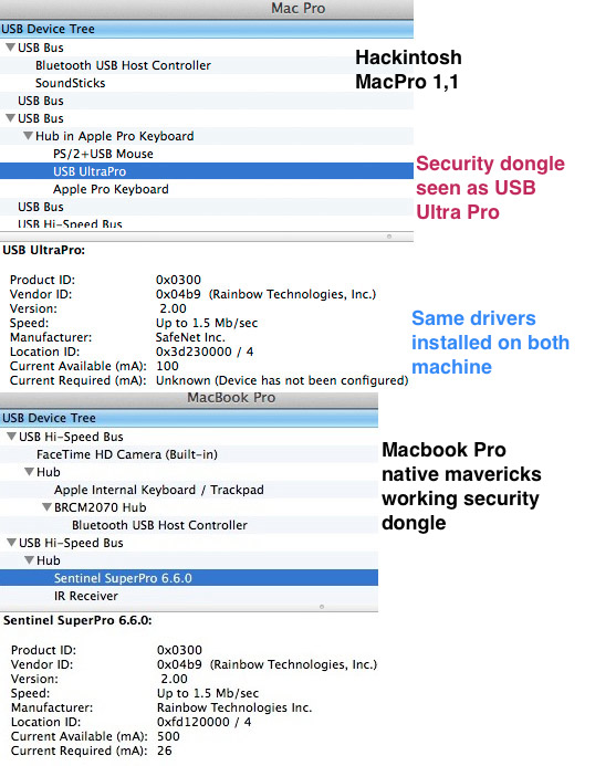

USB Dongle issue with MacPro1,1
right so i had to redo my install and did the Macbook Pro connection trick, formatted my Mac Pro drive to GUID and installed 10.9. then added a START UP Disk partition at the end of the drive of 5GB and worked a treat with no issues. faster and easier to install then MBR method.
Im having only one issue which is a bit a deal breaker for me at this point.
USB ports are working but devices plugged into them aren’t being seen correctly.
I have a “sentinel SuperPro 6.6.0″ dongle but the MacPro 1,1 is seeing the same USB dongle as a “USB UltraPro” so the security drivers won’t work with it and won’t authorise my 3D software to use.
works fine on my Mavericks macbook pro but not the MacPro 1,1 hackintoshed. anyone have this issue ? any solutions ?

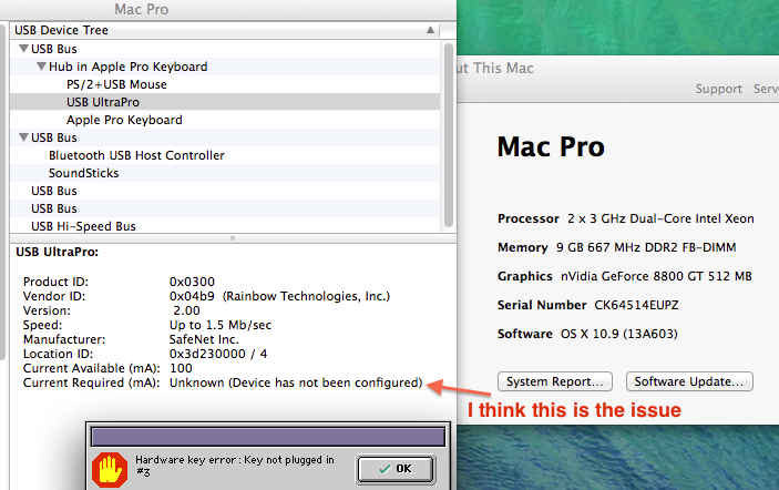

here si an image of the issue. thanks

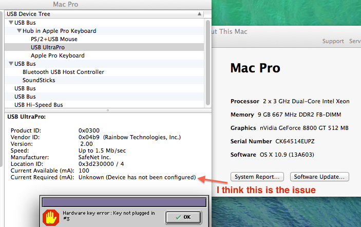

I think it has something to do with the configuration of "Current required" is unknown while on the working Macbook pro is set to "current required: 26"
ill have a check on another computer that i haven't installed the security software on to see what it does.
That would suggest that the drivers are not installed.

oh and i tried the dongle on a mavericks native machine and I'm getting the same report as the Mac Pro for this dongle so it seems it might be the drivers. but since i did install the drivers on the Mac Pro and it still didnt work i thought it must something conflicting or not allowing the drivers to to see the dongle and so the drivers aren't working on the Mac Pro.

Right did a fresh install of Mavericks on the MacPro and its a combination of things. first the Safenet drivers are 100% compatible with Mavericks but do work. the fresh install shows the same "current" missing issue and incorrect name of the usb port but runs the software. which means my migration transfer brought over some 10.6 legacy crap with it and is conflicting with the install of the current drivers.
thanks guys for helping me figure this out. annoying but got there in the end. now i just need to figure out how to uninstall the legacy drivers and current drivers and try to fix it that way. don't want to reinstall from scratch but i guess that is the worse case scenario.

Figured out the Dongle issue. it was three rouge drivers in my library/framework that where patches to make the dongle work in Lion. so all is right in the world again. and working great.
