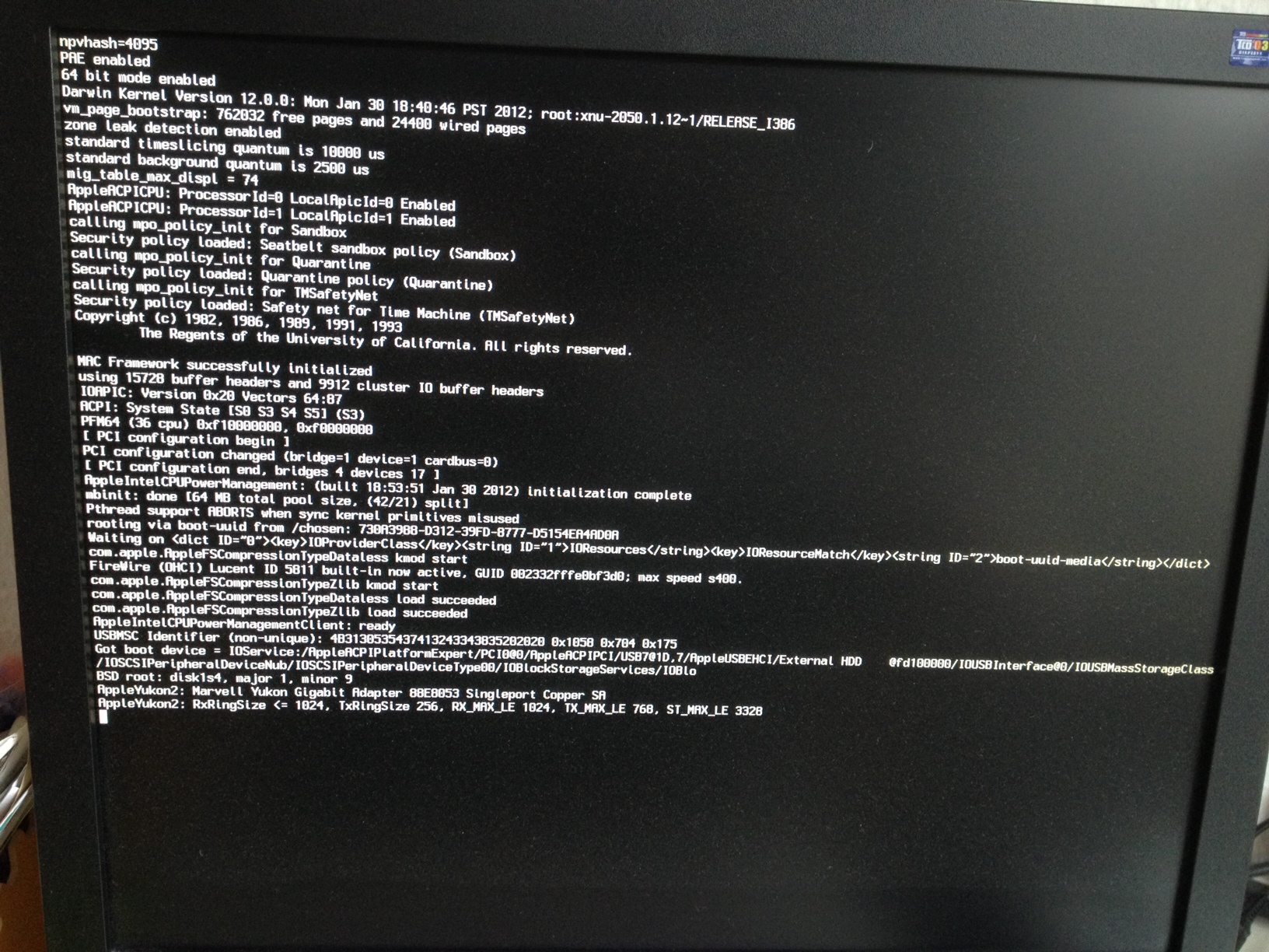

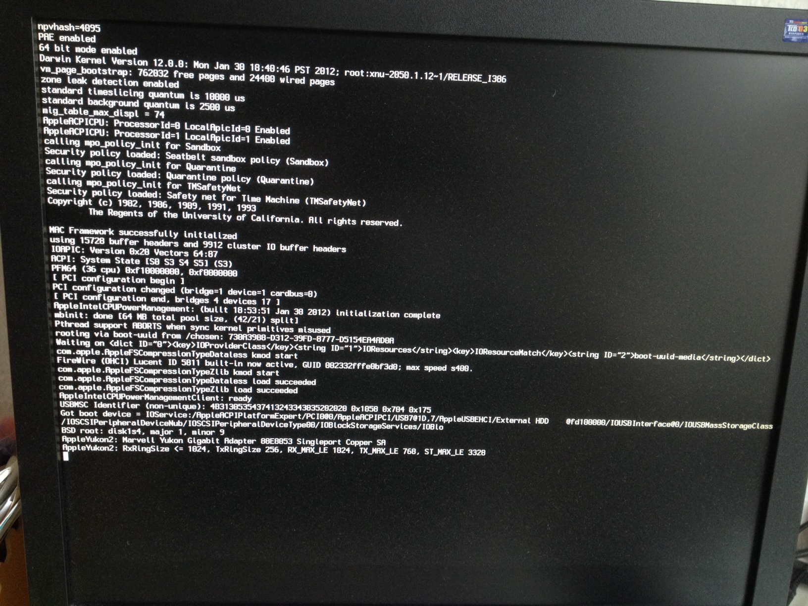

I am now trying to get OS X Mavericks Golden Master up and running.
The 64-bit Intel GMA kext doesn't look promising, hence I'd like to stick with the Mountain Lion PostFactor mixture of kexts and mach_kernel.
I installed Mavericks (using a supported machine) to my USB harddrive, applied MLPostFactor on it (->10.8.4), reworked "SystemVersion.plist", added the Board-ID and Model-ID to PlatformSupport.plist, replaced the boot.efi with the MLPostFactor one (from the installed 10.8.5 system), "blessed" the boot.efi and rebooted...
To make a long story short: It doesn't work.
The kernel and its extensions gets loaded, but "launchd" doesn't show up in verbose mode. The system freezes (keyboard is ignored).
(Screenshot attached!)
My question is: Is there a solution for this, beside switching to 64-bit mode?
Or is that the end of i386-mode PostFactor?

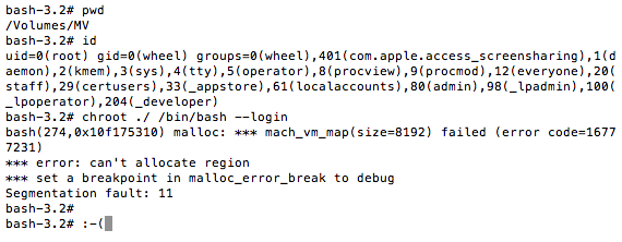

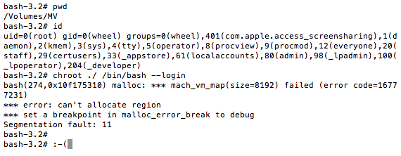

EDIT: Not even 'chroot' is working... 🙁 (Screenshot attached)
Indicates massive under-the-hood (API) changes 🙁
Chroot itself works fine -> "chroot"-ing into the Mountain Lion installer partition works flawlessly.

😛 Did you seriously expect to boot Mavericks with a DP1 ML kernel, Lion 10.7.5 graphics kexts and several other older stuff? 😱
Mavericks is 64bit only from the onset (i.e. DP1) and in the absence of stable 64bit graphics kexts for older GPUs, I very much doubt MVPF will ever see daylight.
