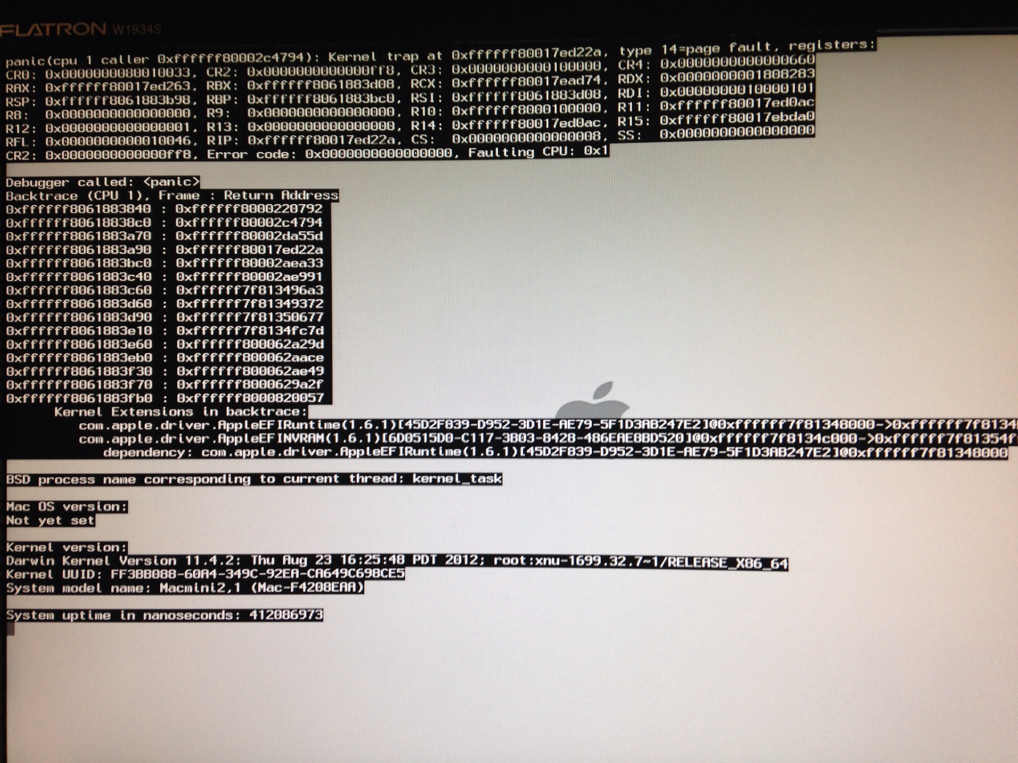

First off, a massive thank you to everyone who's contributed to this thread - it has been an incredible help and I now have 10.9.4 running successfully on my late 2006 iMac. I need it to run Xcode 6, so you guys saved me from having to buy a new computer! :D
Unfortunately, I messed up at the very end and have damaged my original Lion OS. In short, while trying to get the Maverick OS partition to boot, I accidentally installed tobyg's Mac Pro Fix (found here: https://forums.macrumors.com/posts/18829695/) on my main Lion OS. This meant that after rebooting, it replaced the boot.efi files made by Apple with the Tiamo version (found here: https://forums.macrumors.com/threads/1598176/). Now, Lion OS will not boot. I get a black and white screen with text for a few seconds, and then the Mac restarts - it never boots.
I've attached a picture of the error I'm encountering below. I actually got this picture from earlier in the thread, but no solution was offered - the user just reinstalled everything. While I do have most files backed up, I really don't want to wipe my Lion HD.
attachment.php
It seems to me that I should just have to restore the files that were changed by tobyg's program, and it should boot up again, but I don't know much about this sort of thing. I really need my Lion OS back for next week, so I would sincerely appreciate any suggestions!
Regardless, thanks a lot for reading!
Unfortunately, I messed up at the very end and have damaged my original Lion OS. In short, while trying to get the Maverick OS partition to boot, I accidentally installed tobyg's Mac Pro Fix on my main Lion OS. This meant that after rebooting, it replaced the boot.efi files made by Apple with the Tiamo version. Now, Lion OS will not boot. I get a black and white screen with text for a few seconds, and then the Mac restarts - it never boots.
Even if the reply comes a little bit too late:
Download from Apple the 10.7.5 Combo Update, mount it and extract the Boot.efi with Pacifist from /usr/standalone/i386 . Then replace the Boot.efi in /System/Library/CoreServices/ as well as /usr/standalone/i386 on the Lion partition.
Not at all, I sincerely appreciate the help (it turns out I didn't need it fixed that fast anyway - I could still access my old programs from the new partition)! Thank you very much for the solution - I'll give that a go =D
EDIT: Well I got the Boot.efi file out with no problem, and replaced the one under /usr/standalone/i386 on the Lion partition. But the one under /System/Library/CoreServices is locked - I can't replace or delete it, and can't find any way to unlock it. Again, thank you very much for your help, and if you know a way to solve this issue, I would appreciate it (hopefully if I can just replace that one file, the Lion partition will boot up again).
Via Terminal try either: sudo chflags nouchg /System/Library/CoreServices/boot.efi to unlock it or simply try to delete the Boot.efi with: sudo rm -rf /System/Library/CoreServices/boot.efi .

Thank you very much for your continued help! Unfortunately, when I tried the Terminal command it just tells me "Permission denied". I should say that I only tried the first command (the one to unlock it), not the second (to outright delete it), as I'm not sure how to specify the boot.efi file on the Lion partition (I assumed it would be 'Partition Name'/System/Library/CoreServices/boot.efi, but that didn't work).
And thanks for the suggestion. One of the first things I did when this problem occurred was delete the com.tiamo.macprofix.plist file, but if anyone else has this issue, it's an important thing to note.
Since the Boot.efi is a System file, the command should be executed with 'sudo'. Maybe it's better to change into the /System/Library/CoreServices/ folder on the Lion partition first and then run sudo chflags nouchg boot.efi
 . You can replace the Boot.efi directly after the unlocking.
Aha! Sudo does make it work. But the only thing I don't understand is how to direct it to the boot.efi file on my Lion partition. I unlocked the one on my Mavericks partition, so obviously I just need to change the path with some special syntax (as I said before 'Partition Name'/System/etc. didn't work) and it should all be good.
I didn't really understand what you meant about "change into the /System/Library/CoreServices/ folder on the Lion partition first". I opened the folder up and tried to use the command, but that didn't work (I'm sure I'm completely missing the point haha).
Your help is greatly appreciated =)
You need to be familiar with the Unix command line. Use a search engine for a Beginner's Guide of the Unix shell commands (like cd, ls, pwd and so on). One path to the Boot.efi is /Volumes/*Lion*/System/Library/CoreServices/boot.efi
 , where *Lion* is the name of your Lion partition. You can change there with cd '/Volumes/*Lion*/System/Library/CoreServices' (in ' ' because of possible spaces) or step-by-step with cd /Volumes , cd '*Lion*' and so on. Use ls -l and pwd to look in which folder you currently are. When you reached the working directory CoreServices and see the Boot.efi with ls -l, then you can unlock it with sudo chflags nouchg boot.efi and replace the file via Finder.
Thank you so much! That worked to unlock the file and allowed me to replace it with the new boot.efi. Unfortunately, the OS still won't boot (same error as far as I can tell), so Lion's still not working - guess the fix wasn't as simple as I thought. Perhaps Tiamo changes more than just the boot.efi...
Regardless, thank you very much for all your help - that's at least one part of the problem taken care of!
Pity. Dunno what the error could be. If you unpack the TiamoMacProFix.pkg there're only the Tiamo Boot.efi and the com.tiamo.macprofix.plist. The latter one replaces only the Apple Boot.efi by the Tiamo Boot.efi while loading OSX. If the com.tiamo.macprofix.plist has been removed from /Library/LaunchDaemons/ and the "new" Boot.efi are really those from Apple (1120944 bytes of size in /System/Library/CoreServices/ as well as /usr/standalone/i386) then something else went wrong. Maybe it helps to reset the PRAM.
Pity. Dunno what the error could be. Maybe it helps to reset the PRAM.
Yes, it's very strange - as far as I can tell, everything is correct. But the booting issue only occurred when Tiamo was activated, so there must be some connection...
I tried resetting the PRAM but still no luck (when this first occurred, I thought that might be an easy fix haha).
One more try: since the boot process uses several caches, maybe it helps to empty these caches. Try to delete the kernelcache file in /System/Library/Caches/com.apple.kext.caches/Startup/ . What happens if you boot in Single-user Mode?
Okay, well I deleted the kernelcache file and restarted in Single-user Mode. I don't think it worked properly, though, as I just got a black screen with a single white underscore (_). No text appeared like it should, and I couldn't type anything.
On a normal boot up, though, things have gone a bit strange. If I just let the Mac try to boot up normally without touching anything, I get the Apple logo but nothing loads. So at first I thought this was a step forward, as I wasn't getting an error message anymore. However, if I hold the Option Key and select the Lion Partition, I get the same error message again. Perhaps the fact that it doesn't load anything on a normal boot up is part of the reason I get nothing from Single-user Mode? It's a shame you can't boot into Single-user Mode after holding Option and choosing a partition.
Also, for some reason, when I choose to Shut Down the computer via my Mavericks partition, it no longer shuts down - it just goes to a white screen and never turns off (I still have a mouse cursor and can control it).
Thanks for trying again, though - I really thought it was going to work for a minute there.
