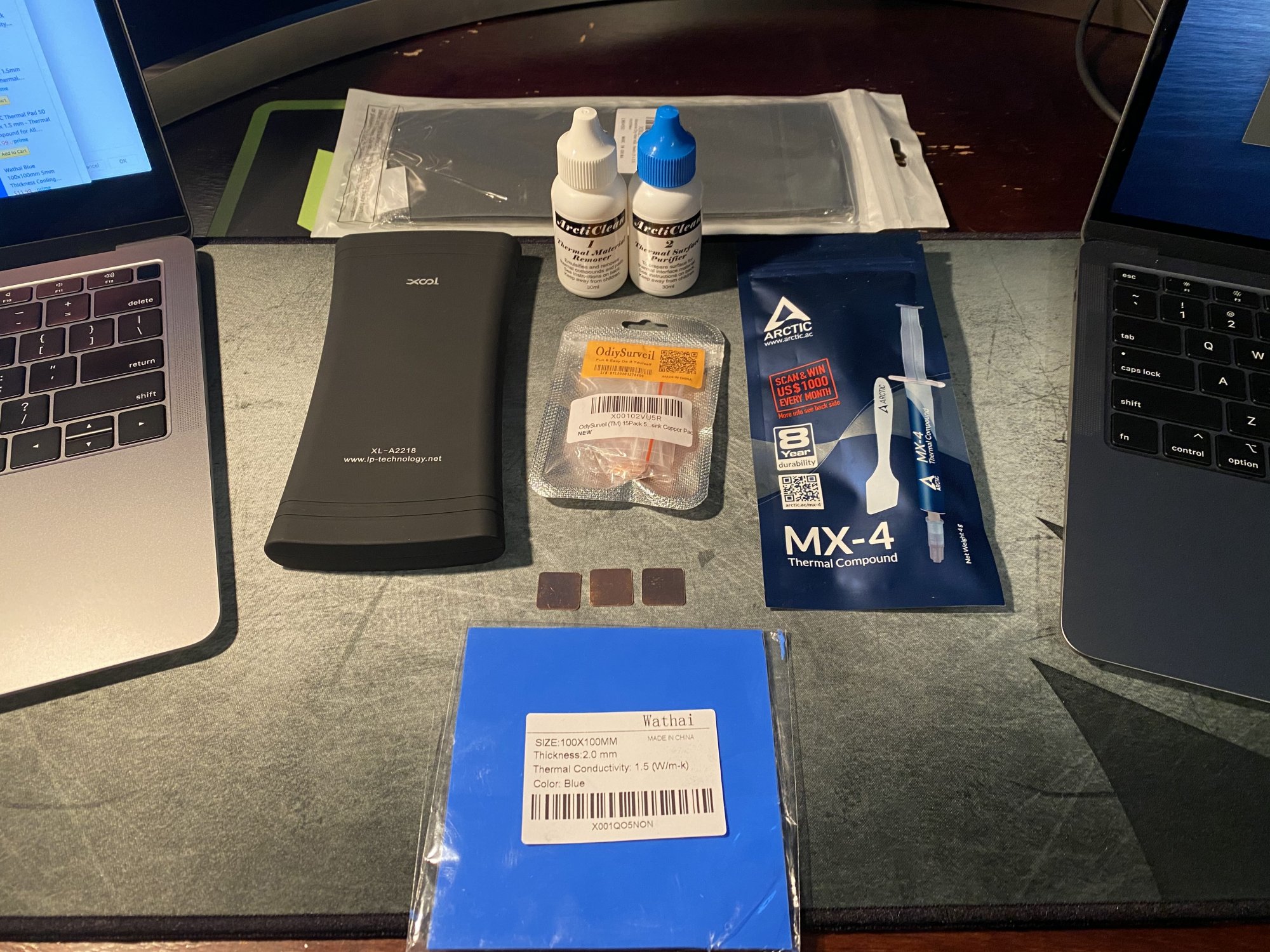

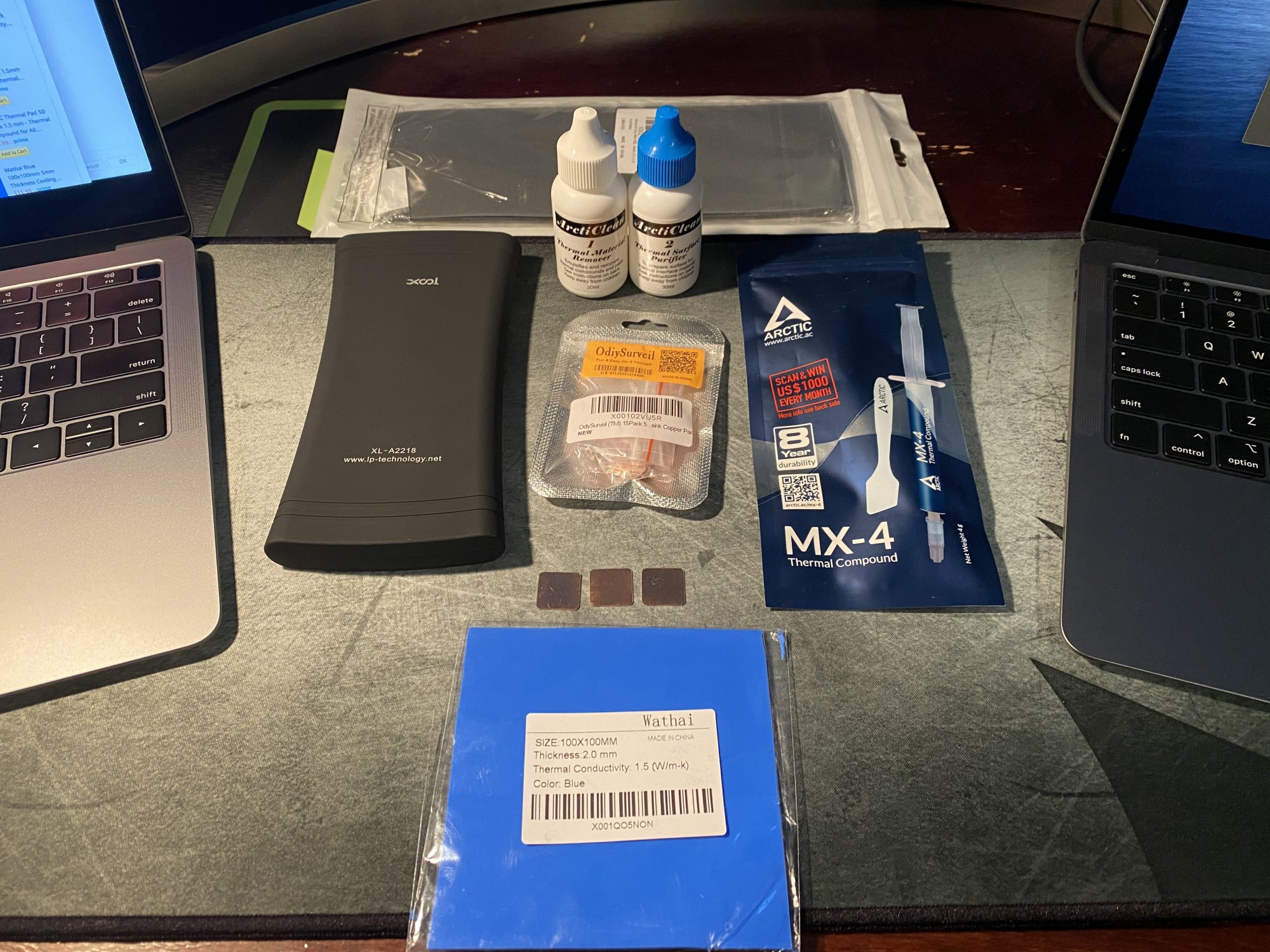

I purchased these parts from Amazon
based on others' suggestions in the megathread:

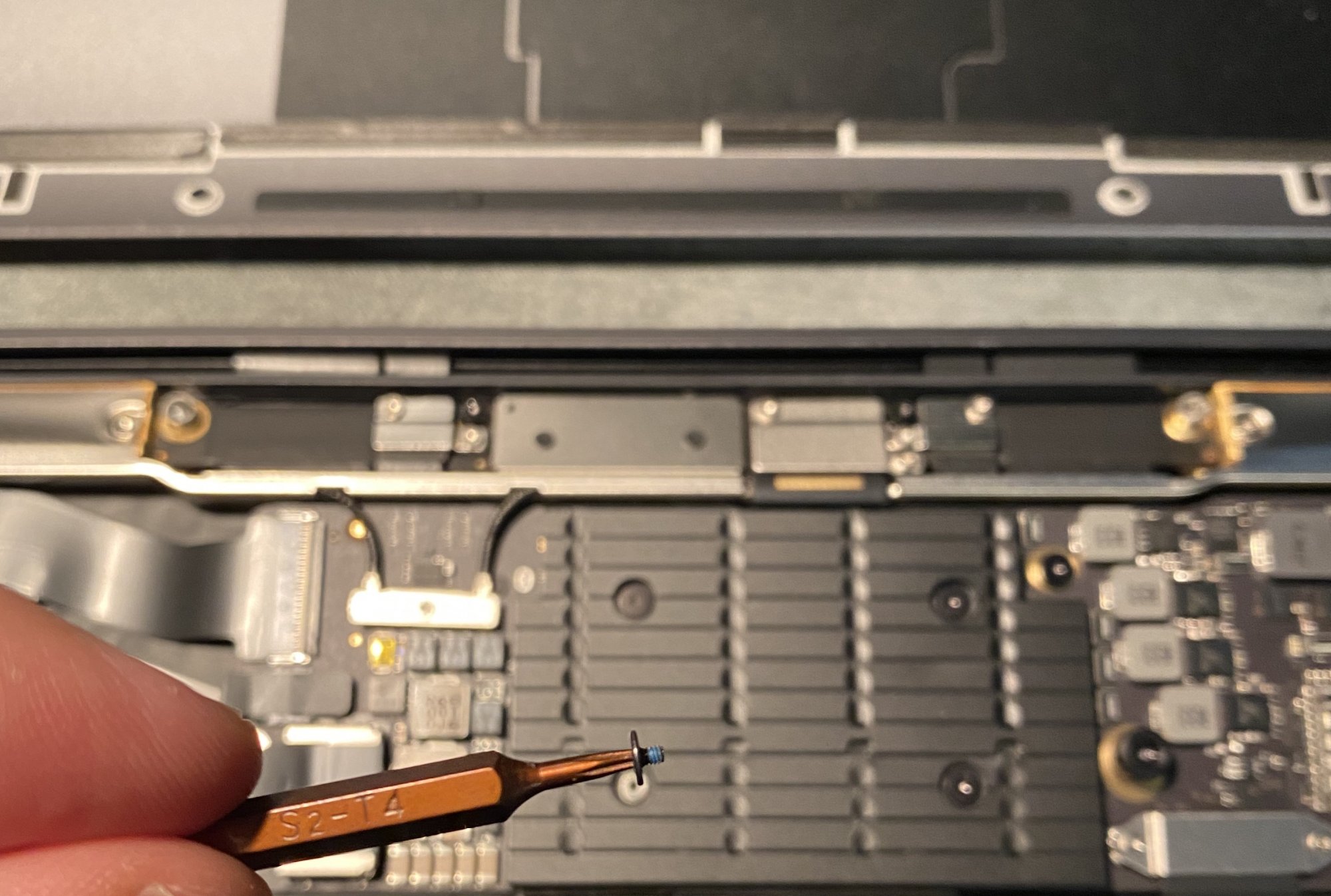

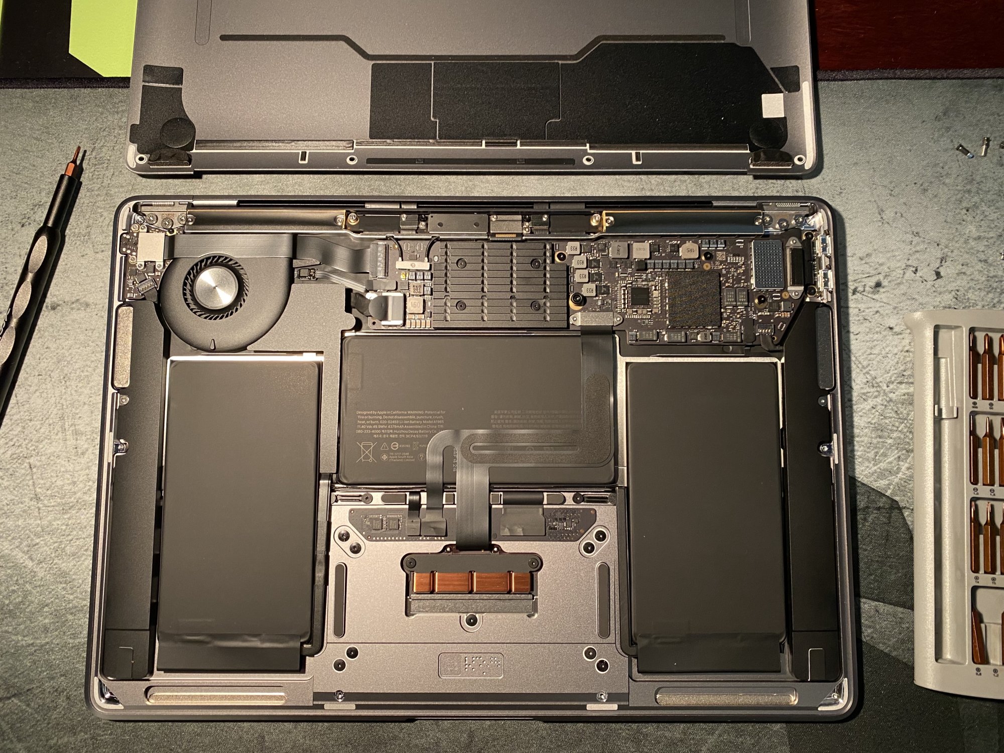

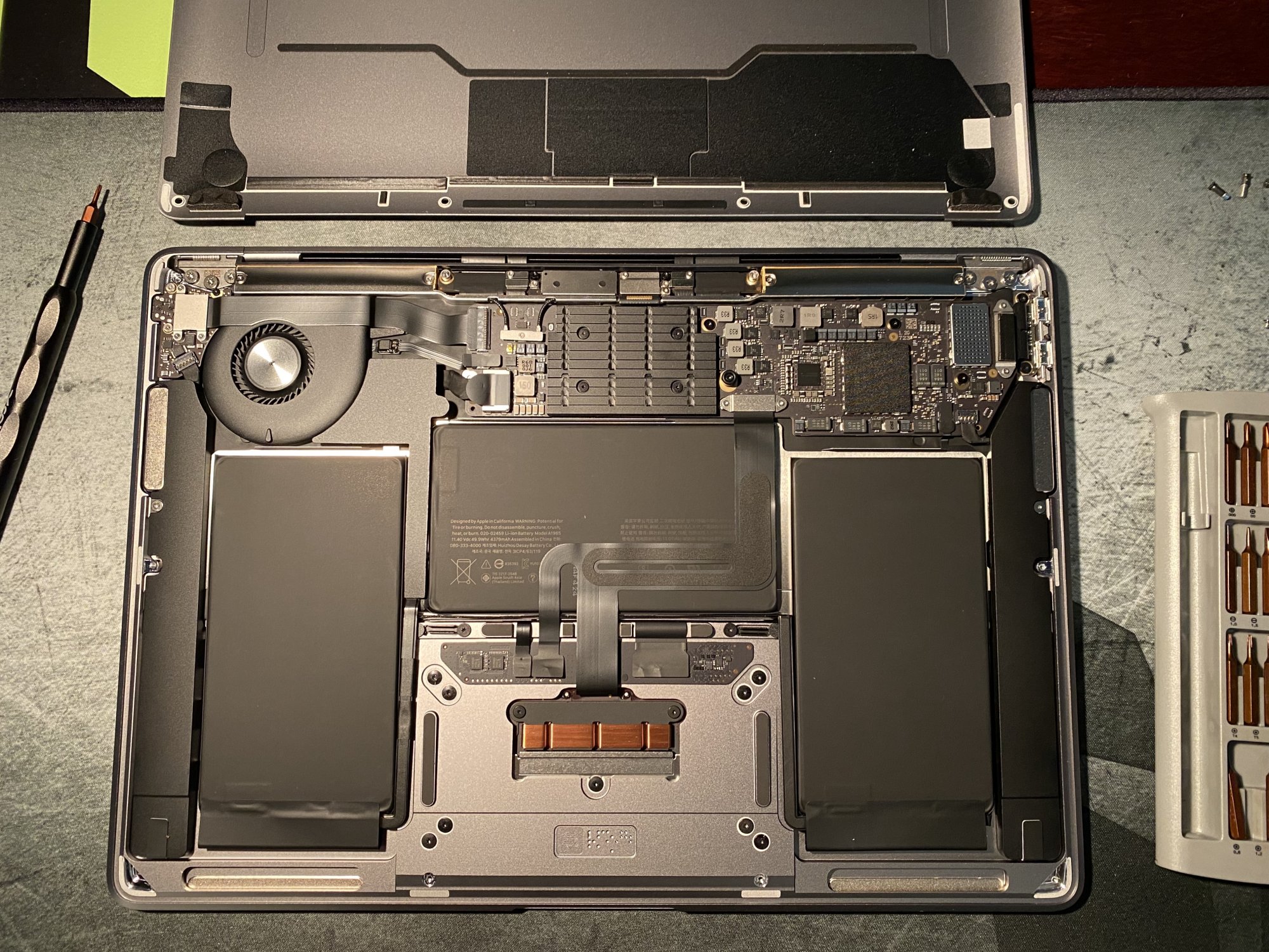

We need to take apart the MacBook's rear cover
by removing the screws with the "Pentalobe 1.2" screw head. NOTE: The four screws at the top of the rear cover are longer than the rest. Keep this in mind when you're reinstalling the screws when completed.

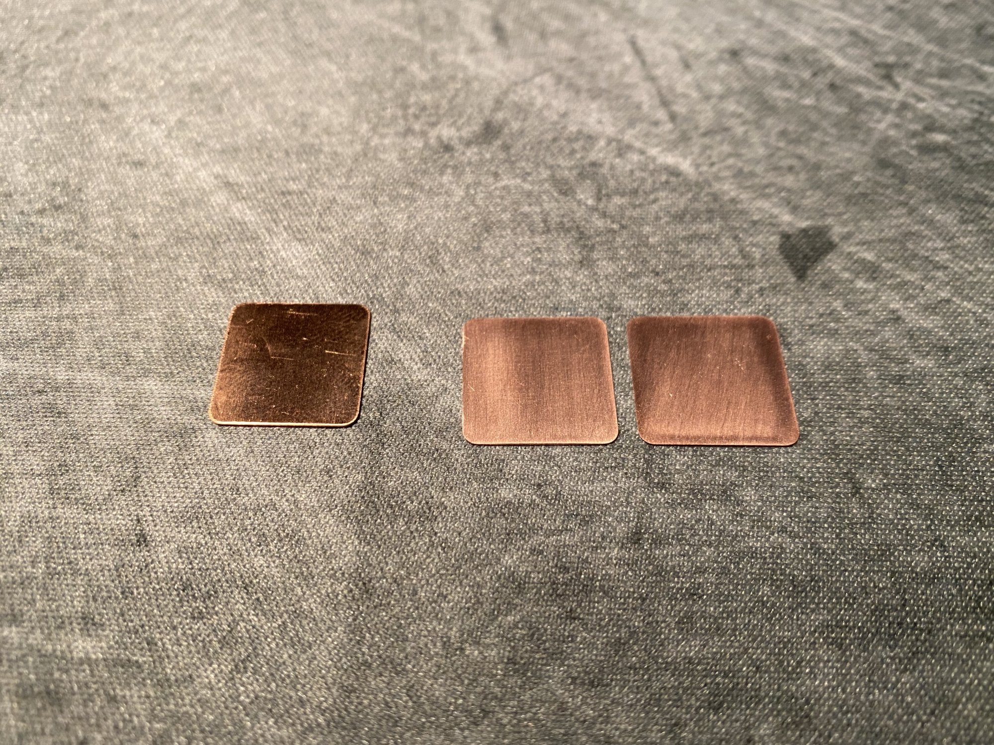

Step 3 (Optional):

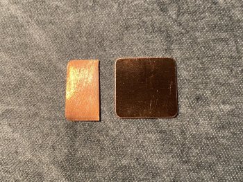

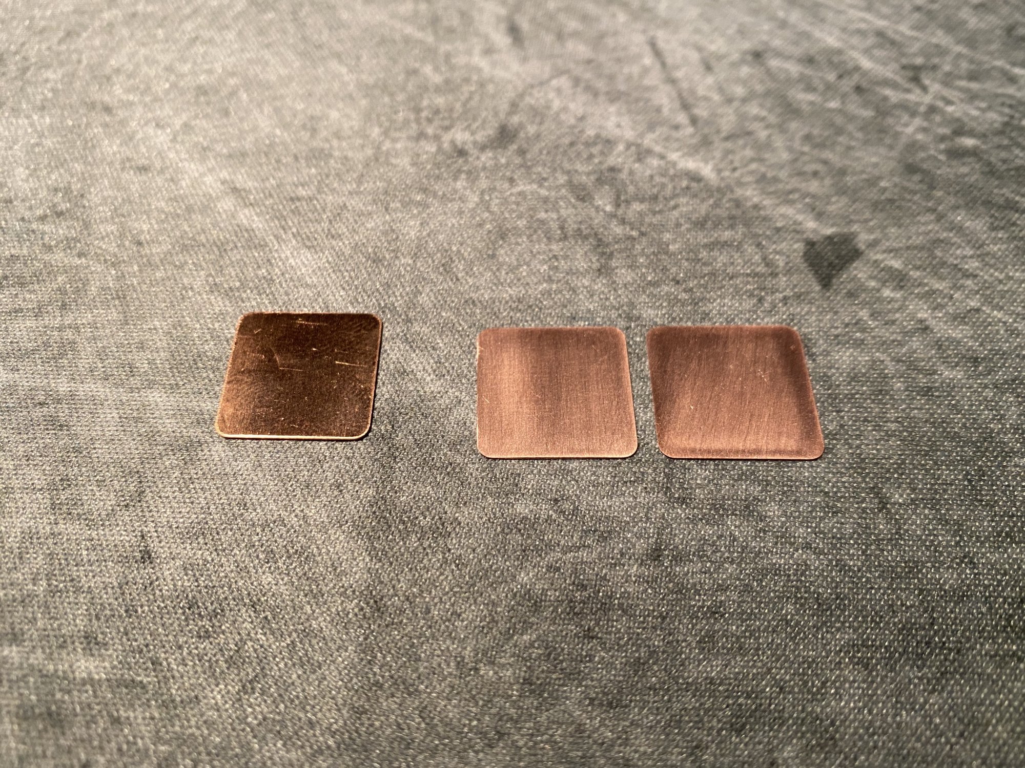

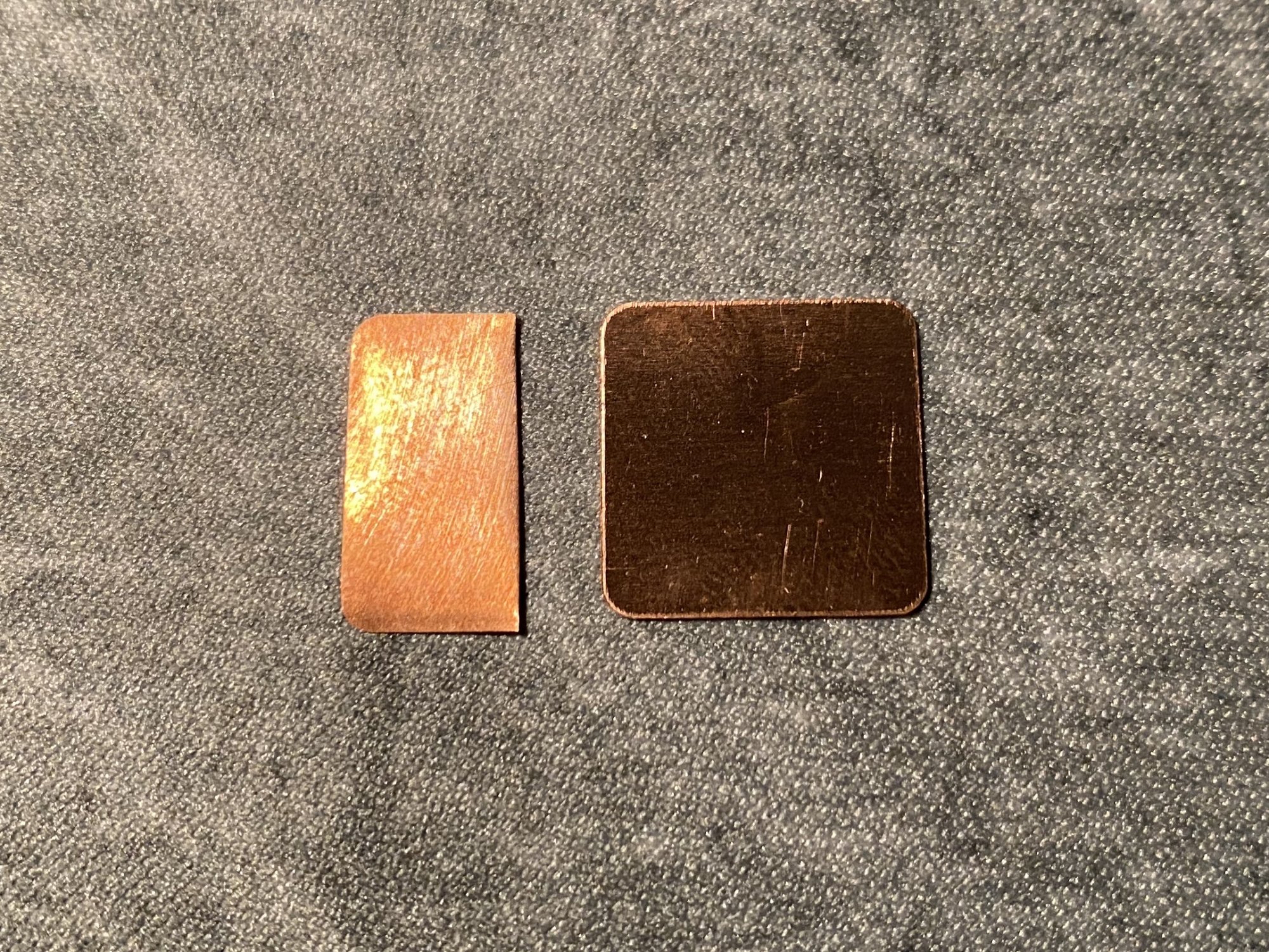

2020 MBAs apparently work best with 0.3mm shims. The Amazon product I linked above provides three (3) copper shims that are 15x15x0.3mm. You'll need two of these shims. We'll be sanding down the shims down with 400, 600, 800, 1000, 1200, and 1500 grit sandpaper in that order. To be honest, I'm not sure if this was at all necessary. It definitely removed some impurities from the shims, but I think you'll get 99% of the same performance improvements if you skip this step. I'd also caution you to avoid sanding for a prolonged period, as you don't want to remove too much material.
The unsanded/original shim is on the left; the sanded shims are on the right.

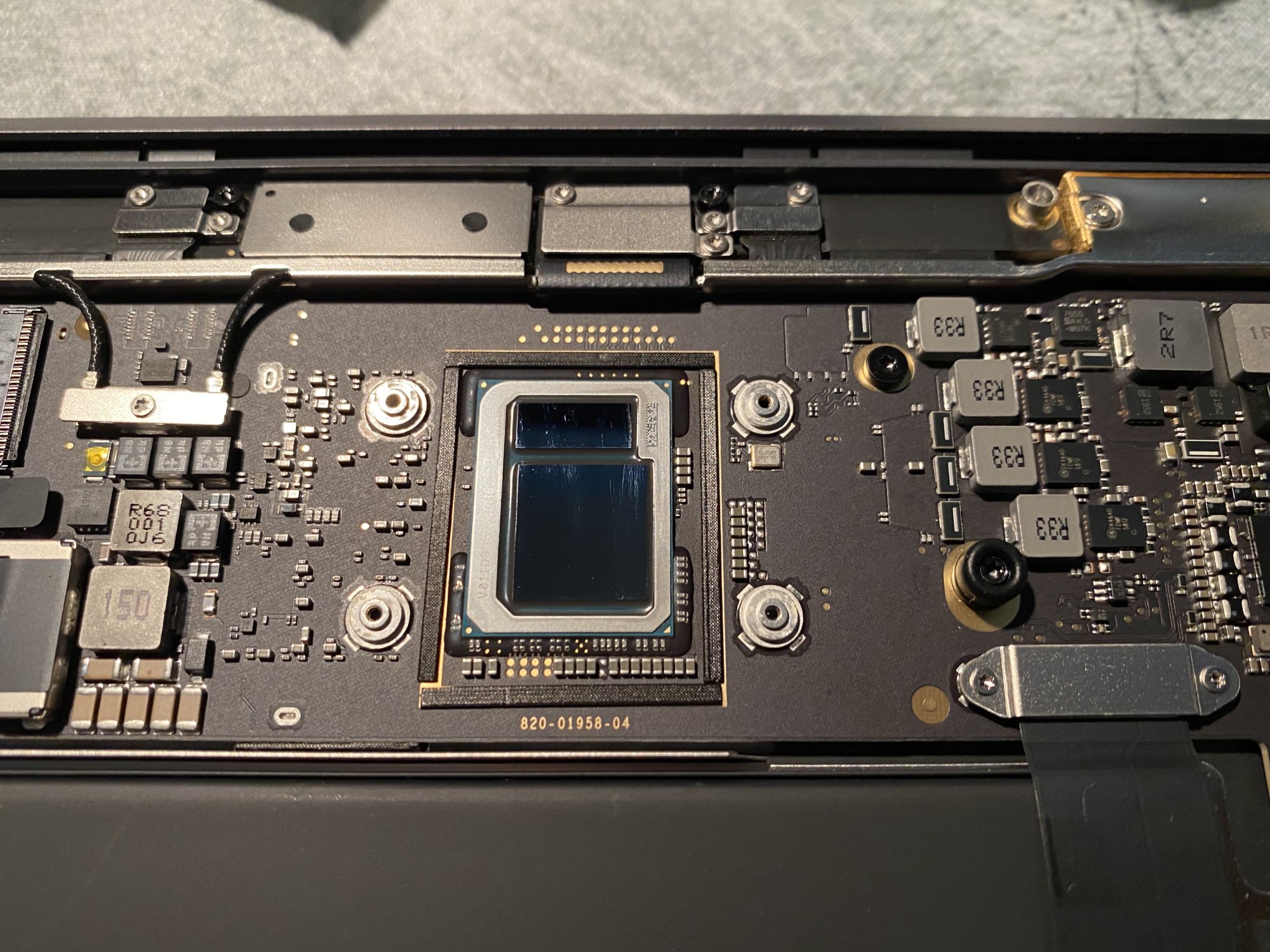

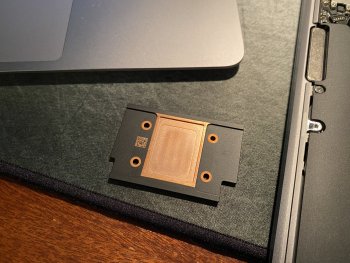

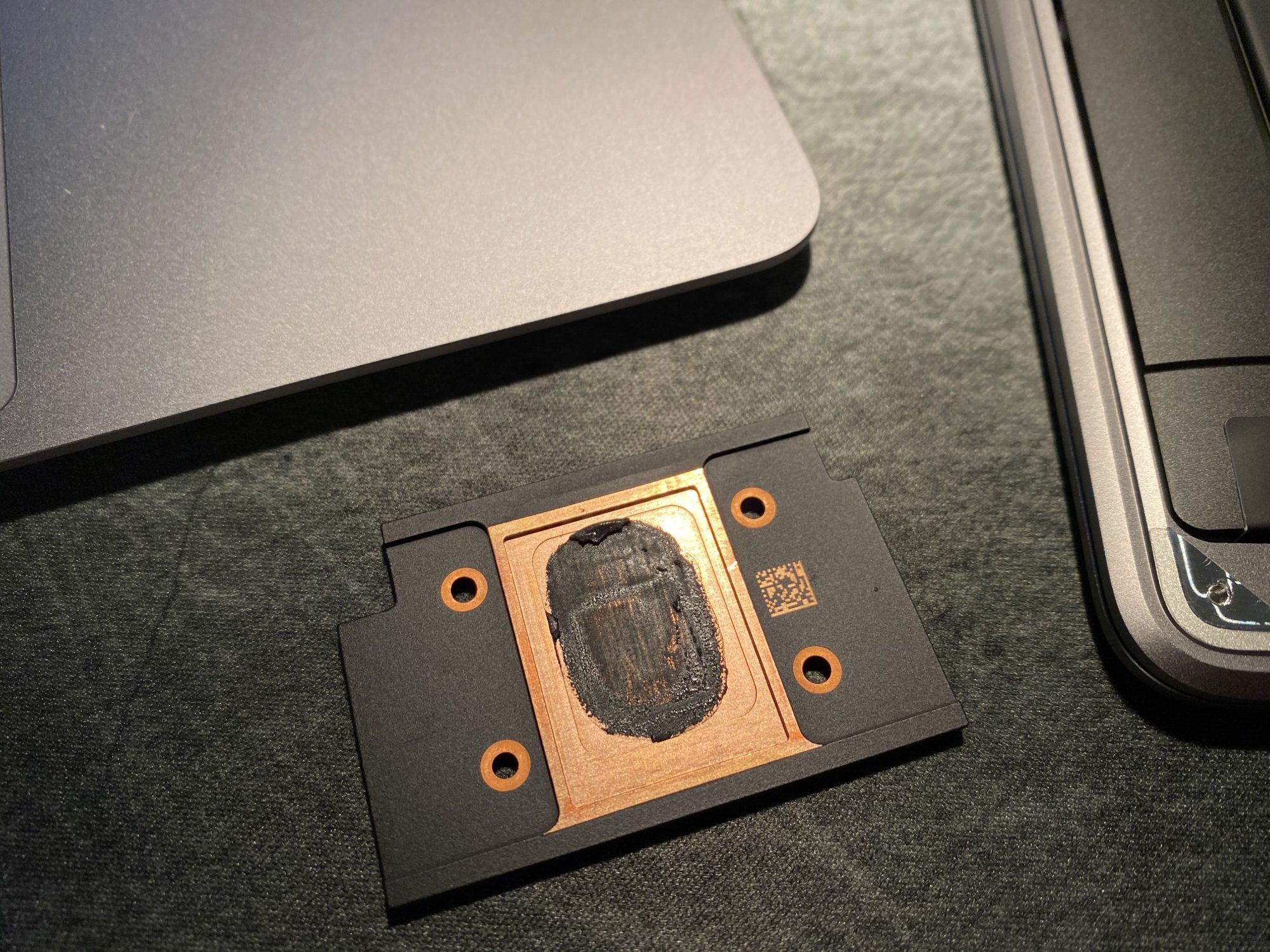

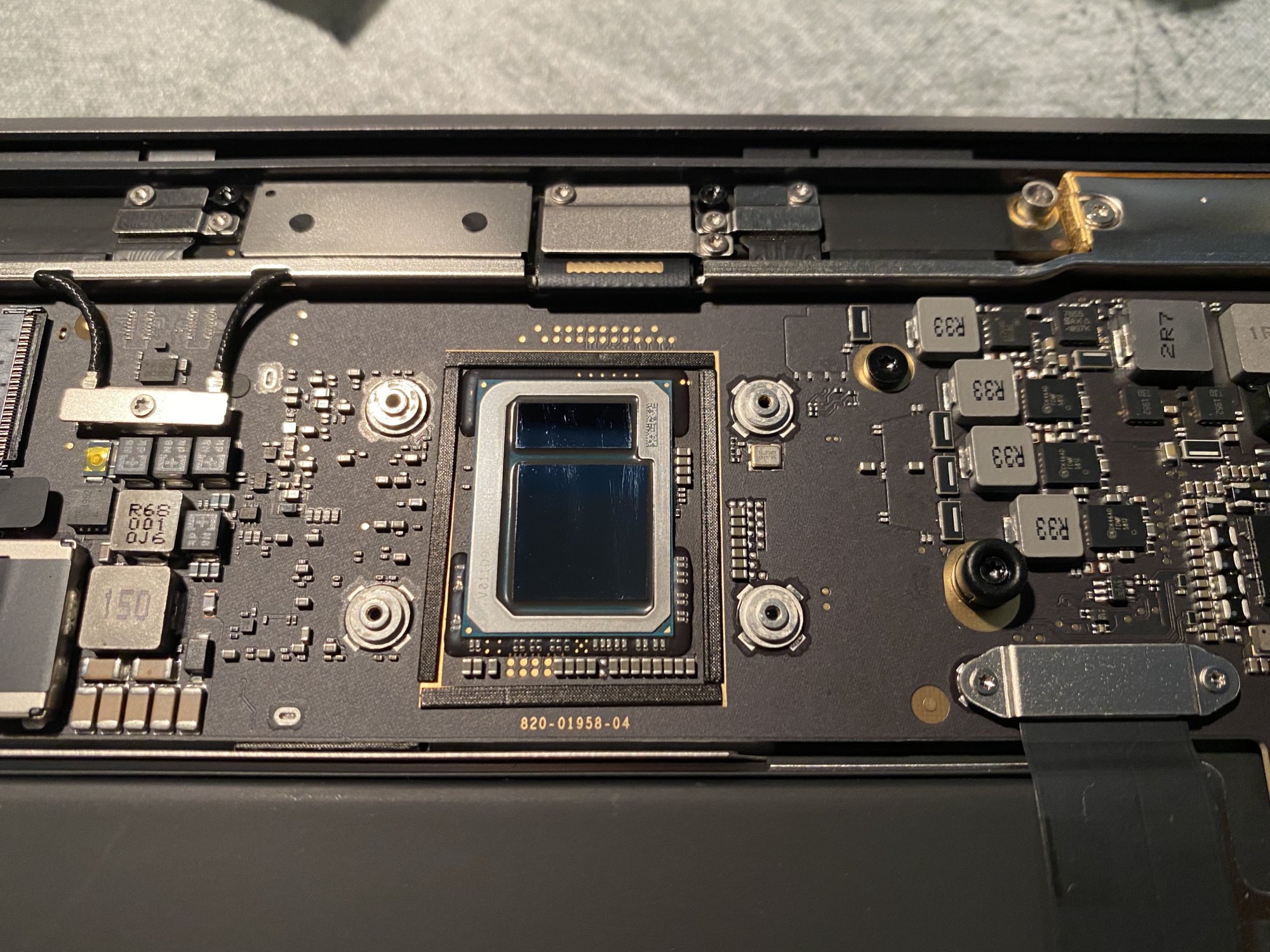

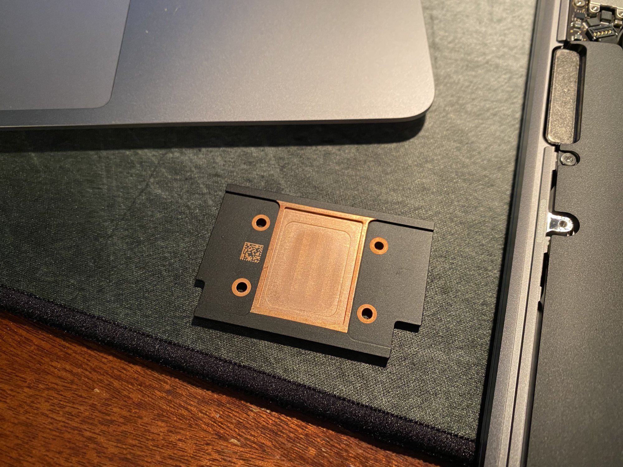

You'll need to remove the heatsink cover located near the center of the top half of the laptop (I'm pointing at it in the picture below). Note that there are four rather shallow screws that require a Torx T4 screwdriver head to open. These are NOT the same Pentalobe screws that you removed from the MacBook's rear cover.
Step 5:

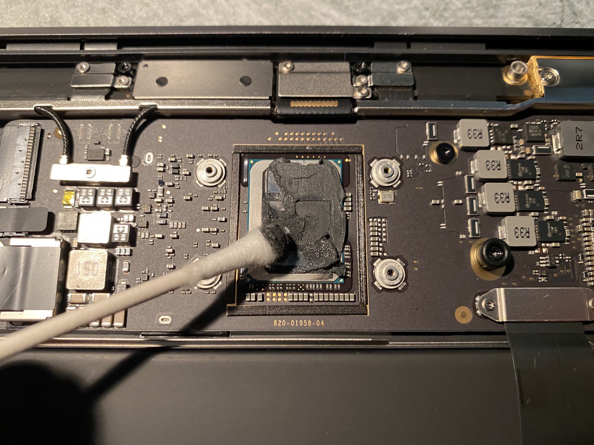

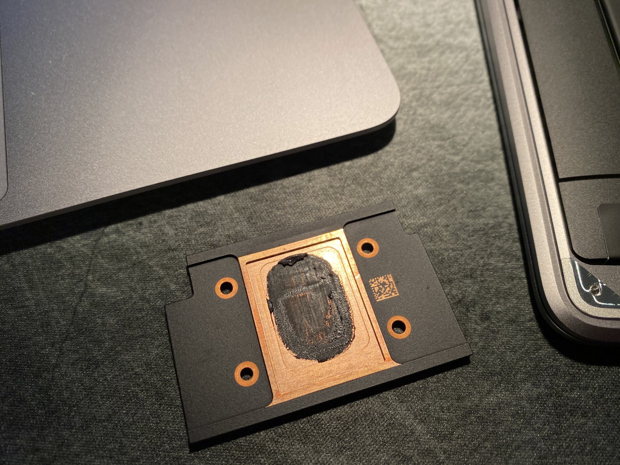

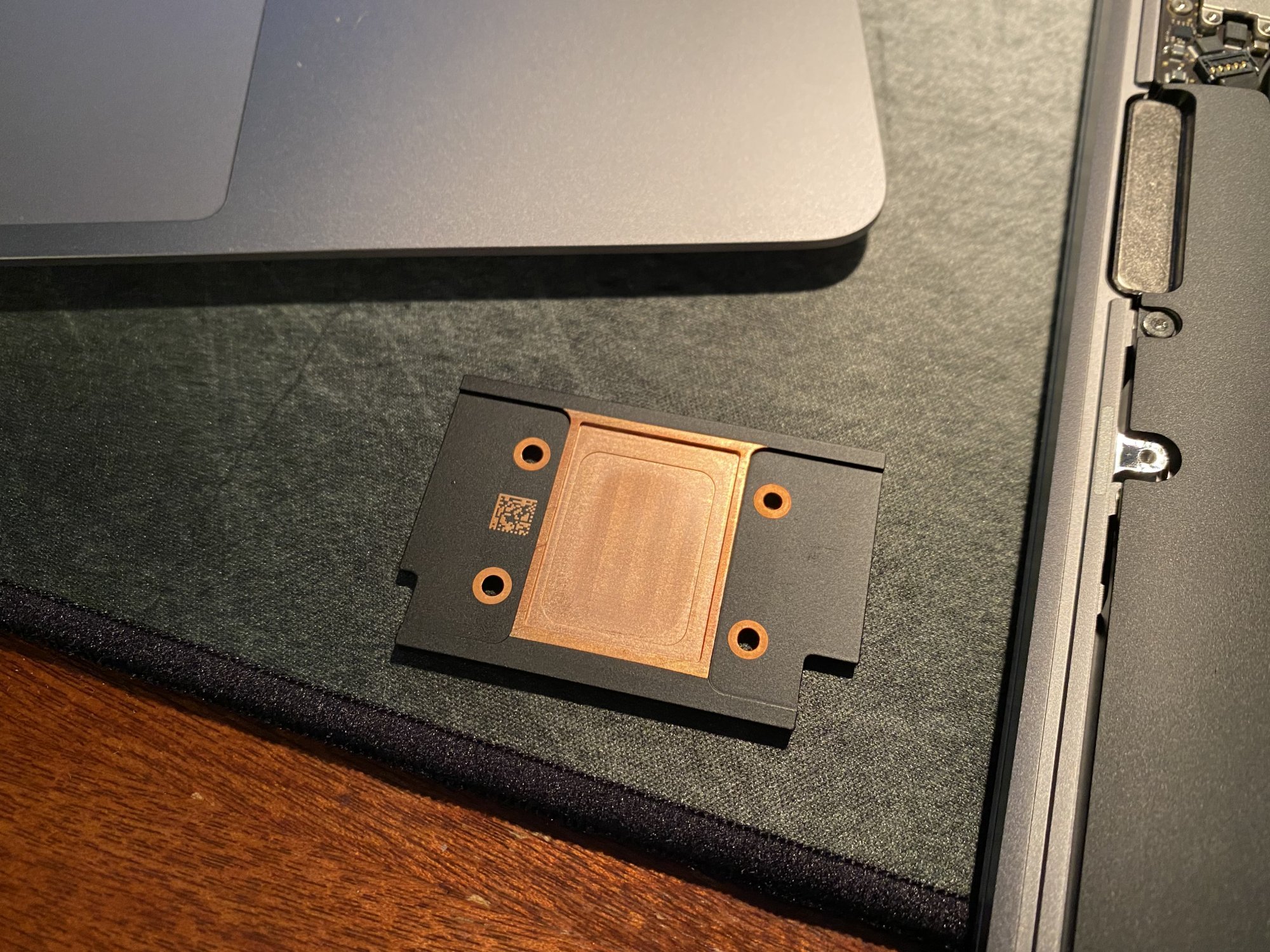

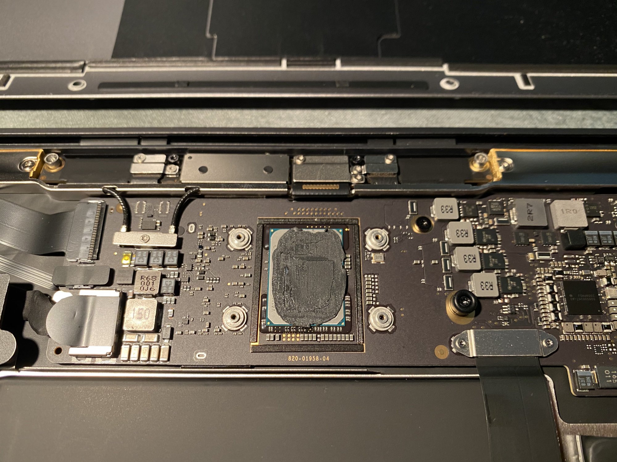

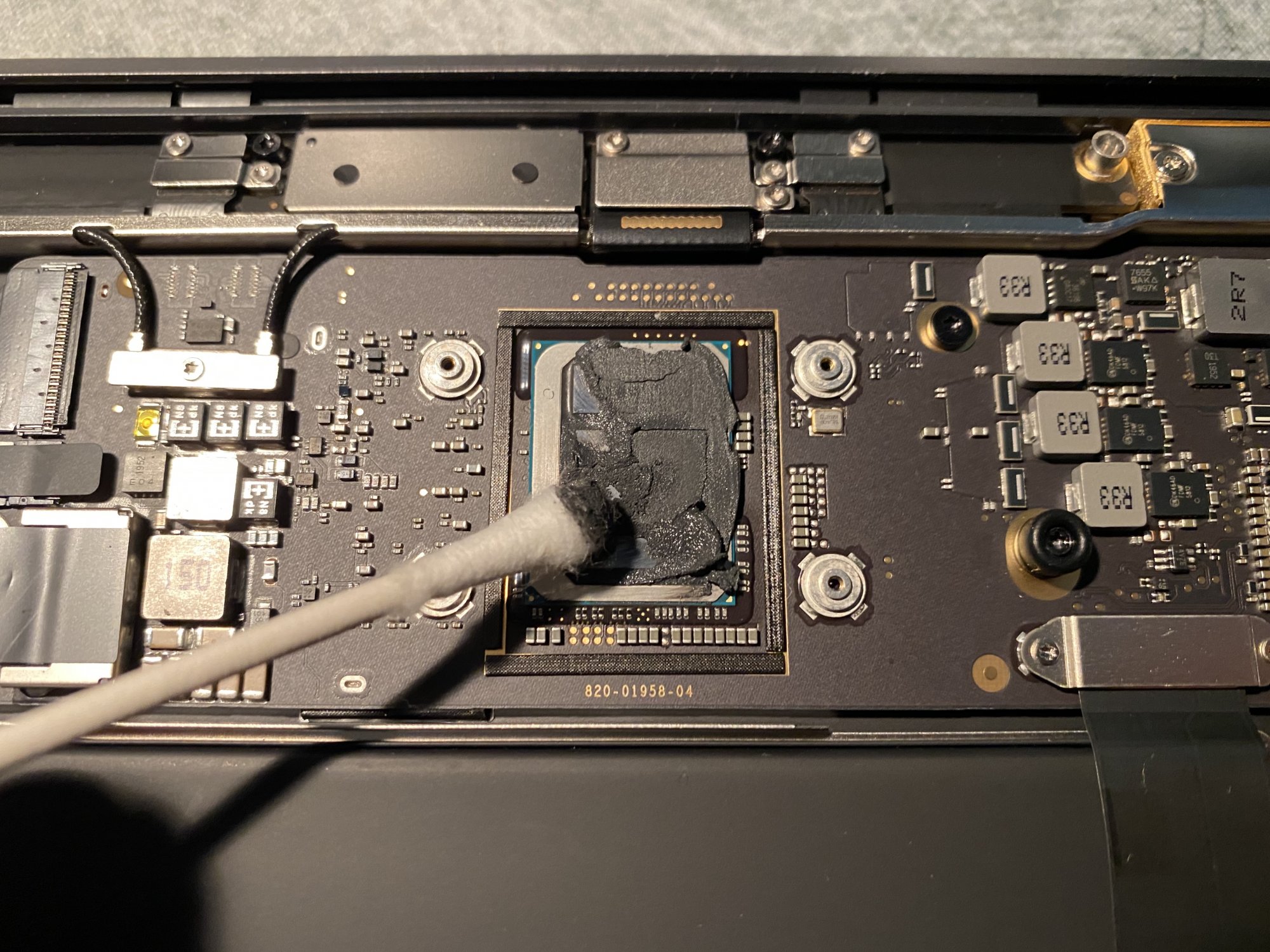

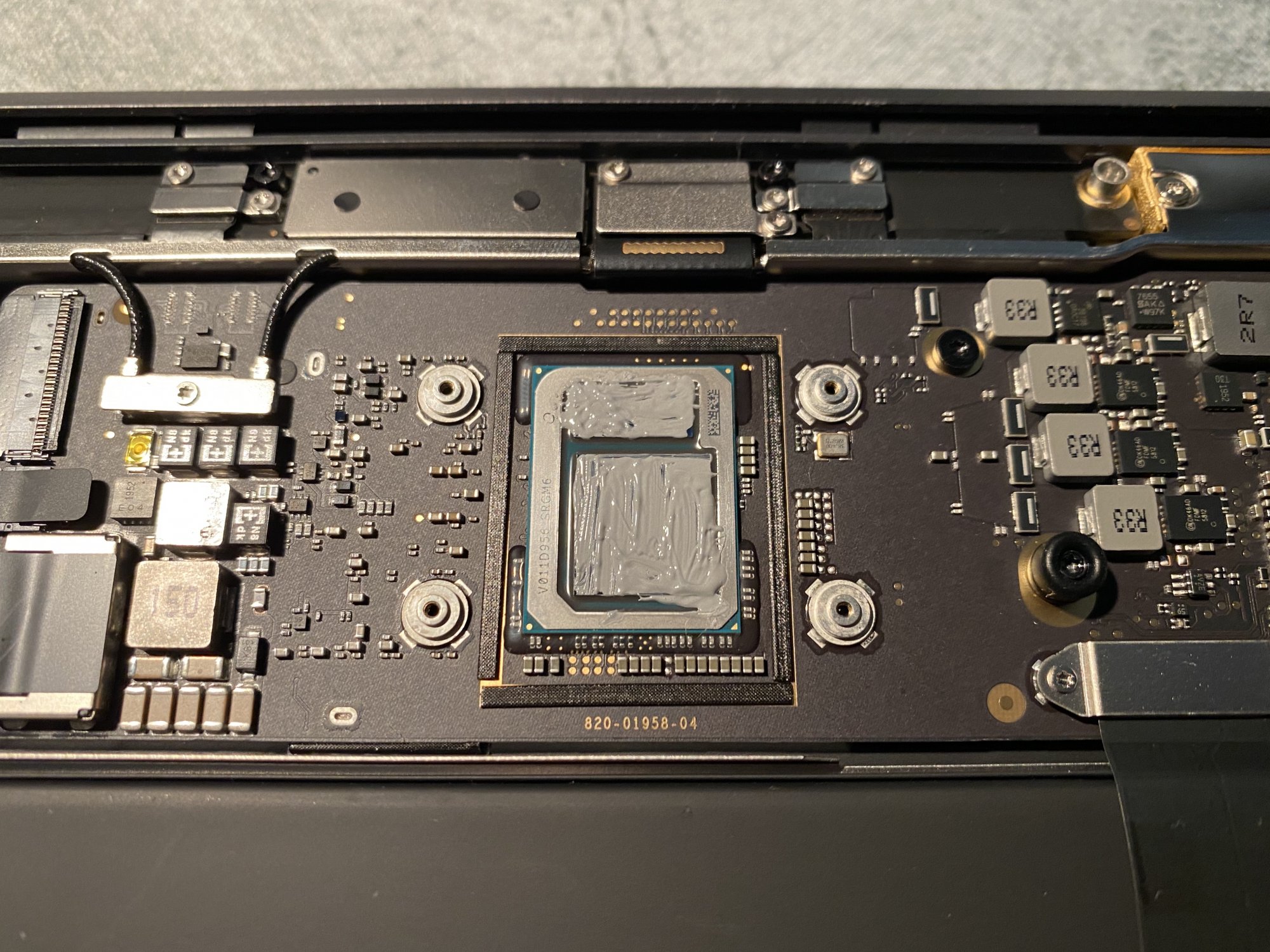

As you can see, Apple used a ton of gunky/sandy thermal paste to fill the void left by the space between the heatsink and the CPU. First, we need to remove the gunk from both the CPU/chassis and the heatsink that we just removed. The easiest way to do this is by using paper towels and/or q-tips. Once most of the gunk is removed, you can use ArtiClean to remove any of the remaining residue.
Once fully clean, your CPU and heatsink should look like this:
Step 6:

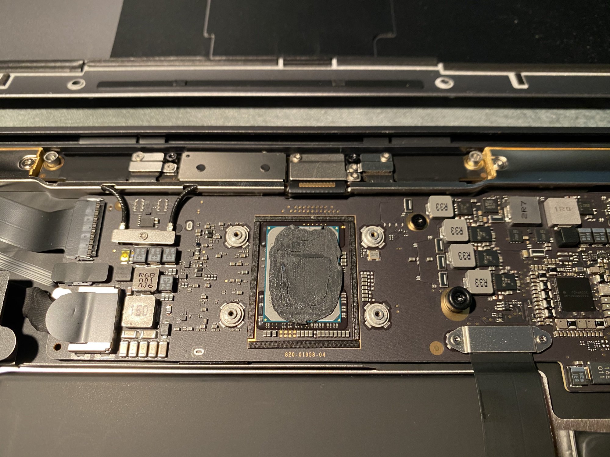

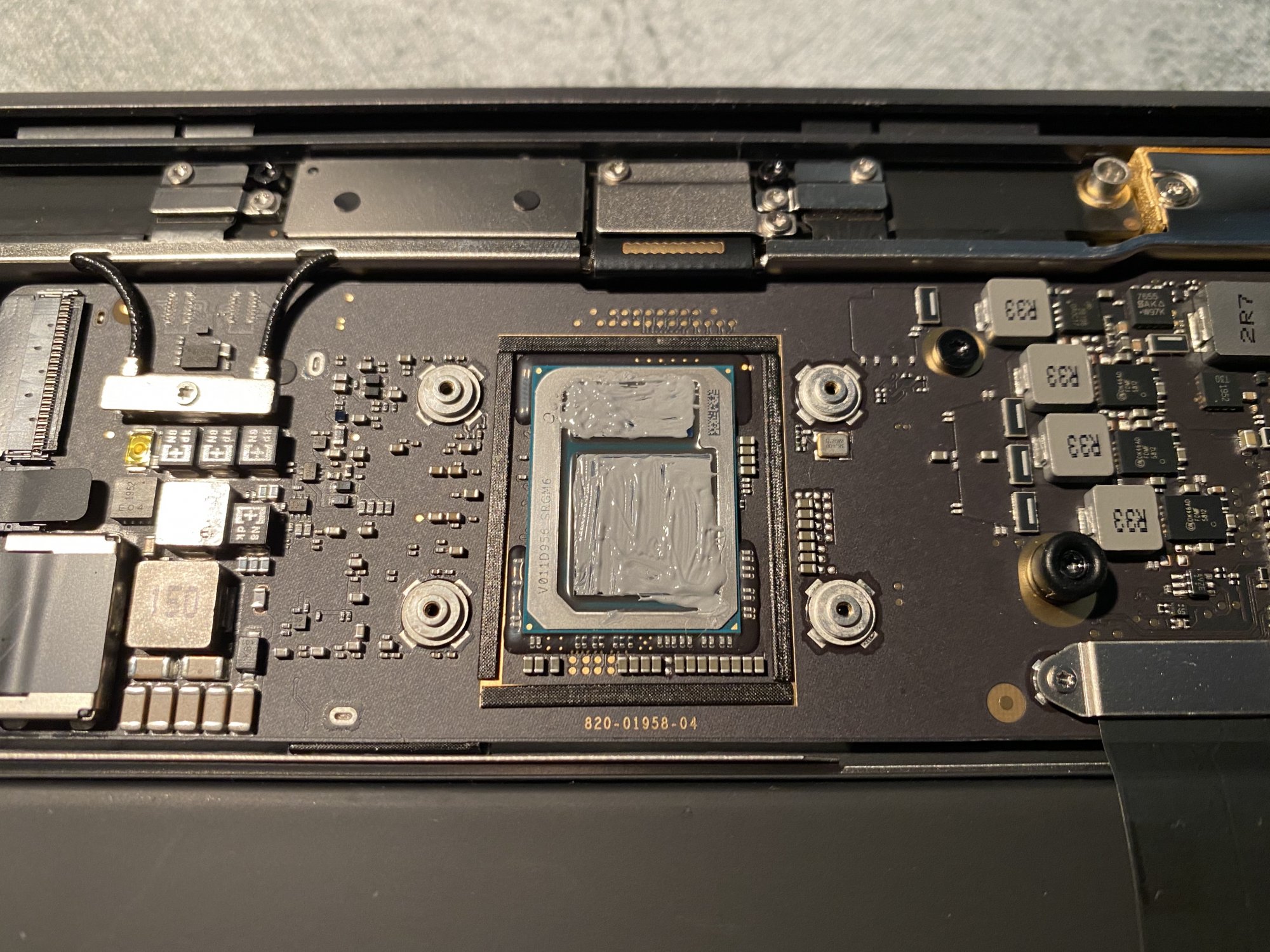

Now, we're going to apply our new thermal paste directly onto the CPU/GPU on the MacBook itself. Put a small, rice-grain sized clump directly in the middle of each shiny piece shown below, and then spread it around as evenly as possible using a q-tip or an applicator (provided with the MX-4).
NOTE: You need VERY little paste; less is more when it comes to thermal paste.
NOTE: You don't need to cover each and every crevice of this area perfectly.The paste will spread once pressure is applied by reinstalling the heatsink in the next few steps.
Here's what my coverage looked like after applying the MX-4:

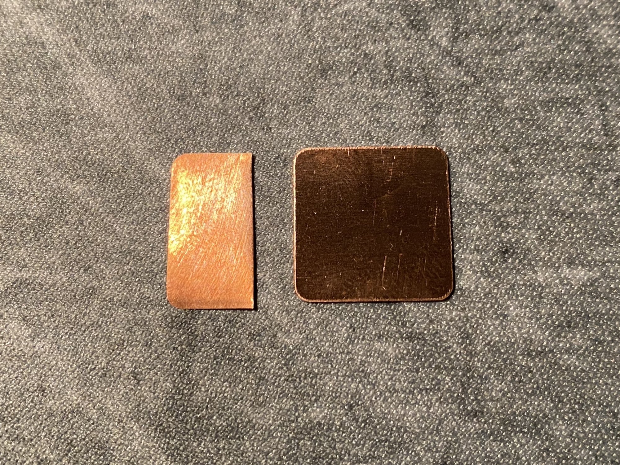

Remember the copper shims we sanded in Step 3? We'll need them now. We'll be using ONE full shim from Step 3, but we'll have to cut the second shim to size since two shims cannot fit in the recessed portion of the heatsink. Take a good pair of scissors and cut one of your shims exactly in half. If the shim ends up getting a bit deformed or isn't completely flat anymore, take the end of pen or pencil and rub the shim while it's laying on your desk. This will help straighten out the shim.
Now, we'll work with one full shim, and one half shim:

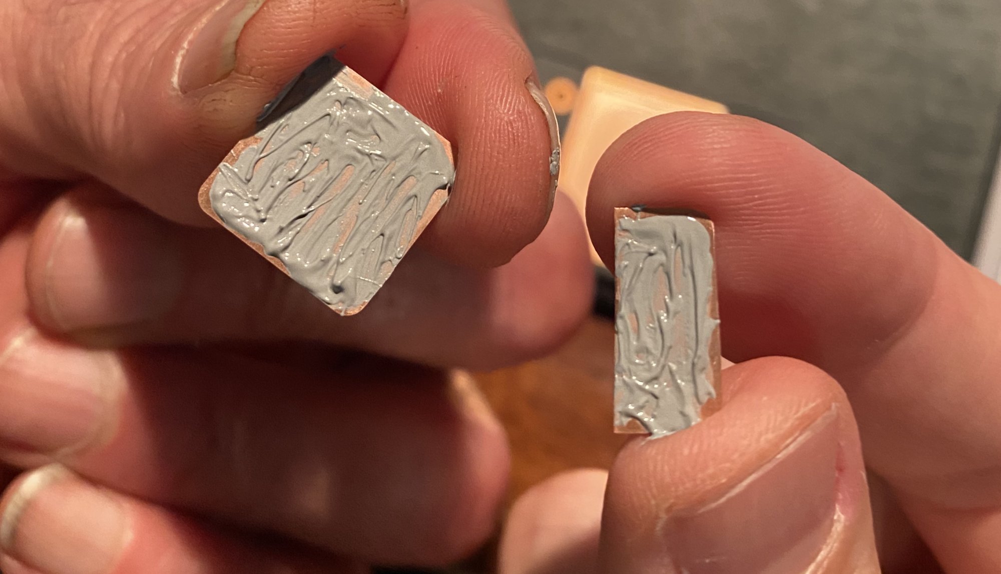

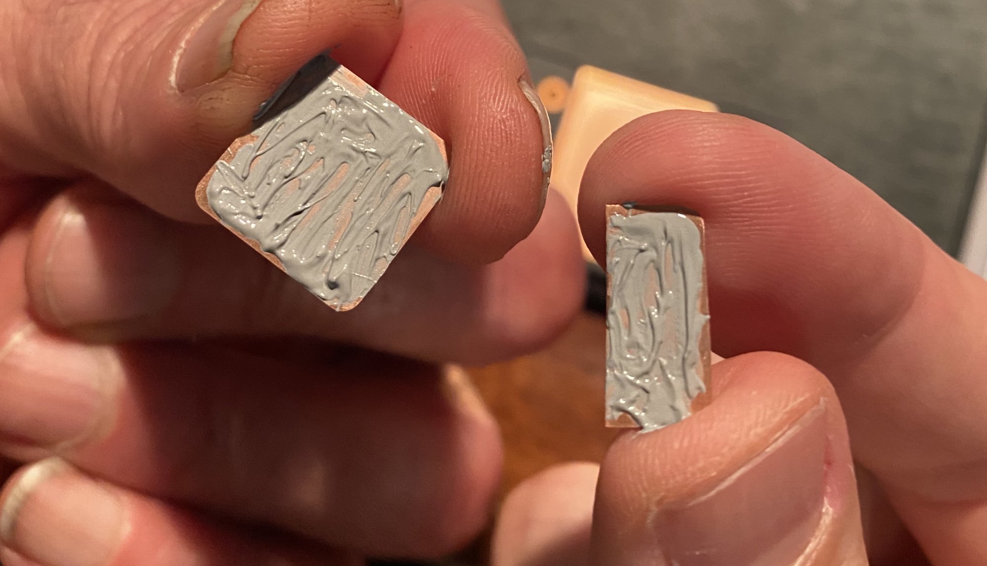

Per @DanSilov's suggestion, we are now going to paste these copper shims directly to the heatsink. This is a lot easier than installing the shims directly onto the CPU that we already covered with thermal paste in Step 6 above.
So, you want to follow the same routine for applying paste as we did in Step 6: take a small amount and spread it onto one side of both copper shims (the full shim, and the half-size shim we cut, pictured above).
It should look something like this:
Step 9:

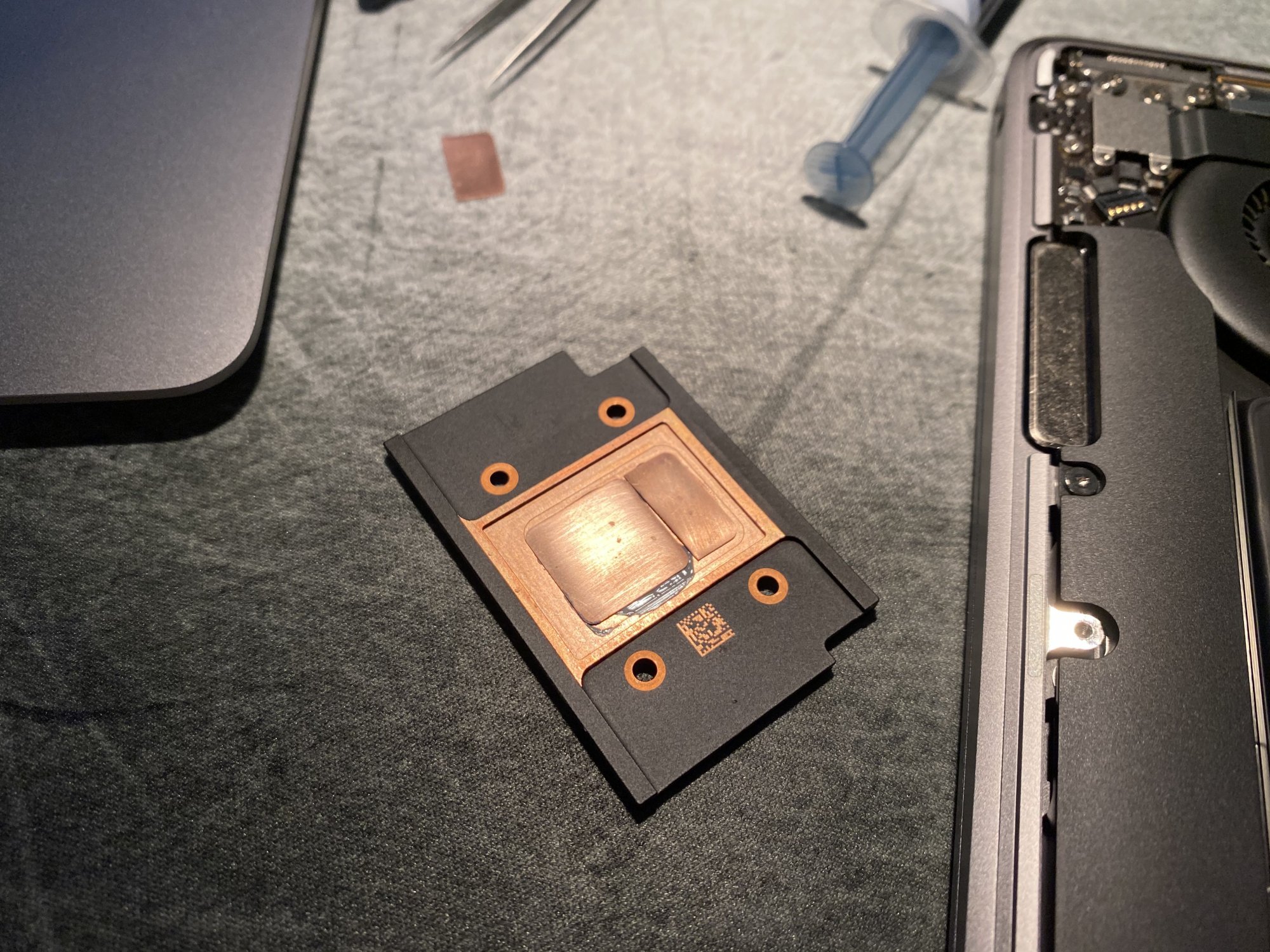

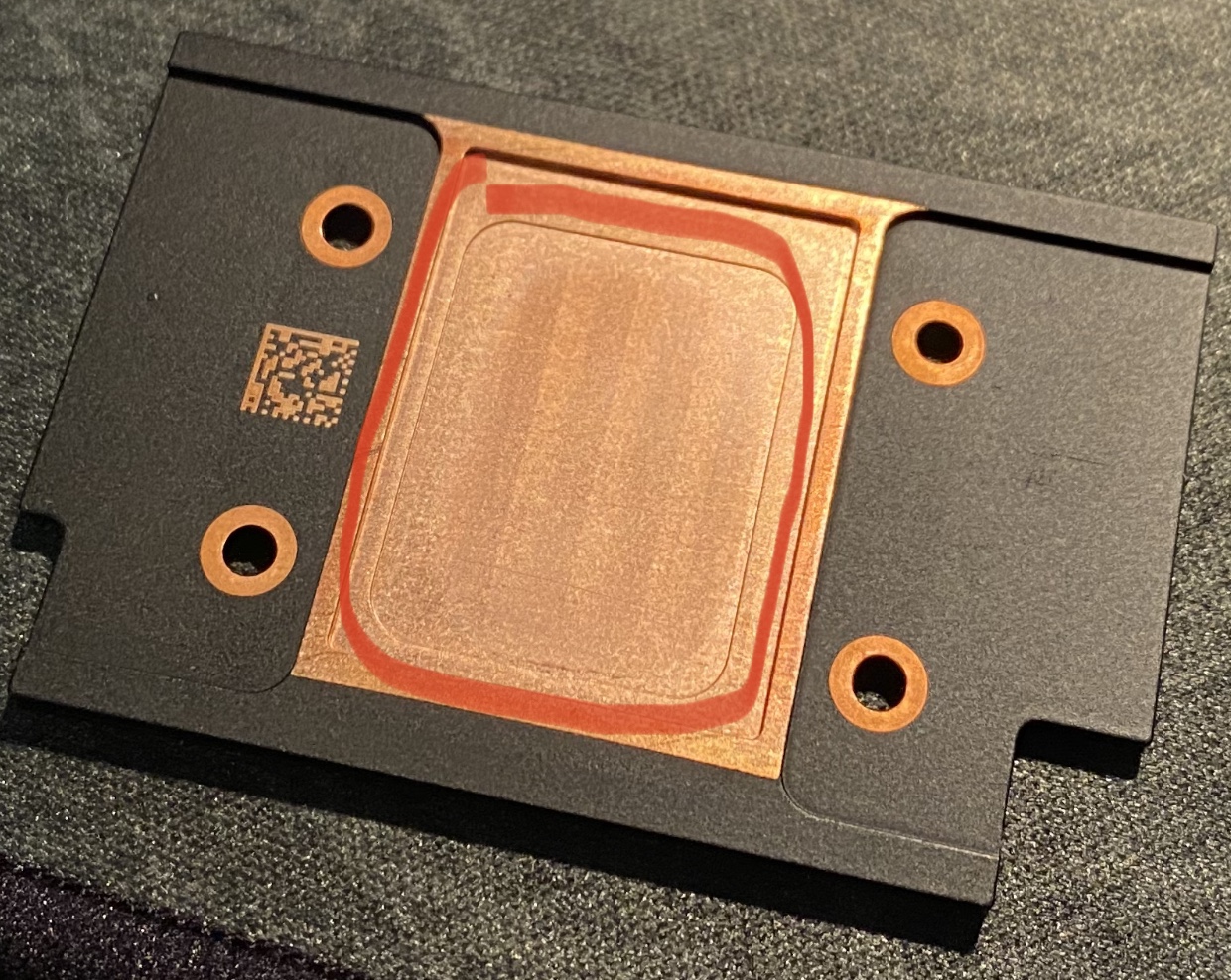

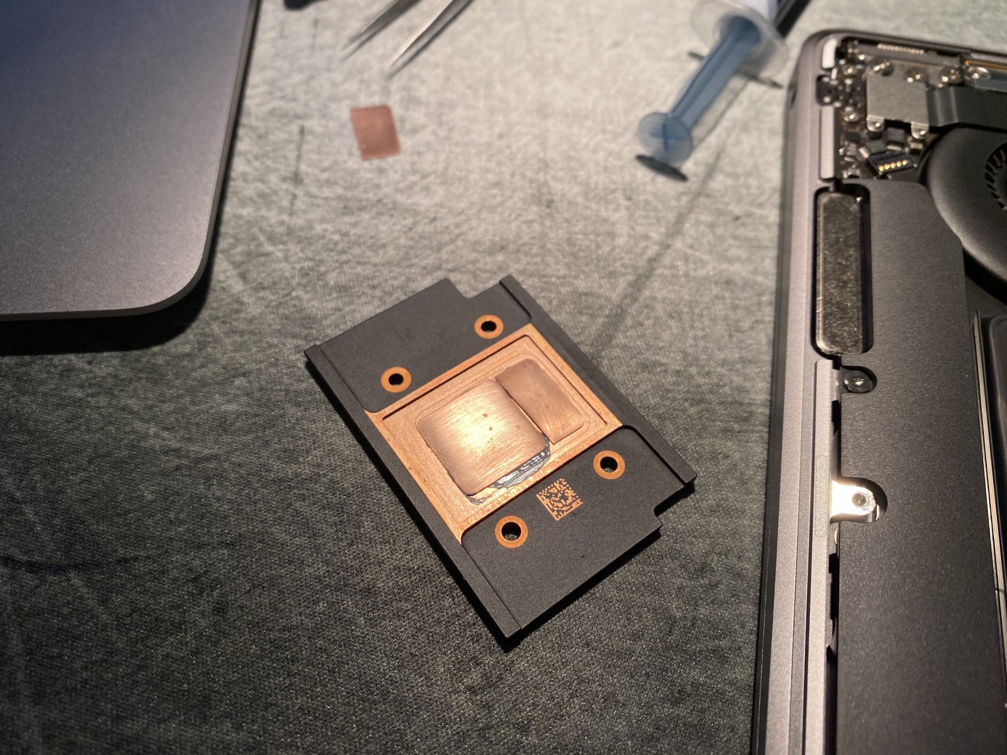

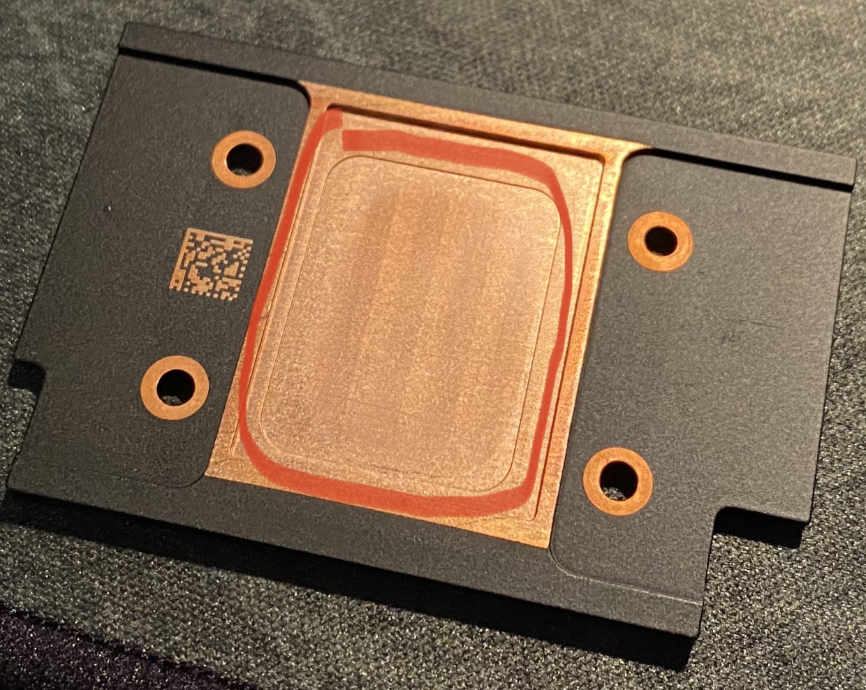

Once you cover the shims with thermal paste, go ahead and stick these shims directly onto the heatsink that we removed in Step 4. You'll notice that the heatsink has a recessed area where our shims can almost perfectly fit into place. THAT's where you want to stick our shims, paste side down.
I've highlighted the area where our shims will rest (paste DOWN) in red below:
Once you install the shims, you'll have a heatsink that looks like this:

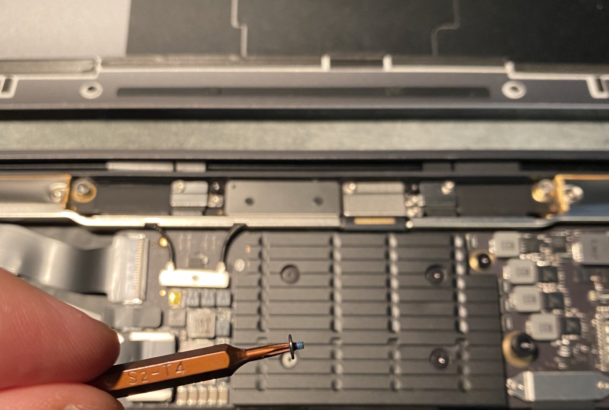

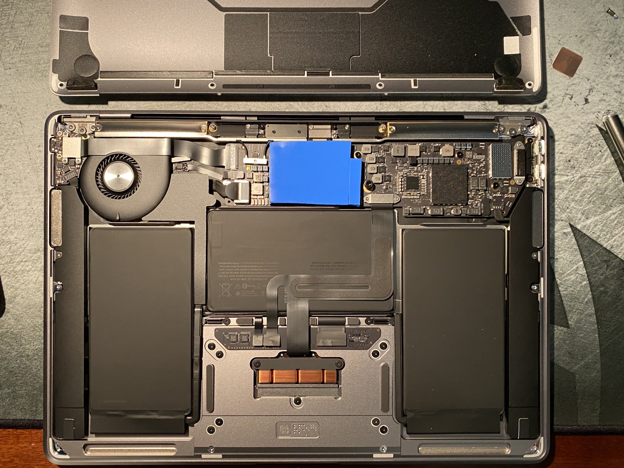

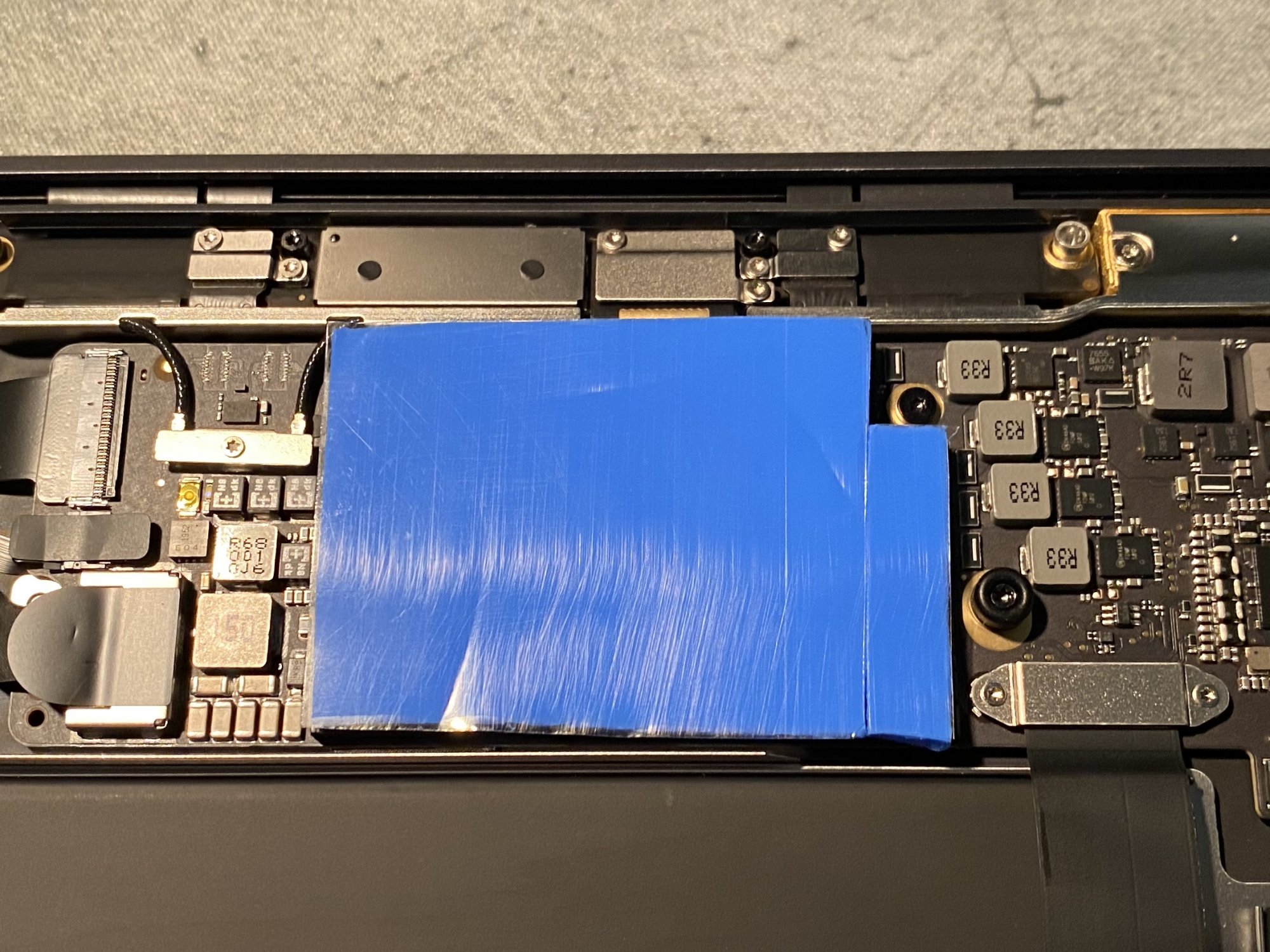

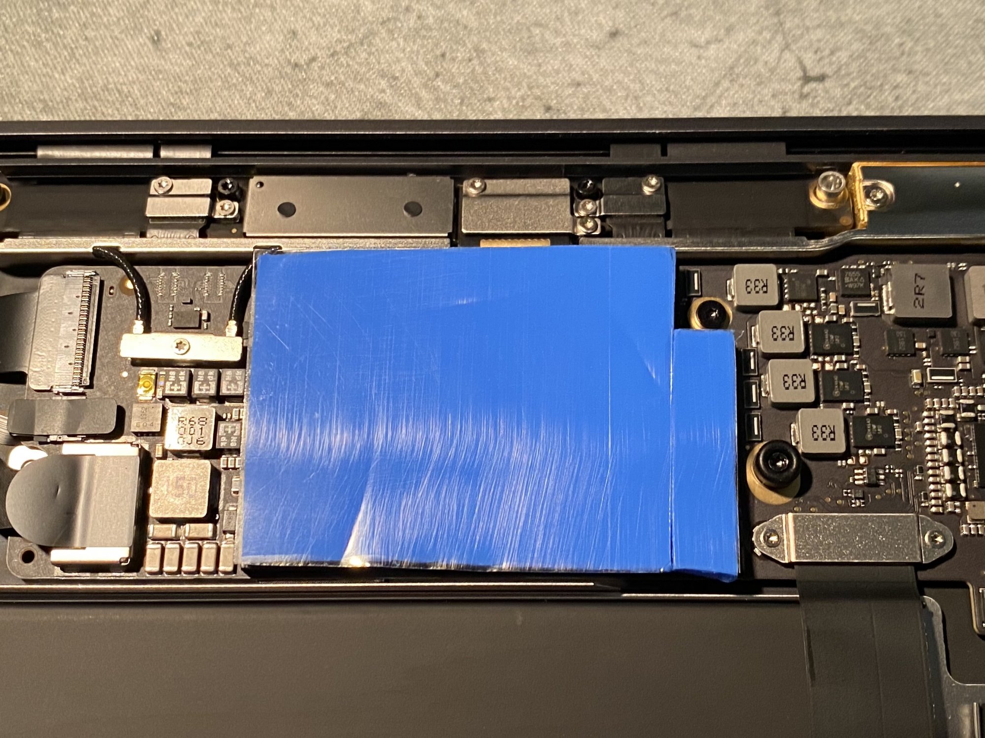

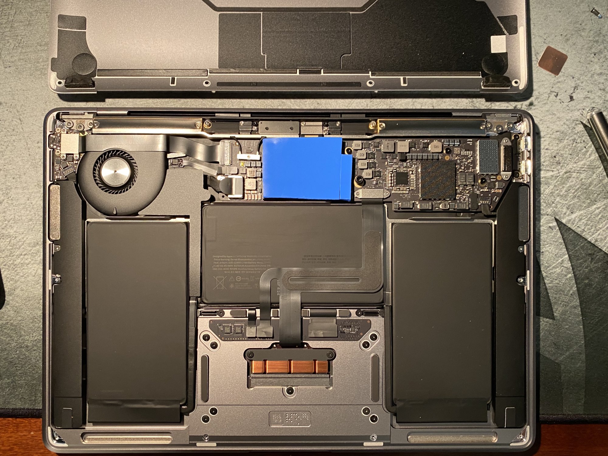

The heat pad mod is relatively simple. We need to cut the Wathai Blue pad (in Step 0) to fit over the top of our heatsink. This can be done with a pair of scissors, as the pad cuts easily. I cut one rather large piece to cover most of the heatsink, and then cut a smaller strip to cover the right side of the heatsink.
I then peeled the red-colored side of the adhesive from the thermal pads and pasted them directly on top of the heatsink. See the pictures below:
Note: I chose to cover the entire heatsink with the thermal pad. Some users left areas uncovered, but I have been experienced no issue with covering the entire thing.
Lastly, I removed the plastic from the top of this blue heat pad. If you're having trouble grabbing the plastic covering, use the tweezers that came with our Xoom screwdriver set.

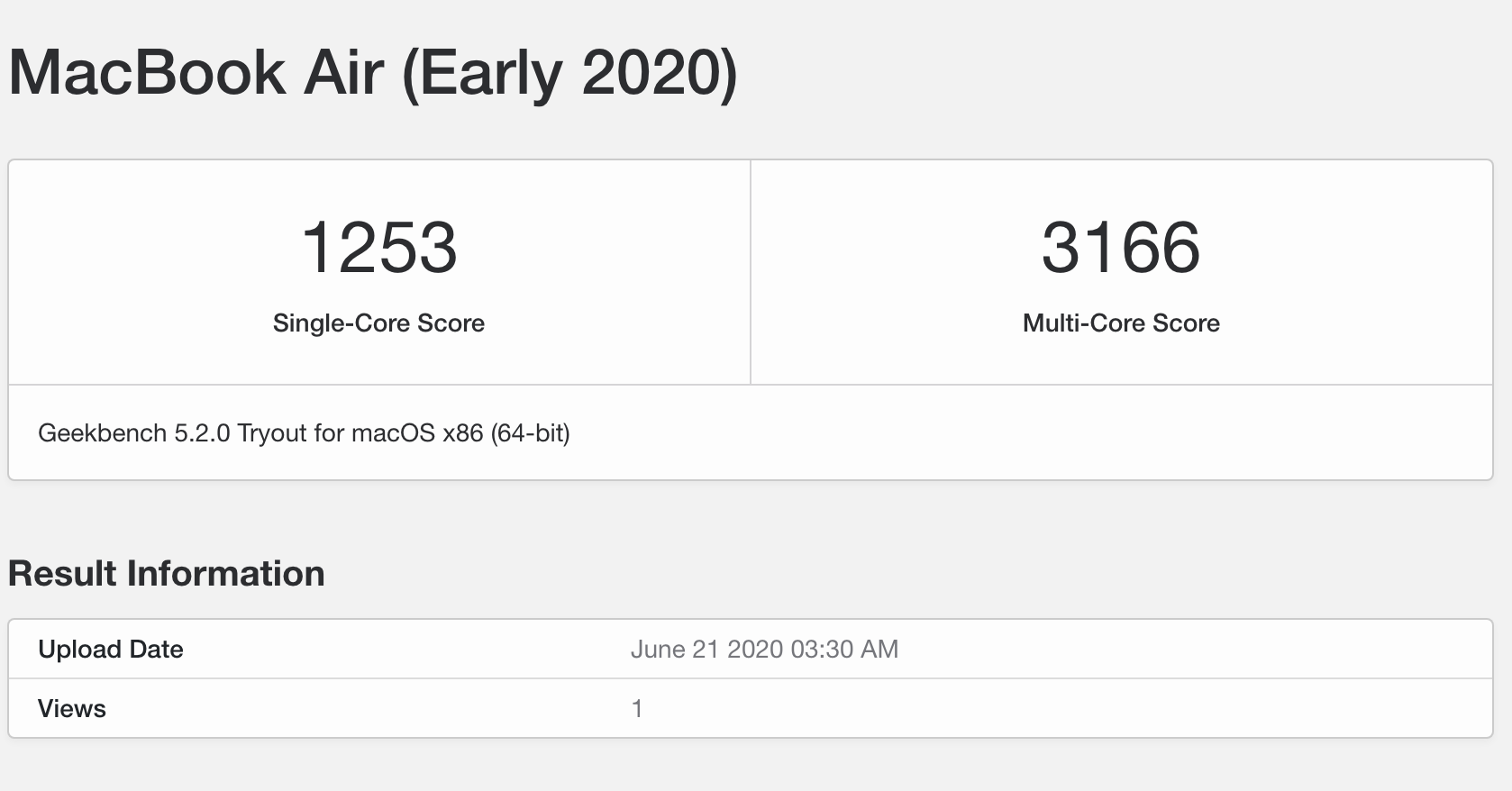

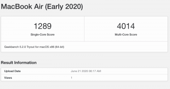

GeekBench Scores
These mods were extremely fun, but the performance gains and temperature reductions were even better. Here were my GeekBench scores before doing the mods:
And here they are after:
Along the lines of other users' results:
Single core score: 2.8% increase over stock
Multi core score: 26.7% increase over stock!

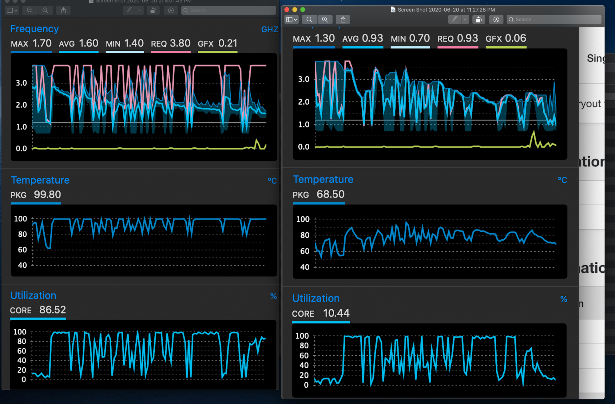

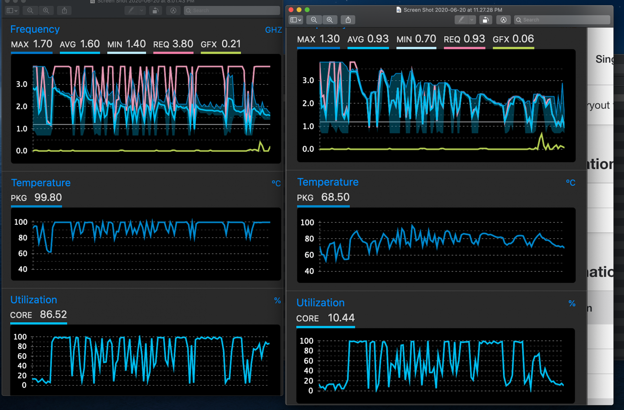

Temperatures
GeekBench scores are one thing, but what I really cared about was taming the heat/throttle issues with my MBA. What I've noticed is absolutely amazing: temperatures are running MUCH cooler under load, and are rarely hitting 100*C (where the unmodded MBA will gladly live at 100*C all day during 4K videos, benchmarking tests, videoconferencing (VC), etc.
Here's a side-by-side comparison of Intel Power Gadget's stats and temperatures during GeekBench. The charts on the left side of the screen are pre-mod; the charts on the right are after the heatsink and heat pad mods.
Take a look at how much lower and steadier the temperatures are. Also, fun fact: the fan NEVER turned on during the GeekBench test after performing these mods. That's absolutely insane, and very impressive.

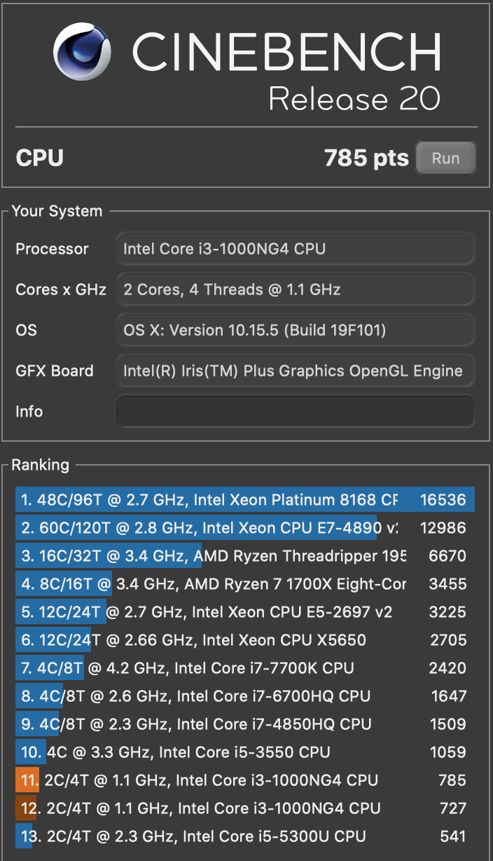

somewhat interesting update for the i3 model; so initially, i had only added the coppershim, which bumped both my geekbench and cinebenchR20 scores. my thermalpad just arrived and i installed it. the geekbench score didn't really change, it was actually slightly worse but within the margin of error. my cinebench r20 score however improved quite a bit. and bonus, the fan never became audible at all.
cbr20 @ stock: ~620
cbr20 w/ shim: 727
cbr20 w/ shim + pad: 785
[edit/] I should have posted this in the megathread. sorry, mods. i'd have deleted the post if i could 😛
