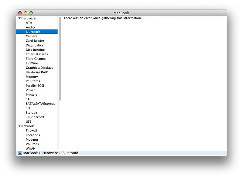

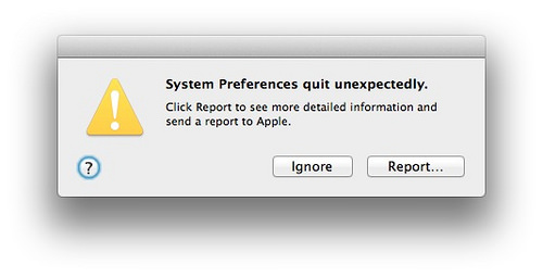

Having used MLPostFactor for 2 weeks, I discovered that the Bluetooth preference pane closes when I try to open it.
Same here, not good.
So I grabbed a copy of System/Library/PreferencePanes/Bluetooth.prefPane from a Lion System (10.7.5) and replaced the Bluetooth.prefPane on the Mountain Lion Mac (10.8.5). I kept a copy in case of disaster.
Now the Bluetooth pref pane comes up under Mountain lion, and appears to function normally.
Regardless, it'll be a few months before I toss that copy I made of the official 10.8.5 prefpane.
All other preference panes look to open normally, except mouse, which just asks that Preferences be allowed to restart before it'll open up. I didn't check preference panes in the "other" grouping, such as GeekTool or Growl because third party panes'll vary from user to user.

10.8.5 with MLPF v0.3 macbook late 2007 X3100.
Screen Shot 2014-03-17 at 6.18.19 μ.μ. by dedalos, on Flickr
Bluetooth is working with magic mouse from restore in 10.8.5 after clean install but i cant add devices because preference panel crashes all the time.
Screen Shot 2014-03-17 at 6.19.13 μ.μ. by dedalos, on Flickr
Everything works fine with clean install on Lion.
Preference panel working on 10.8.4 clean install, error exists in system report and no new device can be add in bluetooth.
If anyone can help it would appreciated.
