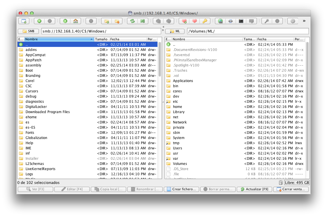

Hello! First of all, thanks to HackerWayne for creating this amazing tool.
Thanks to MLPostFactor my early-2008 :apple: Macbook Black has acquired over years of life. Sorry for my english, I'm from Argentina. ;)
I installed OS X 10.8.5 using 10.8.4 MLPostFactor config and I found a temporary solution to the SMB problem. Using muCommander can access the Windows network: copy, move, etc... by typing "smb://xxx.xxx.xxx.xxx/" just like in Finder.
See the screenshot.
I hope my contribution helps others with the same problem.
Saludos!!!
