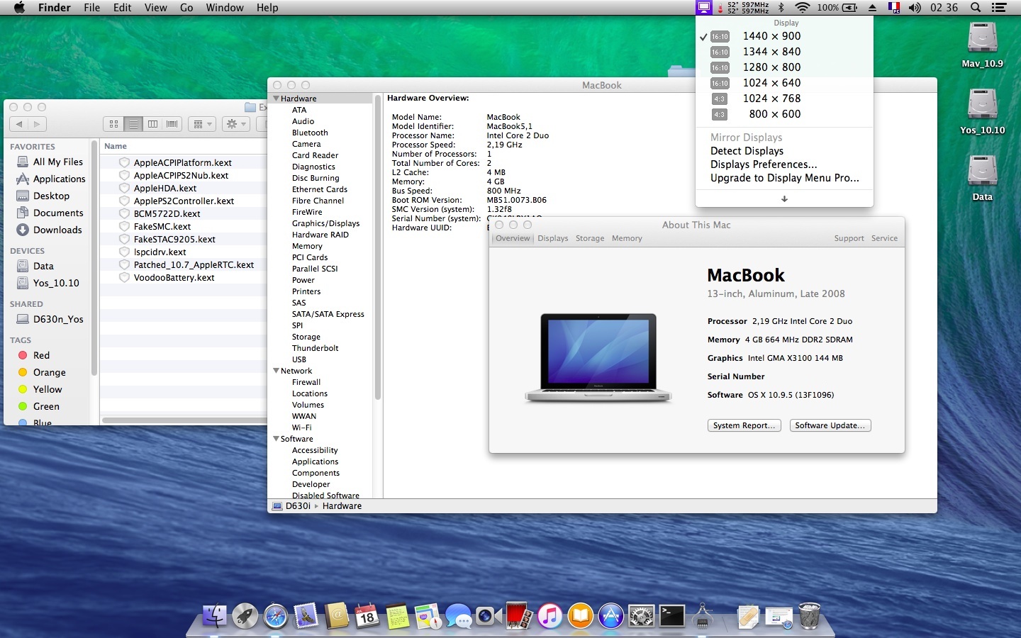

Good evening. Decided to Test the relatively new MCPF 1.0.1 on a MacBookAir Original which is 3.1 . Must admit, I'm going nowhere incredibly fast and somewhat disappointed. Expected a big improvement over MLPF which is, easily, one of the most aggressive hacks I've ever seen. I'm stuck at the Start Line - Error 1 and, just for clarity, I've sent about five
different Mavericks and ML Installers to my Applications folder with no forward movement. And, all are legit. I'm running a Dell Latitude D630 w/ Core2Duo T7500 and Intel GMAX 3100 Hi-Res Graphics. Was hoping to enable the Acceleration
of the X3100 so that it would have 144MB of memory. Can't even get past the Start Line. I'd PAY to see the private Beta Testers who shook this App down. Any and all comments, positive or otherwise, will be graciously accepted. And, from Philadelphia PA , have a Goodday.

FAILED - no Install of 10.9 using MCP 1.0.1 Beta Preview. Wow-w ! That last Poster was absolutely correct. The futility of this App is beyond words. Trust me. I'm beginning to believe that MCP cannot be used on Hackintoshes. I've Tested it on three (3) Dells and, goes without saying, 0 for 3. And, picked up an Adware bug that cut my Network speed in half. ThrowsErrors better than I can throw a Curve ball. This App isn't intended to do work, it's intended to attract attention. This site must be starved for attention. And, please - no User Error here. Been years since I've been a Noob. If I begin to believe that it won't run because I'm using a SSD, that's pure comedy. Just a shame any of this need happen. Don't blame me, my Code is on time.
I think this may be an hackintosh issue. What exactly is it doing? Is it showing an error or is it not detecting the installers in your Applications folder
We been testing MCPF on real unsupported Macs, not PCs. That could be the reason you are experiencing so many fails. What are the 'full' specs for your dell?

It IS a Hackintosh issue. However, your First Generation MLPF product had no problems functioning with its
aggressive excellence, and I assumed that this was an extension to enable Mavericks and Yosemite down this
same path. I have a Dell Latitude D630 w/ Intel C2D T7500 2.2 Gbs CPU along with an Intel GMAX 3100 1440 x 900
Hi-Res integrated GPU. I've perfected this brand of Hackintosh outside of flashing an Apple BIOS to replace the stock
Dell BIOS A19 . The DSDT and SSDT have been added to an Extra folder that has OS X running as seamlessly as it possibly can. Therefore, the MacPostFactor Beta Preview should detect this unit as one of its own. However, it first welcomes me with an Error 5 (just a disclaimer) and, then signals an Error 1 ( consistently with different ML and
Mavericks Installer Apps in the Applications Folder) . The sameformy other two (2) Dells. I find this rather awkward.
I was able to get MLPF 0.3 to run using Torrents. This won't even cooperate with genuine Apple Installers. The unfortunate thing is that , I have no quit and WILL find a way to get the Beta Preview to run. Once again - no User Error here. Have a very Goodday.
Off-topic on this forum, but this has long been answered for at Hackintosh sites. You won't get anything more on your D630 X3100 than real Macs owners do, i.e. you can only obtain graphics acceleration under 32bit mode ML with MLPF but nothing under 64bit-only Mavericks, Yosemite, etc. beyond FrameBuffer support (and X3100 reported with 144MB) as long as you install the 64bit GMA kexts from 10.6.2. That's it, that's all.
