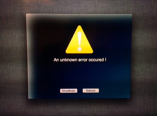

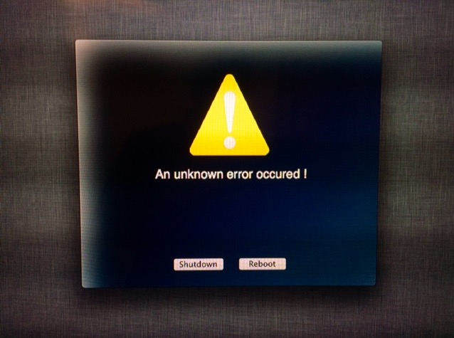

Has anyone come across an issue where the MCPF can't see the internal drive. It's a Kingston 120GB SSD in a Mac Mini 2,1.
It's taken me 3 days to get 10.8.5 onto my mac mini. After many many failed attempts, the only way I could get it to work was to clone my internal 10.7.5 drive to an external USB drive, boot to this drive, then install 10.8.4 directly over the cloned copy, then do all the patches and updates (the last security patch would not install though), then clone the OS back to the internal drive.
The OS itself now works well on the Mac Mini, but the problem I have now is that the recovery partition gets all screwed up in the cloning process. The recovery partition does not boot with a big bright yellow error message. I know the recovery partition can be fixed by running MCPF over the drive again. I've done this on an external drive and it worked great. BUT...I can't do this on my internal SSD drive because MCPF fails to see any internal drive at all...the error I get even says that having no internal drive is not really possible!!!
I've tried a number of work arounds to fix the recovery partition, including putting the Mac mini into target disk mode, and using it like an external boot drive connected to an old MacBook. It booted great, but again MCPF could not see the drive at all.
Frustrating
Does anyone have any insights?
Thought I'd post some pictures, which may or may not make my issue clearer...
Here you can see Macpostfactor not seeing my internal drive:
And here is the error message I get when trying to boot into the cloned Macpostfactor recovery partition:
