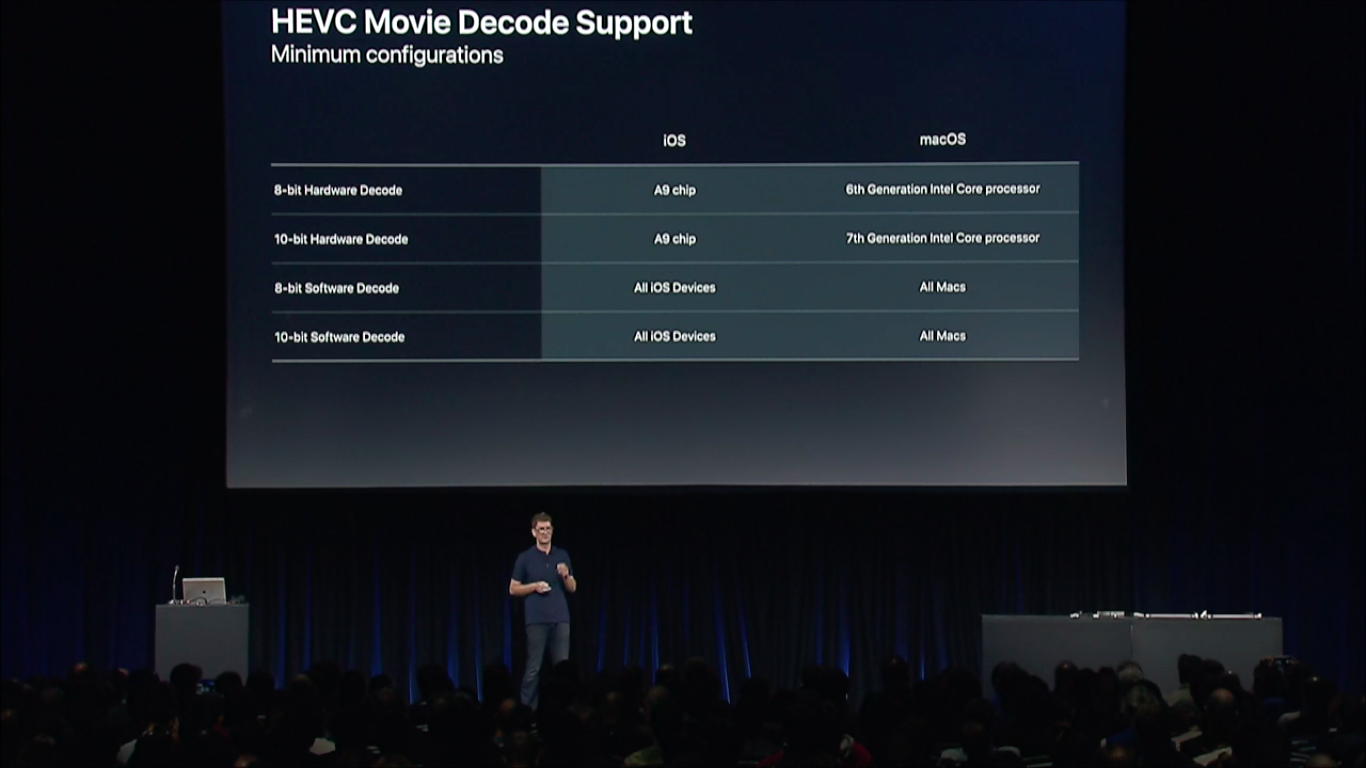

I was watching a WWDC video related to introduction to HEIF and HEVC and I saw this. This is at 21:35 and should clarify everything we were wondering.
https://developer.apple.com/videos/play/wwdc2017/503/
John.B
macrumors 601
Jan 15, 2008
4,197
708
Holocene Epoch
Also, according to that slide, every iOS device Apple currently sells has 8-bit and 10-bit HEVC hardware decoding -- except the retina iPad mini 4 (A8).

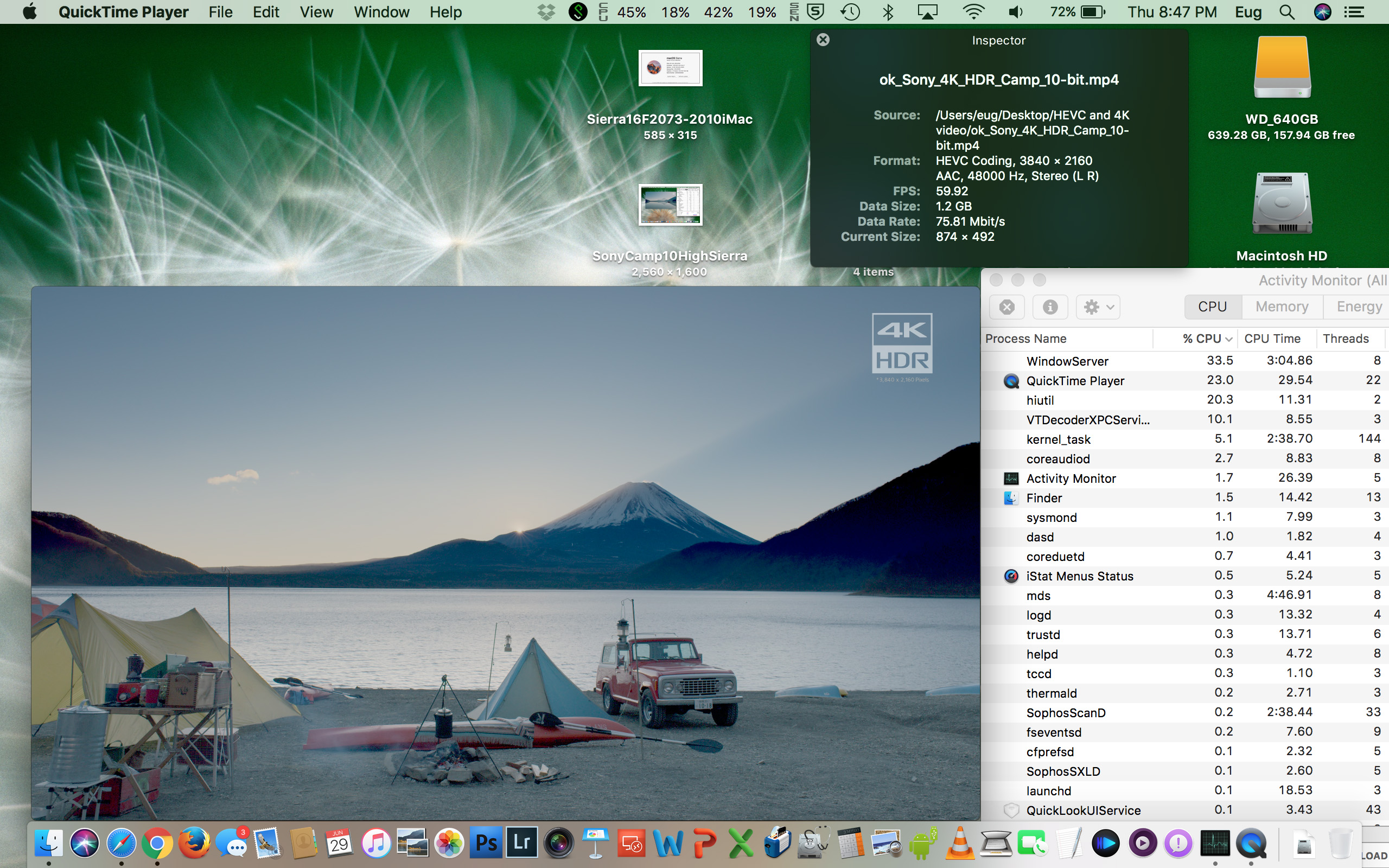

In High Sierra, Skylake can playback 4K 8-bit HEVC videos easily. Not so much for high bit rate 10-bit HEVC videos. There is no hardware decode for the latter, so you'll either get crappy playback, or else you'll get somewhat decent playback but with the CPU seeing very high usage, the fans in vacuum cleaner mode, and your battery screaming for help. ;)
In contrast, it plays gorgeously on any Kaby Lake Mac, even my 2017 Core m3 MacBook.
So if smooth and battery-friendly 10-bit 4K HEVC playback is truly important to you, then get a Kaby Lake 2017 model.
