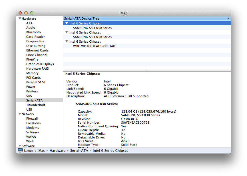

Just finished my recent upgrade this evening.
Just a little backstory,
the machine is/was a base model 2011 27" iMac,
2.7GHz i5
4GB RAM
1TB Seagate HDD
1st upgrade was to up the RAM just a little; I added 4 more GB of Samsung DDR3.
2nd upgrade; the true bottleneck, toss in an SSD.
I installed a Corsair ForceGT 120GB drive to the machine and replaced the Seagate 1TB HDD with a WD 1TB Black drive.
3rd and final upgrade, I just dropped in 2x Samsung 830 128GB SSD in RAID0 with the 1TB Caviar Black drive.
I know these are not the newest blazing fast drives on the market but Fry's was having a decent sale and I picked up both drives for less than $150.
I have 1 SSD on the old HDD port which is SATA3 and the 2nd drive on the actual "SSD" labeled port which is also SATA3 and the HDD using the superdrive port which is SATA2.
So I am quite happy with the upgrade to say the least, it took just under an hour to tear apart the iMac, drop in the drives and reinstall OSX.
It gives me 600+MB/s writes and 800+MB/s reads on BlackMagics Disk Speed Test.
255.38GB on the RAID and 1TB for internal storage.
(Machine is backed up to a 3TB TimeCapsule with most information stored on a 4TB Thunderbolt External back up to another 6TB external)
This machine will be plenty, plenty quick for at least another year or two or more! Just hoping that a new Thunderbolt display is released with USB3 connections since Belkin has dropped the ball.

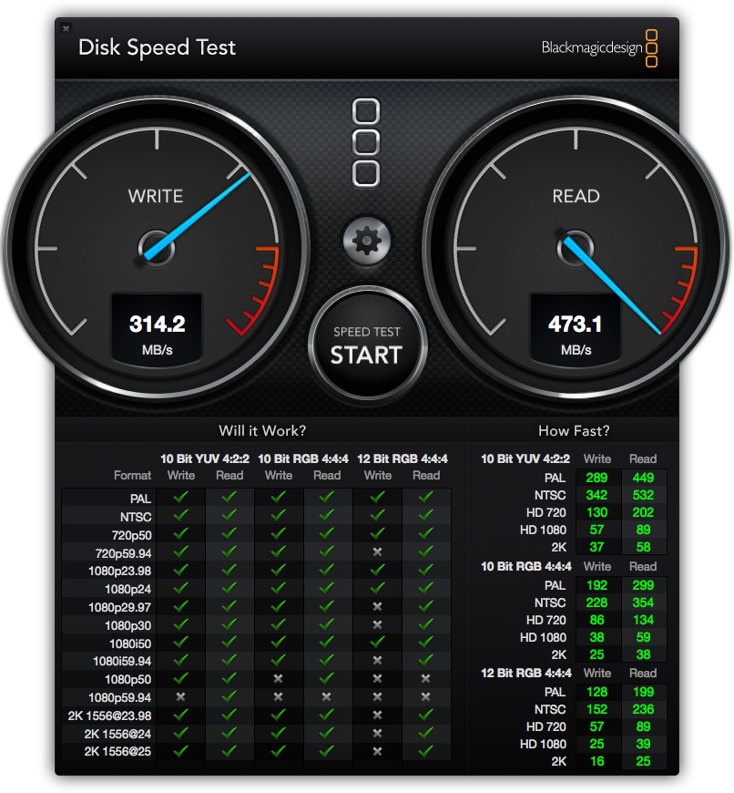

Just finished my SSD+HDD setup. It was a hard job in my opinion. Took me over an hour to fit everything correctly but after that it was all worth it. The write speeds are 320, the read 470 megs per second and it is insanely fast. I love it!
