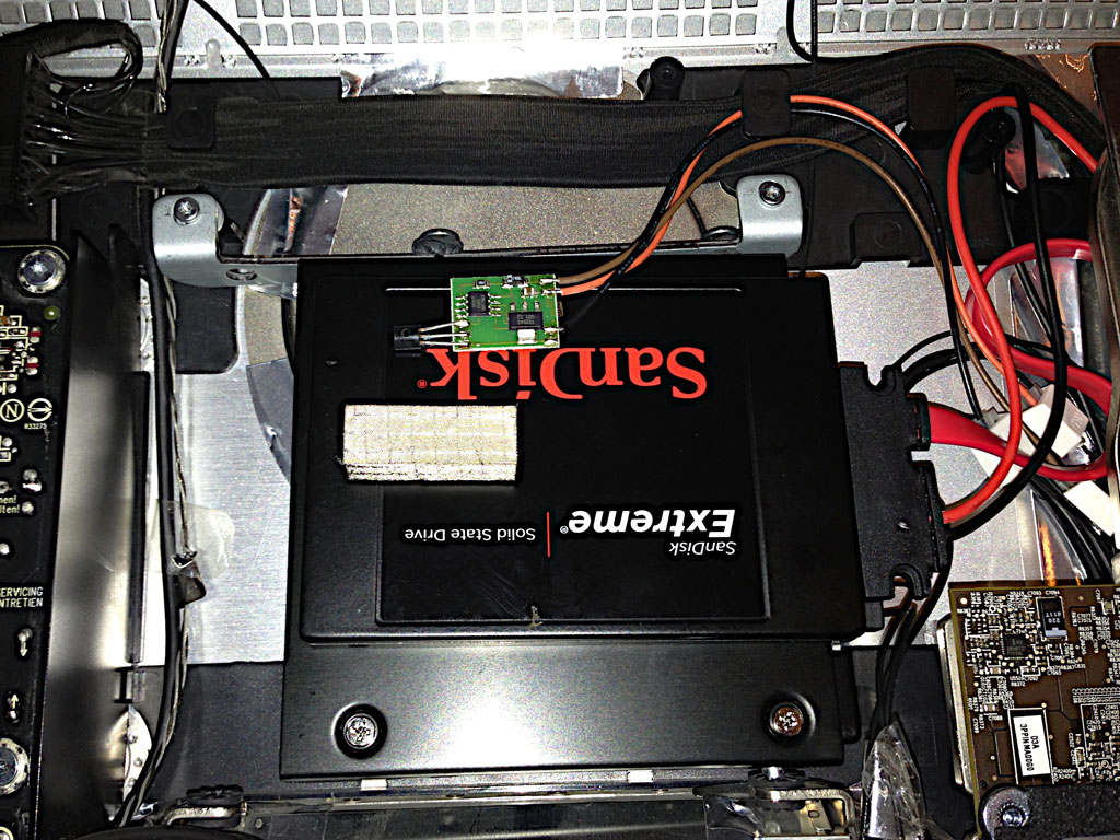

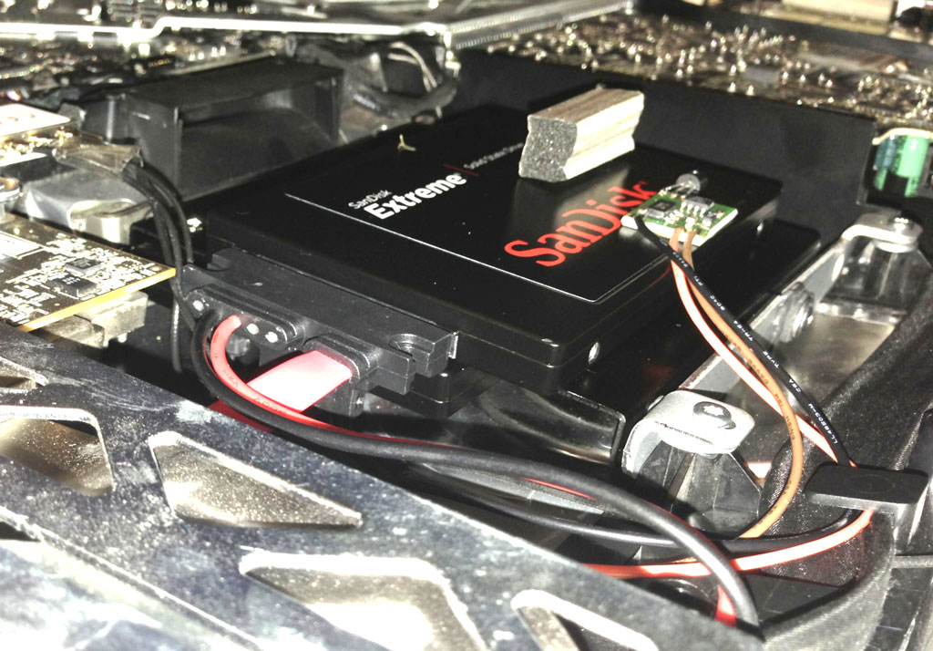

Anyone tried to add a real temperature sensor ?
Something like this ?
http://applecomponents.com/items/92...-optical/0000004398?pn=1&cmp=0172&per_page=30
I spoke to the local Apple Service Provider who said when they upgrade the drives on the 2011 iMac's, they cable in a sensor. It adds up as they charge $150 (on top of the $150 for the SSD install) but at least it works without any software help. If it were a cheap enough part, seems like a good solution.

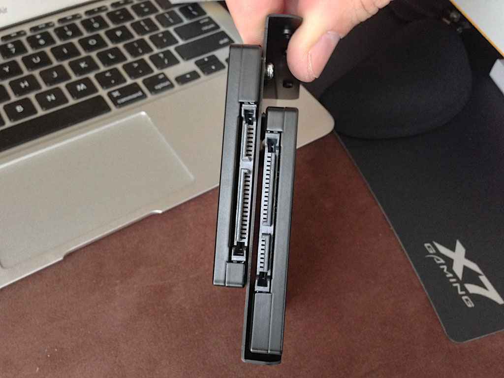

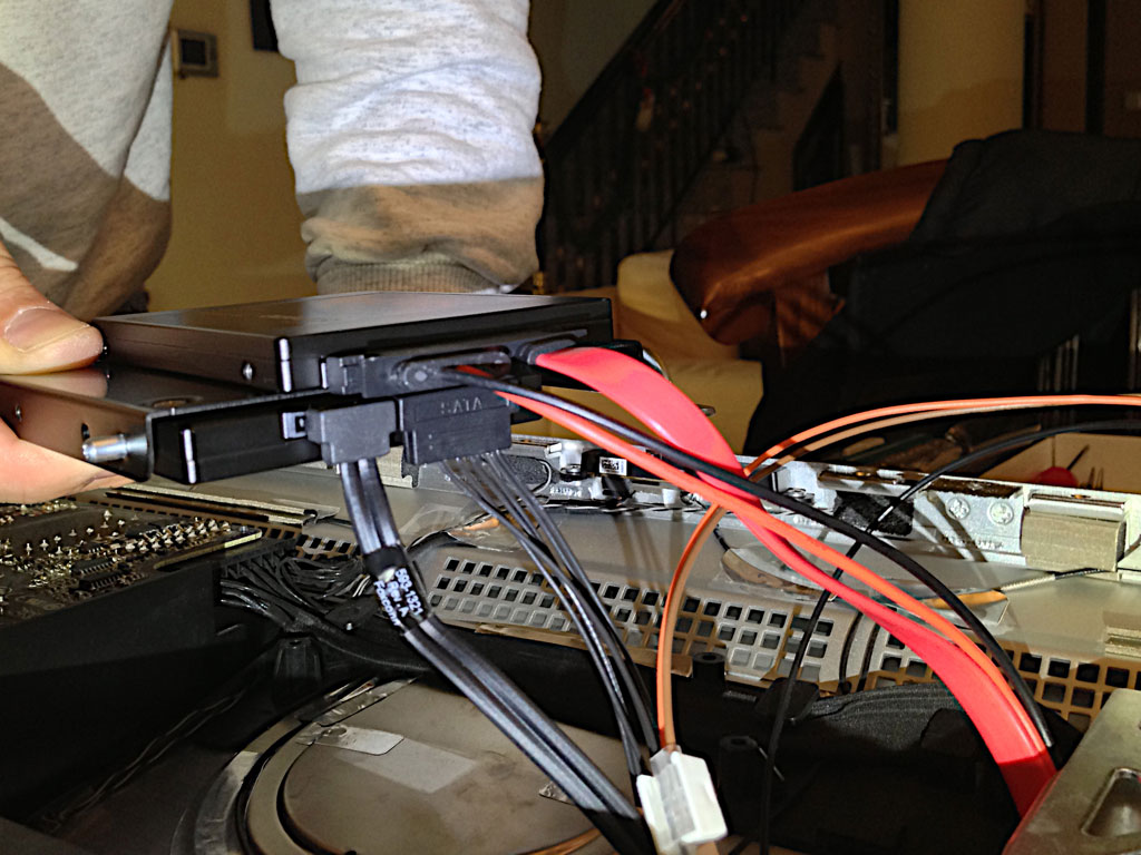

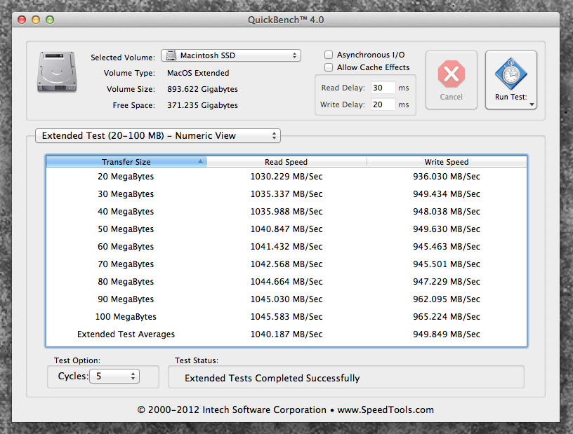

Hi, Happy New Year all i have a mid 2011 27' 3.4Ghz 2GB graphics 16GB ram 1TB HD, I purchased the following OWC Kit's OWCDIYIM27HDD11 & OWCDIDIM27SSD11. I removed the factory fitted HD and with the help of the OWC DIY video, this cable OWCDIYIM27HDD11 , the single SATA cable that came off the original installation of the HD was not removed i just added the power cable mentioned above thus together i was covered for the one SSD HD, now the other SSD HD i purchased the following cable OWCDIDIM27SSD11 that is shown in the OWC video for installing behind the optical drive which i did NOT, and put both SSD’s were the factory fitted 1TB HD was on a custom made 2-1/2 Inch HD back plate adaptor the wires were long enough for me to carry out the above mentioned and NOT having to remove the optical drive and it’s fan and place the second SSD behind no need. NO power splitter was used because both mentioned kit’s above one is DATA & Power and the other is just Power with the thermal sensor, using SANDISK 480Gb 6.0 Gb/s my iMac fly’s and don’t listen that RAID0 is unstable i guess it is on windows but not a Mac :) using time machine or like i use Drobo you will be covered in case something goes wrong which i very much doubt, the job that was done works perfect 'it's Amazing like have a Ford Fiesta and traded it in for a Bugatti Veyron' also no fan issues and all is well.

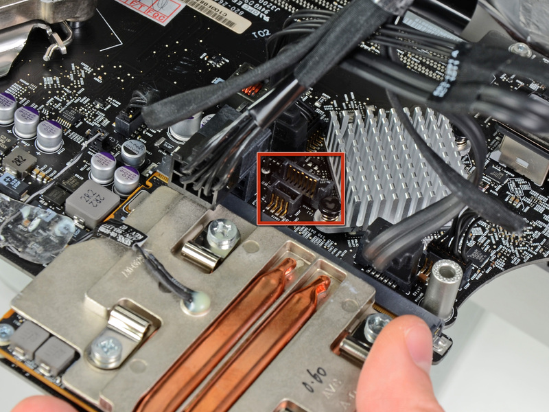

No thermal connector on Mid 2011" 27"?
I have installed a SSD with HDD in a 27" iMac mid 2011, but it's impossible to locate a slot for the thermal connector!
Have never seen this before - either it's the old "external" sensor, OR the newer sensor integrated with the HDD. But at least there have been a connector for the temperature sensor…
It's the same iMac as in this pic:
http://guide-images.ifixit.net/igi/FcIRZTlS1RucliAR.medium
(courtesy to iFixIt)
And sure, there are no temp sensor connectors on the picture...
Can someone please confirm that there are no temp sensor for the HDD in this iMac?
