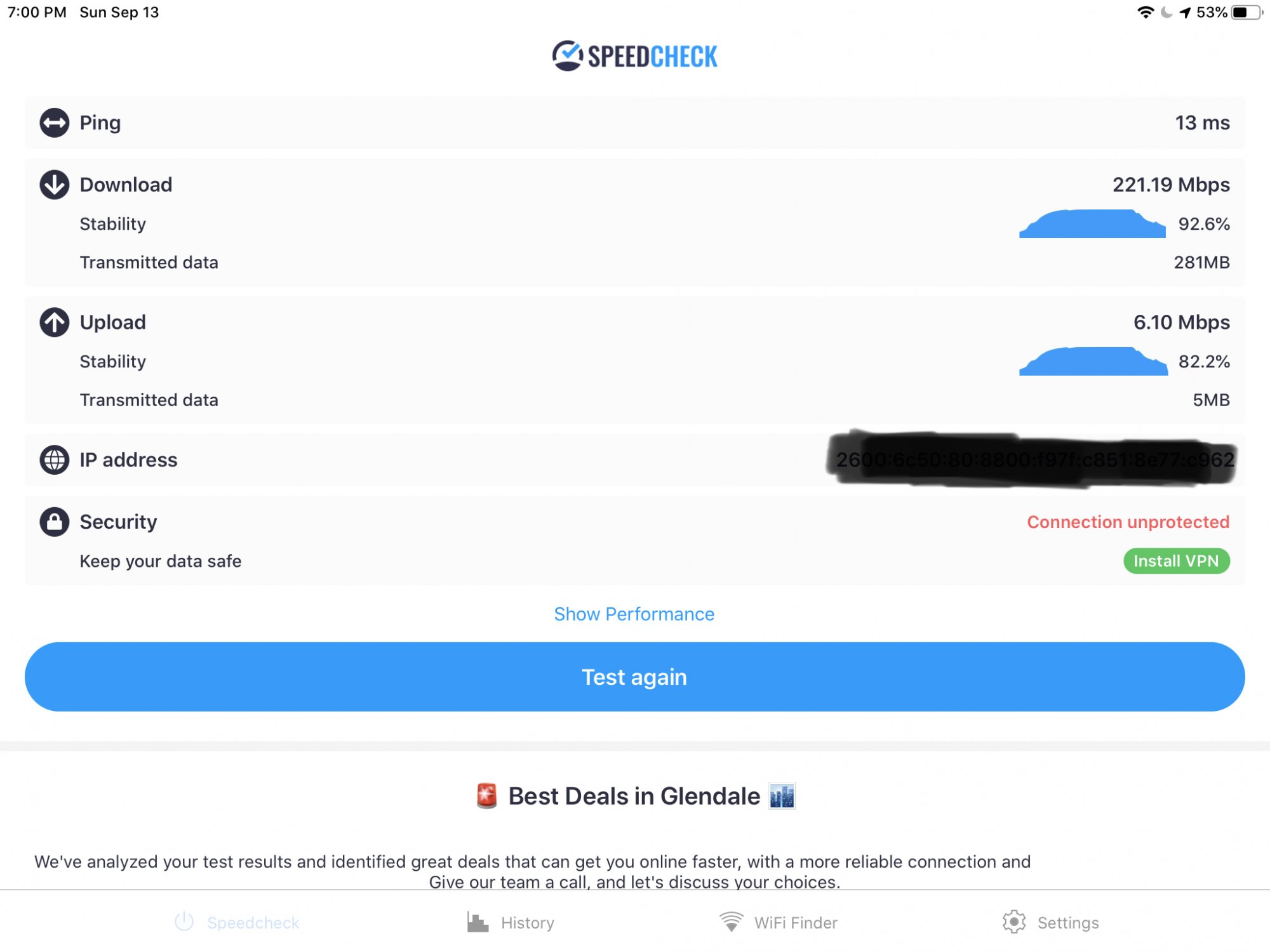

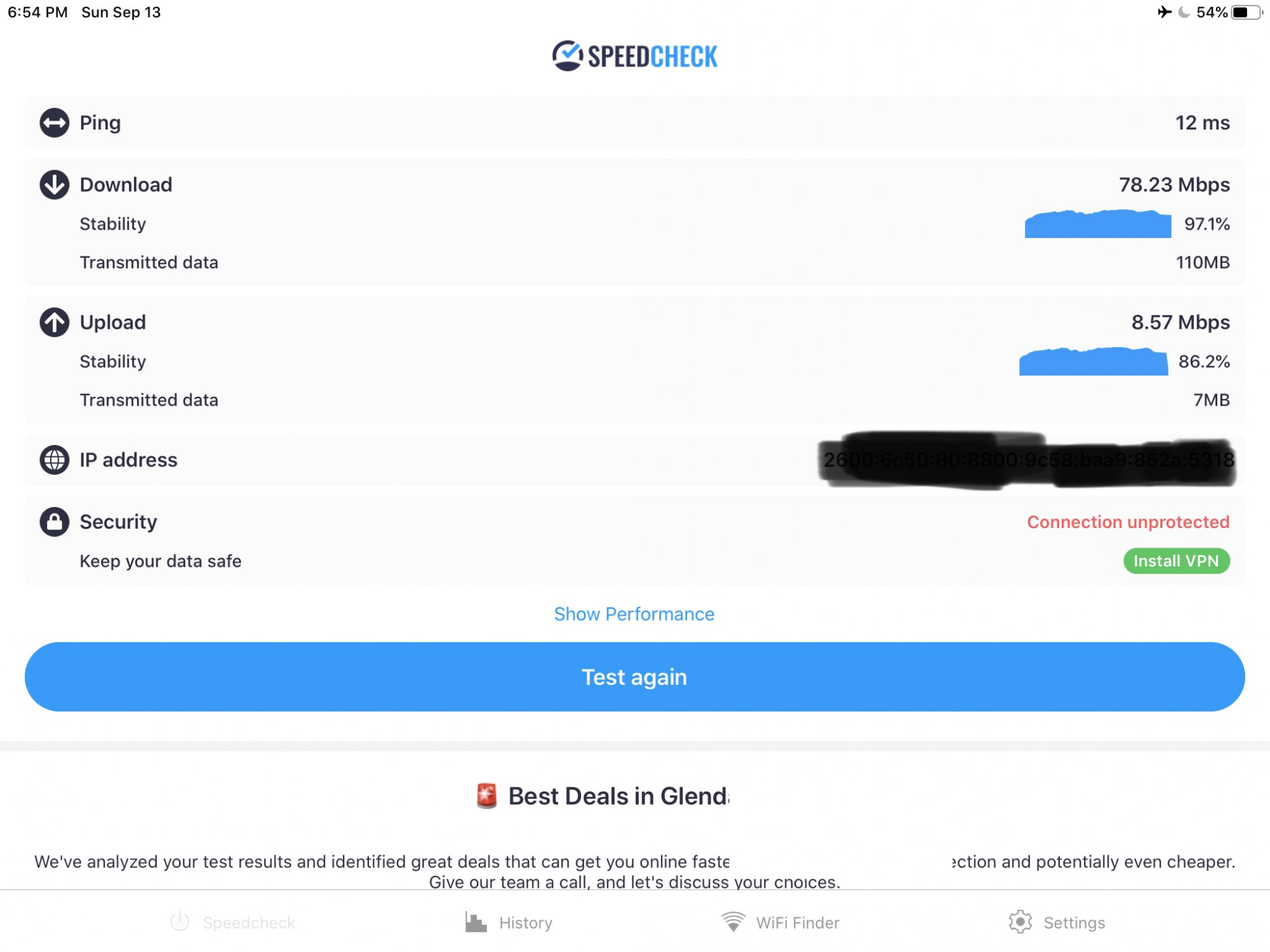

The only issue I have is with speed. The upload speed is about the same with both the ethernet and wi-fi - no gain with ethernet. However, Speedtest says my download is significantly less with ethernet, about 2/3’s LESS. I don’t know how to fix this.
iOS Speedtest bug?
TW100
macrumors newbie
Sep 13, 2020
3
I used fast.com and got a similar result as Speedtest. And I just tried two speed check apps, and both came up with same as Speedtest And Fast.com.
TW100
macrumors newbie
Sep 13, 2020
3
Here is with just wi-fi. The download is significantly higher, but losing a slight bit of stability. The upload is actually showing as better - I do get about 33% more Mbps, and the stability is a bit higher, so this should improve my streaming video. But I don’t understand the disparity on the download.
(Also, Spectrum is ripping me off a bit with these speeds and what I’m paying, so that’s a whole other issue.)
Your iPad is only capable of USB2 speeds. This means it is only connecting at 100mbit speeds, slower than your wifi.
Test it by going into settings and selecting "Ethernet". My USB C hub on a 2020 iPP shows "USB 10/100/1000 LAN".

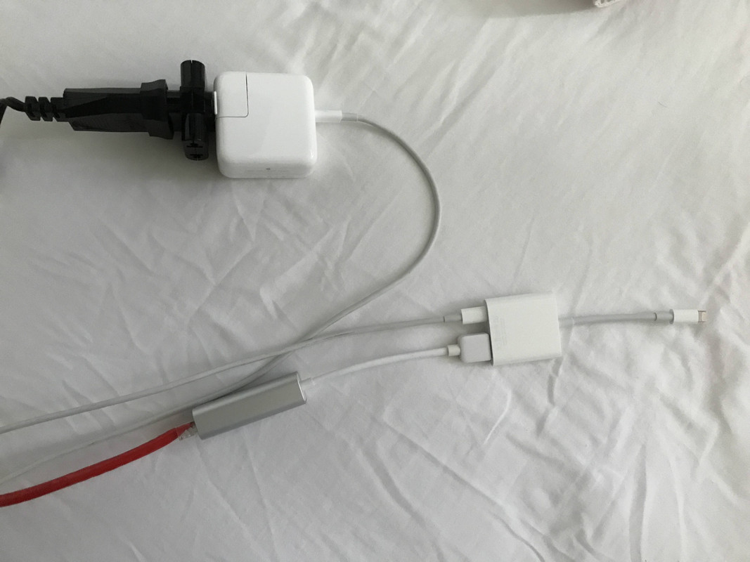

I've been using the ethernet adapters mentioned in this thread in my iPAD Pro 10.5, however I noticed at least ever since the last OS updates this combo (which is not gigabit) doesn't work anymore:
The 1st one mentioned by this post (see picture above). The problem here is that you plug into the lightning port and iPAD-Os fails to conect to the internet. So if your internal IP range is for example 192.168.15.X and your modem is accessible from 192.168.15.1 (internal DNS) this adapter instead does this:
169.168.15.X
I forgot what was the wrong IP he assigns to my iPAD, all I can say it's not the one he should. For example, if this was working properly he should have assigned this random IP:
192.168.15.40
The 169.XXXXX that appears there can't connect to the internet, of course.
So in order for the adapter to work I have to manually inform (just once, there's no need to do this again) what is going to be the random IP:
192.168.15.40
255.255.255.0
192.168.15.1
Otherwise no internet access.
This problem never happens with the gigabit combo informed, using these adapters:
Also, even when the 1st combo works if you barely move the iPAD (for s.h.i.t.t.y. apps that insist in using portrait mode instead of landscape, regardless of your device's screen orientation) you get disconnections. So I advise against any investment in the 1st combo, especially because the 2nd one can get max DL/UL speeds from your internet, including INTERNAL SPEEDS from your network.
With new Apple devices/technologies that allow the use of ethernet adapters that if I am not mistaken are gigabit and don't require a power source to work, so it's just plug and use, I see no point in using all this outdated stuff.
Even the 2nd combo is clunky and discouraging to use after a while. Not to mention if the idea is to cut EMF radiation from wi-fi always turned on 24/7, you are still receiving another form of EMF pollution, this time from the electrical field generated by the old gigabit adapters.
That's because when the 2nd combo is plugged you are also recharging your battery. One more reason to ditch the old and opt for the new.
One more reason to not pay for the 1st combo is the fact the Apple's adapter will not last for long if you keep moving around:
The cable can be easily broken. Another suggestion I'll make is to not buy round ethernet cables.
Instead opt for a FLAT one:
This will allow for moving around the cables and not put too much weight and pressure over the adapters. I bought recently a CAT-8 cable that looked like this:
I didn't understand your whole post. However, my iPad Pro 10.5 with iPadOS 14.5 works fine with Apple's Camera Adapter and Apple's USB Ethernet adapter. It's not gigabit though, so it maxes out at about 95 Mbps, and external power is required. It sounds like you have a similar experience.
BTW, in general flat cables are not recommended, because usually they sacrifice quality for form factor, although YMMV.
Branaghan
macrumors regular
Jul 3, 2019
195
61
The max speeds you get from non-gigabit adapters are 95 Mbps and within your internal network limited to 12 MB/s. 12 MB/s is painfully slow.
I have 300/150 Mbps broadband internet, and all speedtests using the gigabit ethernet adapters reach that. In a few tests I got over 100 MB/s by sendind a file between my PC and this iPAD.
So in terms of speed the BELKIN F4U047BT ethernet adapter
+ this one from Apple:
Are both awful. The issue I explained before (not being able to assign an automatic IP) was about these two.
Also note this BELKIN non-gigabit ethernet adapter + the Lightning to USB 2.0 Camera Adapter (from Apple) combo don't require any external power. That's right, it's just plug and use in my IPP 10.5.
That's the only advantage it can offer.
If you want gigabit speeds with these old devices you need to use another combo:
The "Lightning to USB 3 Camera Adapter" and the Anker ethernet adapter:
Not only that, you'll need to plug both into an external power.
It's not worth the hassle if you are using the new (gigabit) ethernet adapter with the new iPADs, if I am not mistaken you only need this USB-C and no external power is required.
Just plug and start using.
My point about flat ethernet cables was that the round ones are very thick and put too much pressure over fragile adapters that tear much easily if you keep moving these cables all the time. Within a few years you'll need to buy another Apple adapter, if (of course) the one you are using is cheap in terms of being too thin.
But that can happen with any cable, of course. I had to replace my DS4 (joystick) USB one, too, after a few years.
With flat cables the weight is reduced, and so is the impact over these ethernet adapters.
