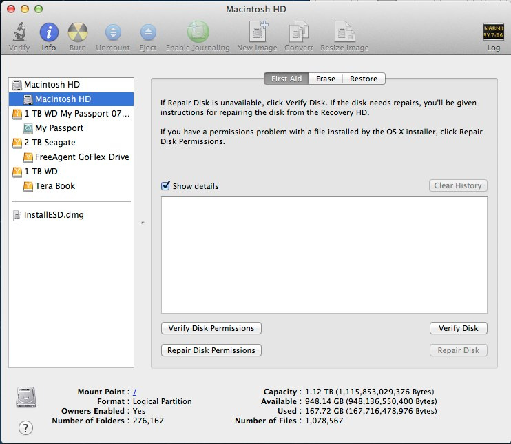

Oh, Disk Utility shows one volume named Macintosh HD, with 1.12 gigs of storage. There is no indication of SSD.

Is it possible to disable fusion drive and have a separate SSD and HDD?
No, the hard drive is a logical volume group with both the SSD and the hard disk married as one.
As requested, a screen grab of Disk Utility:
