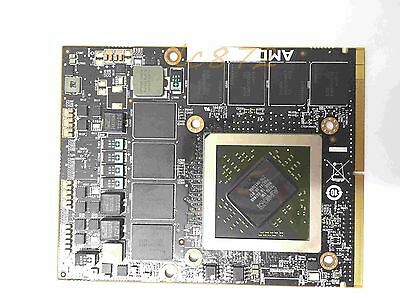

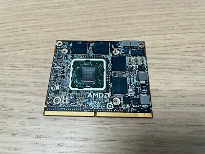

Thanks, but this says 21.5" imac and I have a 27". I found someone selling one cheap and he checked with my serial number that it is compatible.
The only thing is thay seem to come in 500mb and 1gb ram on those GPU, does it make a difference much? Husband doesn't play video games. He does email, poker, youtube and search the net....
Take this advice and run with it.
I found from a friend of a friend one for $40 so I'll take a shot and hope it works and gives me a little time to save for a new one. Thanks everyone for all the great info and advice. I wish getting a new one was in the budget. Not sure what to feel about the new imacs at 24" now, just so much to think about. Thansk again!

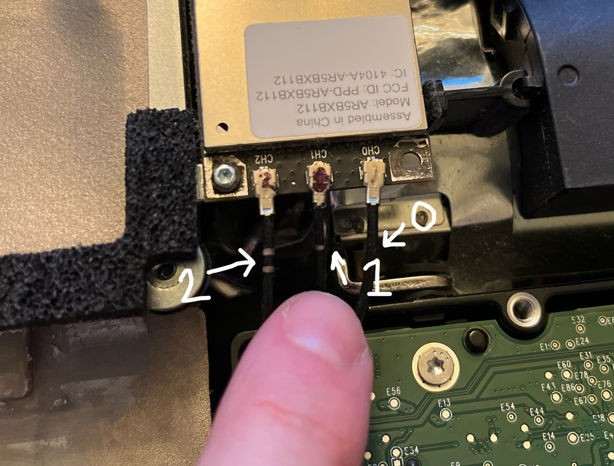

I just received the chip. I am opening the imac tonight but ran into 2 issues.
1- I have to look for the instructions that remove the entire motherboard on a mid 2011 27" imac because the screws on this model are on the other side... great, but Iknow I can handle that with instructions. Hope iFixit has that.

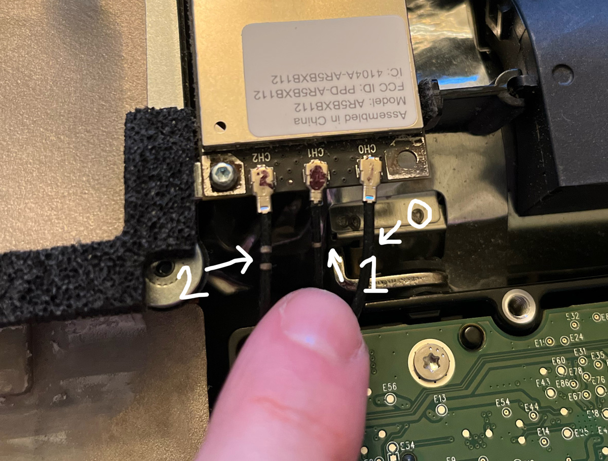

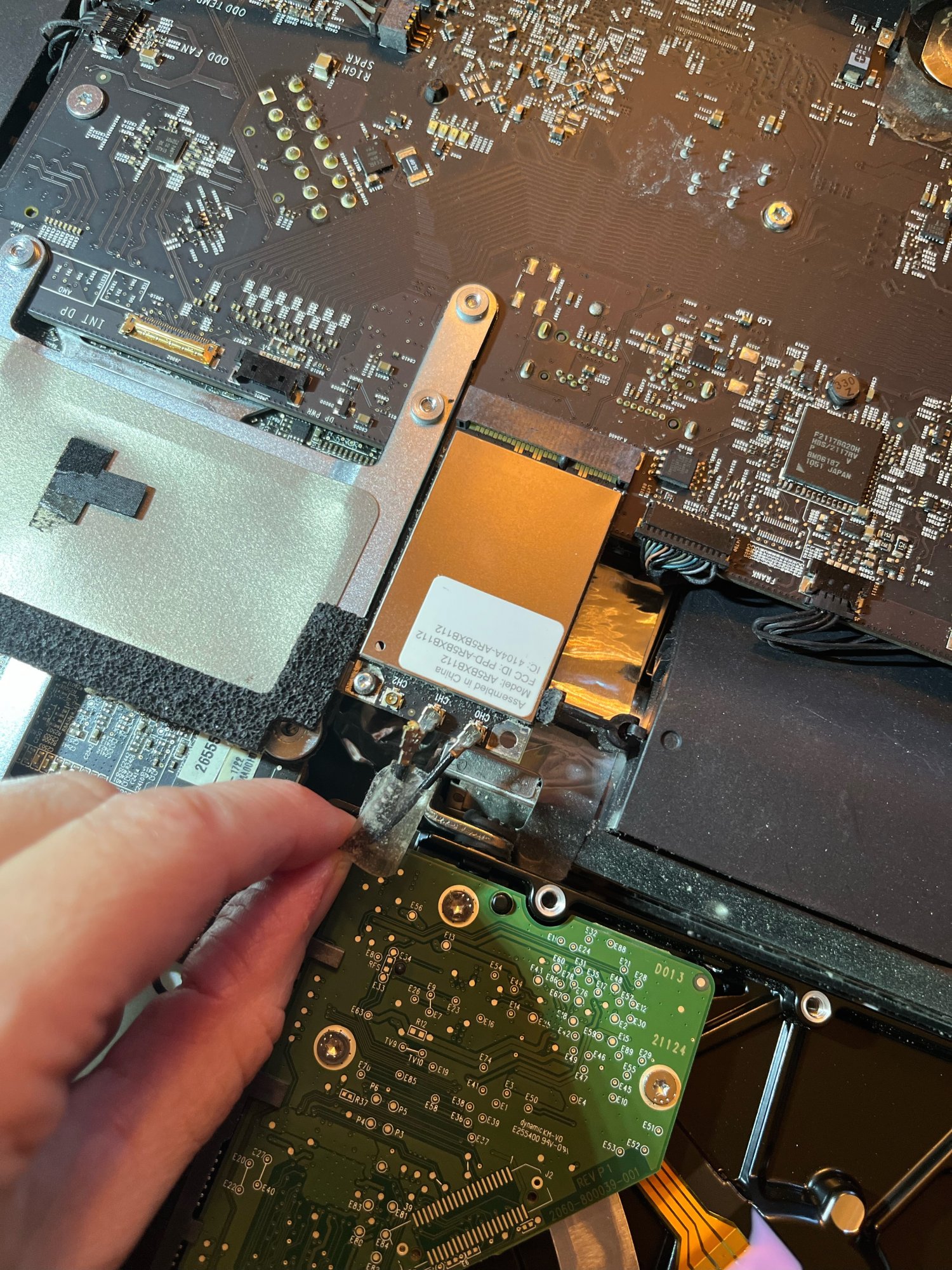

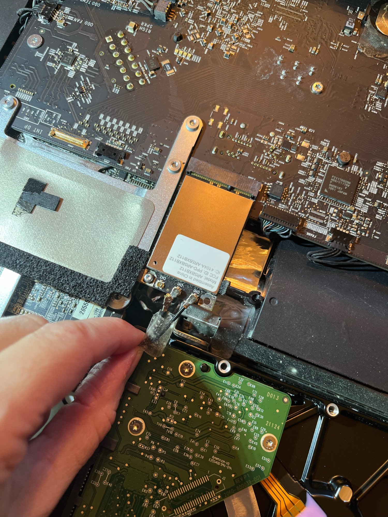

2- (SEE PHOTO) I saw a loose wire in there. No idea if it's supposed to be lose or not and what it does.

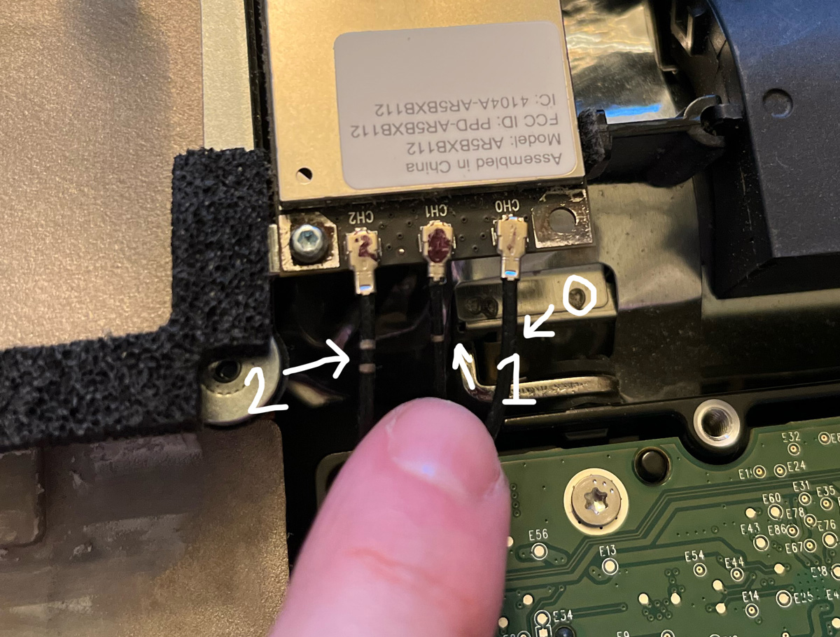

CH0 & CH1 have a wire attached to it. The lose wire looks like maybe it was for CH2?? Maybe not?? Could that be the cause of my problems all along??
I'll just move ahead for now looking for instructions on removing the motherboard and the GPU but will wait until I hear on this wire situation.

CH2 is the antenna lead for the left Airport antenna (one of the Wifi antennas.) There is also a right antenna, which connects to the CH0.
I think it is unlikely that a disconnected wifi antenna (1 of 2) would cause your boot issues.

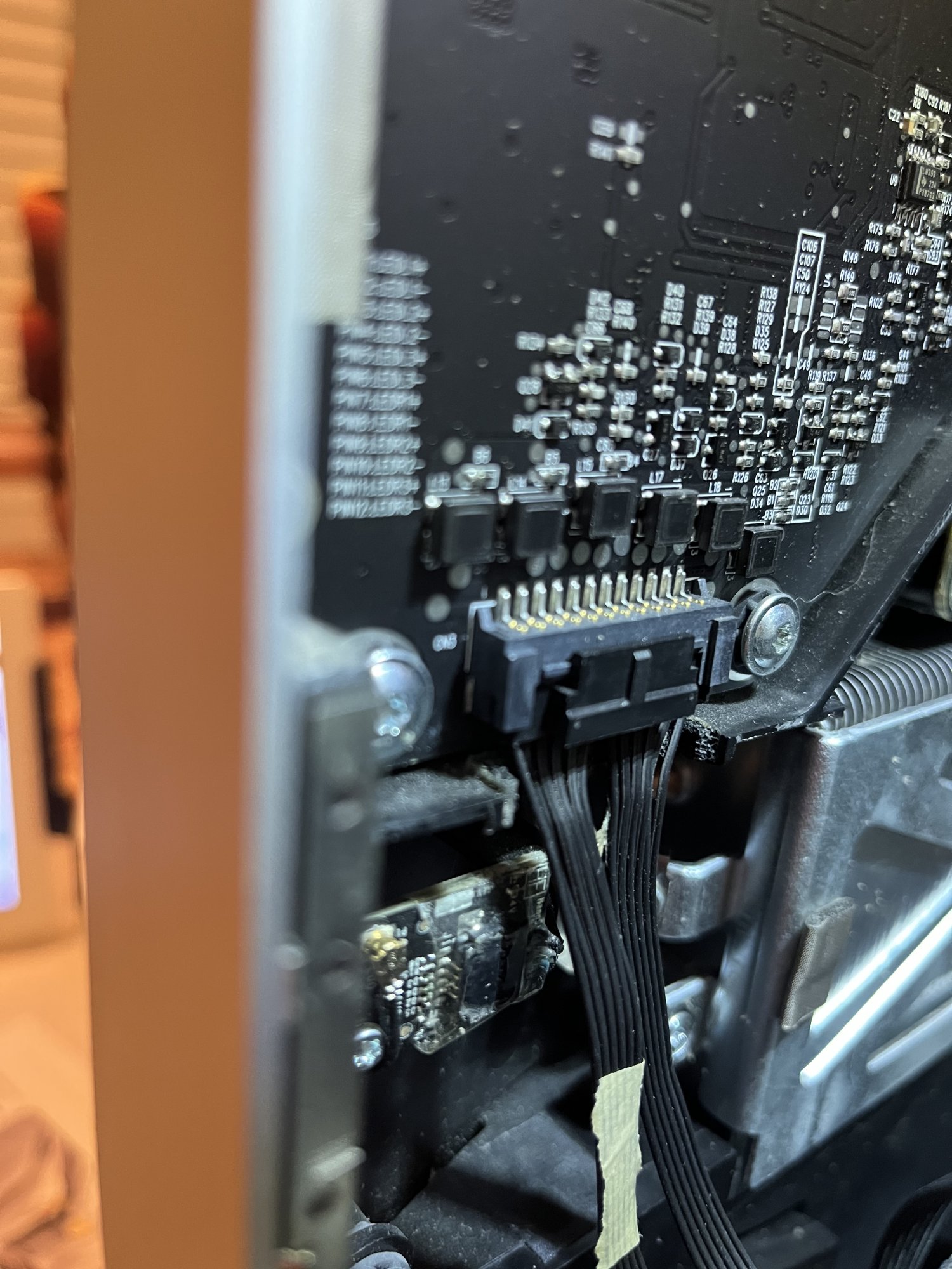

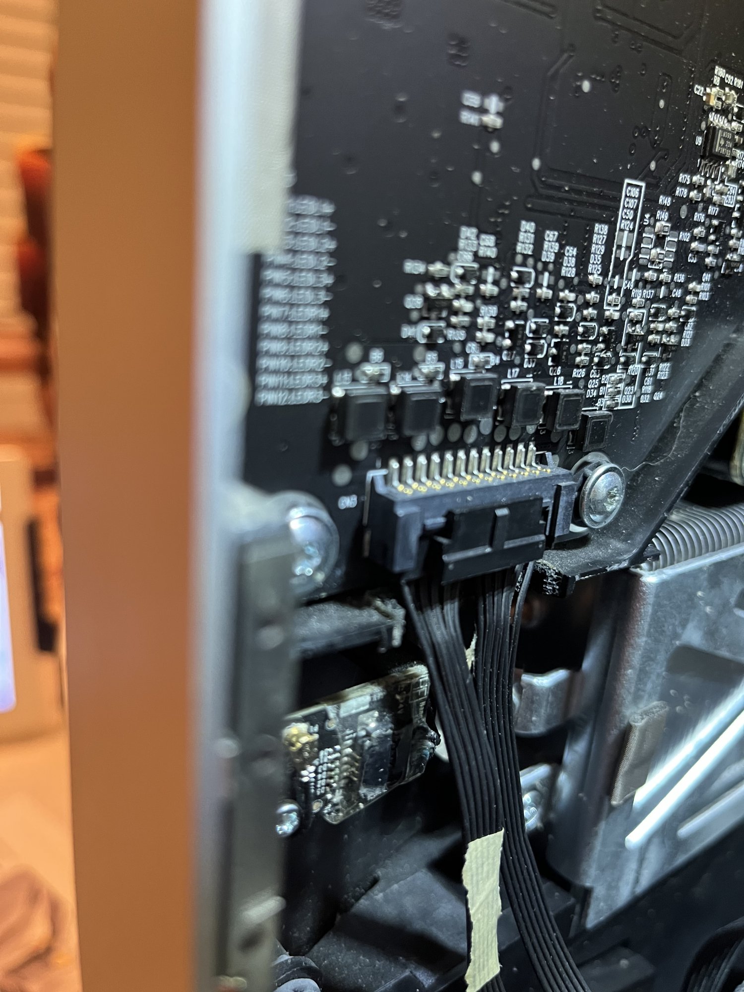

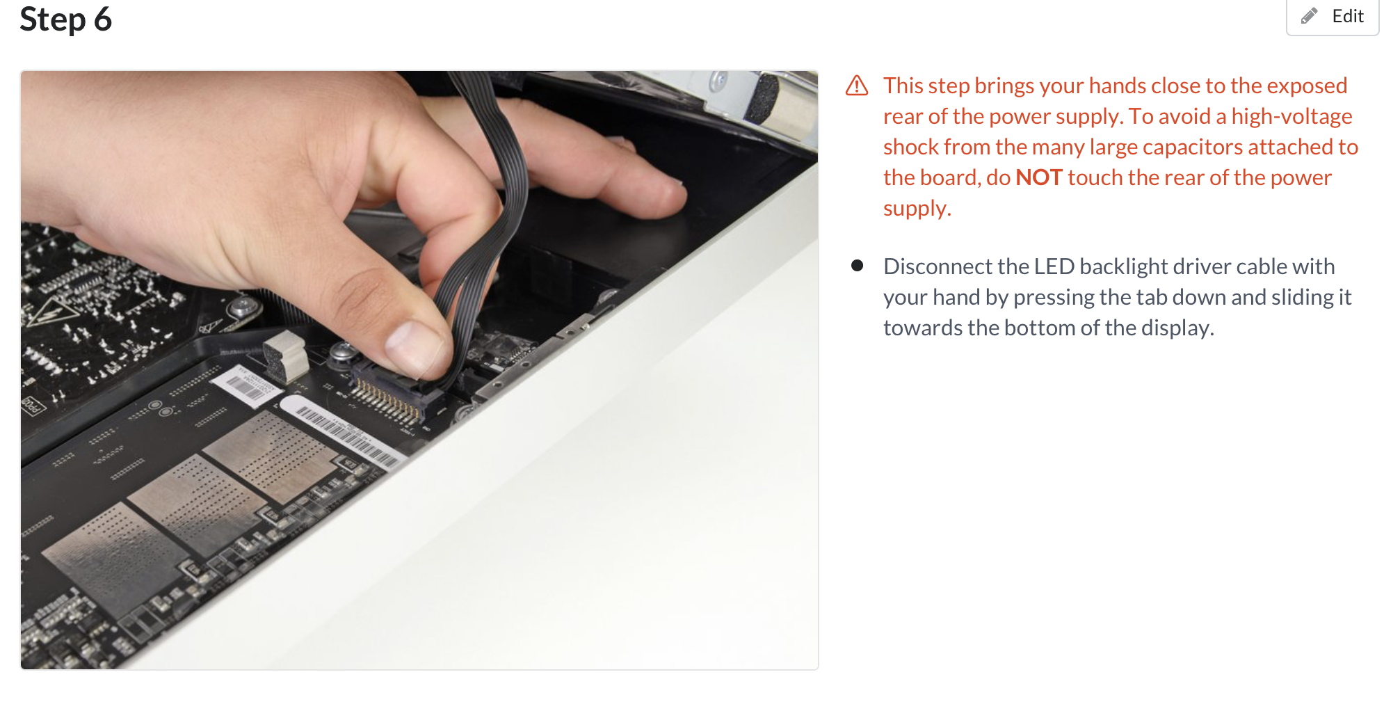

When taking the motherboard the instructions didn't say anything about those 3 connectors CH0, CH1 & CH2 so they all got disconnected. I noticed on the wires one that had NO LINE, one had 1 LINE and the other 2 LINES. I hope I am correct to assume they indicate where to plug them back??
I took the time to take all the other wires to make sure I plugged them back properly but those didn't get marked

It's good that you heard the boot chime, that positive. I know you checked the wires, BUT more than likely, the LCD backlight wire was not plugged back into the logic board. I've done that many times even when I swore the cables were put back when I repaired iMacs 🙂

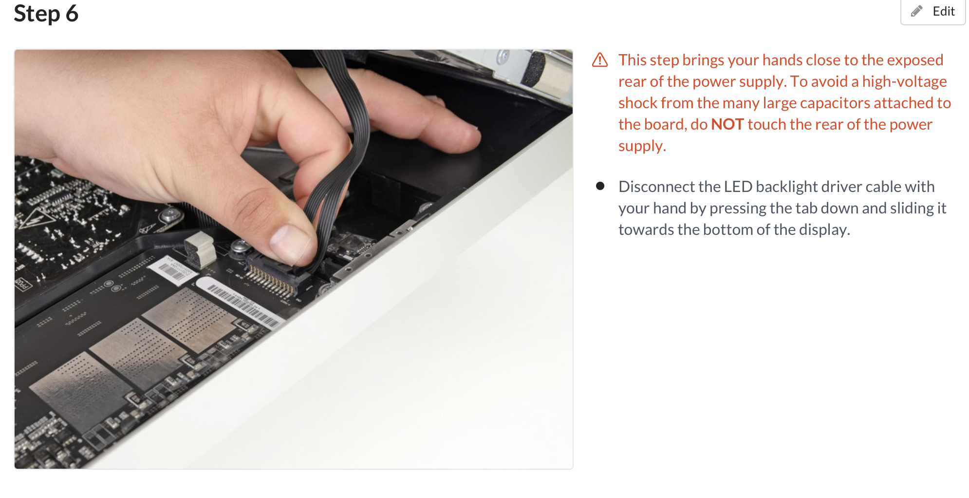

UPDATE...
Ok, changed the GPU, YES, plugged all the wires back, made sure they were all clicked in properly.
The computer starts... I hear the chime...
but screen stays completely black, not even a flicker of life... any ideas?
thanks

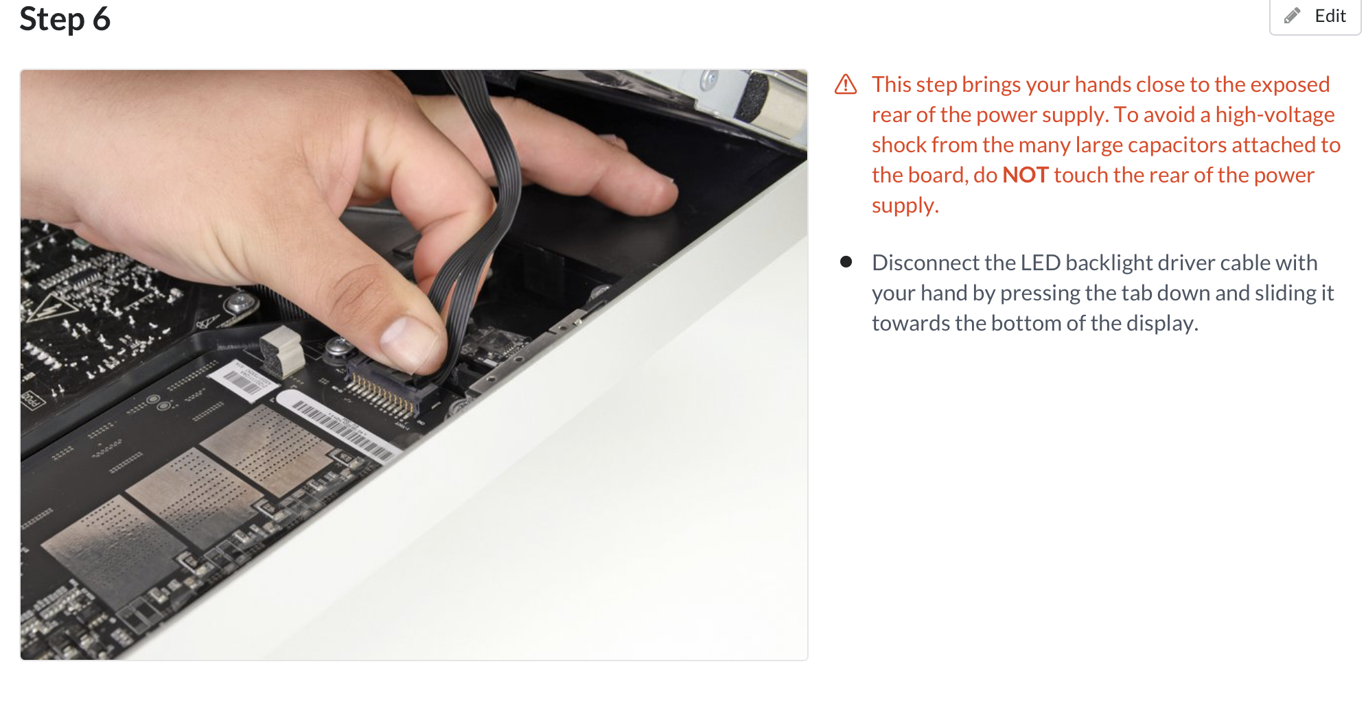

Do this when your iMac lay down face up on a table:
Remove all the screws that bolt the LCD panel to the aluminum frame.
Lift up the LCD panel a little bit and peek inside to check whether all the cables from it had been connected to the parts below.
Reseat the cables.
Power it up again to see if this can fix.
There's 4 LEDs on the front of the logic board that can help a lot with what is going on with the video.
Can help you decide if the problem is the power supply, the LCD, or the logic board/graphics card.
You have to be able to see the LEDs, however. That Apple service manual that I suggested shows how to view the LEDs, and what each LED indicates.
Reseat the cables.
I opened it, reconnected all the4 wires that attached it to the computer and no luck
