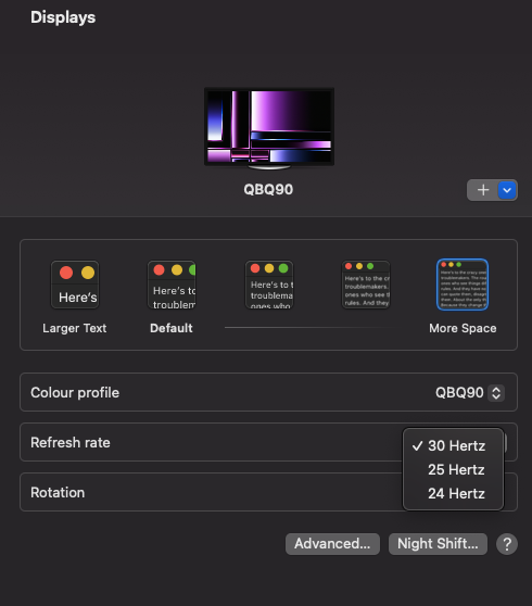

I have the 16” M2 Max and received this USB4 hub today with HDMI 2.1.
I have a 120Hz 4K display but when I connect it through the hub it only shows 4K 30Hz.
I had a power input, webcam and Ethernet connected at the same time.
Shame as I was wanting to go for a one cable solution when in clamshell mode.

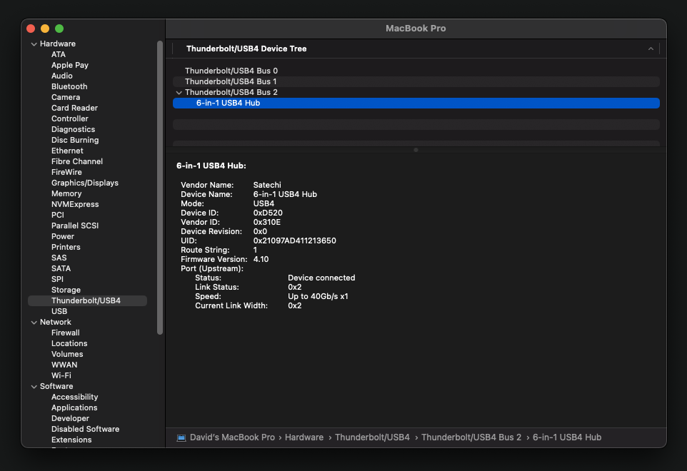

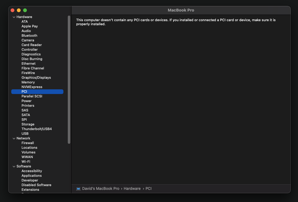

Please try the hub again, and check System Profiler in the Thunderbolt/USB4 tab to see if it is connecting correctly as a USB4 device. Check the PCIe tab to see if it has any PCI devices. Check the USB tab to see what USB devices it has (it should have a hub or two). The ethernet is either a USB device or a PCI device.

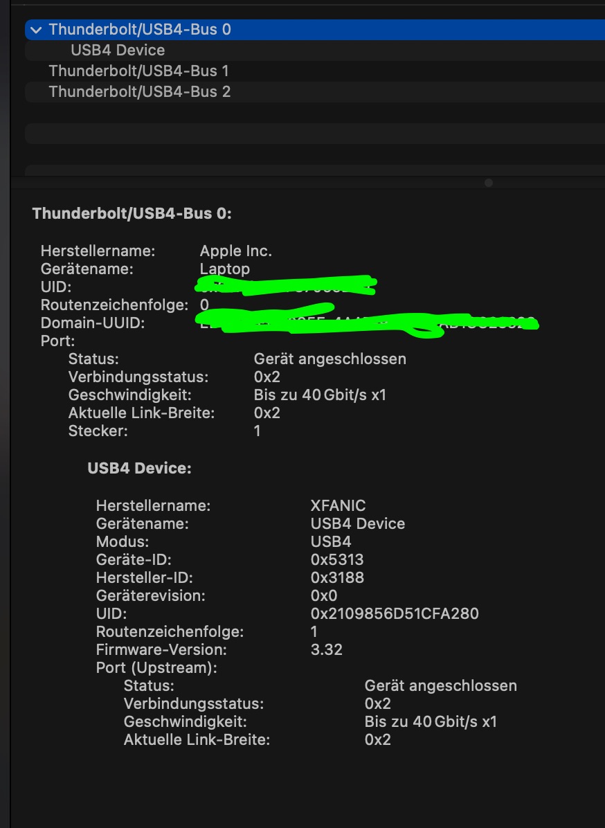

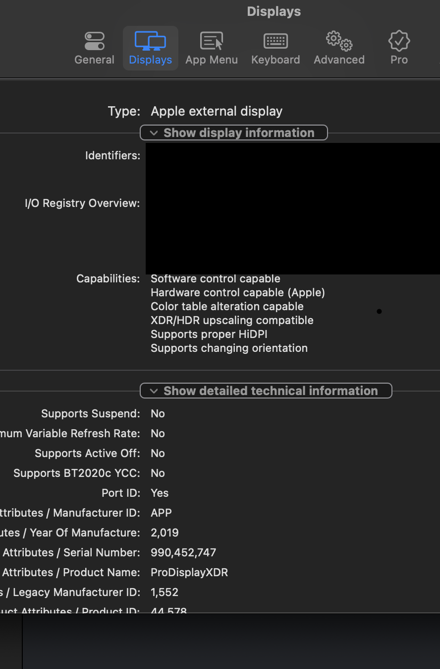

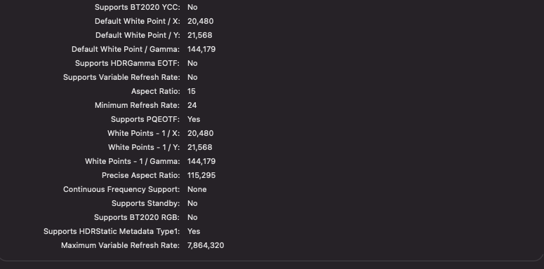

I have an USB Dock also which it show in Devices as USB4/TB Connection with 40Gbps, but iam on M1 MAX:

Sorry I missed it as well! I don't have an Intel Mac anymore, here is the screenshot of the hub connected...

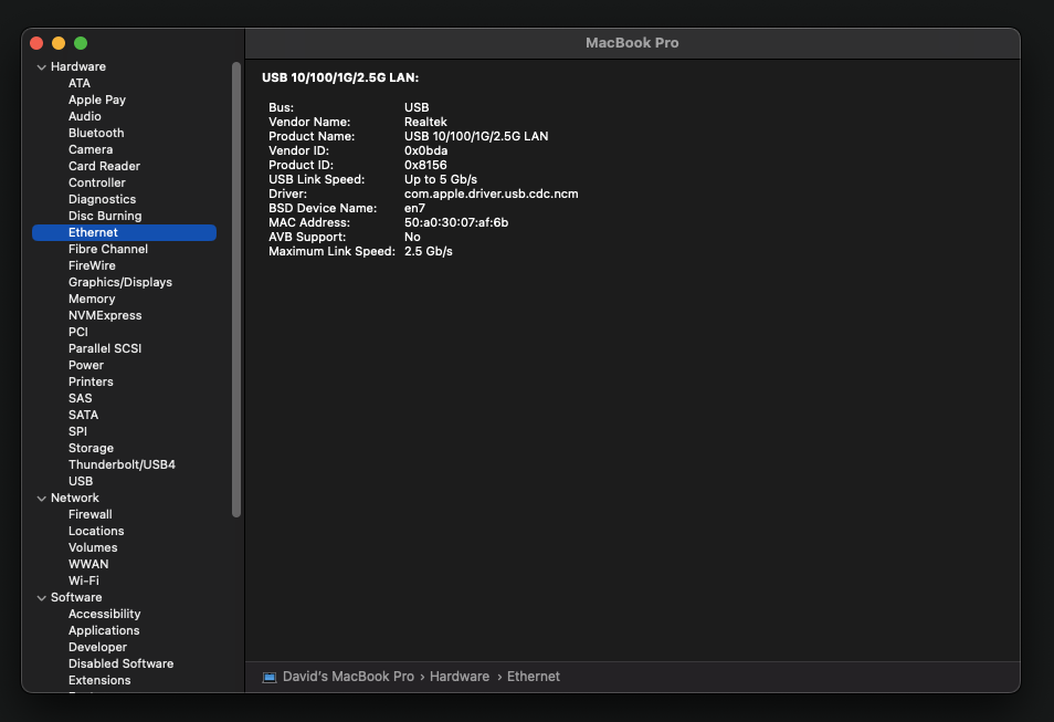

I have ethernet connected via the hub....
Nothing in PCI...

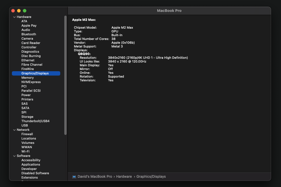

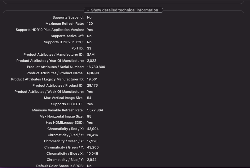

I am connected directly to the MAC via the HDMI 2.1 port and its showing this just for reference...
It looks fine the USB Port is connected with USB 4, the HDMI has 2.1 so it has to be work !! 100% Apple limit this.. Did u try BetterDisplay ?

The Ethernet is a USB 5 Gbps device which is good enough for 2.5 GbE. I need to get an Apple Silicon Mac and find a way to update AllRez to get DisplayPort info on Apple Silicon Macs.

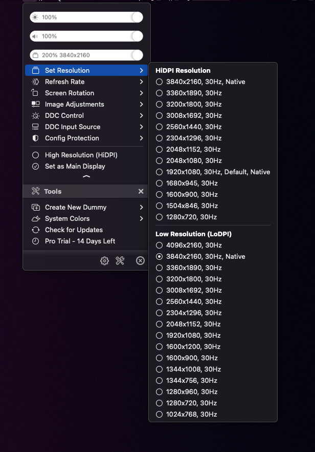

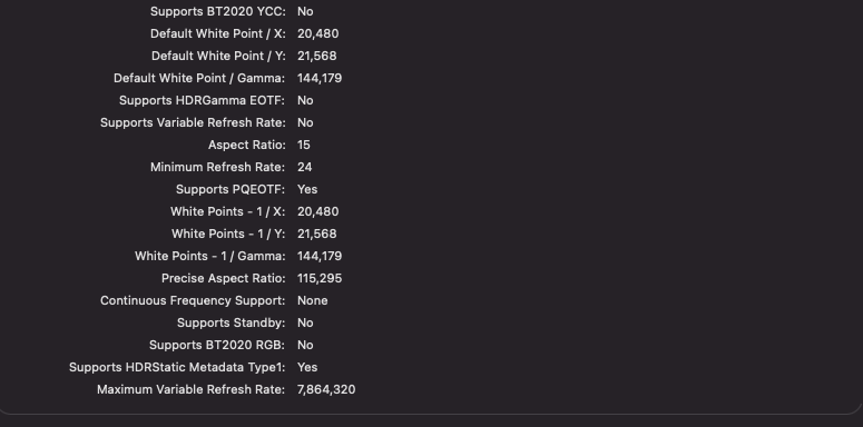

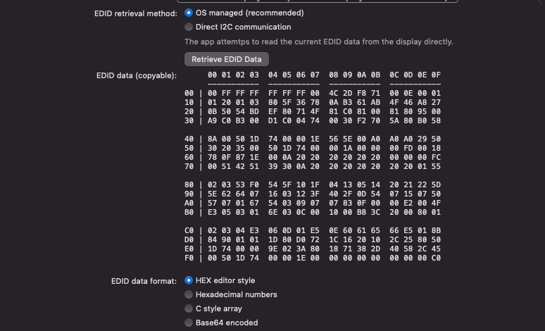

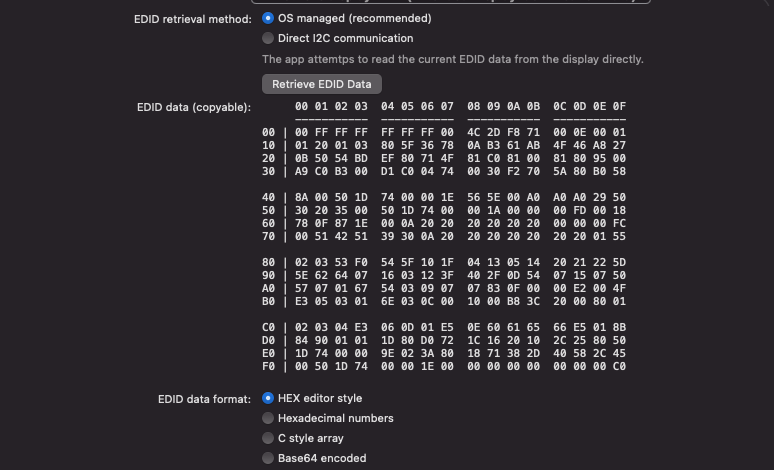

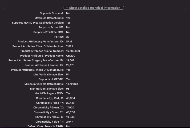

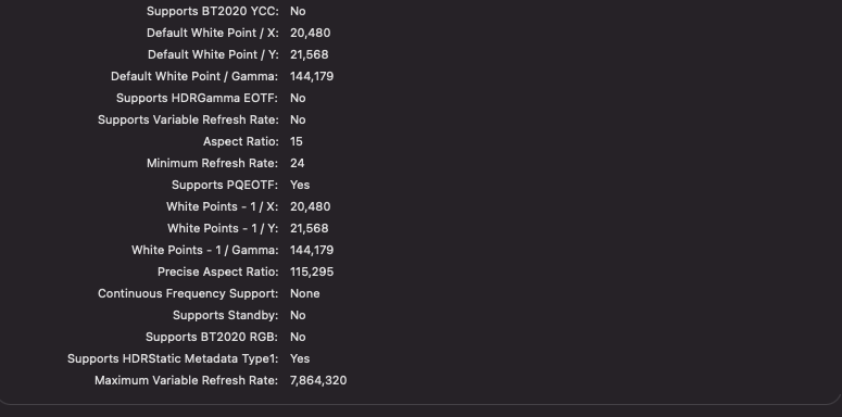

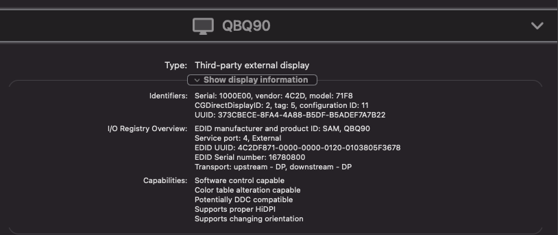

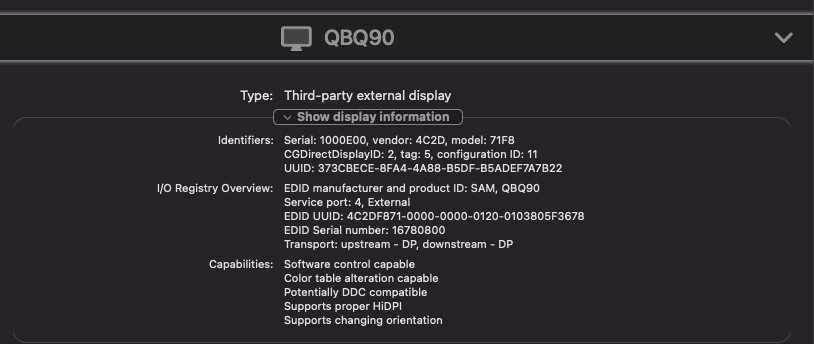

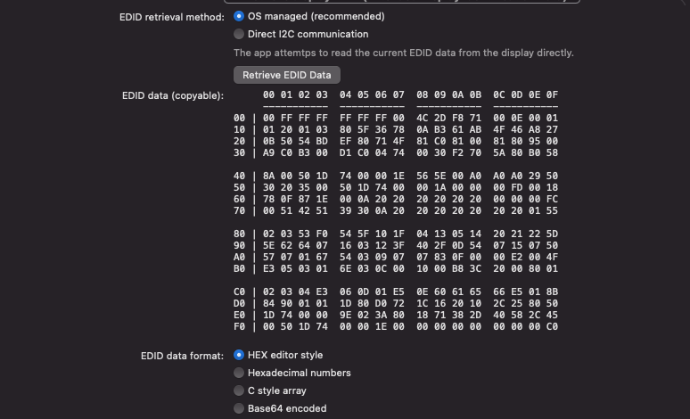

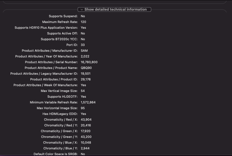

Looks like the Hub does not support more than 30hz. this is not normal. The M1 MAX does support 4k@60hz. Can u write to satechi and send them these informations ? Whe have to wait what waydabber(BetterDisplay) say about that. I send him these informations.

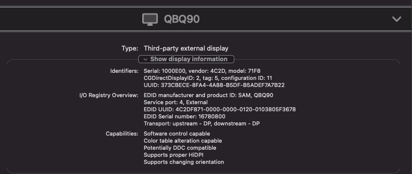

Can u show the EDID inkl. technical information which BetterDisplay shows u ?

Hi guys, check this out to get 4K@120Hz on the M1 over HDMI.
#760
The method is to download the display's EDID via BetterDisplay, alter the EDID's video interface to DisplayPort (if set to nothing or set to HDMI originally - you might need to upgrade the EDID format to v1.4 for that) and then apply the EDID override (which is now possible on Apple Silicon with the latest BetterDisplay app version).
