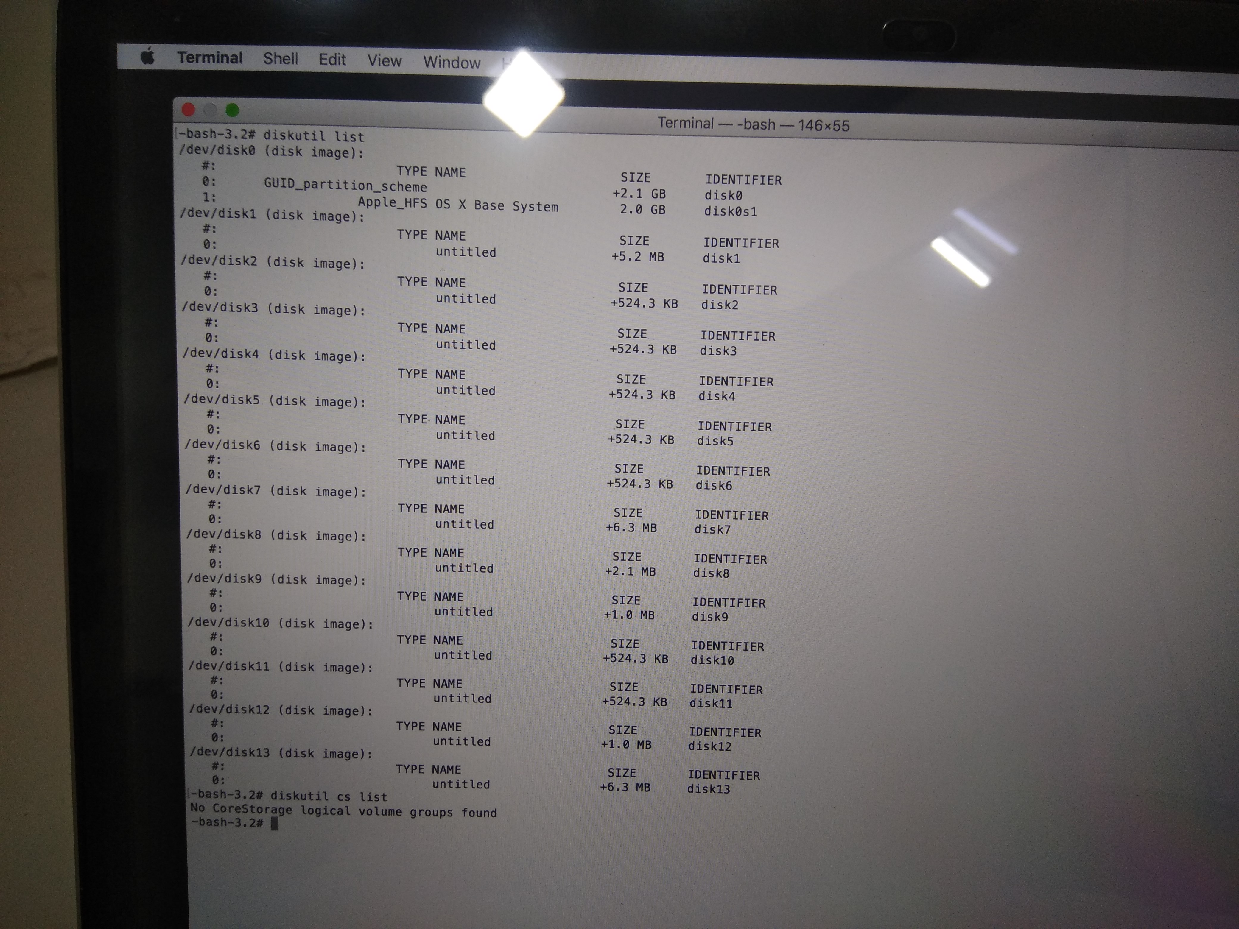

Get back in Internet recovery (make sure it is command-option-r at boot) then in the Utilities menu open Terminal and run these two commands and tell us the output of each.
Code:
diskutil list
diskutil cs list

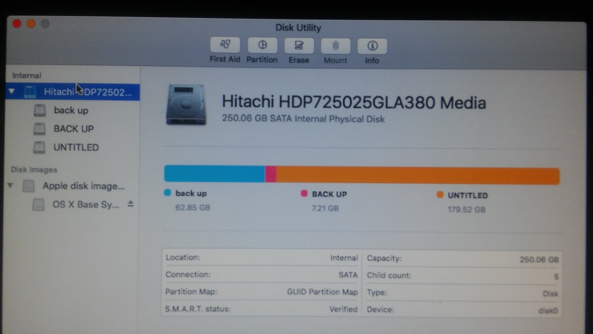

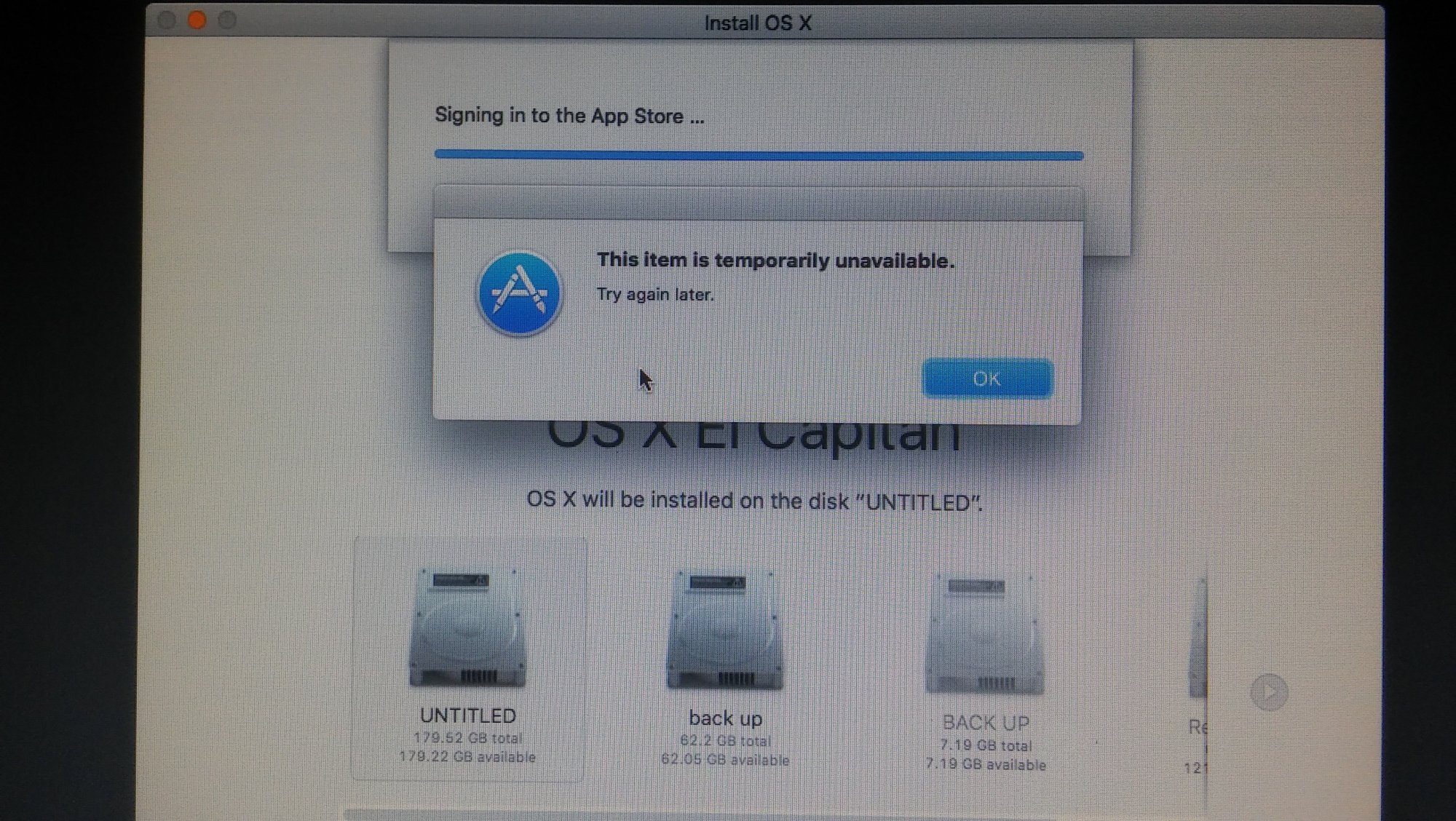

I've followed all the steps posted in this forum and sadly nothing has worked. I can get into the disk utility but once there I have 3 different partitions but no OS X Base system..I have run the diskutil commands and nothing. I am really trying not to just give up on this desktop..It is an A1224 El Capitain was on it when I got it..all I did or tried to do was a system format..This is my last resort because as of now this is nothing but a huge 20" paper weight in my office. Can anyone help?
I bought the desktop from a pawnshop, was trying to factory reset it due to not being able to use it..Couldn't log in as an admin etc..When I went to do so I called tech support due to never having used a Mac before. Followed all the steps as instructed then when I restarted it, it loaded slow (almost 45mins)..The bar was a dark gray under the apple but after that nothing. This was back in March. I haven't done anything to it since. Today I booted it up with the same results. I did go to the TM screen and follow all the instructions. When I tried to see the Mac Core it says CoreSystem not available? Not sure why or what that means but in disk utility I can't find the base system all it has is 2 backup and one untitled file under the Internal tab..I do have the disk images but I did see where it was commented that nothing can be done with those. I really would like to fix this without spending 1000$ or more..It's a nice desktop but if nothing can be done I'll have to trash it, can't sell it as it is.

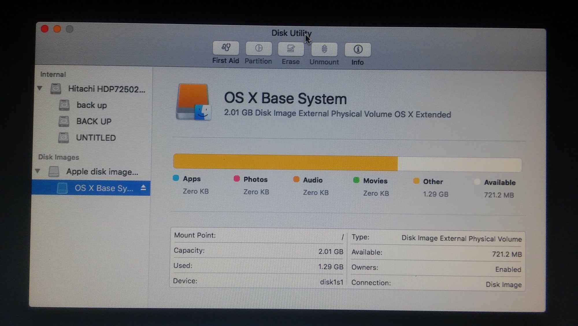

I have tried to run first aid which says the system is fine but when I go to erase it, I get a messae saying it failed. The details say the disk could not be unmounted but it was never mounted.
If you hold command-r when booting, will it boot to recovery?

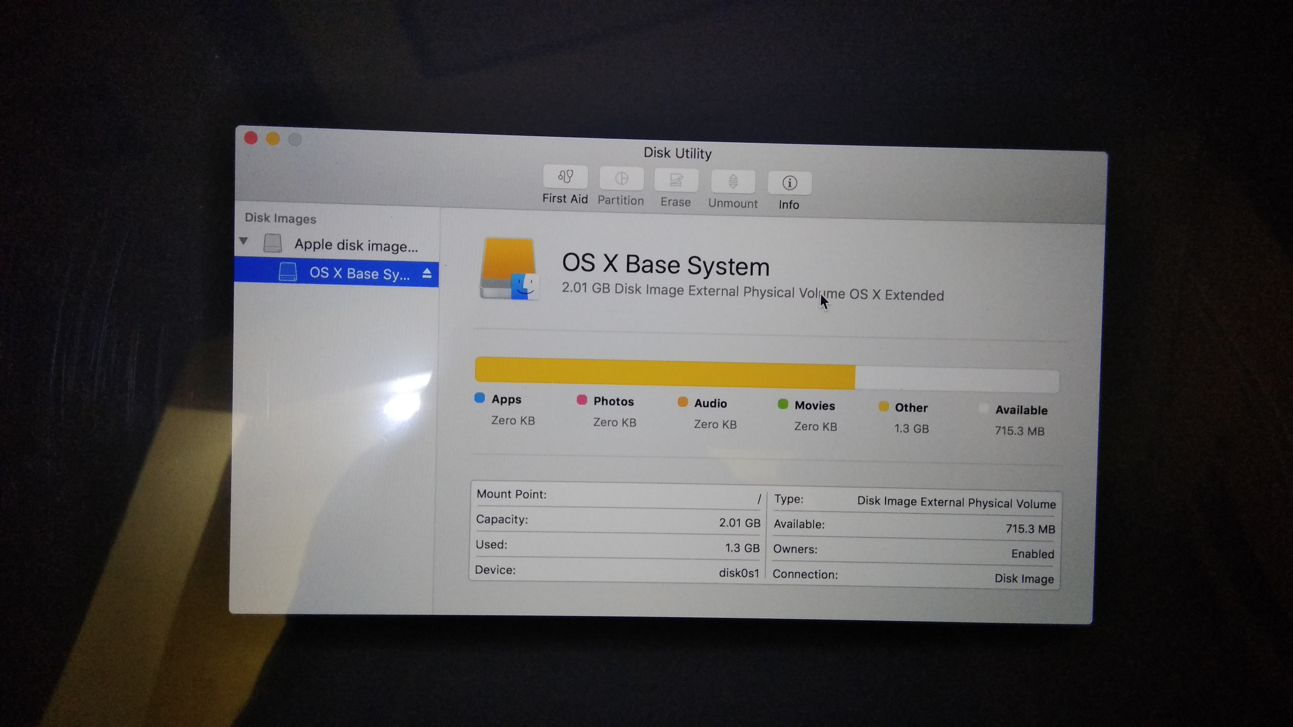

I can get into the command menu OS X Utilities and have all 4 options but it will not reinstall OS X there is no back up due to this not being my desktop, again I bought it from a pawnshop :( and the disk utility shows no OS.
The recovery system is the one you are booted to.
There are three active partitions on your iMac: Untitled, back up, and BACK UP
None have any files, and no system installed.
The "OS X Base System" is on the recovery system, but that won't help you. It's just the minimal system that the Recovery HD uses to boot. You can't do anything with that system to help you get OS X installed again.
Best way forward is to download the El Capitan installer, and make a USB bootable installer from that.
Boot to THAT, and open Disk Utility. Choose the line starting with Hitachi, and erase the hard drive. That will remove the extra back up partitions, and leave you with just the one. Then, just continue with a reinstall of OS X. And, you're done :cool:
But, you also said that you tried an erase of the hard drive, which failed.
If so, it's very likely that the 11 or 12 year old hard drive is on the edge of failure (or already failed).
That would also explain why the install process was very slow.
Your iMac is probably either a 2007 or 2008 model, so a failed hard drive would not be a surprise.

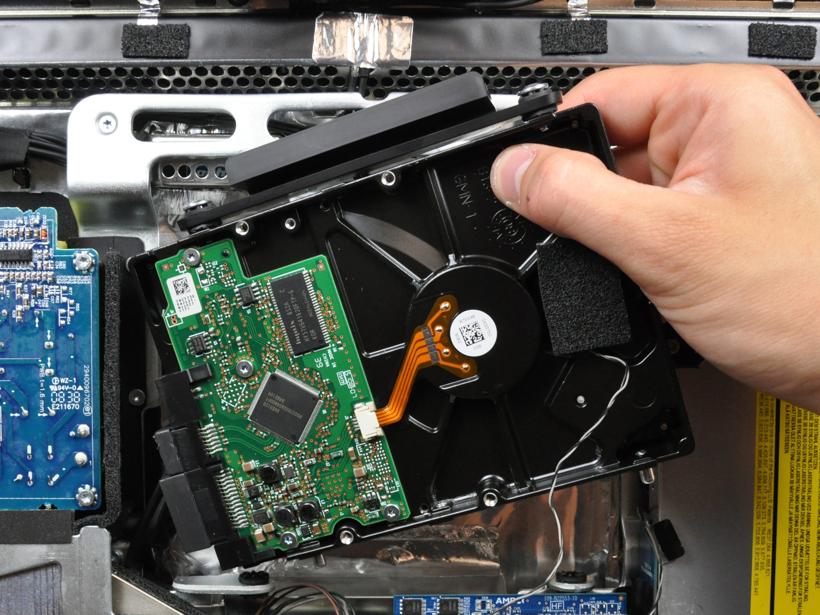

Replacing the hard drive is not particularly difficult, and you can find instructions for doing that at iFixit.com:
You can even purchase a replacement drive, along with all the tools you need on that same page.
(Is it worth about $100 to get that 12 year old iMac working again? Only you can answer that question)
