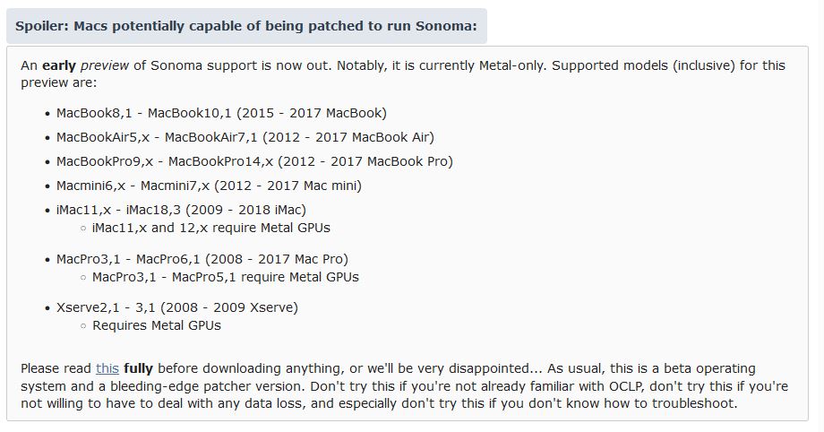

An MP31 can run everything up to Sonoma. So, if his A1186 is an MP31, then he can do a lot and as someone correctly said, the OP needs to provide what model it is he is running exactly before providing advice on what can be done or not done (hopefully based on facts).
The screenshot below from here on Macrumors should tell you what you need to know:
Let's get real for a minute. Even if he has a 3,1 he'll still need a Metal GPU. Given the OP's unfamiliarity with (most?) things, getting a proper GPU and OCLP support is about 16 steps to far for this fellow.
Even IF he has a 3,1, AND even IF it has a Metal GPU, AND even IF it has enough RAM (8 GB), there's still a high risk that if he attempts to install those drivers it'll fail (because it's expecting an i5 processor) AND if the drivers do work then it might not work because the processor is too slow (we are talking about audio drivers and software programs after all).
Honestly, it's a fun project to get a 3,1 to work for this purpose, but it sounds like the guy just wants to make music. If that's the case, just spend the $150 to get a used Dell and use that.
I'm stunned that they can get Mac Pros 3,1 to run with Sonoma. That's 15 years of unofficial support! Didn't know that, thank you :)

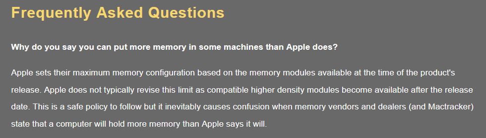

Is Mactracker wrong about the Mac Pro 1,1s? It says Apple claims they can have 16GB of RAM, but can have up to 32GB.
Many cMPs ended up being able to use higher RAM than Apple stated at release. MP31 can go to 64gb for instance but the "official" limit is 32gb.
From MacTracker:
