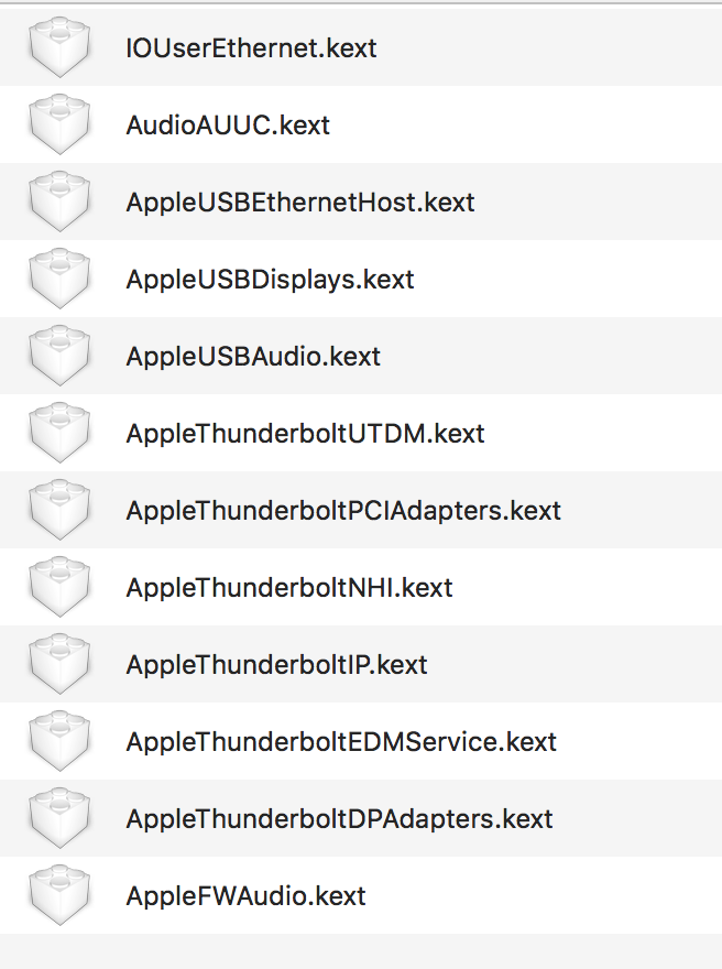

Try to replace all of these 12 files. It should work. But honestly I believe that my Mac slowed down using this solution. Best one that works for me is a python script, try this.
You show a list of files to replace, but you don't offer any information about what you replace them with.
How about a link to "a python script" that you want someone to try?
By replacing I meant to just get rid of them from the Extensions folder (after you enable csrutil in terminal). Simply create another folder and rename it to ex. Extensions Disbaled and move mentioned files into the new location.
Python script is available few pages back, someone already uploaded it.

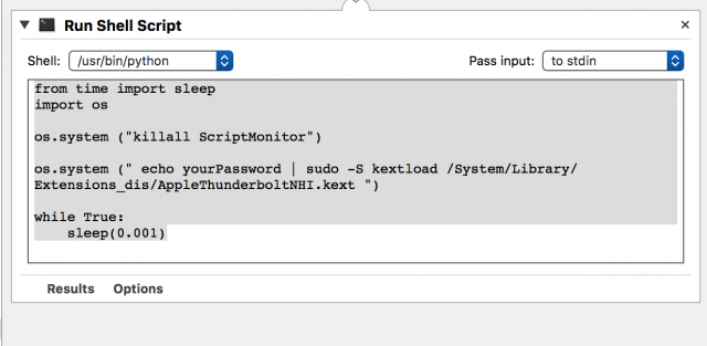

Now you can create an executable to run every time you need to use the a thunderbolt device, this script will load the driver and launch the famous python script to prevent the Mac from crashing.
The python script is using a considerable amount of power so wen the thunderbolt device are not needed its better not to have it running for better battery life and performances.
1) Open automator and create a new "Application" document
2) from the side bar select "Run Shell Script", under Utilities
3) select the kind of shell as “/usr/bin/python“
4) paste this code:
from time import sleep
import os
os.system ("killall ScriptMonitor") #this avoids having the automator monitor open after running the application
os.system (" echo yourPassword | sudo -S kextload /System/Library/Extensions_dis/AppleThunderboltNHI.kext ") #this loads the driver
#this keeps your mac alive, you can tweak the number, the original one is (0.00002) and corresponds to a quite hight 20% cpu load, (0.001) is around 2% and its seems to be enough on my system
while True:
sleep(0.001)
5) replace "yourPassword" with your system password, it is needed to load the kext
6) export the application, if you prefer you can download the zip form here https://github.com/pignoniG/Load_Tunderbolt but you need to edit the "Contents/document.wflow" file inside the app and replace "yourPassword" with your password.

So if you disable (move out of /System/Library/Extensions) AppleThunderboltNHI.kext driver then reboot. Everything runs ok, you can connect external screens via Thunderbolt.
The only drawback is that Ethernet via Thunderbolt will not work.
PS : you can't just move kext driver files from /System/Library/Extensions even if you're root. You need to disable "csrutil" (just google it)
Yep, you just revived my macbook. I have probably been looking up this issue 20+ times without finding a real solution. Hats off to you!

BTW deleting the thunderbolt driver didn't change anything I still have the same problem.
Deleting all 12 drivers that someone listed don't help me. I must use python script all the time. I lost hope for repairing it... Apple should change our motherboards or something.
If you are sure you did everything correctly (disabled SIP? did your computer update since the day you removed the kext?) you can probably make the pyhon script less of a problem reducing the load. The 20% cpu load was unnecessarily high for my machine, I get a stable computer with just 2% load.
To try to increase gradually the value of sleep, the original one is (0.00002) but now I'm using (0.001)
while True:
sleep(0.001)
while True:
sleep(0.001)
Yes, I'm definitely sure and have no idea why it didn't help me. When I try python with value = 0.002 my Mac still freeze sometimes, so I'm using default value. I'm so angry because I can't even sell my Mac with this issue (or maybe for a fraction of amount that I pay). I'm also angry because I had apple care, but they didn't help me, said that everything is okay.
You can tweak the value to get to sweetspot of lowest performance reduction and stability.
