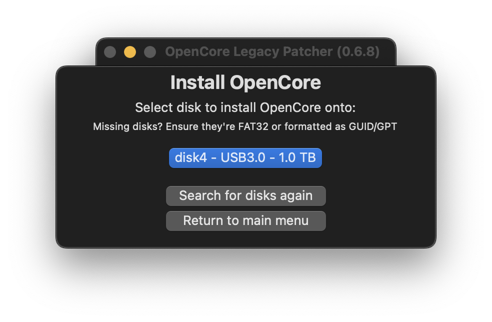

and is it better to use Open Core App, or use Terminal Commands, or do i need to do both?
I have tried Open Core but it doesnt appear to swicth of the port.???!!
Can anyone help with this?
i use Open Core and follow directions but the Thundertbolt Port is still acive.
ive teied the Terminal commands, gone back to sevwral forums which talk about those commands, and the orede fo commands changes, and i cant get some of the commands to work.

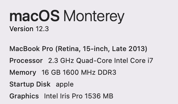

I own a 15" Macbook Pro Late 2013. Everything works great in Monterey, no problems so far.

Installing OpenCore worked for me, I can even update it without having to repeat the process.

OpenCore is a patch for macOS Monterey or Ventura which allows you to install them on older macs, it is an open source project and you can check the code here https://github.com/dortania/OpenCore-Legacy-Patcher. So far it has been working great, with no bugs and no battery or memory issues. I recommend downloading the latest OCLP and install Monterey as Ventura support only began a couple of months ago. The patch is applied only once and you can update macOS without issues. It is also reversible.

I've recently updated to Big Sur, which works great, but I still had to use the method of moving the AppleThunderboltNHI to .bak since the opencorepatcher doesn't seem to save the developer settings for disabling the Thunderbolt port. Everytime I reboot it the setting is unmarked again. Are there any tips for this issue since I want to update to a newer version of Big Sur without using the moving method of the kext files?
It seems you are confused, the settings are for configuring the patch, after that you have to build it and install it on your main disk.
https://dortania.github.io/OpenCore-Legacy-Patcher/BUILD.html
