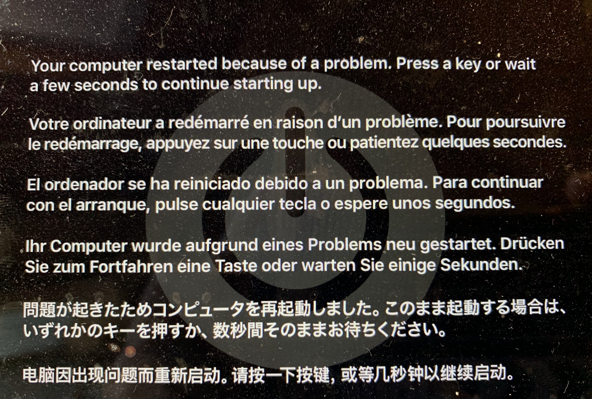

I had this problem, too - black screen, fan spins up, keyboard lit, 5-15 seconds of that, then shutoff. I called support, talked at length, brought it to them, they replaced the battery, wiped and created a new user, and found...nothing.
I brought it home, it kept doing the thing. I took it back, they checked for anything, wiped, gave it back. They still hadn't found anything. I brought it home, it did the thing. I took it back, they did the same thing. I took it back.

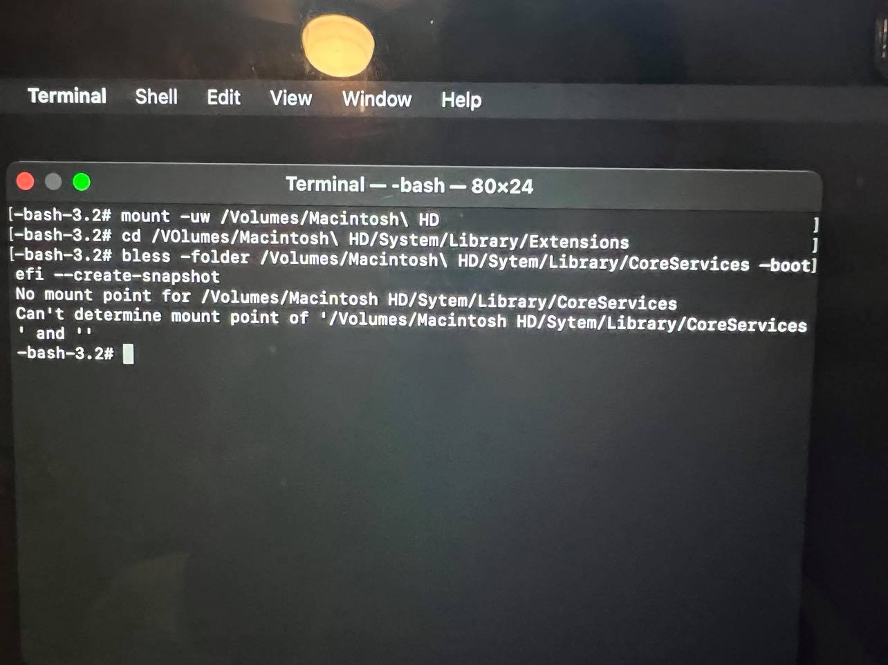

Followed the instructions but failed to perform the last step bless. Here is what I did
For me
Started in Recovery Mode
- csrutil disable
- csrutil authenticated-root disable
Reboot Started in recovery mode again
- mount -uw /Volumes/Macintosh\ HD
- cd /Volumes/Macintosh\ HD/System/Library/Extensions
- Removed AppleThunderboltNHI.kext AppleThunderboltNHI_kext.bak
rm -rf AppleThunderboltNHI.kext
rm -rf /System/Library/Caches/*
- Renamed
mv AppleThunderboltDPAdapters.kext AppleThunderboltDPAdapters.kext.bak
mv AppleThunderboltEDMService.kext AppleThunderboltEDMService.kext.bak
mv AppleThunderboltIP.kext AppleThunderboltIP.kext.bak
mv AppleThunderboltNHI.kext AppleThunderboltNHI.kext.bak
mv AppleThunderboltPCIAdapters.kext AppleThunderboltPCIAdapters.kext.bak
mv AppleThunderboltUTDM.kext AppleThunderboltUTDM.kext.bak
- kmutil install -u --force --volume-root /Volumes/your MacOS files location
Then onto the last Step
- bless --folder /Volumes/Macintosh\ HD/System/Library/CoreServices --bootefi --create-snapshot
Also Tried
- bless -folder /Volumes/Macintosh\ HD/System/Library/CoreServices —bootefi --create-snapshot
Gave me the same error.
Was unable to perform the last step. Picture shown below of the error.
Would appreciate any feedback or advice!
Running on MacBook Pro Retina 15" Late 2013; MacOS 11.6 Big Sur

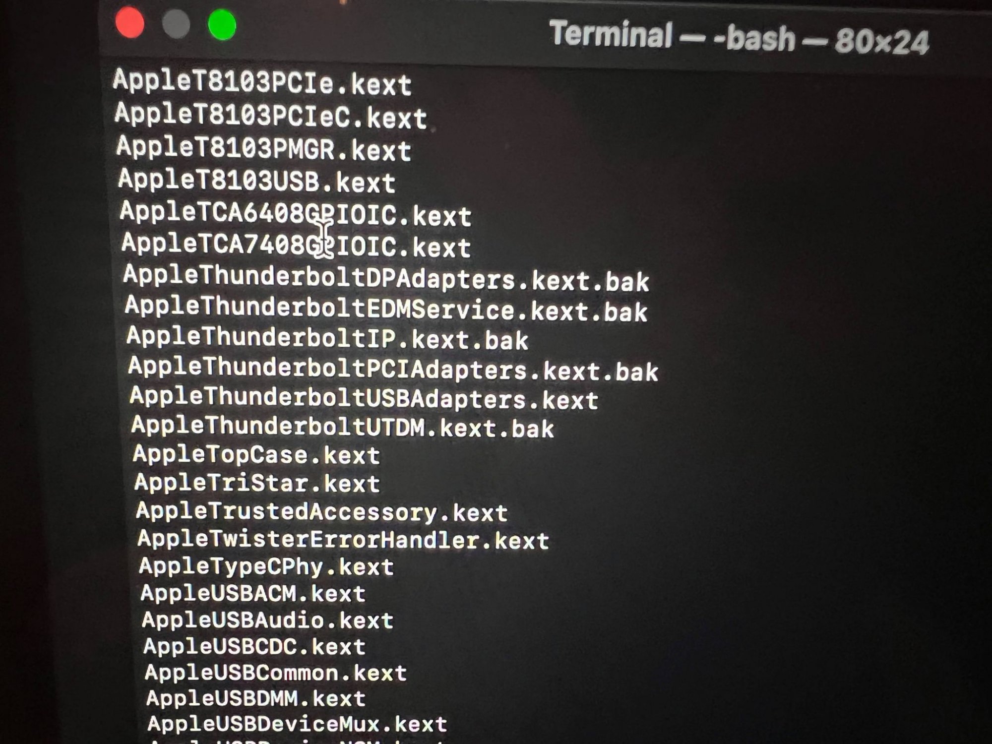

1st Picture shows NHI file was removed and all other Thunderbolt.kext files were renamed to .kext.bak

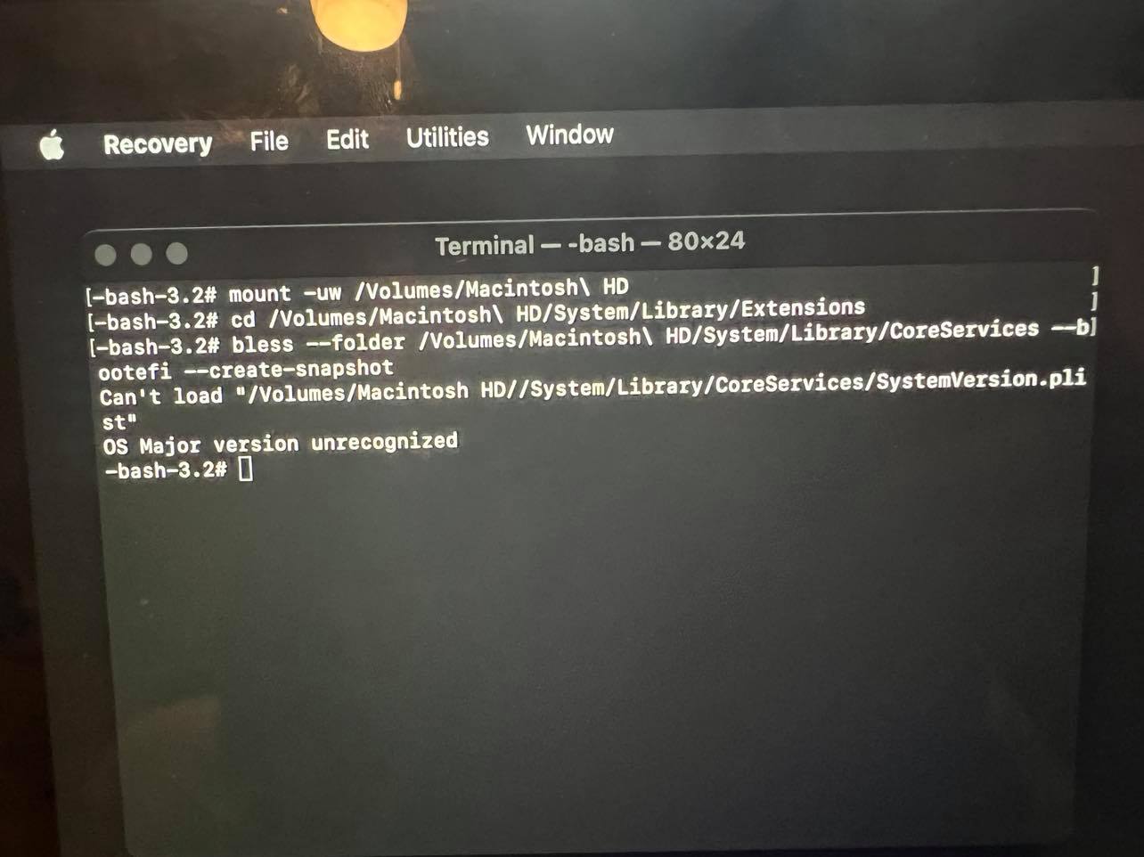

2nd Picture shows the bless --folder command
3rd Picture shows bless -folder
2nd Picture Error
Cant load "/Volumes/Macintosh HD//System/Library/CoreServices/SystemVersion.plist"
OS Major version unrecognized
3rd picture Error
" Cant determine mount point of 'Volumes/Macintosh HD/System/Library/CoreService ' and ' '

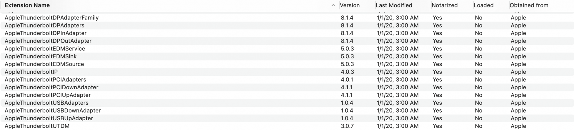

Open System Information
click "Extensions" under the "Software" group
Once list loads, look to be certain AppleThunderbolt* show as not loaded.

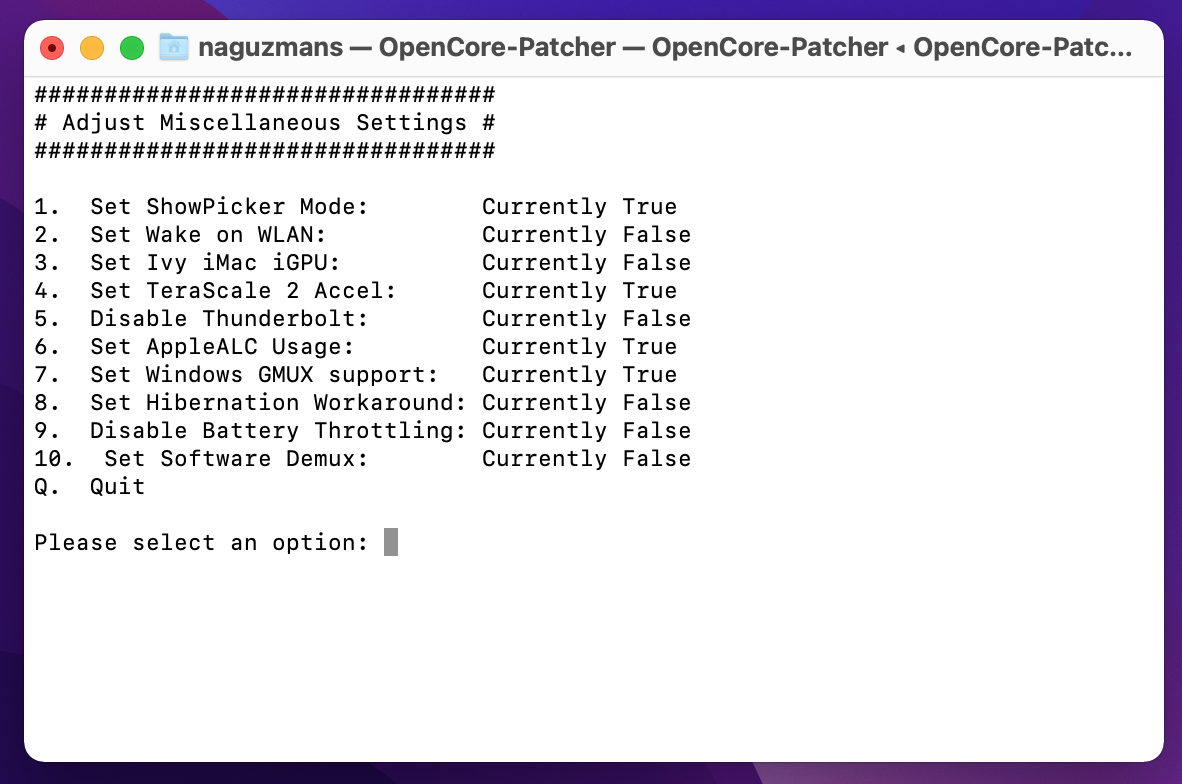

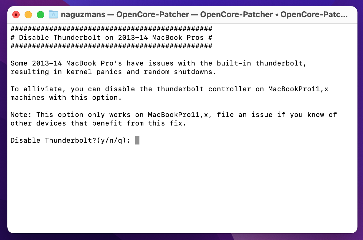

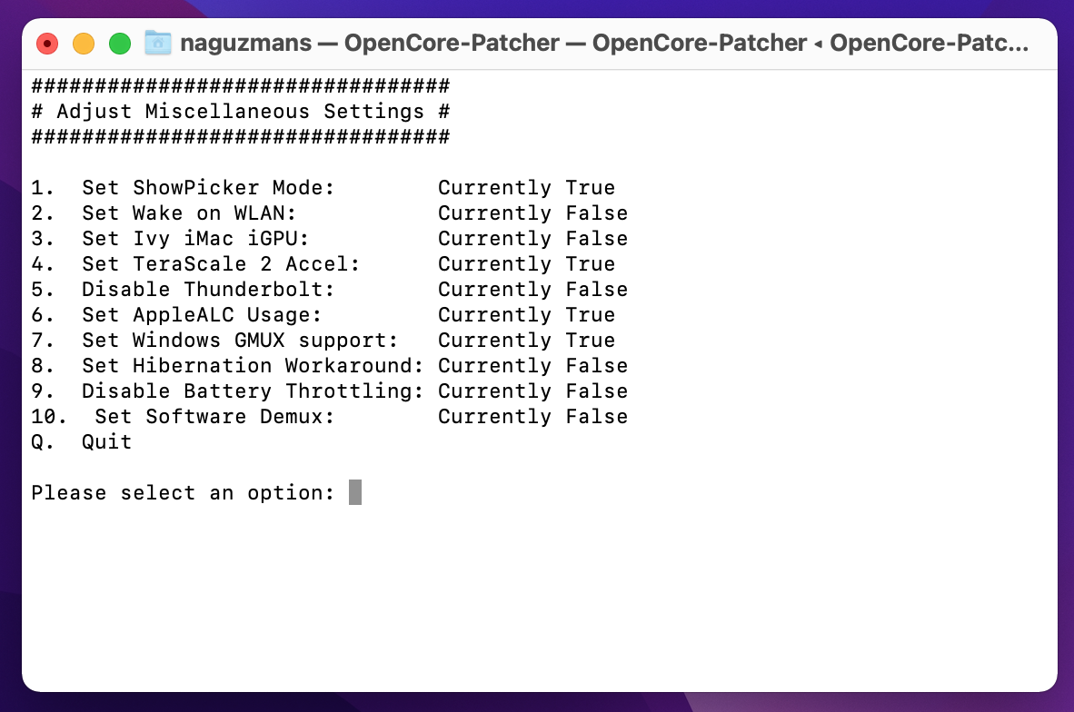

If you want to see any easier way to disable the thunderbolt without doing all those commands Use Opencore its quite simple. I posted instructions on how to use opencore on another thread with the help of another user which can be found here:
Hope this helps everyone!
