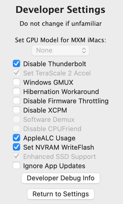

Yesterday I updated my Macbook (11,2) to macOS 12.3 with no issues, before doing it I just installed OCLP 0.4.3.
Reactions: Oneiroi91

Did you update through Mac's own system update or through OCLP?
Before updating download the latest OCLP from https://github.com/dortania/OpenCore-Legacy-Patcher/releases (OpenCore-Patcher-GUI.app.zip). 'Disable Thunderbolt' is under Settings->Developer Settings. After you install the patch reboot and go to Mac's own software update in System Preferences.
Thank you! I think I remember reading that you had Monterey installed, right? Is it working well even though it's not officially supported on MBP 2014?
I own a 15" Macbook Pro Late 2013. Everything works great in Monterey, no problems so far.
