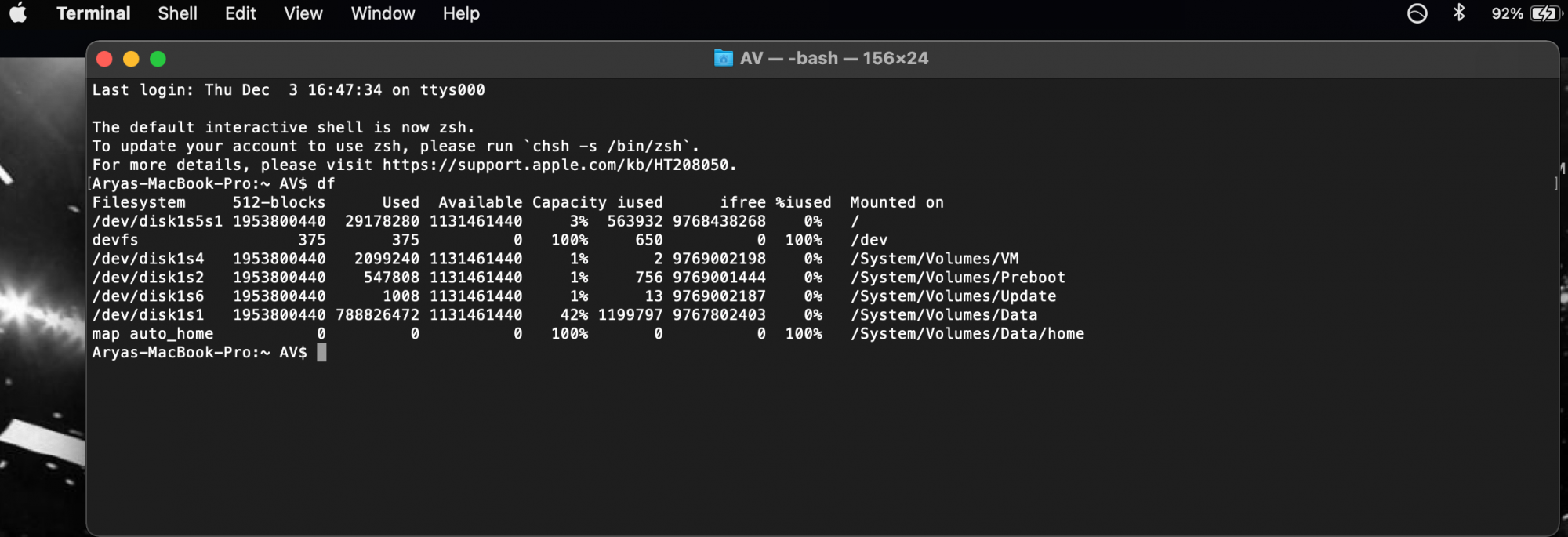

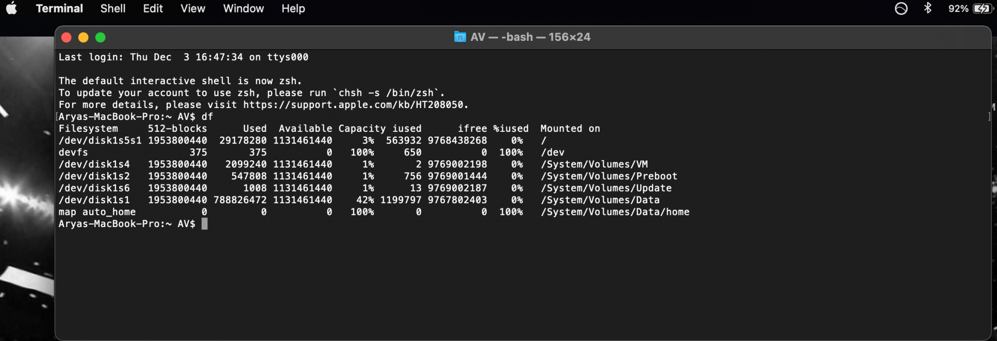

Booted up terminal on desktop: Aryas-MacBook-Pro:~ AV (shown in picture "AV")

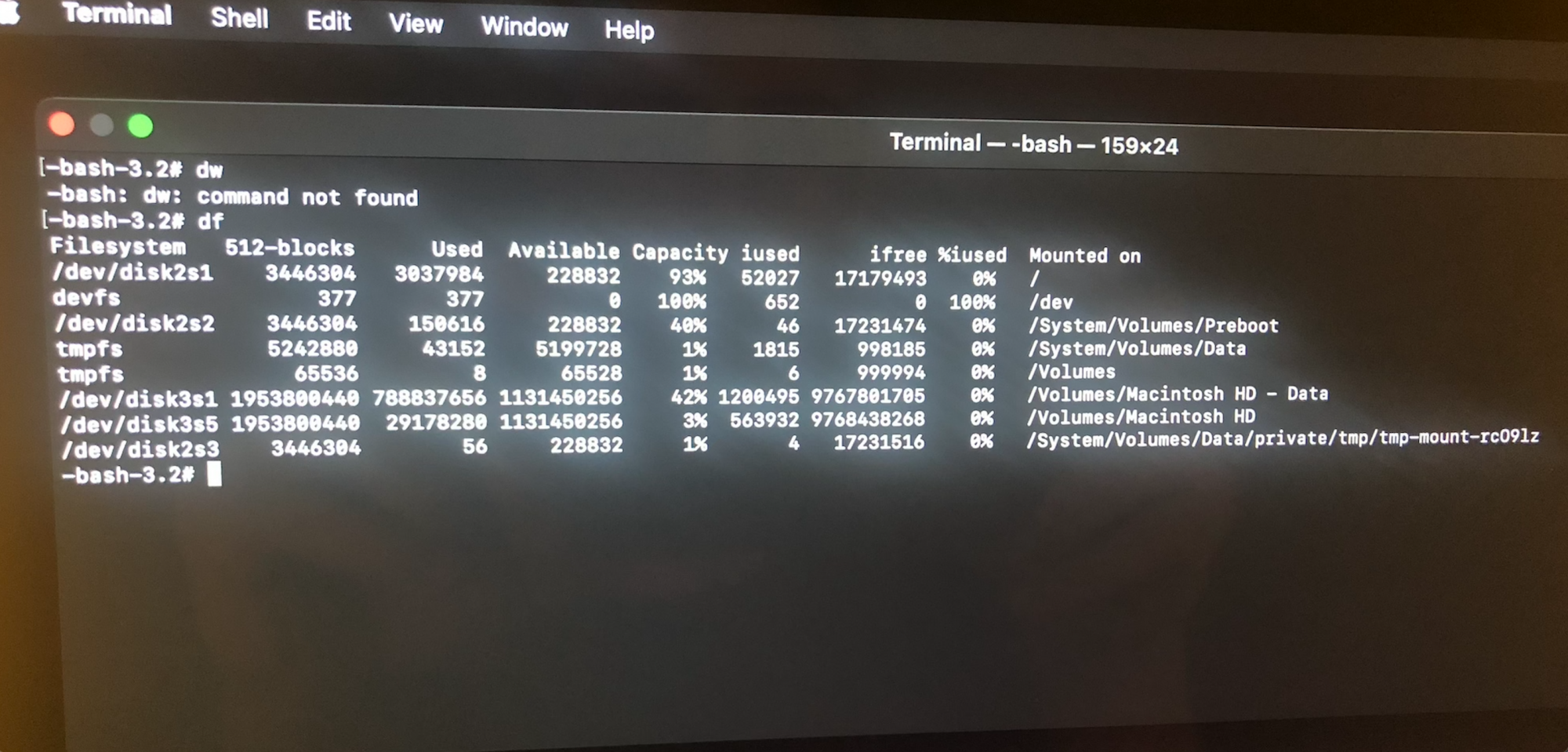

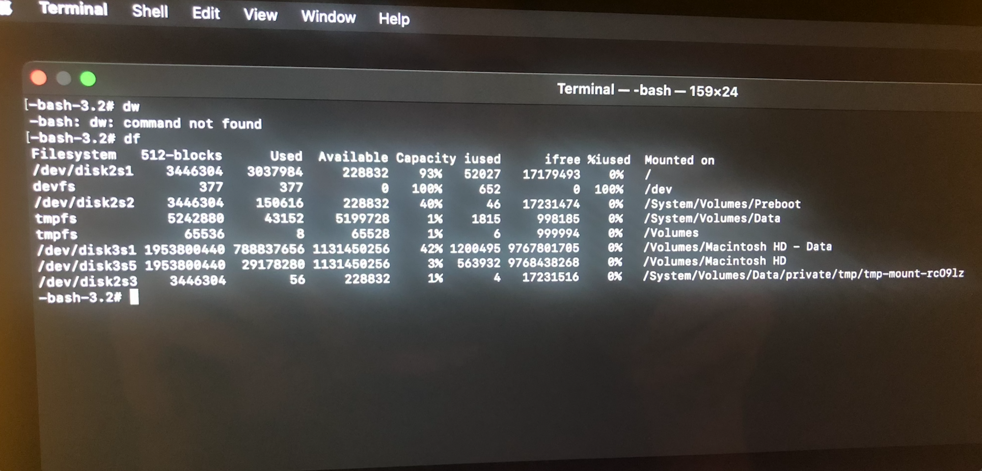

Cmd + R terminal: Macintosh HD - Data (shown in picture 2)
Once you guys help out with my noob question, do you mind filling in the blank of with the example below of how I should type it into the terminal once going through the recovery mode terminal?
mount -uw /Volumes/__________
Very last question, enable csrutil at the very end of everything or just leave it disabled?
- sincerely, the big noob
mount -uw /Volumes/Macintosh\ HD
Do not enable csrutil

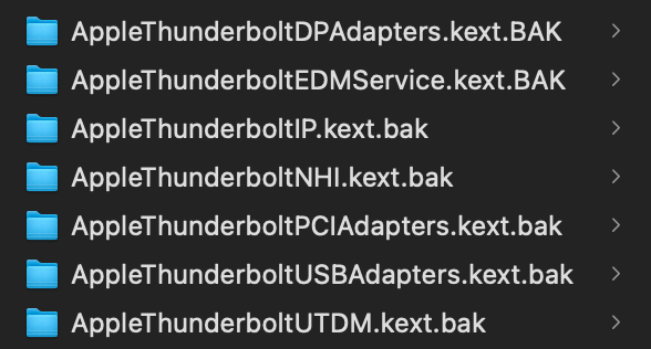

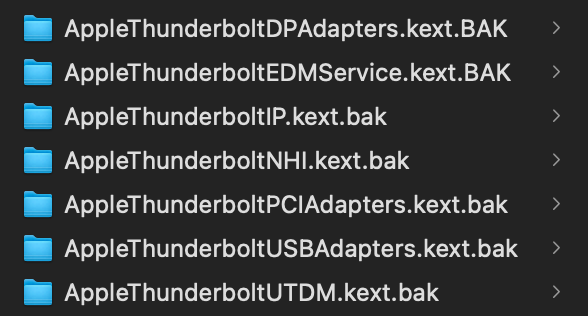

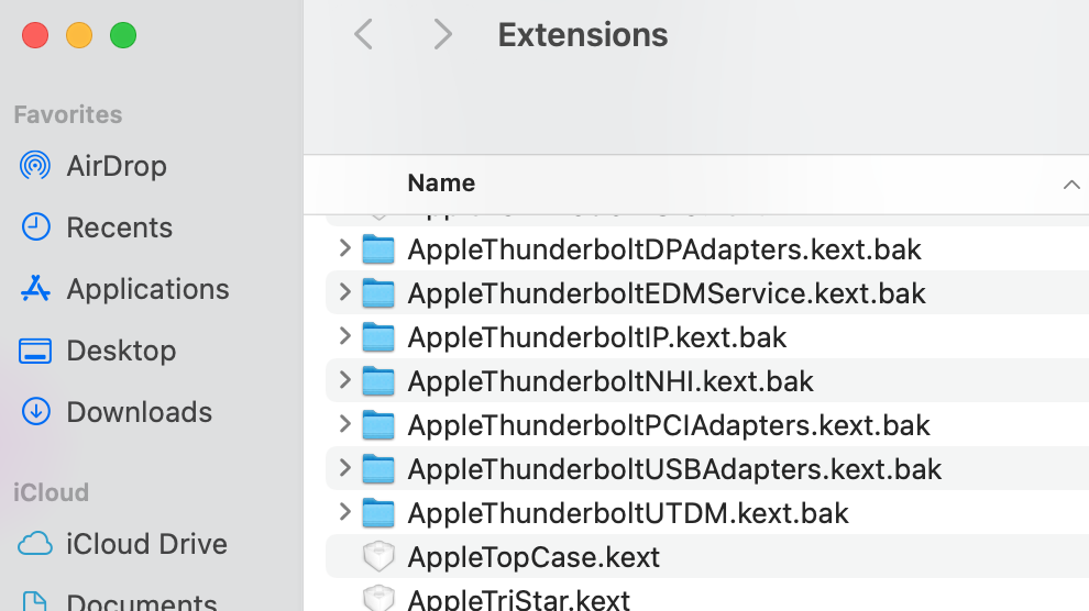

I accidentally renamed the first two .bak files as ".BAK" and did the rest in ".bak" (image attached). Assuming the capital letters shouldn't be an issue since it's an extension? If it is an issue, assuming I just go back into cmd + r terminal and run through the same exact process/steps (without the csrutil disable/csrutil auth disable steps since they're implemented?) and just change the files from ".BAK" to ".bak"?
Appreciate the patience with my questions.
It is not an issue, you just have to rename them, leave it that way.
